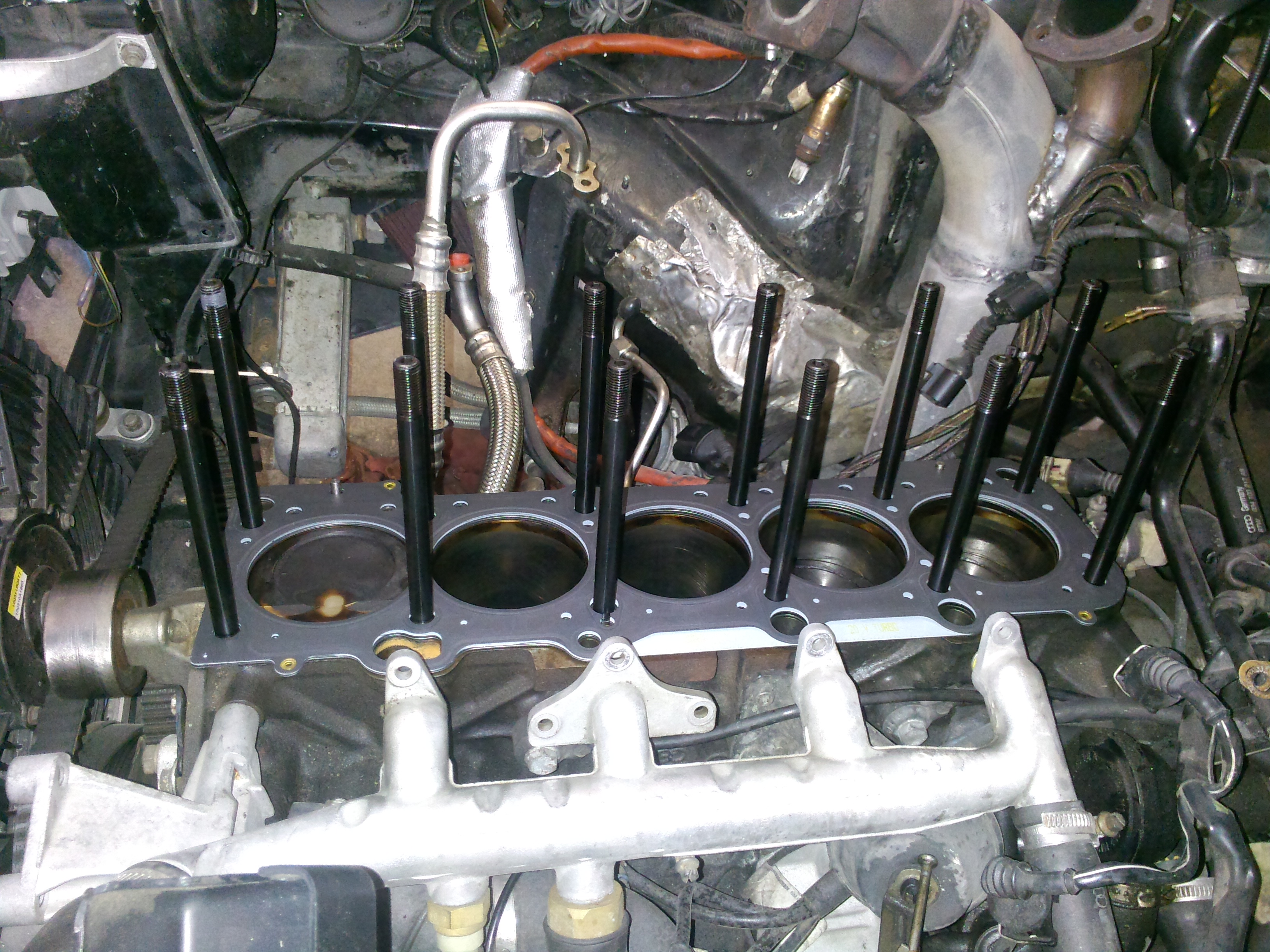

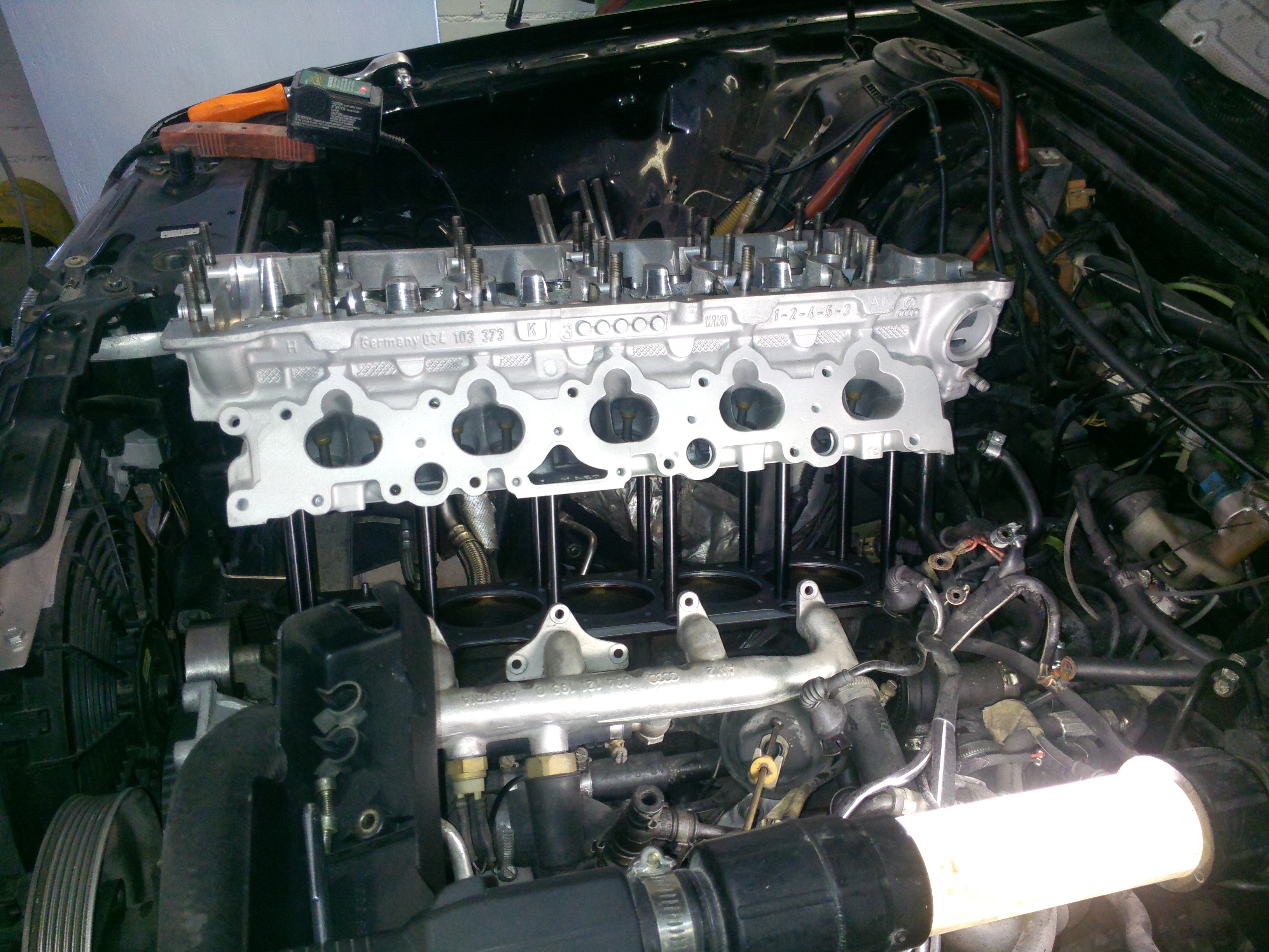

Head studs Installed...
Head Installing...

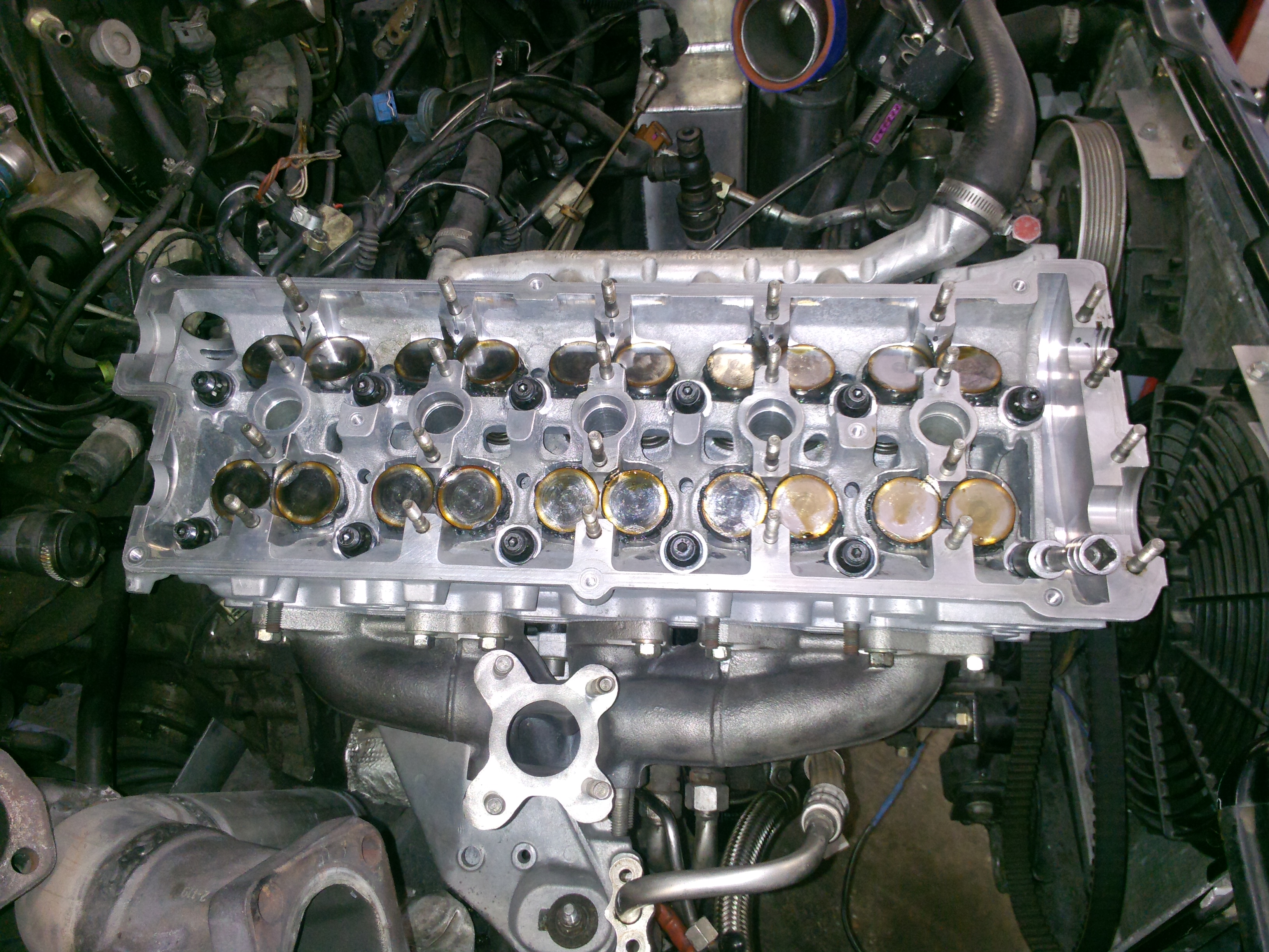

Head installed and torqued...
I also have swapped my turbo cams into my 7A and vice versa. I have installed them but have not a pic at the moment.
