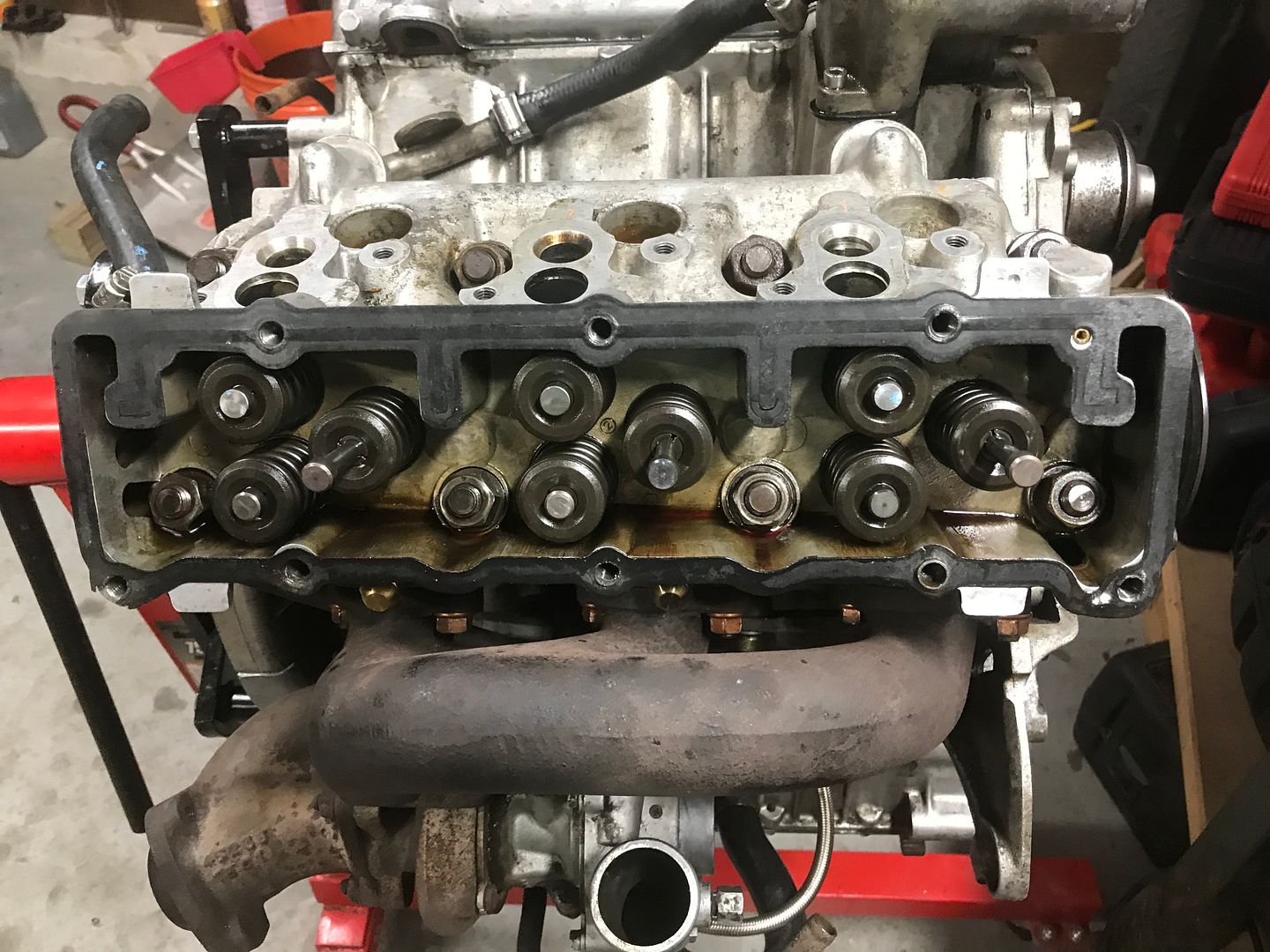

Yeah, I was pretty worried that I'd have trouble with the heads but they popped right off. No trouble at all!
I have the new head gaskets and valve seals on order to show up by the weekend.
I believe I found the issue - a broken valve stem seal on one of the intake valves for Cyl #4:
Hopefully I'll be up and running before Labor Day

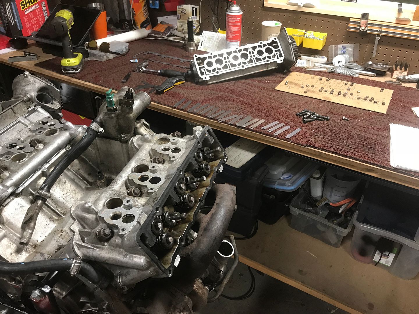

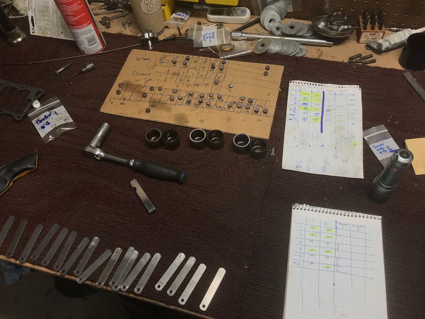

Deep into the most annoying part of this project yet - and that's saying something
These engines require that the clearance from the cams to the "cup" lifters be set to a close tolerance. The intake between 0.31 and 0.39 mm and the exhaust between 0.41 and 0.49mm.
To achieve this, you need to place the proper thickness shim on the end of the valve stem (one for exhaust, two for intake)
Mine were all wrong of course so I'm working on it now:
To make matters more annoying, you can only check the clearance with the cam box torqued down to the heads so I've had it on and off probably 10 times the last week or two while I slowly deal with this.
These engines are so weird. Turns out its the first ever 3 valve per cylinder engine ever mass produced (as well as the first twin turbo)
The image below shows the way the three valve works. Valve shims in red, cup lifters in blue, valve stems in yellow. The exhaust lobe only opens one exhaust valve so the stem is long and sits centered in the middle of the underside of the lifter cup. For the two intake valves, the lifter cup has thicker walls and the two valve stems hit opposite sides of the lifter cup on the thickened walls. So odd

FYI you may be able to grind the shims by hand with fine grit wet dry sandpaper against a flat surface. That's how I did the intake shims for the Alfa.
Grillage
Posts: 863
Location: Cincinnati, OH
Re: Ben's Maserati Biturbo Spyder
Post by Grillage »
I've done that for a change of 0.05mm or so. I'm not super comfortable doing much more than that. Amazingly, the vast majority of the shims I have from this engine and the bad engine I harvested the others from are all a bit too small. I have another shipment of what I hope to be the last ones coming my way before the weekend. then I can finally install the engine again and get this thing moving!
