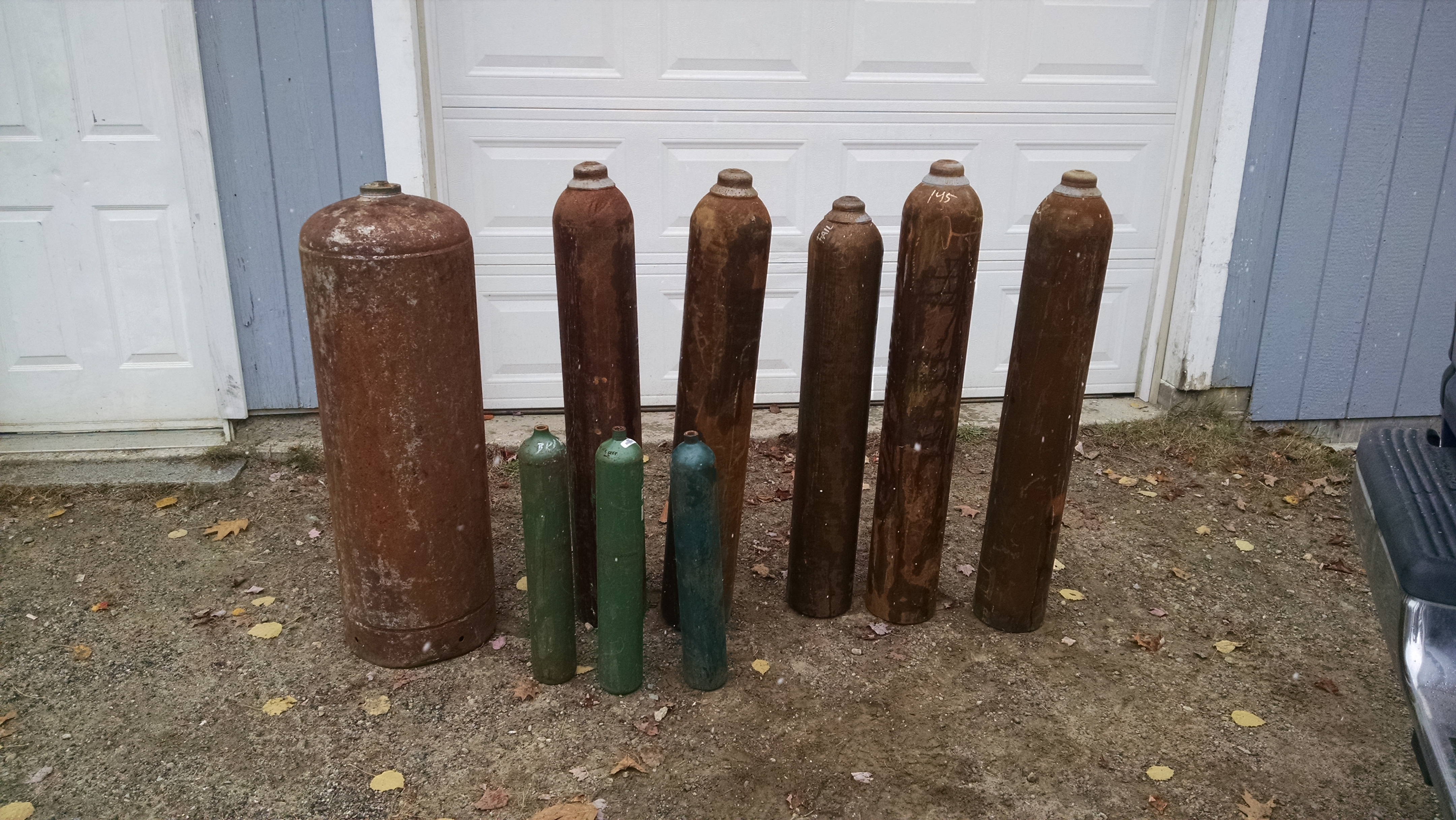

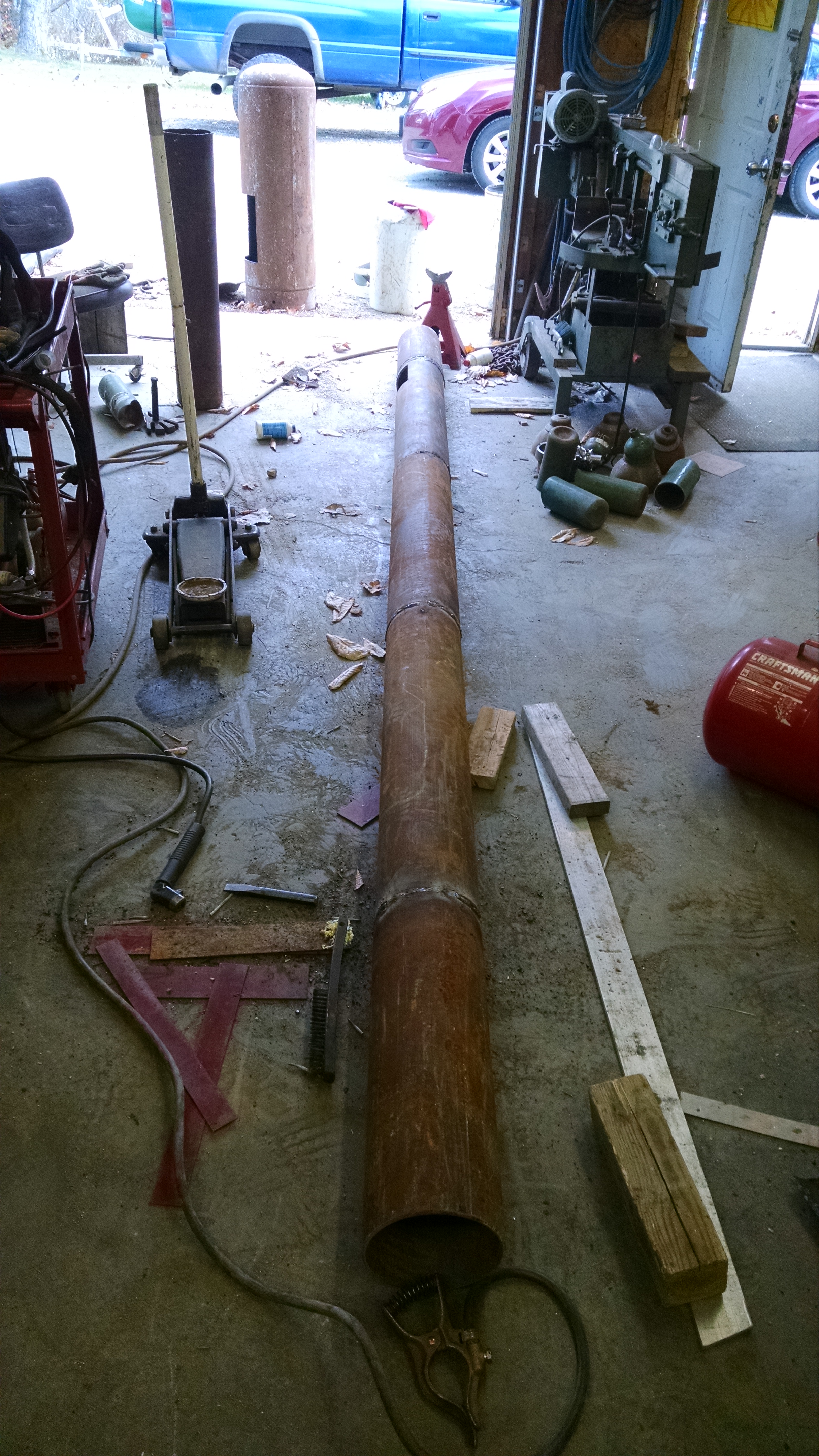

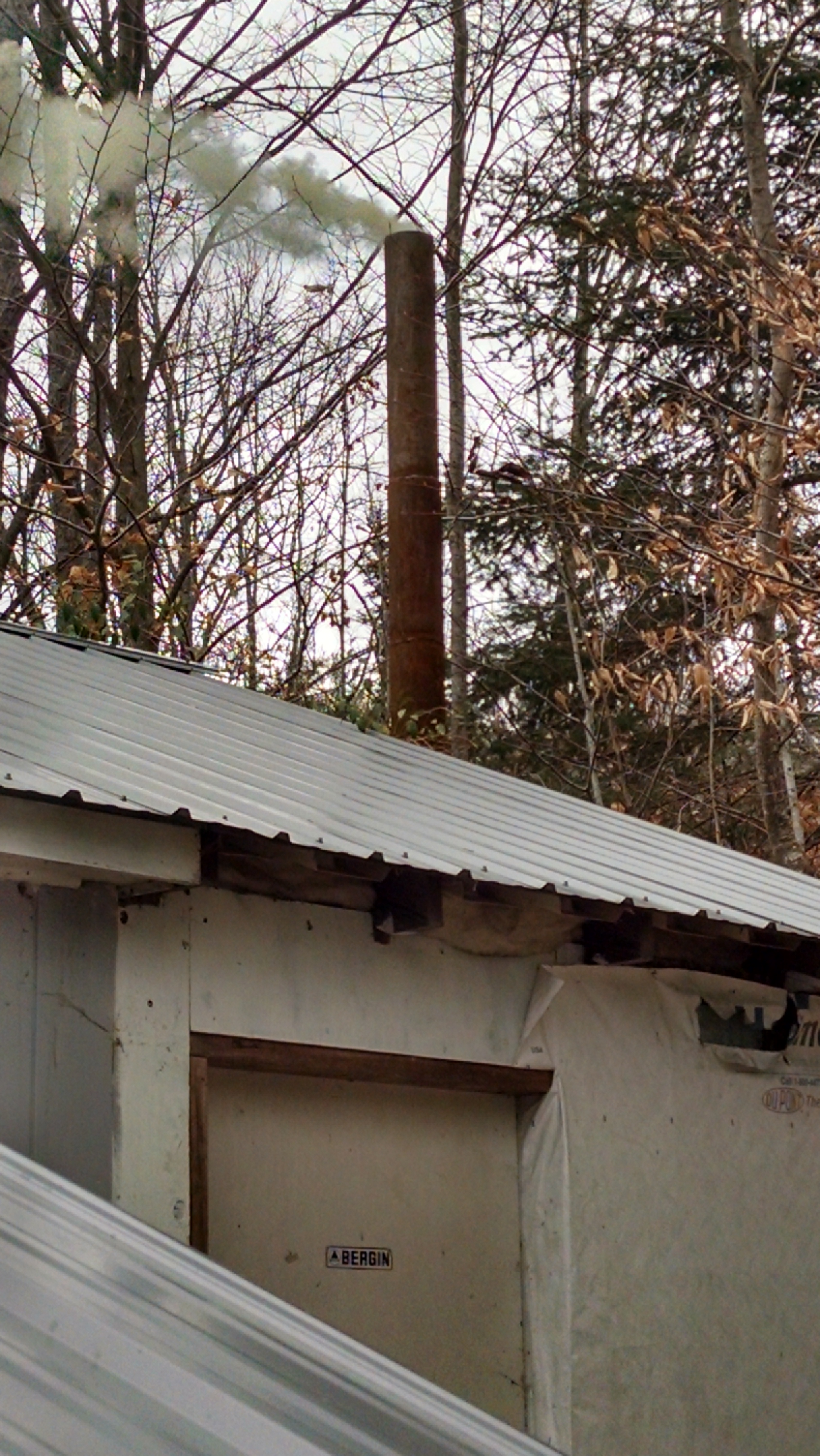

I found a few version of this on YouTube so I figured I would give it a shot myself, with the price of scrap low I went to the local salvage yard that the air gas plant scraps all there bottles and got some supply's. 1st off I built a new chimney since my stove pipe one was getting rough, I used 6 argon tanks welded end to end to make an 18.5' chimney
Don't judge the welds,  I'm a tig welder not a stick welder

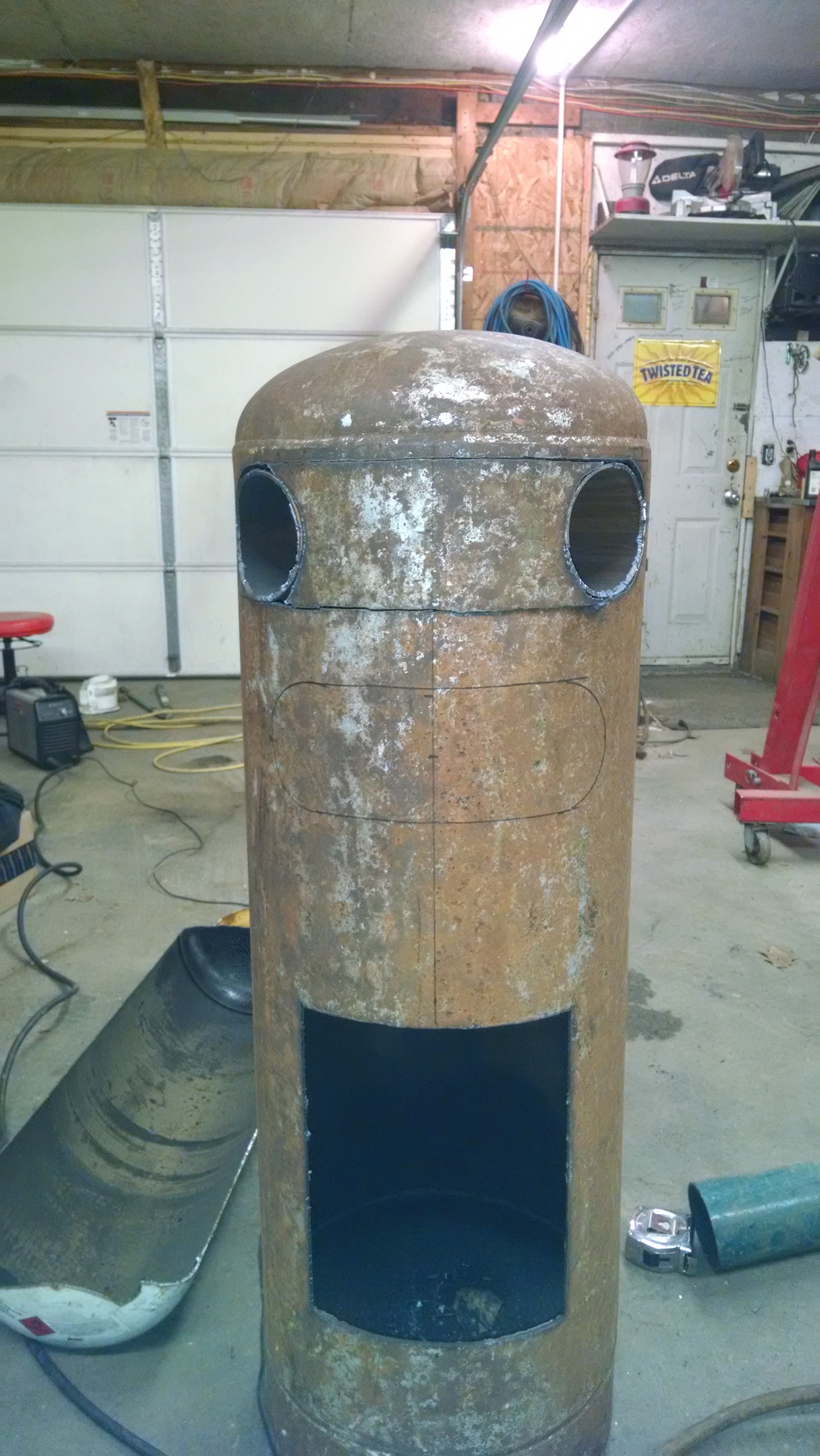

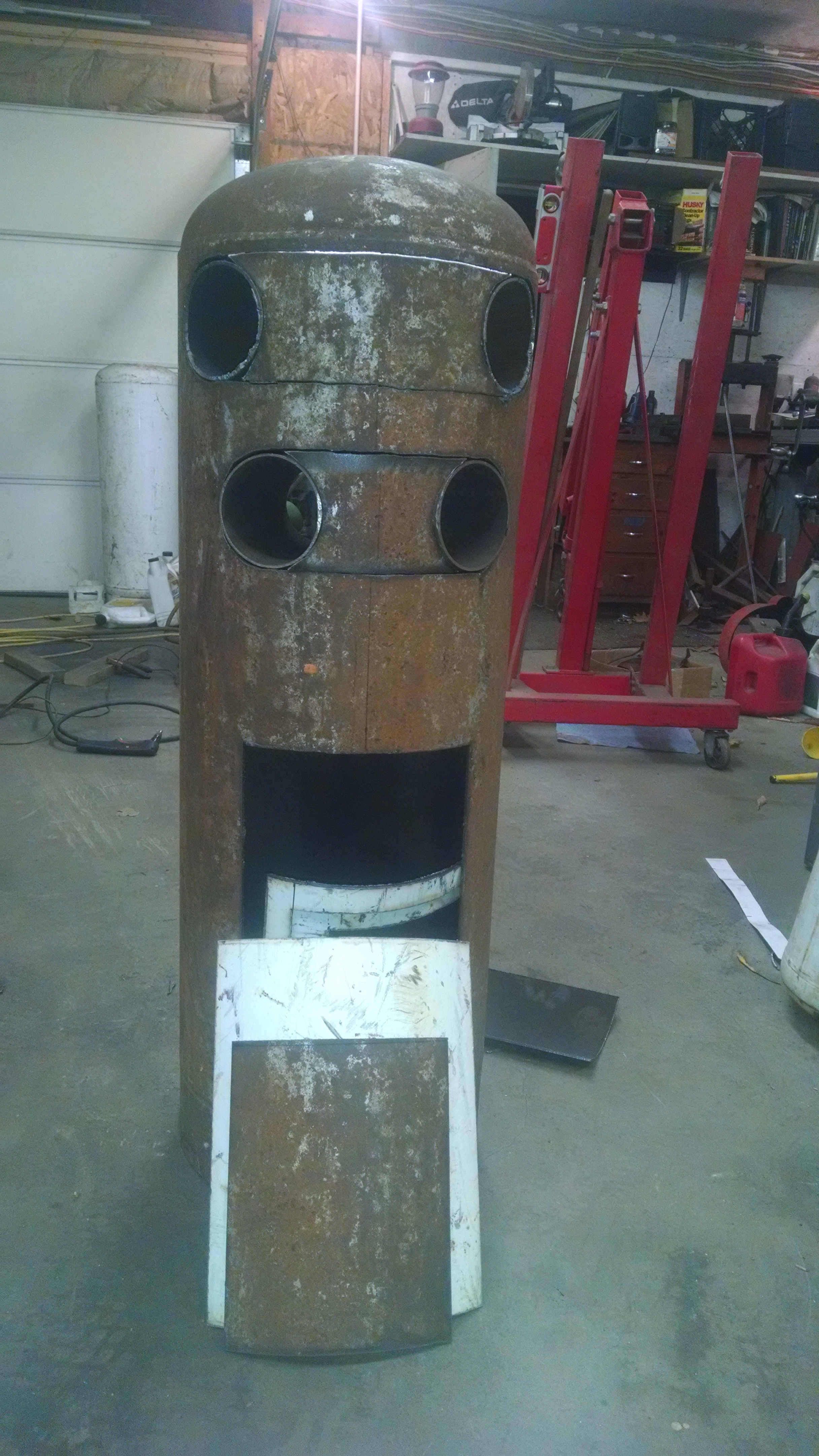

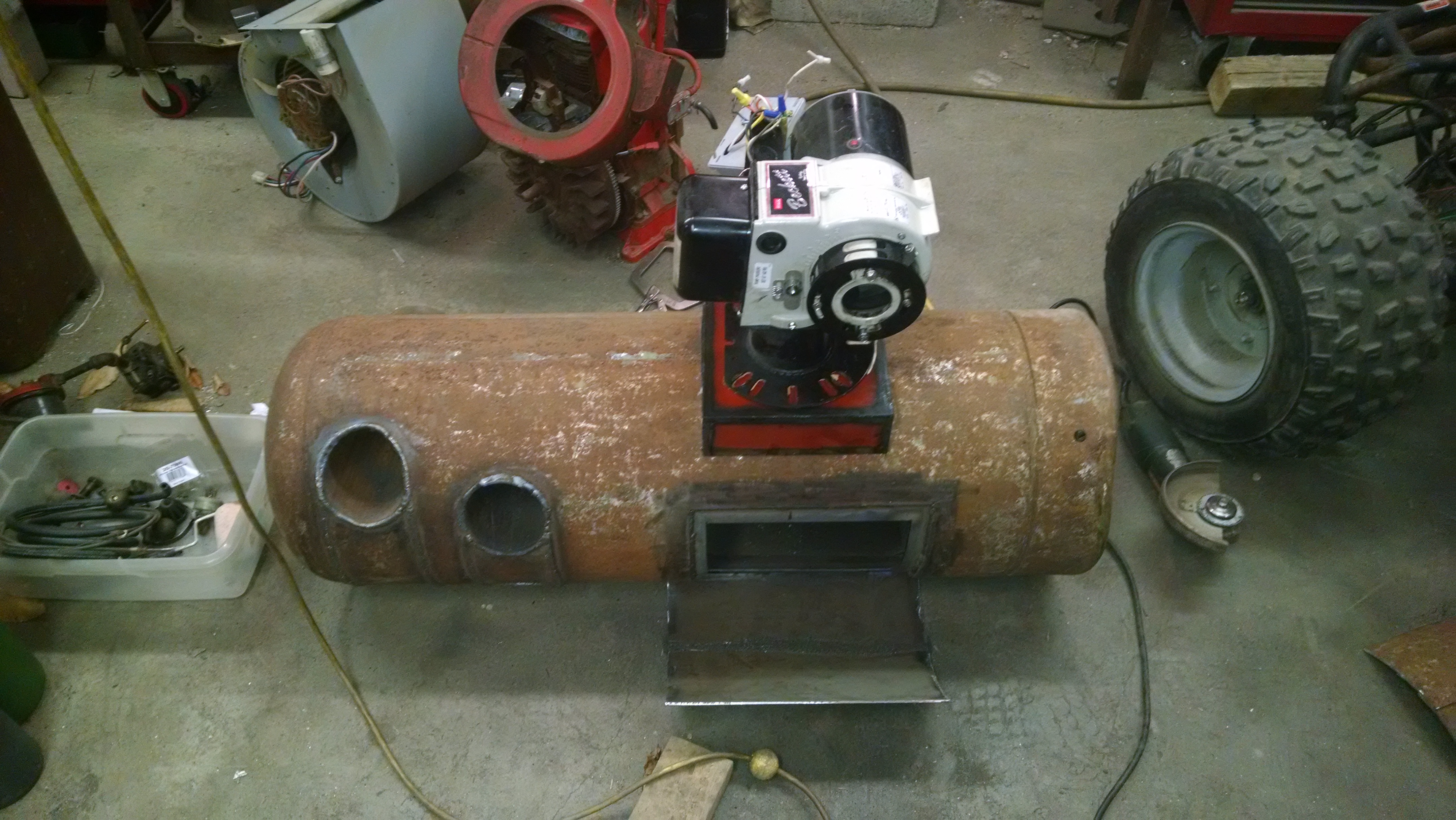

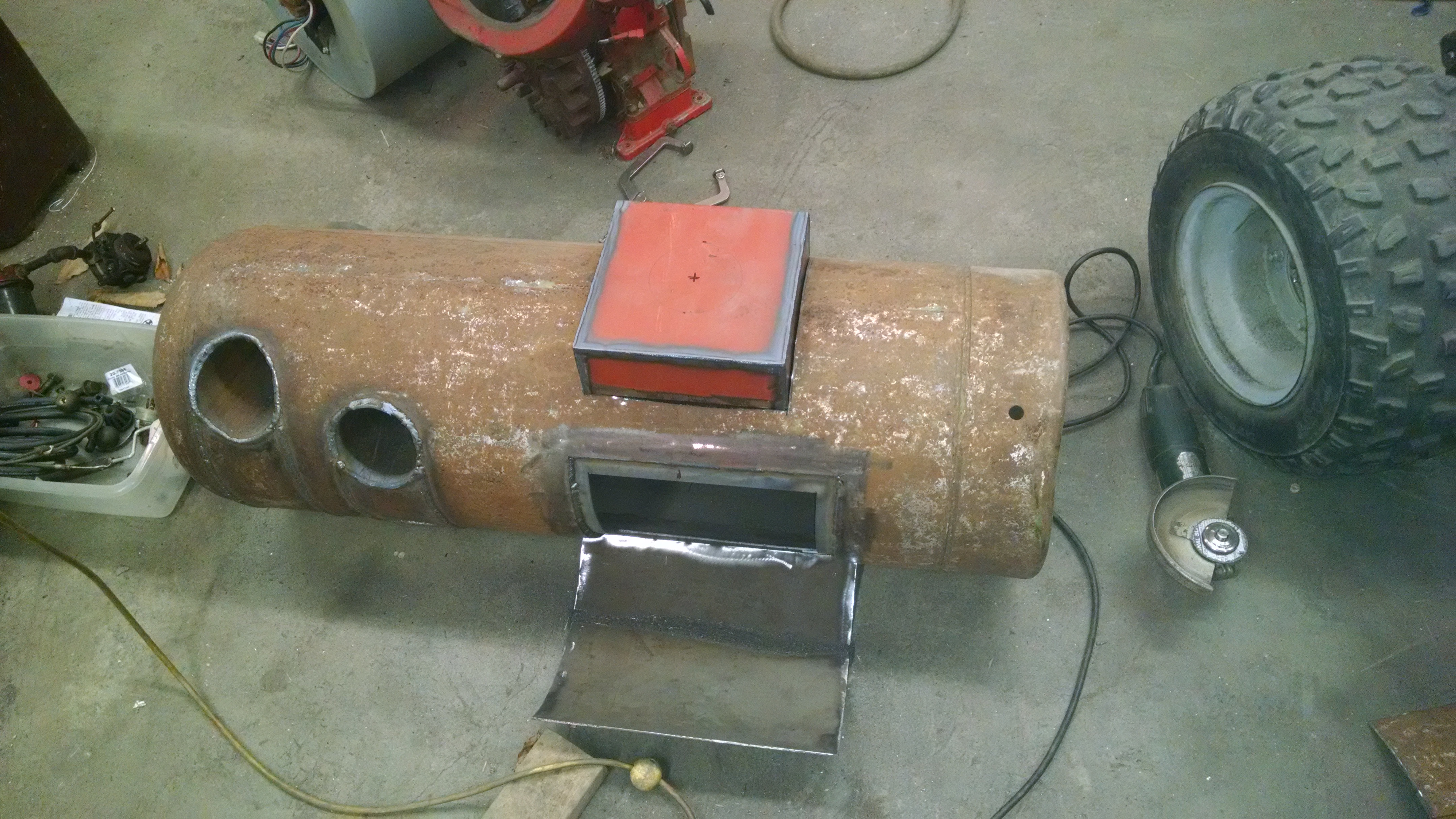

Ok so now that the chimney was done I could move onto the waste oil furnace, the main part of the furnace is an old propane tank. Some how I don't own a plasma cutter yet so I luckly have really generous friends and I was able to borrow one for a long weekend to get 90% of the cutting done, this saved me tons of time and cut off wheels.
I have a 1/4" steel fuel line going down the ctr of this tube for the oil and the blower pushes air through the pipe cooling the line and feeding the flame
I'm using a oil burner that was going to get scrapped since it was attacked to a cracked furnace(freebie!). It's only being used as a blower since this is a drip style burner.
The through holes are oxygen tanks,  the are v's and exit the ctr of the back and will be hooked to duct work to pump air into the main room in my shop

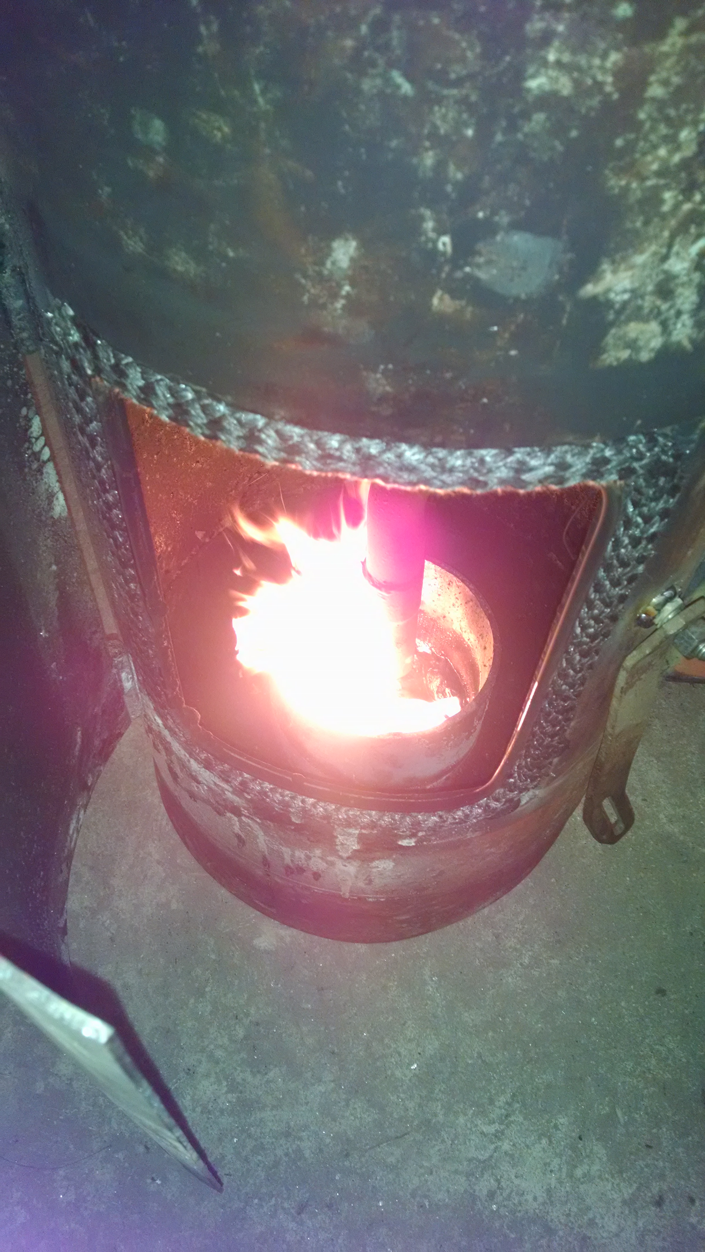

The burn pot is the bottom of a argon tank but I think it would work better with a thin ss pot with a flat bottom  so it gets hotter a burns better

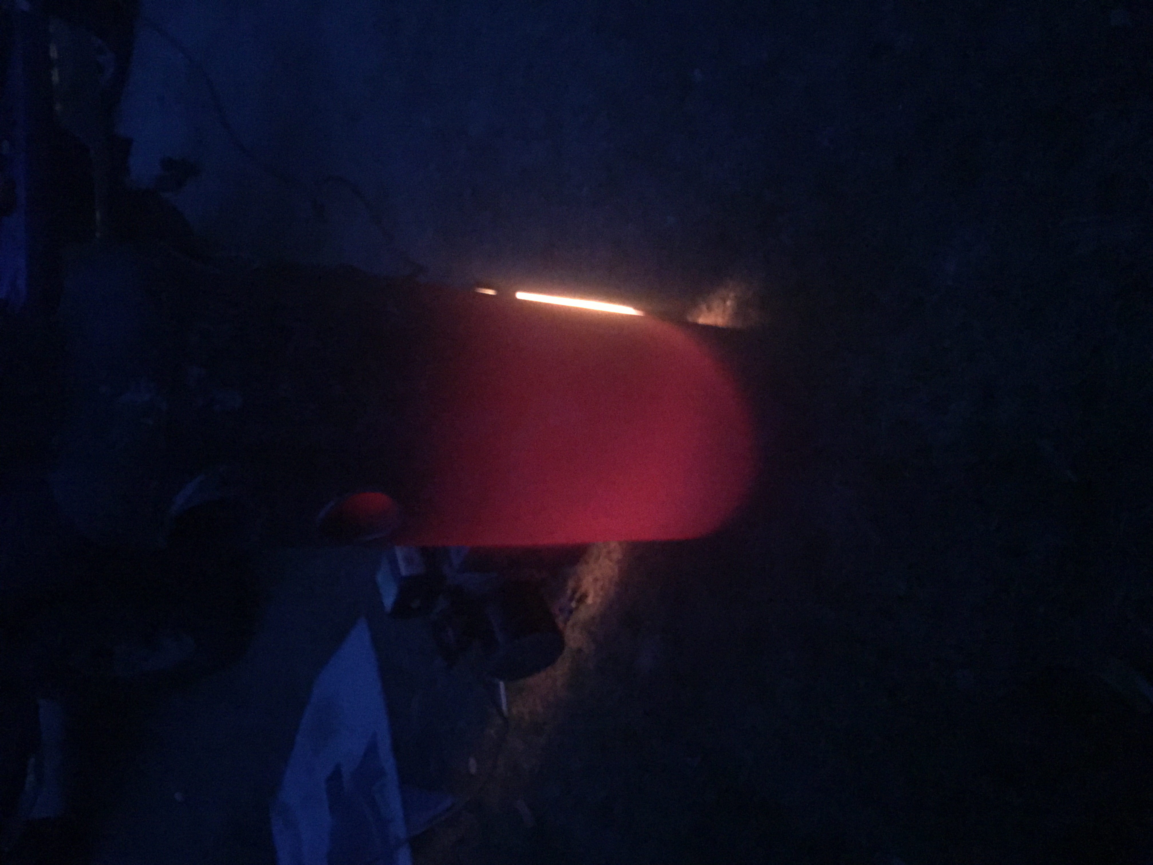

Oops this is when I decided to shut it down with a fire extinguisher
