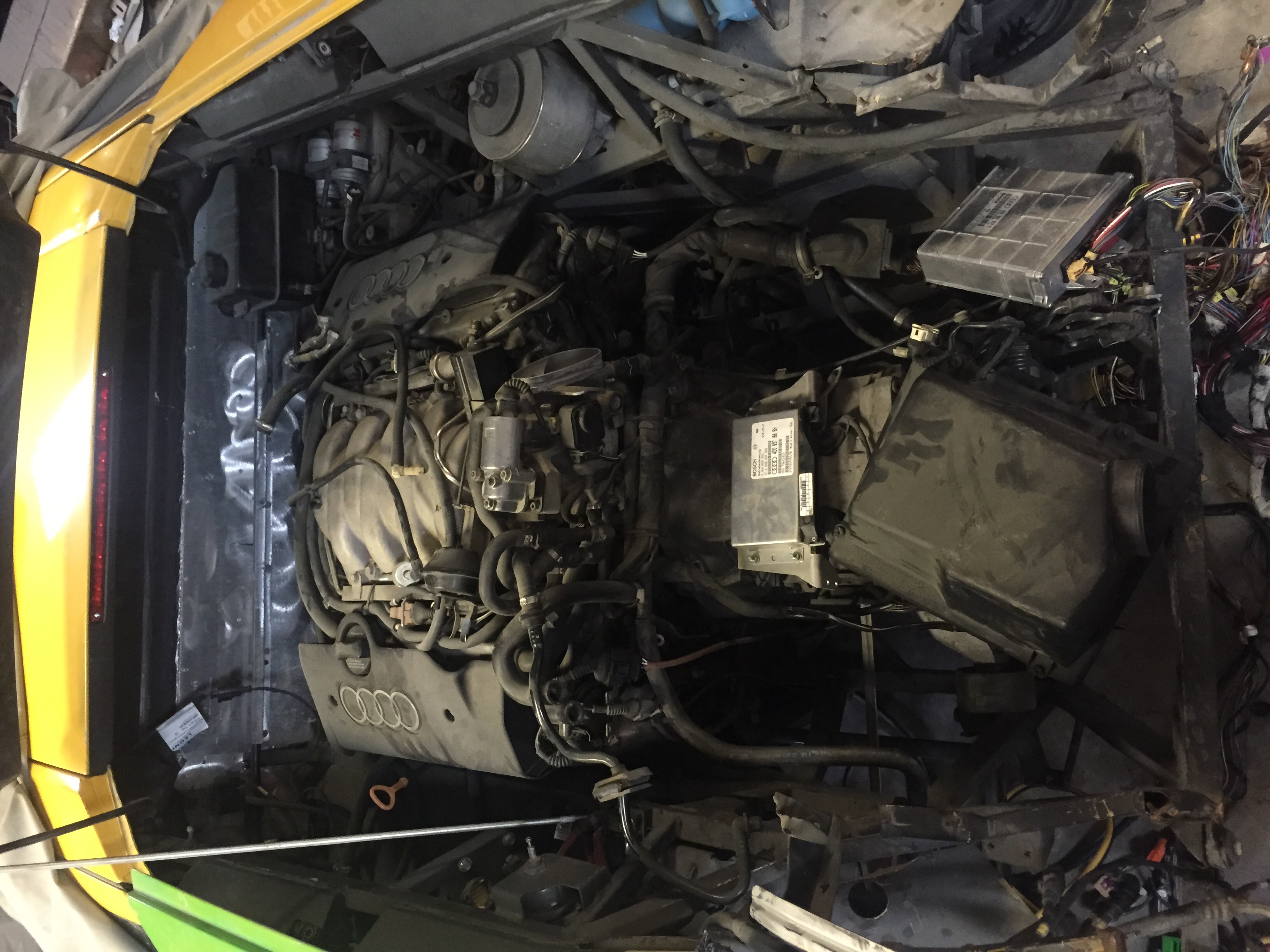

No better place to start then here! I was invited over by a member from another forum and asked if I wanted to post up my little project. I have a 2006 Lamborghini Murcielago that was wrecked when I purchased it, motor was bad and exactly what i was looking for to do my 4.2 swap. I have about a million questions and I'm not far into the swap. Right now I have a 98 A8 4.2 car that i have completely dismantled and have for a donor. Im not looking for the same power the Murci had I'm just looking for reliability and comfort with less maintenance. I have all of the Murci wiring all figured out. Don't know if may people know but the Murci's are just pretty much Audi's under the body. Every wire on the car is labeled VW/Audi, every connector, master cylinder, brake booster is all off an Audi car. So this seemed to be the only direction I wanted to go is use the 4.2. I really don't want to run a stand alone engine management (but not opposed) I like having the knock sensors, etc.

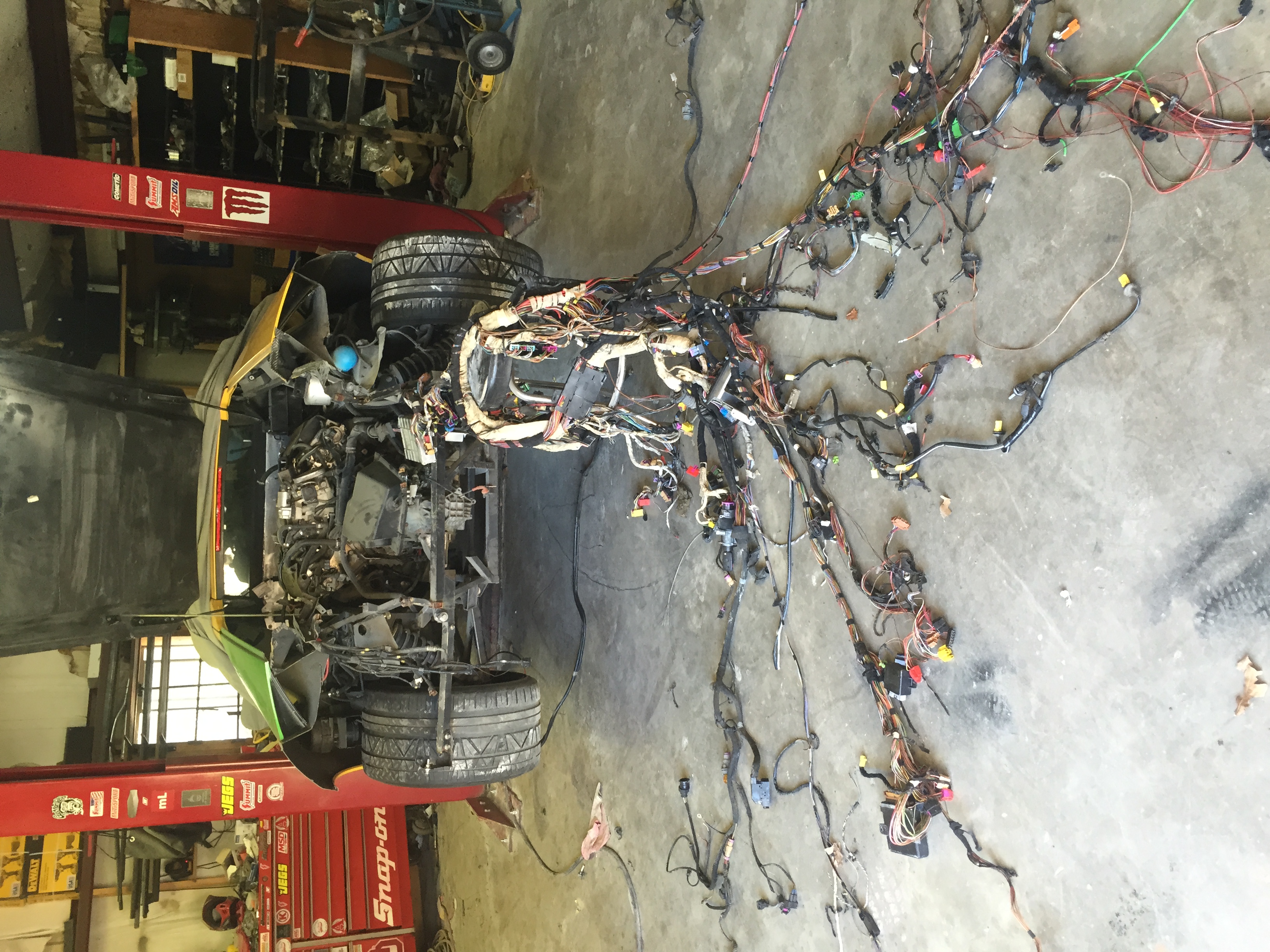

I am looking for any info I can get on how to eliminate as many wires as I can off of the Audi harness to where I can just hook up the lamb harness into the Audi computer.
All the Murci wiring is there, intact and working. Murci PCM all works fine, instrument cluster is fine, Climate control all is good, windows, locks, everything on the Murci is good. Even have the factory ignition wire ready to hook up to the starter solenoid.
So a few questions, right now I'm trying to just get it to fire up off the factory wiring that is spread out, however my only draw back is I don't have the neutral safety switch, I left it attached to the transmission when I sold it (only thing I have gotten rid of)
Secondly the RPM speed sensor (I think) it went in the Quattro transmission the transmission I have doesnt have a place for it will it run without it?
Third does the instrument cluster and shifter need to be hooked up to run, I have it all hooked up now just for verification. I didn't know if anything was drawing through them for power, etc.
Lastly, since this was a Quattro car and I'm running a manual what do I do with the auto transmission control unit?

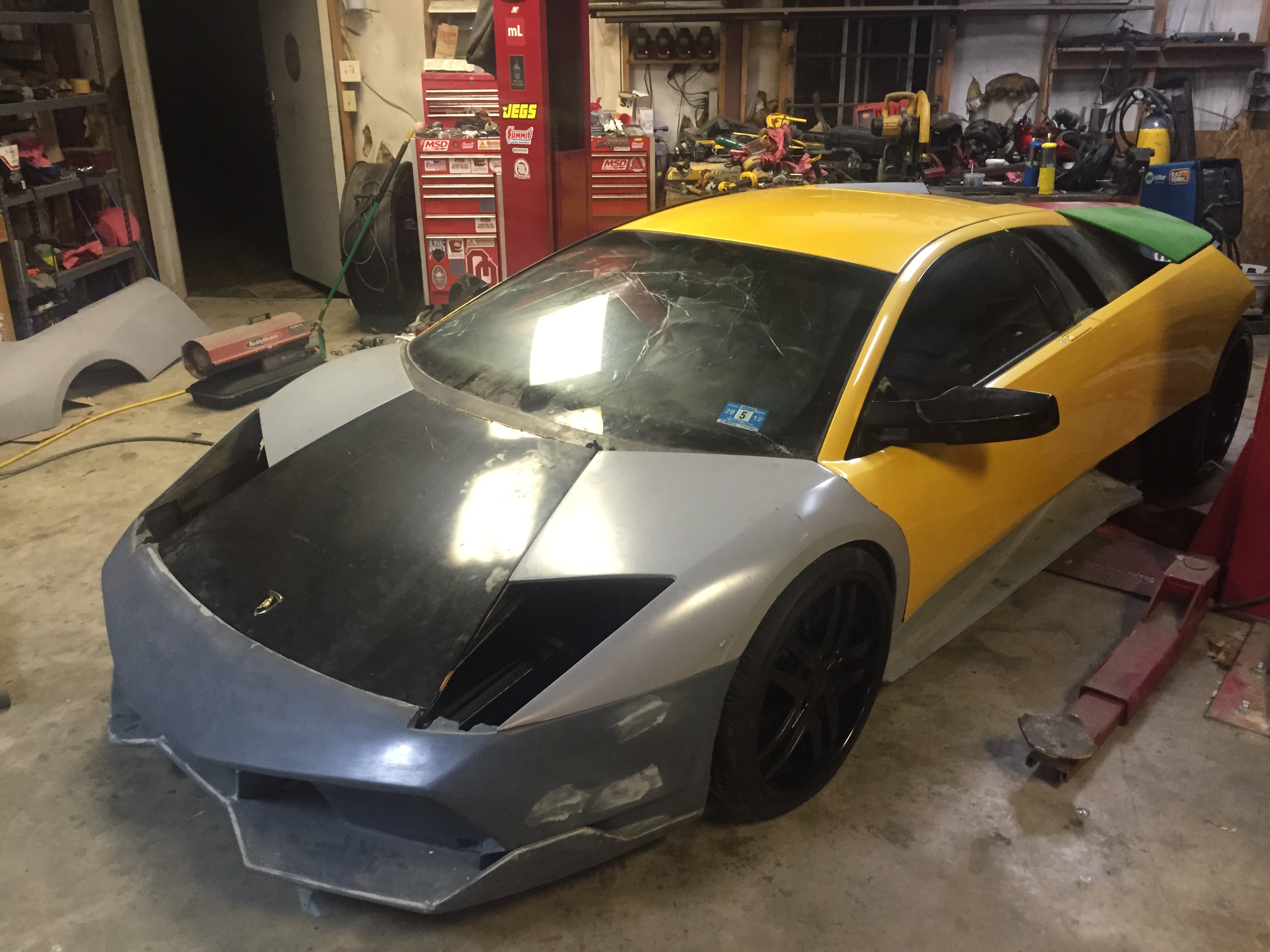

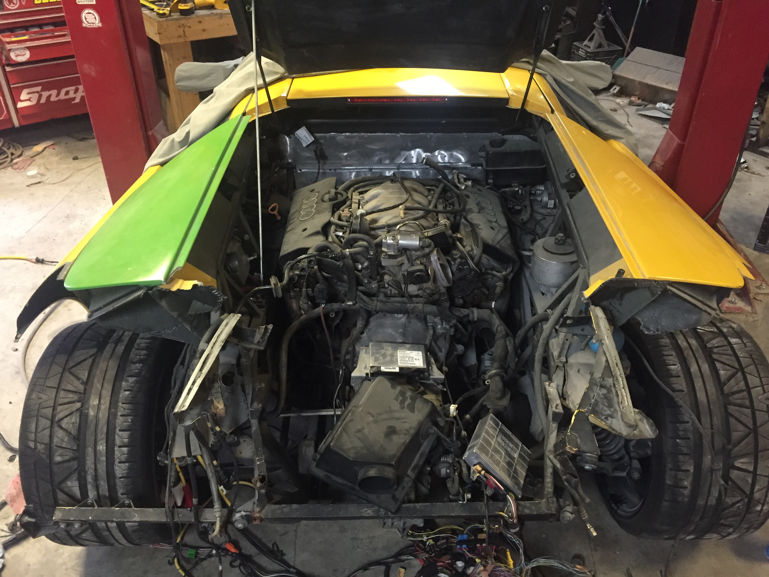

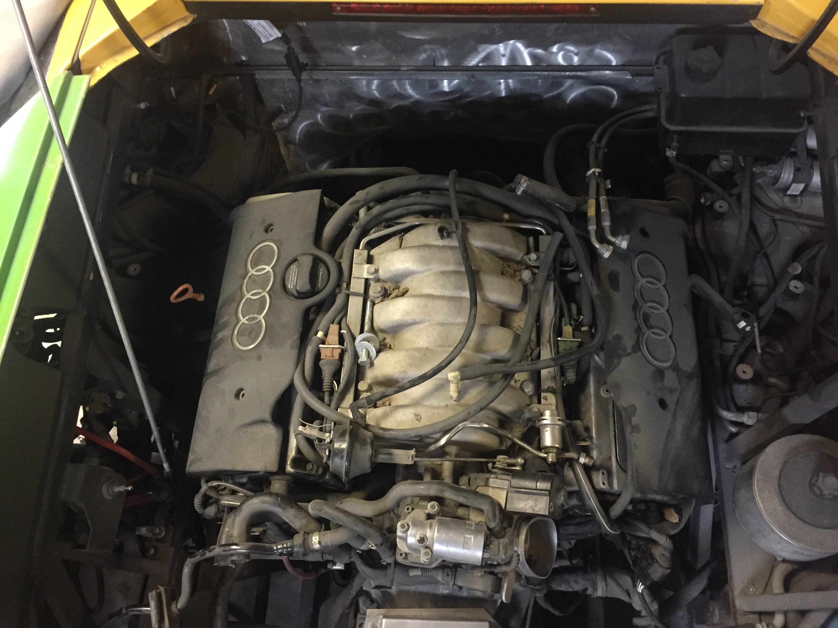

Here are a few more pictures...

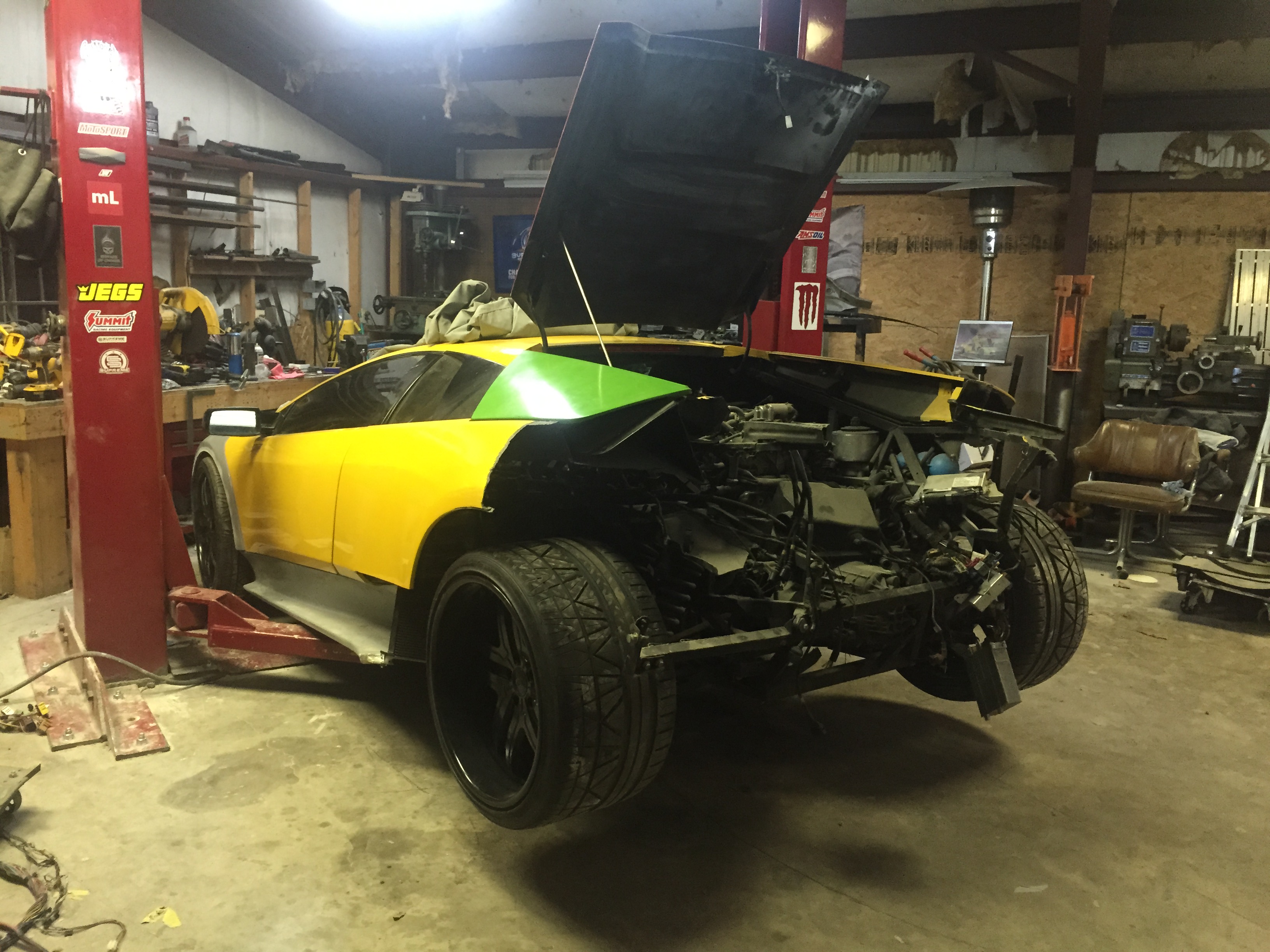

Here are a few pictures of the fitment, should be easy to work on when needed.
