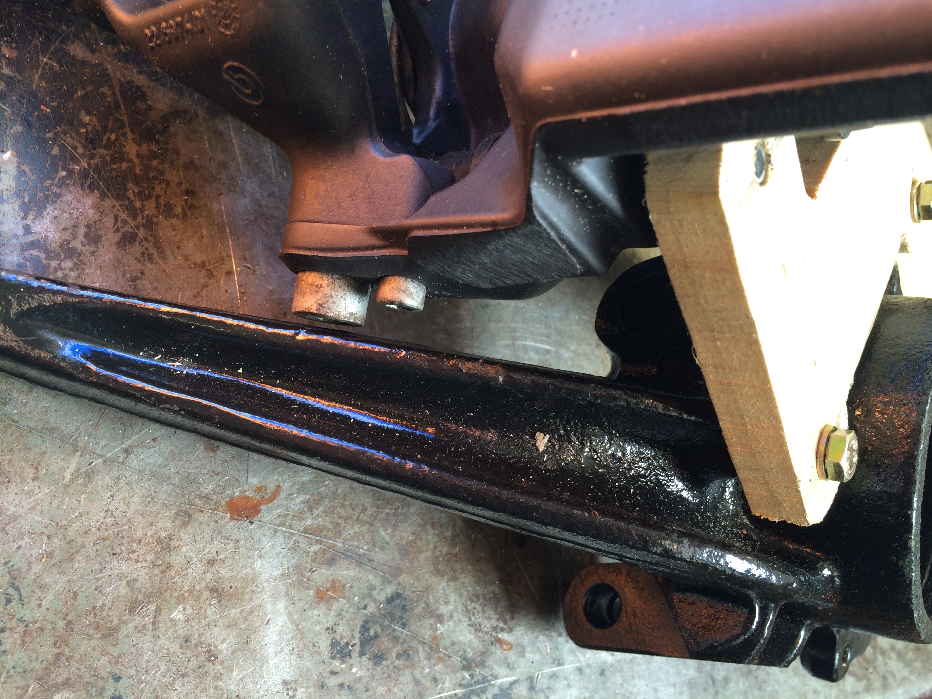

Started with a piece of Poplar wood to make my initial design. Easy to work with & cheap enough to try different designs. Moved to 1/8" steel plate for a pattern & then on to 1/2" plate for the final bracket. Maybe 3/8" would have been enough but I wanted to have at least 6 full threads on the 10X1.25mm bolts that held the calipers to the brackets & the thread depth should be at least the diameter of the fastener.
I torched the rough design out of 1/2" plate steel as I do not have a plasma cutter. I used a Harbor Freight bench top drill press for my "machining" work & an electric grinder for my finishing operations.
My first attempt placed the caliper too close to the hub carrier arm.
My first attempt.
My first attempt.

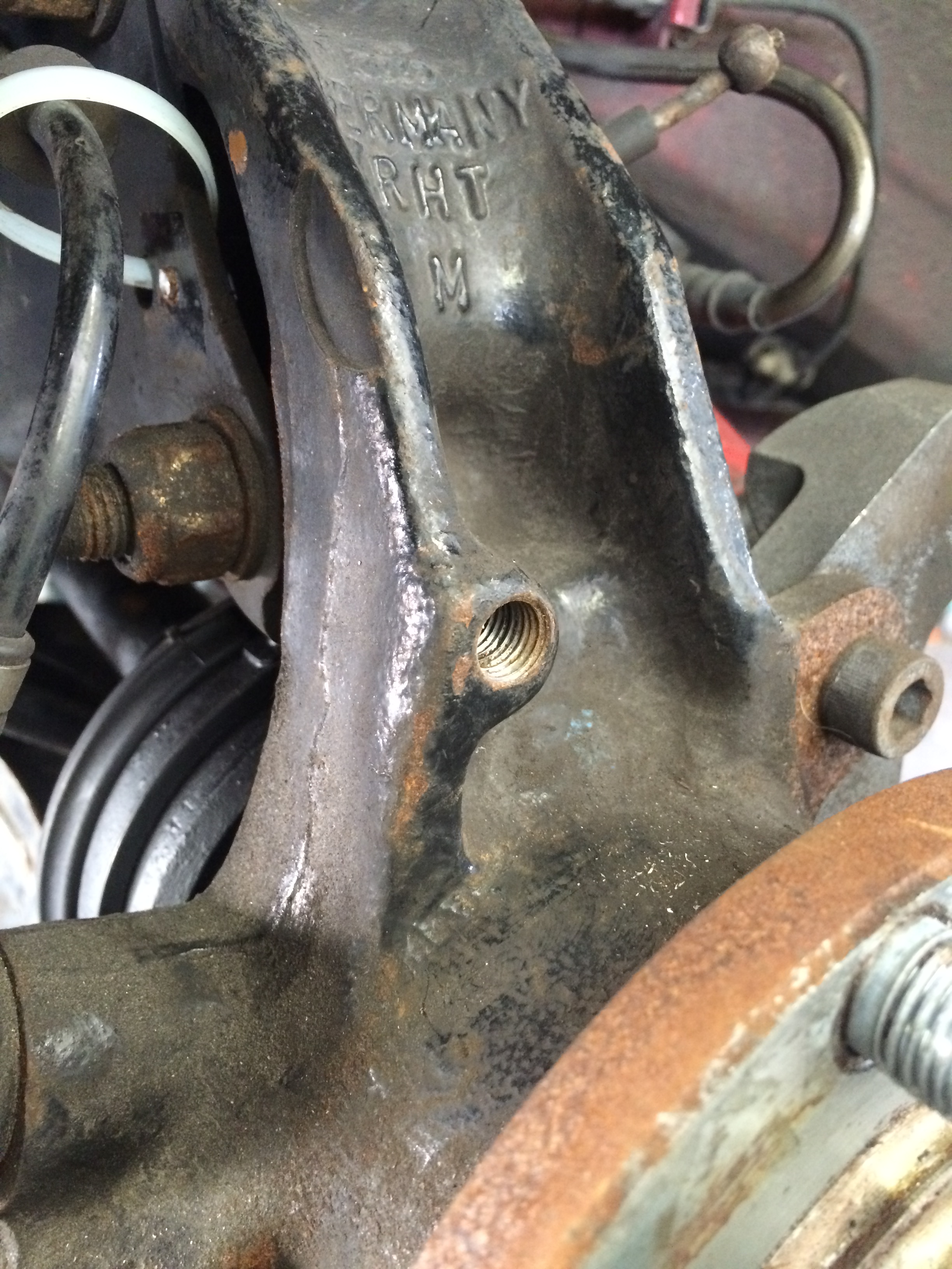

Mounting hole drilled & tapped
August 9 131.JPG (1.35 MiB) Viewed 50720 times

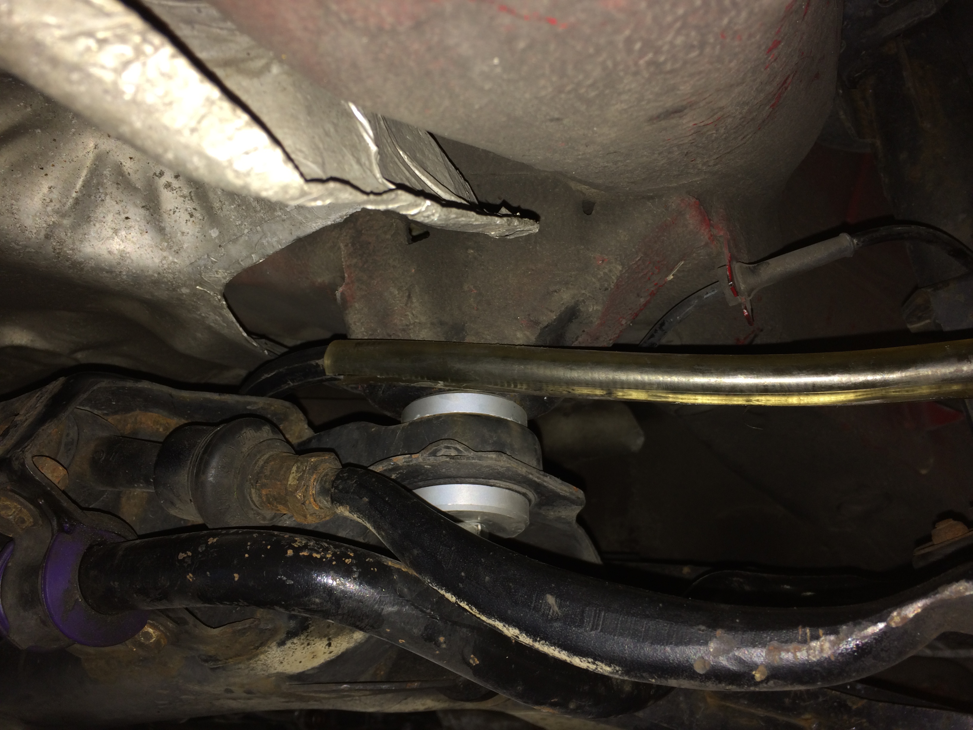

Cable routed Behind back end of subframe. Plastic tubing cut to fit over new parking brake cable for protection.
Another angle.
Another angle.
Adel clamp to hold cable to subframe on left side.
Adel clamp holding cable on right side.
And there you go. Questions? Comments? Criticisms?
