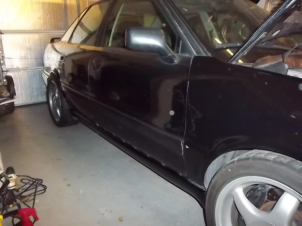

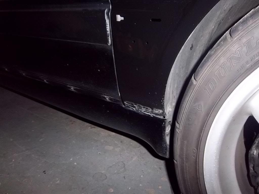

Took the lower trim off.
I'll have to fill these holes in on the front fender when I remove all the upper trim. Tips on filling holes like this?
Re: Darin's 80tq...more skirt developments...
Cut a piece of similar thickness metal the same shape and TIG in place. You can MIG but it's way more grinding and warping.
