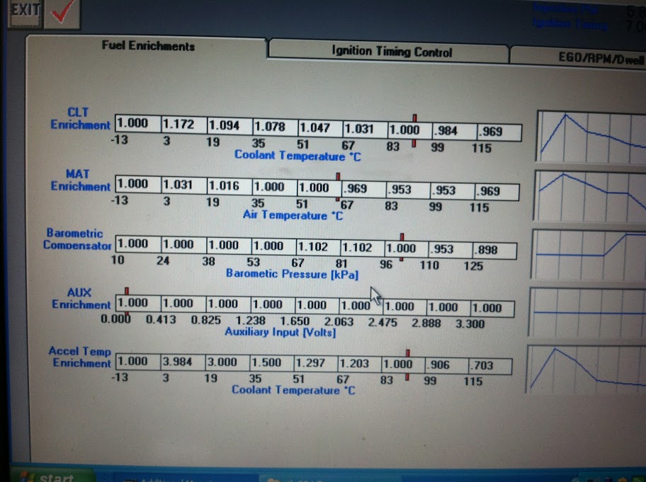

Hey all,
So I finally have the 'ol girl buttoned up mechanically. IC is installed and coolant system is reconnected and bled. Spent about 30 minutes today tinkering w/ the fueling table to get the car revving moderately cleanly without backfiring, etc.
At this point, I have a feeling the timing is still off a bit, as about the 3300 RPM level it starts backfiring like mad (think launch control). Makes me think my timing #s are set wrong.
Here are the timing tables in teh ECU... can you guys give them a look see and make sure I have everything set correctly? If not, what values should I be changing?
and here's a video (when it finishes loading) of the car revving. Don't mind the EGT readings, as the probe is shot. Haven't had a chance to order a new one yet.
[vimeo]vimeo.com/70373237[/vimeo]

Re: Help me get my 4000 Started! More Help Needed
I believe you will want to smooth out your "RPM ing. advance". I dont think thats your real problem here but that needs tweaking. What does the config table look like for the timing degrees? Where the spark actually fires, at what degree.
Rocket SLC wrote:I believe you will want to smooth out your "RPM ing. advance". I dont think thats your real problem here but that needs tweaking. What does the config table look like for the timing degrees? Where the spark actually fires, at what degree.
actually thats soft enough advance @ 3k to bog the motor.
needs to be closer to 30 degrees or so there.

Marc, not even going there, dude. Like I said, if I had known the frustrations I would have gone through with this setup, I would have been better off w/ the VEMS. I'd kill to be able to work w/ the ECU out of the car and not have to sit there futzing with it in the car, in the 100* garage.
Anyways, here are some more "screen shots" along w/ a log. Turns out that the timing was still ~6degrees off plus there was -10 degrees in the dashboard section (attribute that to when Hank and I messed with the distributor after we had it zero'd in before). So I zero'd that out and rechecked timing and adjusted accordingly in the CONFIG section (10 teeth w/ 10* offset).
and the fuel table:
When doing the pulls, off load I was able to rev until ~4k rpm w/o it breaking up. In first/second gear, as soon as I got near 3k rpm it started backfiring and bucking. Really think it's a timing issue, but I'm not sure at this point.
Input is appreciated as always!
and the fuel table:
Post up a pic of your Config settings for your timing as well as your dwell setpoints. I would like to see someone verify that the spark is set to happen at the correct degree points for a 5cyl on the config page.
Your ign% goes to 100% about the time you are at 3250rpm. What is your dwell like? Are you overloading your coil?
Are you able to get to WOT for a bit while you are logging?
Is it possible to tie in your wideband O2 to the O34 Ic ECU?
