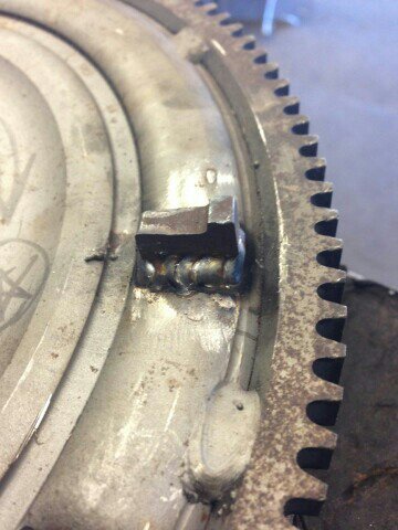

Re: A tale of Rubí... Crank Sensor Check w/Pics & Video
[youtube]http://www.youtube.com/watch?v=EwJBl_W0eYc[/youtube]
I think he's left the building
Should look like this

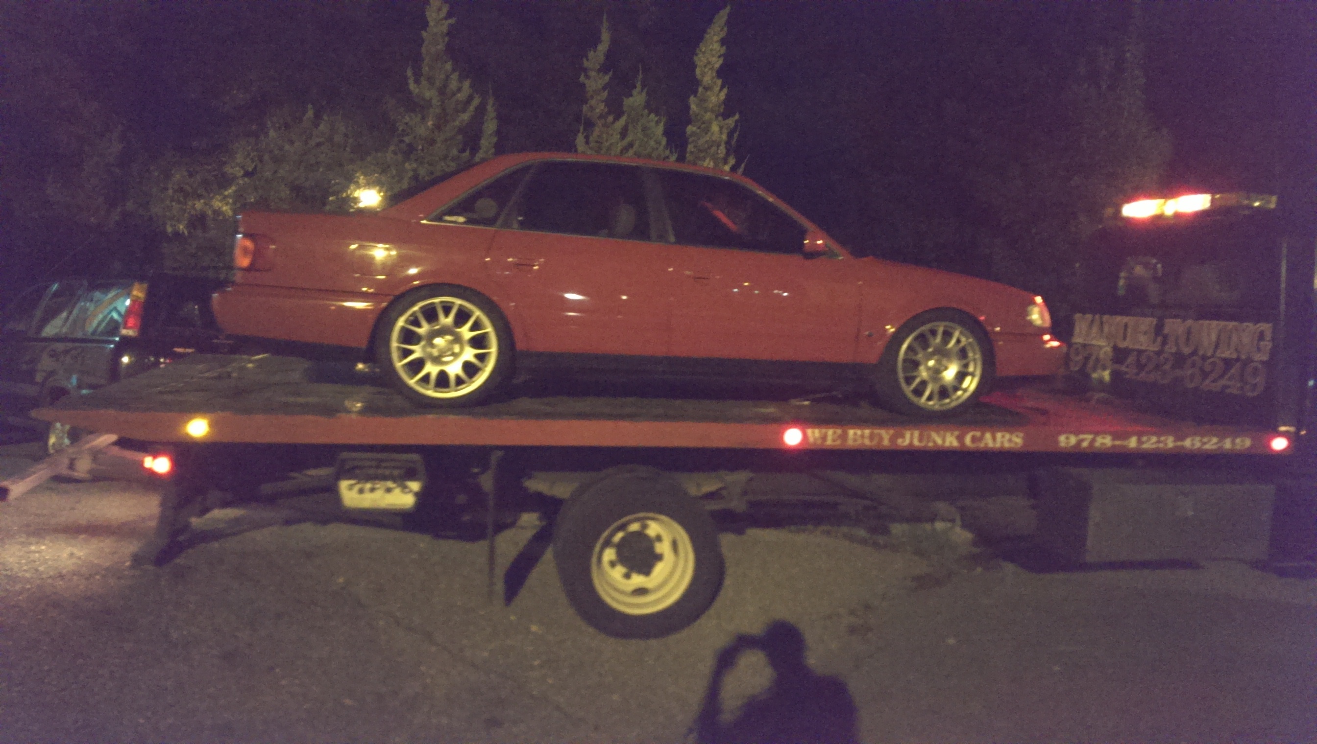

Re: A tale of Rubí... Late night transport...
Ruh roh
This better stay on...
Sent from my HTC One using Tapatalk 4
Good news is that the clutch disc was installed correctly as it really can only be placed 1 way as opposed to the info I was lead to believe...
The culprit was the missing 2 bolts on the oil pan...
these 2
This clamp fought the whole way out
Found the identical replacement locally
Everything nice and dry/clean, I'm gonna reuse the sensors as it could easily be swapped out later, but they measure perfect as is...

Re: A tale of Rubí... Back In Business...
So in retrospect a couple of myths have been rectified...
1) A SouthBend Clutch in a UrS Car can only fit one way. There is "apparently" a 1,000 mile break-in period on Full Faced clutches (I've always done 500 miles and only did 250 when I did this clutch with the banged up flywheel and had ZERO slip). While pucked clutches "apparently" only have 0-100 mile break-in...
2) A missing Flywheel Trigger PIN will prevent VEMS from recording BOTH Primary and Secondary events when recording a trigger log (can be due to the older version of VEMS I'm running)
3) A sensor if tests out perfect and the wiring is good to and from the ecu, trust it... Example, Just cuz a sensors appears to be bad Image it doesn't mean it is... apparently they can take a beating... we'll see later on if it causes errors once it gets tuned...

A clutch disk can be installed backwards. On a "UrS-fitment" style disk, the disk will slide on the splines either way, but one side of the disk protrudes so it makes it pretty obvious. On a 7A style clutch disk, the disk is symmetrical and can easily be installed backwards. Which is why the disks are usually marked "flywheel side" or "pressure plate side".
mushasho wrote:3) Just cuz a sensors appears to be bad Image it doesn't mean it is... apparently they can take a beating...
That is just a metal cover on the actual sensor - magnet protrudes from the center under the cover...they're pretty hard to actually break.
