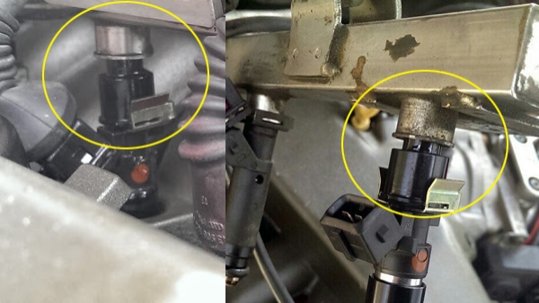

It does NOT appear that those injectors are tall enough to safely run with the OE rail. The o-rings look like they're barely into the cups in the fuel rail, they should be seated all the way at the top of that cup.

This here is fully seated and is as seated to the top of the cup as possible...
The only remedy seems to be better sized hats or o-rings... The slippery slope could also mandate an aftermarket rail that might fit lower than the stock one... or could just be install error on my part (my bets are on that)

Yes, that photo is fully seated, however the photo above with the rail installed is NOT fully seated. The injectors are shorter than OE injectors, it is a common problem. Once they are fully seated into the intake manifold, they pull out of the rail. A properly fitted fuel rail is the best solution, but in the meantime, you can:
-Cut the mounting tabs off of your fuel rail and weld them back on in the correct location
-Or, modify the seats for the mounting tabs on the intake manifold so the rail sits lower

I did something minor along these lines,... I bent the mounting tabs a bit as to have them create a bit more down force once I bolt it down... we'll see how it holds, I guess...EDIGREG wrote: -Or, modify the seats for the mounting tabs on the intake manifold so the rail sits lower

FWIW, my FIC2150's are not the same as stock height. Mine were not as bad as OB's appear from these photos, and I never had one pop out or leak, but they could move enough that it definitely made me uncomfortable running them with the stock rail. You could grab the middle of the injector where the hat meets the first o-ring and "bend" the injector side to side. Now with the custom rail they are solidly bolted down, no chance for movement at all.

Ed, where do you see a mismatch in height? Looks to me that the o-rings are in exactly the same place as that Siemens 630, and they are designed as such. The discrepancy is the shoulder on the top hat which allows the o-ring to slide down further in the event that it comes unseated from the groove in the hat. The updated hat will place a shoulder just under the o-ring so it acts just like that Siemens 630.

The photo above doesn't show any concrete information regarding the length of the injectors. Not only is the photo taken at an angle where perspective comes into play significantly, but the cap is on one end of the FID injector and there is no telling if that injector is fully compressed, meaning the injector body is fully seated into both the top and bottom hats.loxxrider wrote:Ed, where do you see a mismatch in height? Looks to me that the o-rings are in exactly the same place as that Siemens 630, and they are designed as such. The discrepancy is the shoulder on the top hat which allows the o-ring to slide down further in the event that it comes unseated from the groove in the hat. The updated hat will place a shoulder just under the o-ring so it acts just like that Siemens 630.
I also had no issues with the Siemens 630 injectors in a stock fuel rail, so theoretically these *should* also be fine if they are indeed the same height. But even if that is the case, then both injectors are shorter than the stock injectors. Not to mention these are 3-piece injectors so they can bend/flex, effectively becoming shorter and increasing the chance of the o-ring slipping. It's very clear in the photo below that the o-ring is barely inserted into the OE rail.
Making the modification to the hats you mentioned above certainly won't hurt, but that is not the root of the problem here. The o-ring coming out of that groove is due to either 1) being installed incorrectly, or more likely 2) the fact that the o-ring is not fully compressed because it is not inserted far enough into the cup (or, a combination of both). If you truly want to have these injectors fit in an OE Audi fuel rail, the top hat should be modified to make the injector the same length as the OE unit. I could pop one out of my s6 if you need a measurement, but it would be easier if someone has a spare stock injector on the bench.
There are other variables as well, such as if the plastic injector insert is fully threaded/seated into the intake manifold.

Compare the photo below of before/after the injectors are inserted into the intake manifold. The injector appears to be fully seated into the rail at first, but once it is seated into the IM it slides down, moving the o-ring dangerously close to the tapered/chamfered edge of the cup on the rail.
Even if these are the same height as the Siemens 630, the issue is not evident on those injectors because they have a clip which prevents them from backing out of the fuel rail. (Even then, not ideal because that prevents the injector from being fully seated into the IM - potentially effecting the path of the spray)
