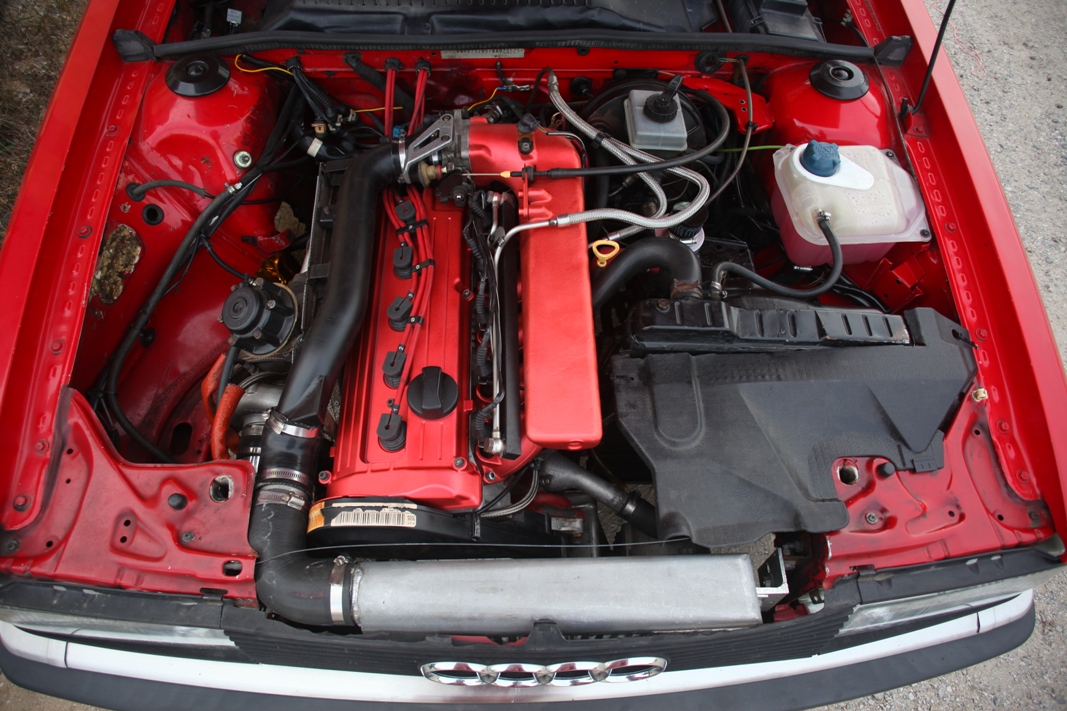

Real camera engine bay shot:
As per the attached image, you can see that I moved the catch can closer to the block (it's under the stainless braided fuel lines). Bad idea. I definitely have way more oil shooting out there. So I got all concerned and did a compression test, 160+ across the board, #4 and #5 were slightly higher at 162ish and 165ish. The gauge was pretty inaccurate. I didn't have the throttle open, didn't think about that at the time. Anyway, I'm happy enough with those compression numbers and I'm sure it's just that there is a ton of pressure down in the CC and it's pushing oil up into the catch can, especially around corners. I've said this many times before.
Anyway, I need to change this setup. I just posted in Casey's thread and I'm thinking of doing something along those lines. I'd like 2 vents on the valve cover and the block vent to go up into the valve cover as well.
I'd like barbed fittings, what is the easiest way to get them into/onto the valve cover? Threaded? I am having a hard time finding big enough AN 90* fittings... frustrating. If I had the patience to go through Hank's thread I would, but that's a task and a half.

Put a good sized vent on the valve cover and move your catch can to the passenger side of the engine bay. It's getting filled with slosh right now, and the U-turn everything has to make to get to the other side does a hell of a good job keeping the slosh at bay.
Sam Stone
Re: 4 FOX SNAKES - fvking crank case ventilation
SEStone wrote:Put a good sized vent on the valve cover and move your catch can to the passenger side of the engine bay. It's getting filled with slosh right now, and the U-turn everything has to make to get to the other side does a hell of a good job keeping the slosh at bay.
^^^THIS
pass side CC location helps A TON!!
Okay so should I still put the valve cover vents on/pointing to the driver's side then? And loop them back? Or do my original plan but with the cc on the passenger side and the vents pointing to it?
Also... If the block breather just goes into the valve cover why do I need to put the cc on the passenger side? Wouldn't that only be If I was keeping the block breather as the only vent into the cc?
Okay! I finished what I think should be the final iteration of the pcv system. I upsized the drain to 1/2" id as well. So far so good, nothing but vapors coming out but I haven't given it a go through in the twisties yet.
Definitely a much better spot. Mine was all the way in the passenger fender up by the washer fluid bottle. The hose to it went up high though, and that's what really matters if you don't have a drain on it (like mine).
Saweet! Seems to not throw oil anymore! The only problem is that I got a serious offer on the car. Ugh my emotions
