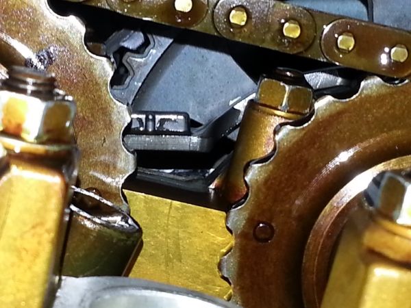

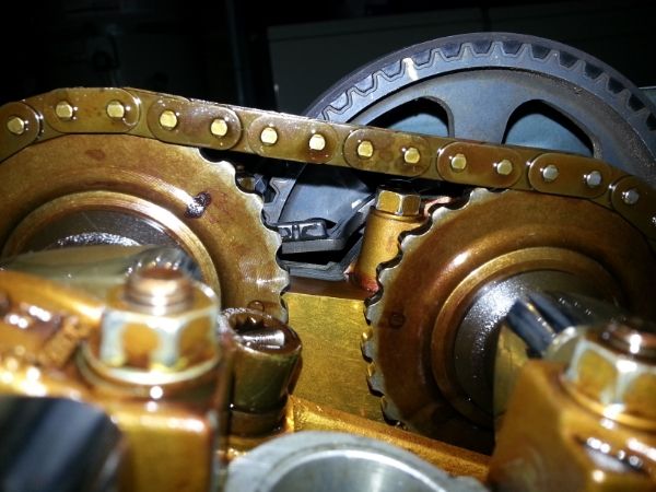

So after pressure testing the system for the millionth time and finding nothing, I proceeded to set TDC and pull the valve cover. I set TDC according to bell housing window with "0" on flywheel. I set it dead nuts in the middle of the groove as it should be. I couldn't get a camera down there lol So her are some pictures of my other marks. The cam gear to valve mark seems ok. The cam marks are the ones Im unsure about. The intake looks slightly off. I couldn't get the camera flat with deck. Let me know what you guys think. thanks

Re: Timing marks...
Those cams don't look quite like they should. Might be a tooth off somewhere
