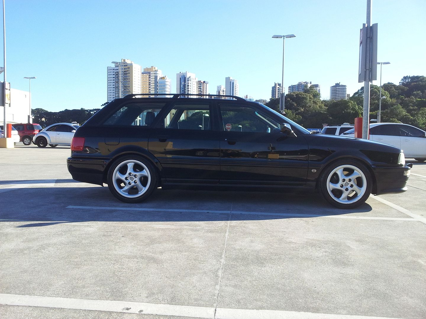

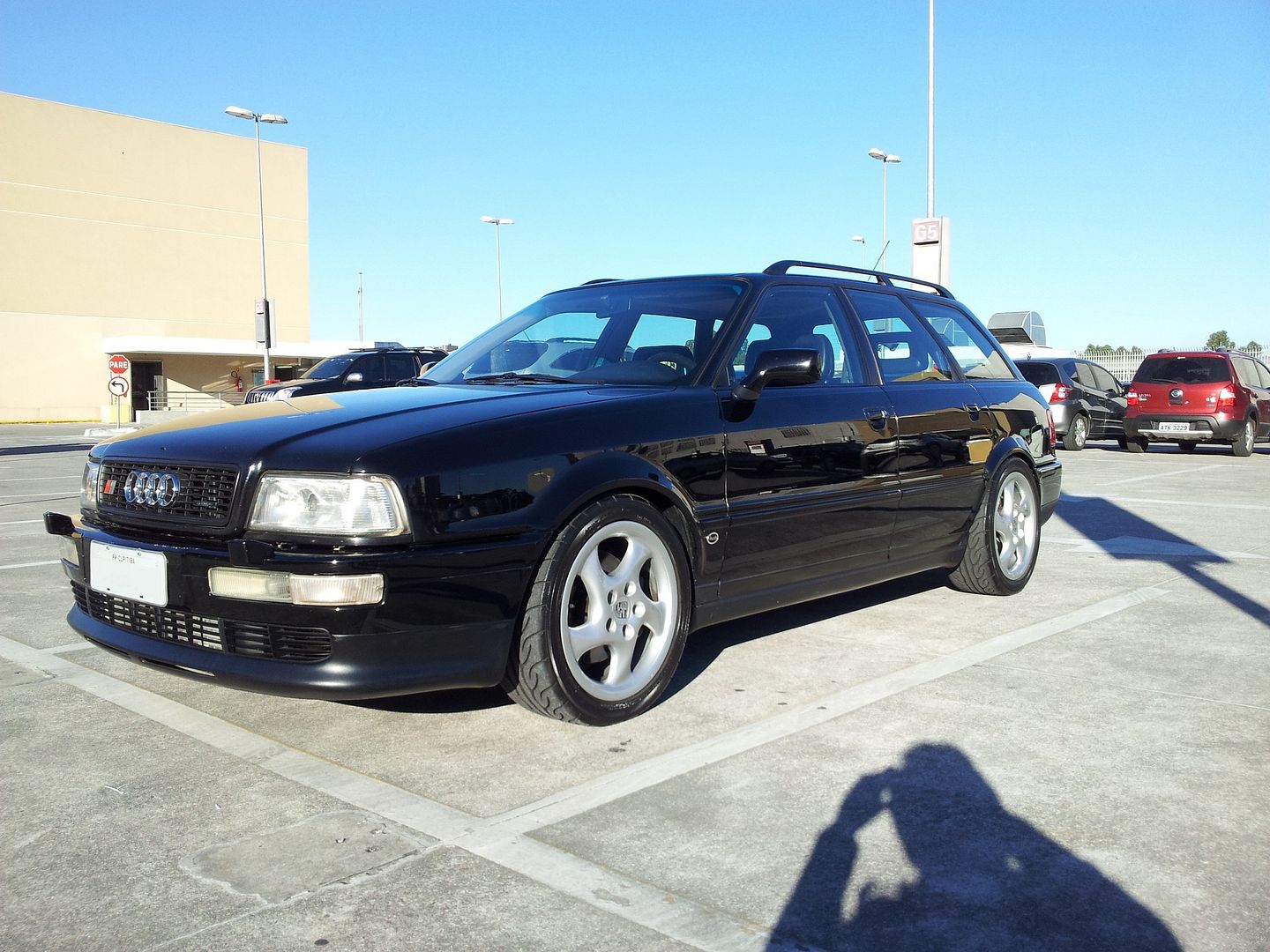

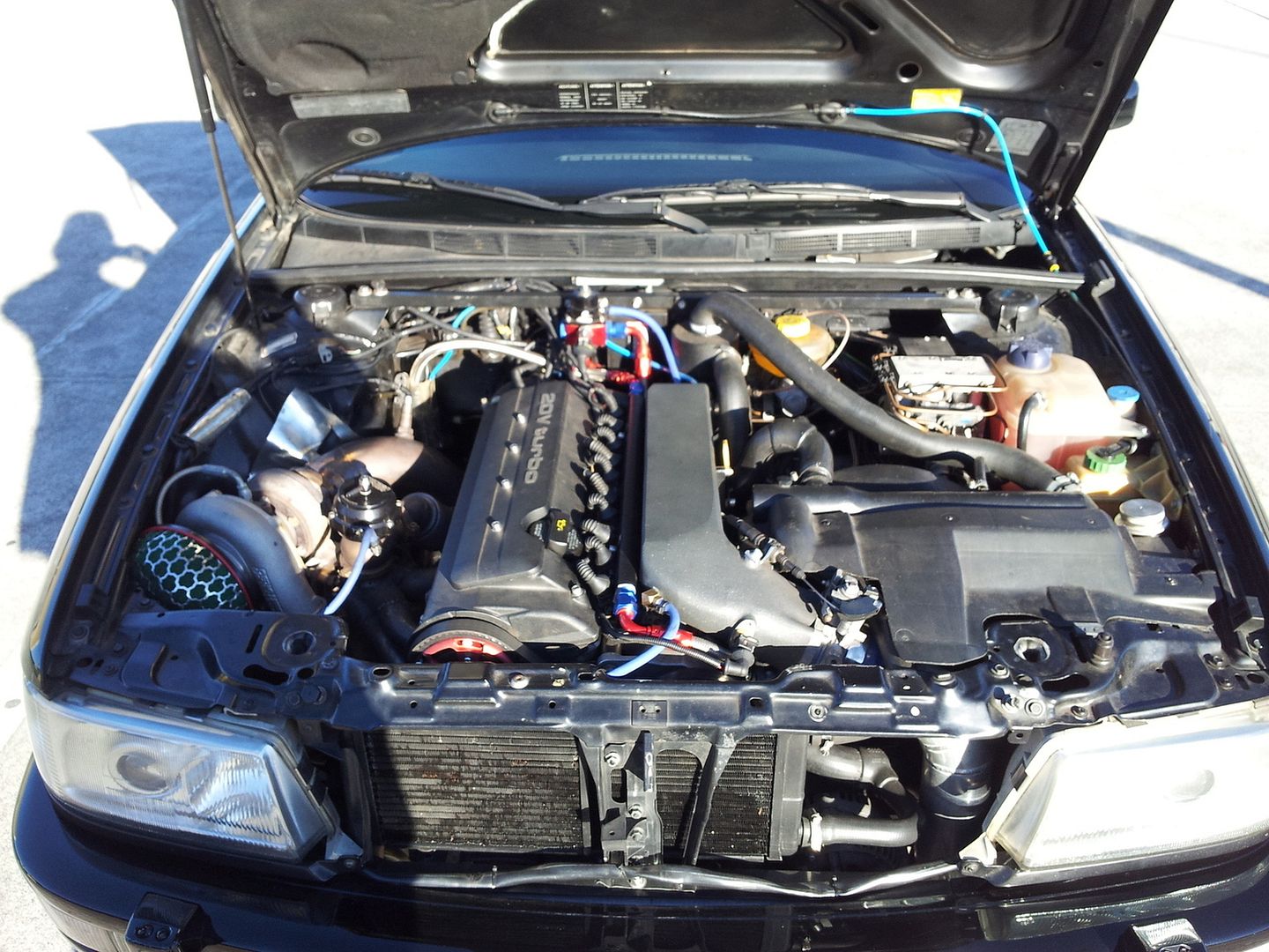

I will also use the opportunity to introduce myself. I am from Brazil and currently own a 94 Audi S2 Avant. I'm currently building her in a 900+ hp project, got a brand new GTX4202R 72mm turbocharger sitting aside just waiting for my header.
Car setup:

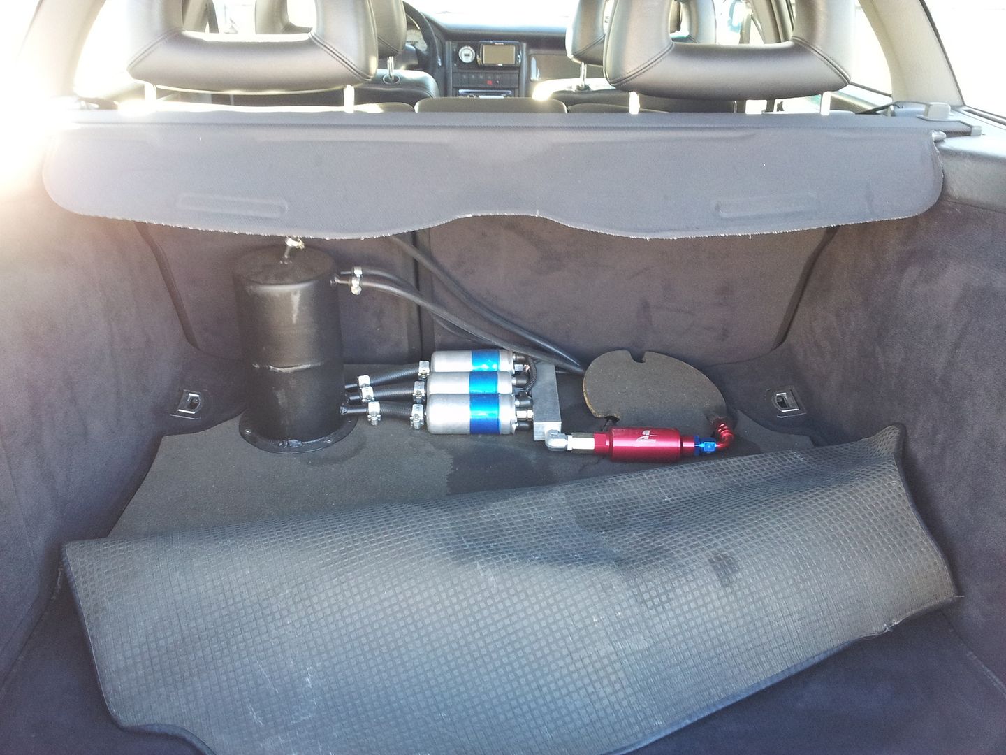

Injection
Fueltech FT-400 Fully Programmable Injection with Color/Touchscreen Interface.
10 fuel injectors (5low 80lb + 5high 160lb)
5L catch-tank w/ 3 DPL pumps
Car runs on E100 streep pump ethanol, we don't have E85 here in Brazil, our Ethanol is mixed only with water (around 4% water).
Engine
82.5mm 8,5:1 JE pistons w/thermal treatment and teflon sidewalls, I.E. rods, ARP studs, O-rings. Stock crank. Looking forward on more upgrades (stronger ligher rods, dry-sump setup, block-guard).
Head has been worked on for increased flow. Stock cam on exhaust, slightly more agressive on intake (don`t have the numbers here). Upgrades on valves, retainers, lifters and springs, still using hydraulic cam. Revving up to 8000rpm. Looking forward to head upgrades soon.
Turbo
I originally used it with a Precision 6765 sleeve bearing, runs on about 20lbs in low-boost setup and 30-45lbs in high-boost setup. Stainless tubuluar manifold and PTE 46mm wastegate. That turbo blew up so I purchased a slightly smaller Master Power 6465, which runs on similar boost levels (but does not produce as much power). Next up is the GTX4202R, the header I ordered with Hank should have a integrated quick spool valve, which will allow me to use this turbo with a 1.28 hot side. Just waiting on some news about it... :bangshead:
4"downpipe and full 3.5" stainless catless exaust with two direct mufflers.
Custom-built front intercooler, 3" aluminum intake pipes.
Transmission
Stock 6-gear, revised syuncros and bearings.
Tilton OST-II 7.25 twin-disc cerametallic clutch w/034motorsport aluminum flywheel
Adjustable shocks w/ H&R springs
Toyota Hilux SW4 Twin-Piston brakes up front, stock at back.
Unfortunateley the closest 4x4 dyno is 250miles away, so that means no dyno graph for now. Also, the car has never measured the 402mts in the latest setup (the car did measure 201mts, but that was in previous setup wich used a K27 turbine, stock head, less boost, and obviously much less hp).
