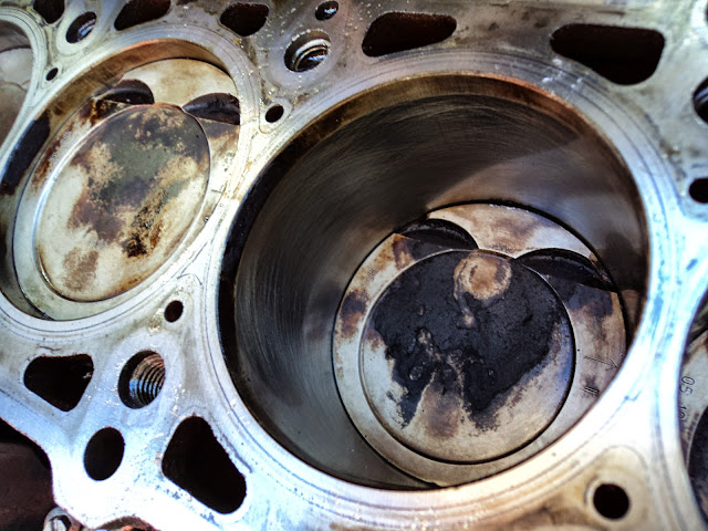

Number 5...
Cross hatch still visible
Day Pics
[imghttps://lh3.googleusercontent.com/-NQHLGHisyYU/VBxJrfROxMI/AAAAAAAAxSU/2_08_cX8ED4/s800-Ic42/IMAG2499.jpg[/img]

what about the exhaust valves on #5 El? any damages from the spark plugs tip?
Re: Rubi - Many Pics...
Yup that be detonation. Is that just aluminum buildup on the cylinder wall or is it eaten away too? I can't really tell from the pics. When we looked at my plugs on the dyno we decided to add a little bit more fuel to cylinder 5. But different intake manifold...
