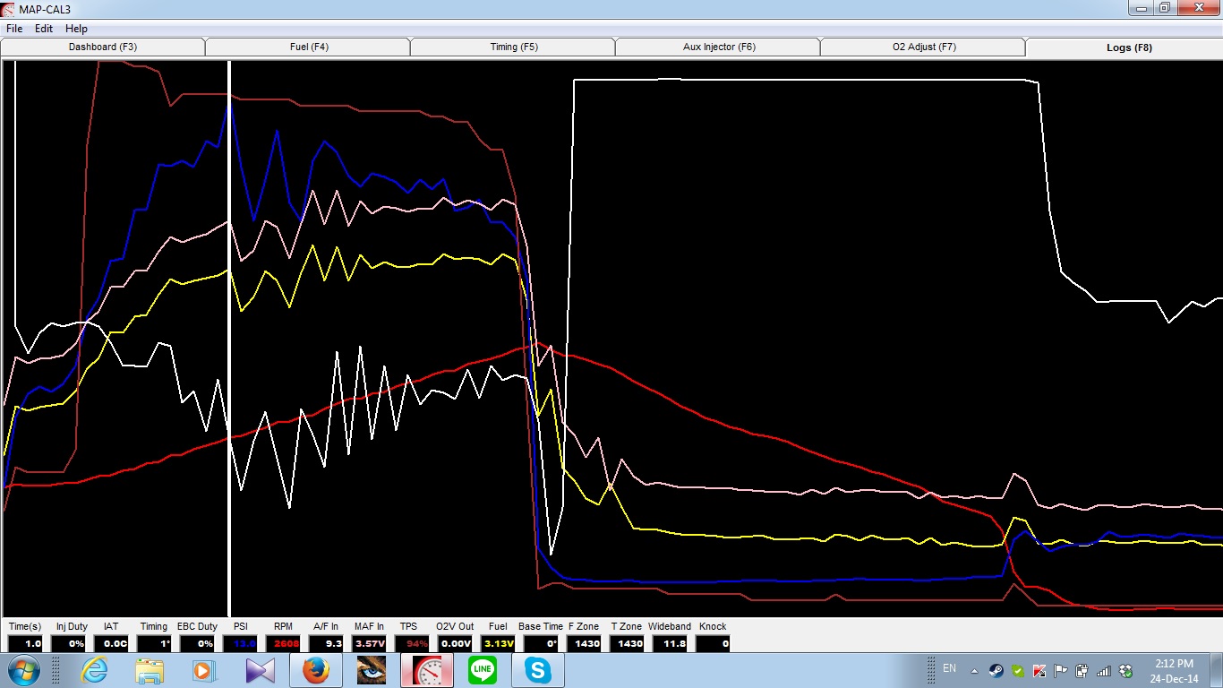

I have some weird boost spiking happening when pressing hard in 3rd to 5th gear. I am currently running intercept mode on MAF signal and timing. Not controlling boost at this time with the piggyback.
If you will look at the screen shot of one of my logs you will see:
WB AFR in white
MAP in blue
MAF voltage signal in teal
MAF output to ECU in yellow
TPS in light brown
RPM in red
As you can see, MAP is very erratic. Up and down like a saw tooth. Correspondingly, the MAF signal goes crazy. I see a peak boost of 13psi in this log. Since I am stock boost level, it should not go over 8. Luckily, I have plenty of fuel.

This might be interesting, since the AEB does not regulate the N75 duty cycle according to boost, because it has no MAP sensor. It uses the MAF. So, if you scaled the MAF down for your injectors and E85 with your piggyback, the ECU will ask for more duty cycle from the N75 in order to achieve the target airflow.
It doesn't explain the oscillations, but does explain why the boost is higher.
Cheers, Brady

bradyzq wrote:This might be interesting, since the AEB does not regulate the N75 duty cycle according to boost, because it has no MAP sensor. It uses the MAF. So, if you scaled the MAF down for your injectors and E85 with your piggyback, the ECU will ask for more duty cycle from the N75 in order to achieve the target airflow.
Hmm, interesting.
Its one of those chicken and egg situations. Is the MAF signal oscillating because of the increased "suction" from the turbo, or is it because of what you said?
It behaves well if gently going to WOT.
Someone else suggested the wastegate diaphragm or the pivot sleeve could be worn out.

I've tried to make the MAF signal reduction less to see if this has any effect. So far, inconclusive.
It did richen up the AFR in boost.
Could be that it is hardware related. Bad, WGFV and/or diaphragm. Will make some more logs to see what is happening.
No fault codes from stock ECU, except limit adaption errors, but that is likely caused by the ECU not being able to trim the overly rich fuel levels sometimes.
