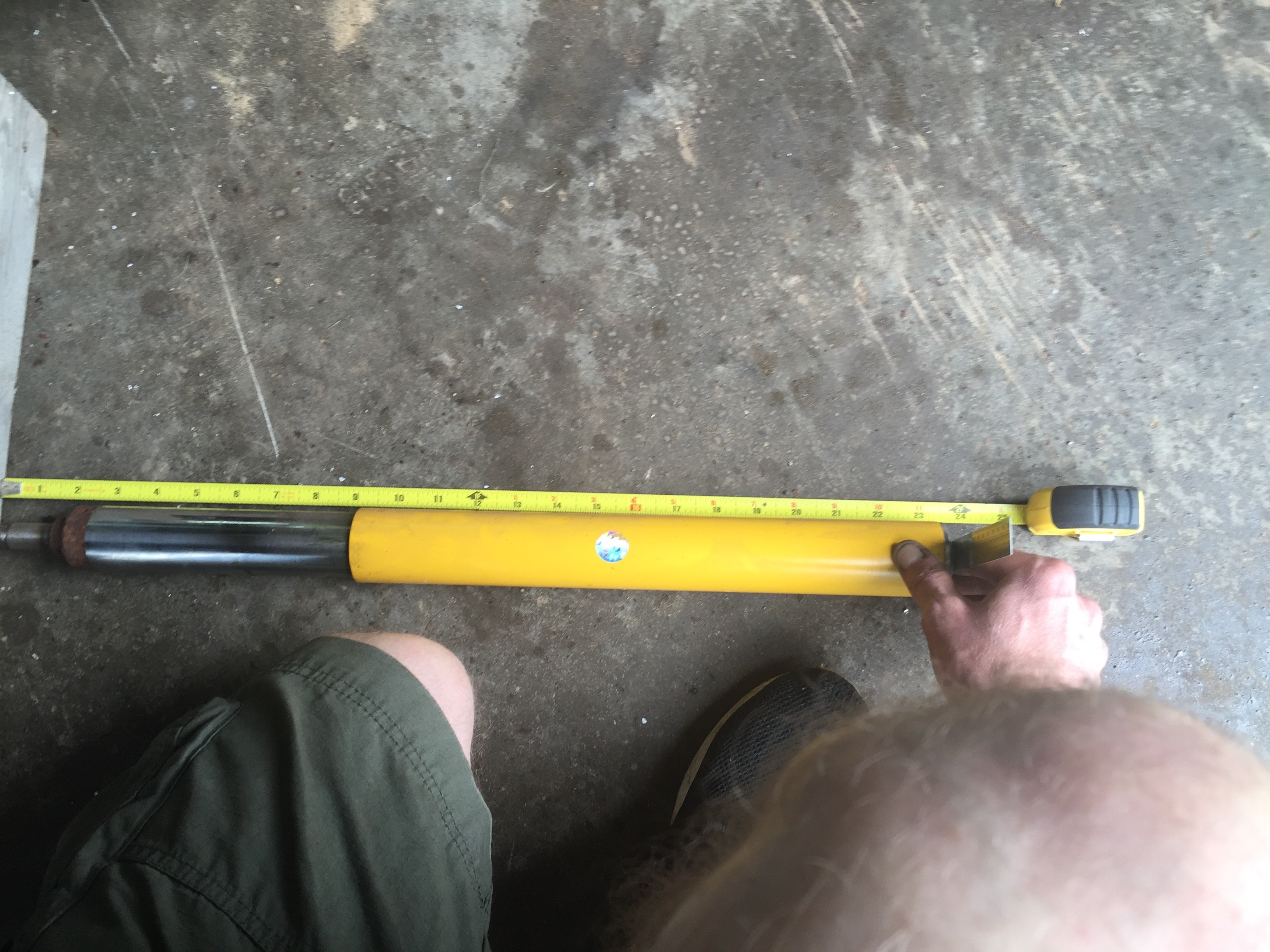

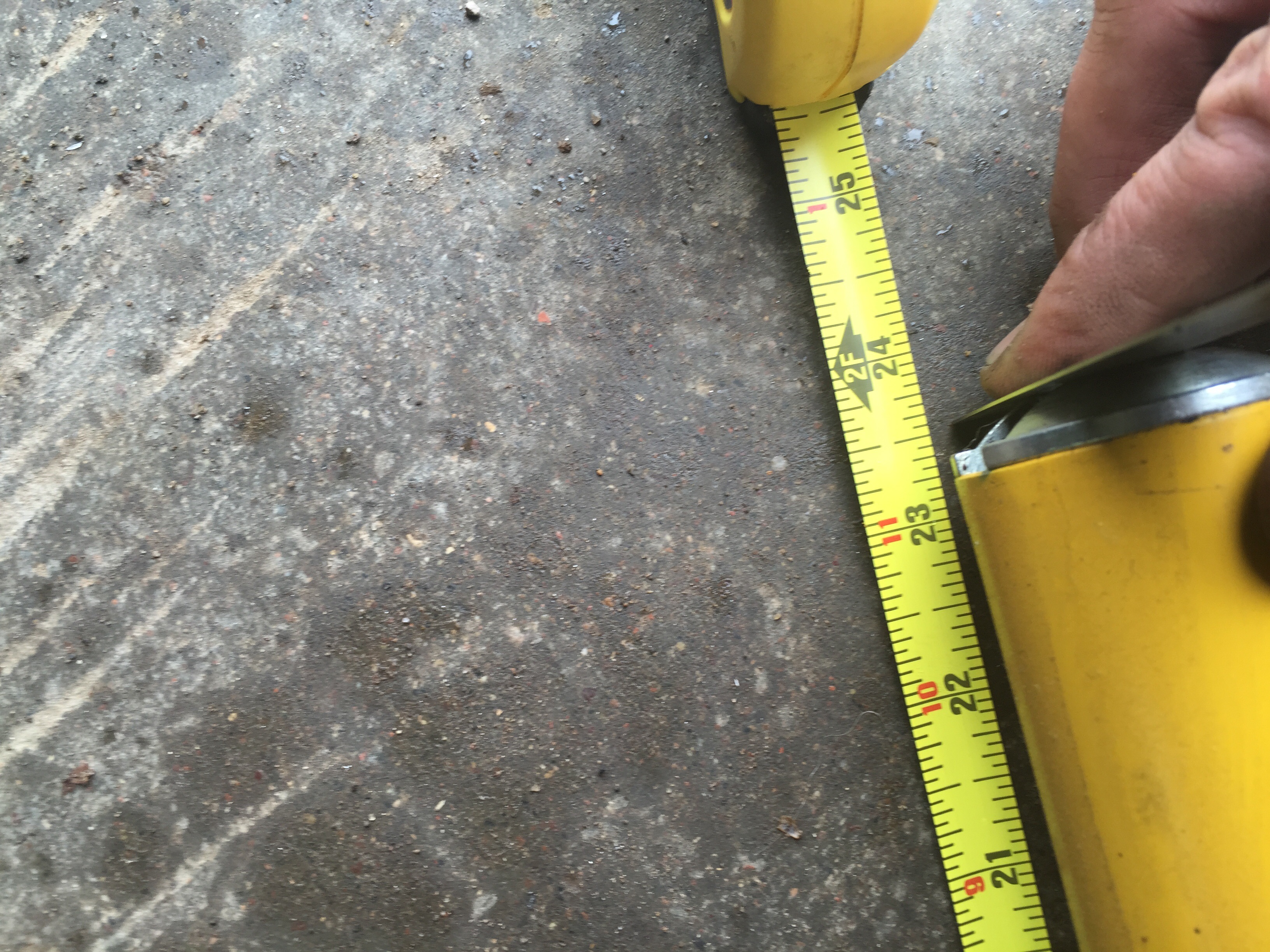

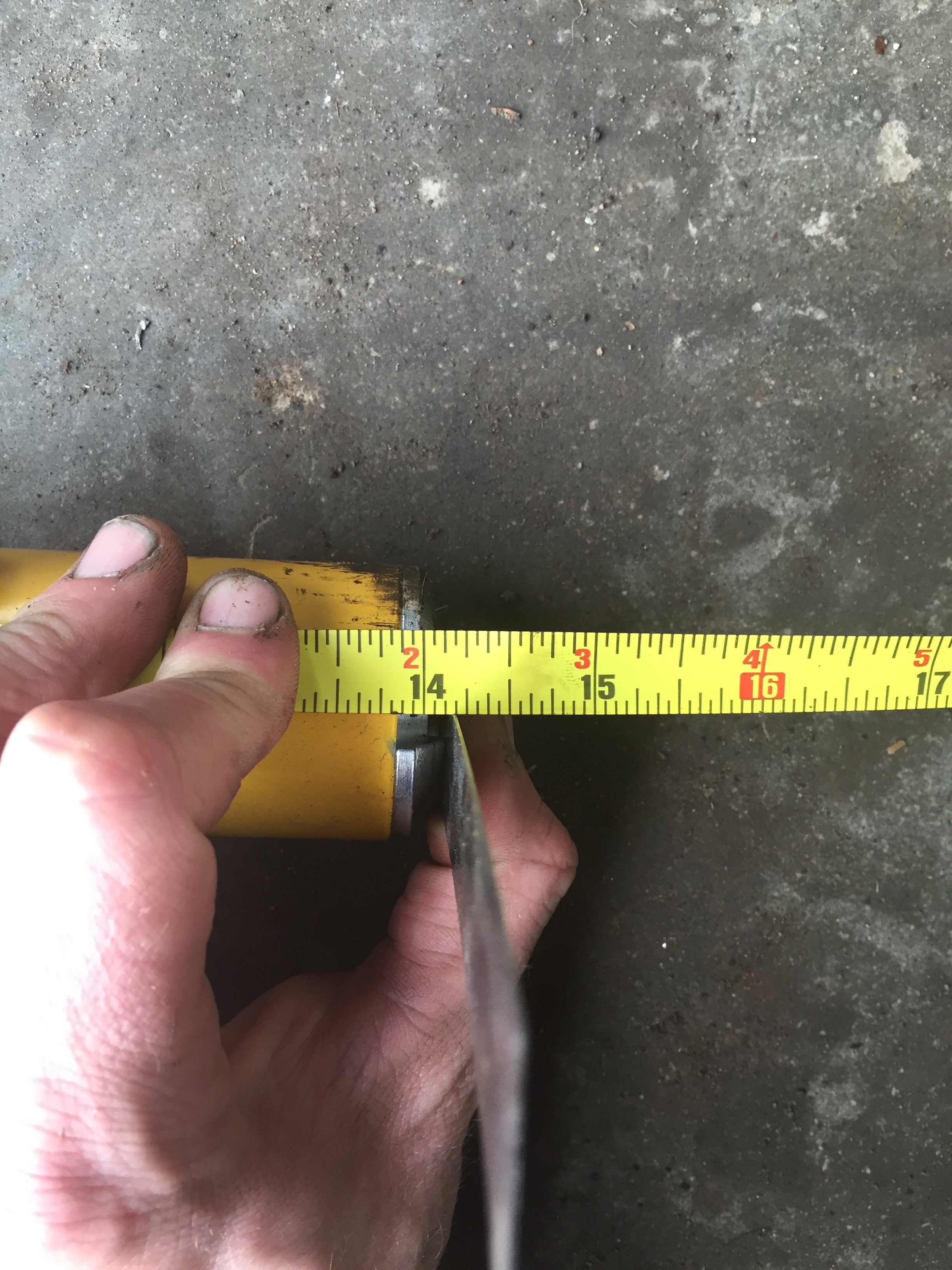

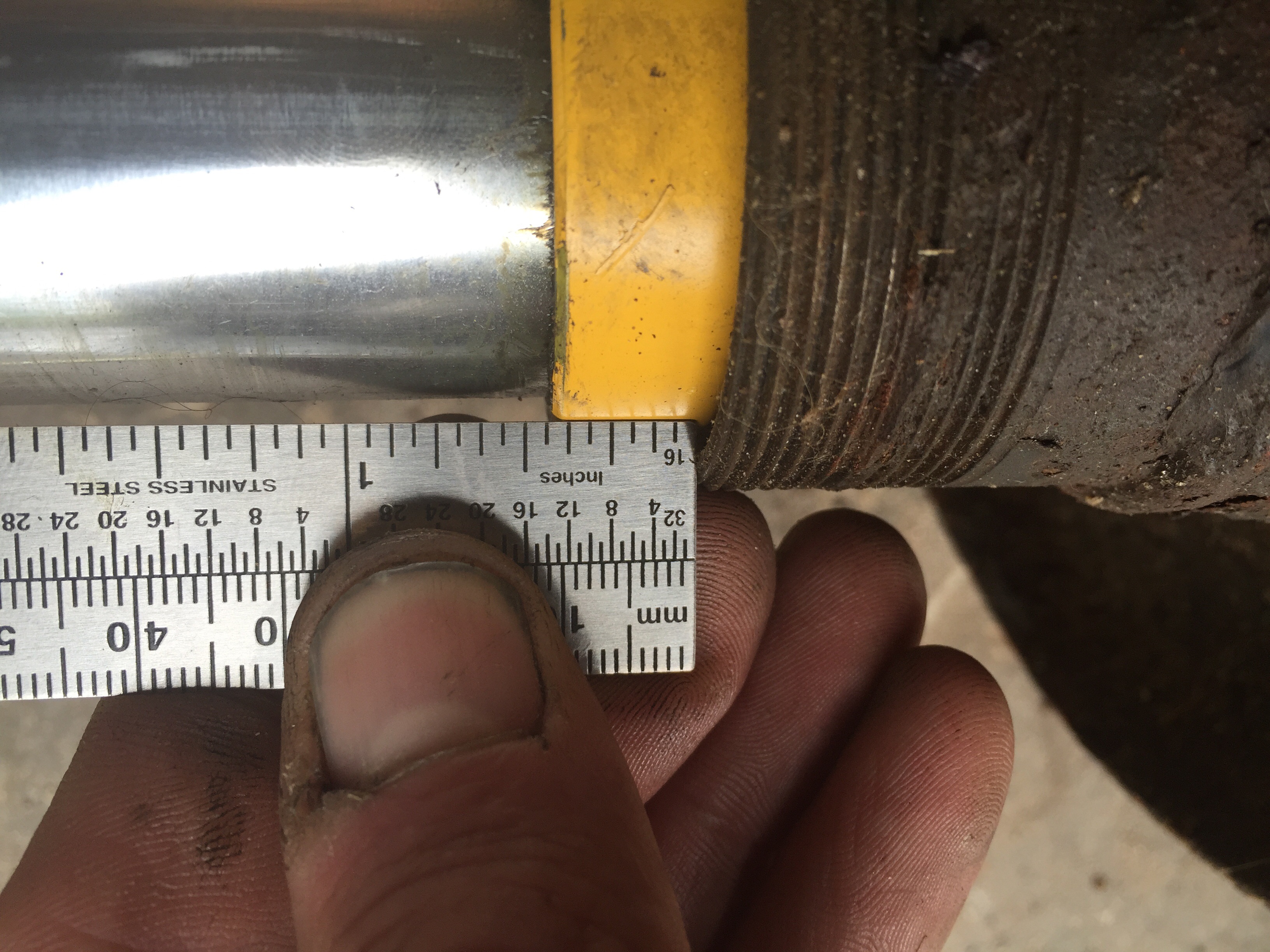

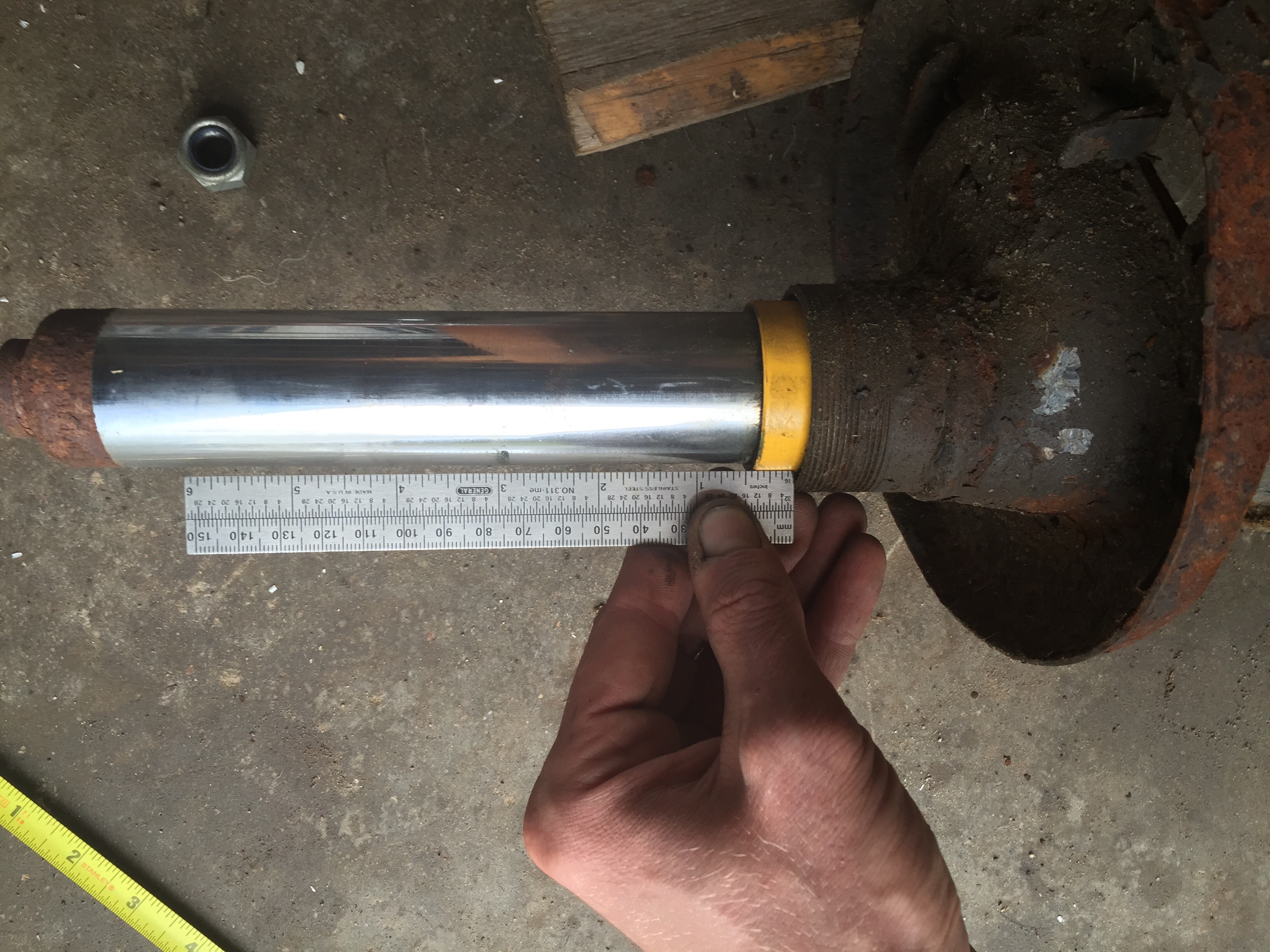

I don't have a loose B3 strut at the moment. I imagine you've got one or two kicking being as you've got a set a nekkid housings.
- Shock tube bottomed out...
- image.jpg (1.75 MiB) Viewed 34970 times
- Shock tube bottomed out in housing.
- image.jpg (2 MiB) Viewed 34970 times
- Shock tube length
- image.jpg (1.7 MiB) Viewed 34970 times
- Total length from pin.
- image.jpg (2.23 MiB) Viewed 34970 times
- Total length, from the pin.
- image.jpg (1.78 MiB) Viewed 34970 times
Re: BBSE question
Is that a UrS housing you are showing it stick out 7/16" from?
Re: BBSE question
Yes it is. I put that up because I couldn't find an accurate way to portray through the interwebs, the depth of the cap that screws on. Figured just showing you what sticks out would work easiest.

OK, look like I have to measuring, and comparing to do. As luck would have it, I have a trashed(new) b3 bilstein port front insert. This should work well.
Will let you know what I do.e up with.
Re: BBSE question
So, here's something kind of interesting. The body of the B3 bilstein is 1/8" longer, but sticks out of the strut housing 1/8" less. So, to make this work correctly, I need to make the over all housings length 1/4" shorter. Hmm... I'll see what I can figure out.
