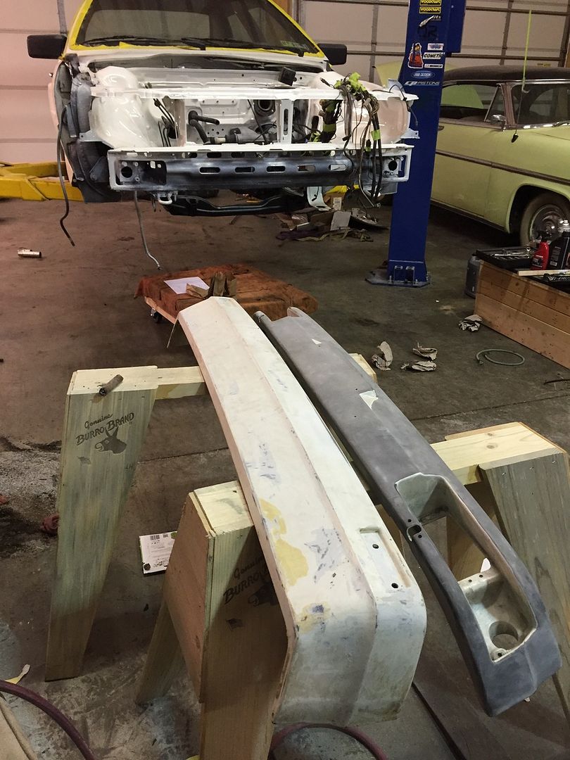

After a long hiatus time to get back to work. I have got a few other projects wrapped up and out of the way and hopefully will be able to devote at least a little time to this car. I'm in no hurry to finish the project but I need to be making progress.
Started sanding the front and rear bumper inserts. These are the last few things I need to sand and paint.
Have around 3 hours into these. Discovered my new Dewalt Palm sander sucks
At this point the bumpers are completely sanded, used adhesion promoter then primed in 4:1 high build primer. I will find some time this week to sand them and get them sprayed.
The fenders are prepped, primed, sanded and ready for color.

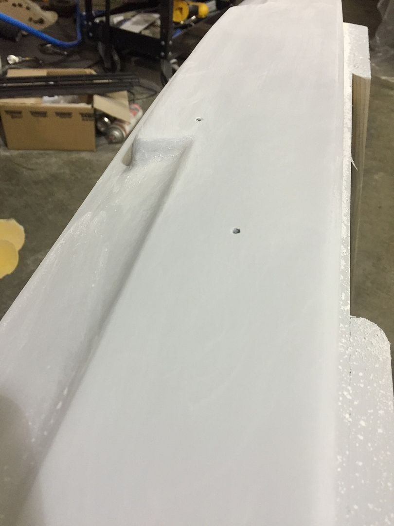

Got a little bit of sanding done before work today. Sanding the primed bumpers with 320 just to knock them down smooth. Have one about 1/2 done will finish that one and get the other tomorrow morning.

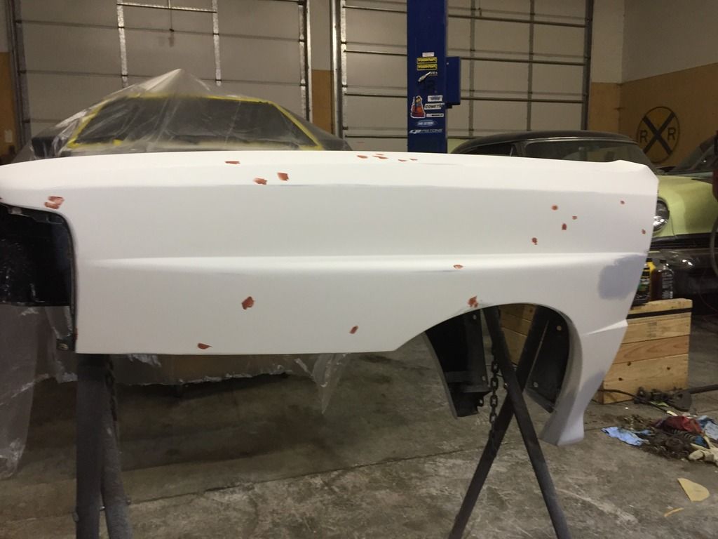

2nd to last stage of prep before painting last night.
Few small areas of spot putty to sand, wipe down and I will be ready to spray the bumpers and fenders.
