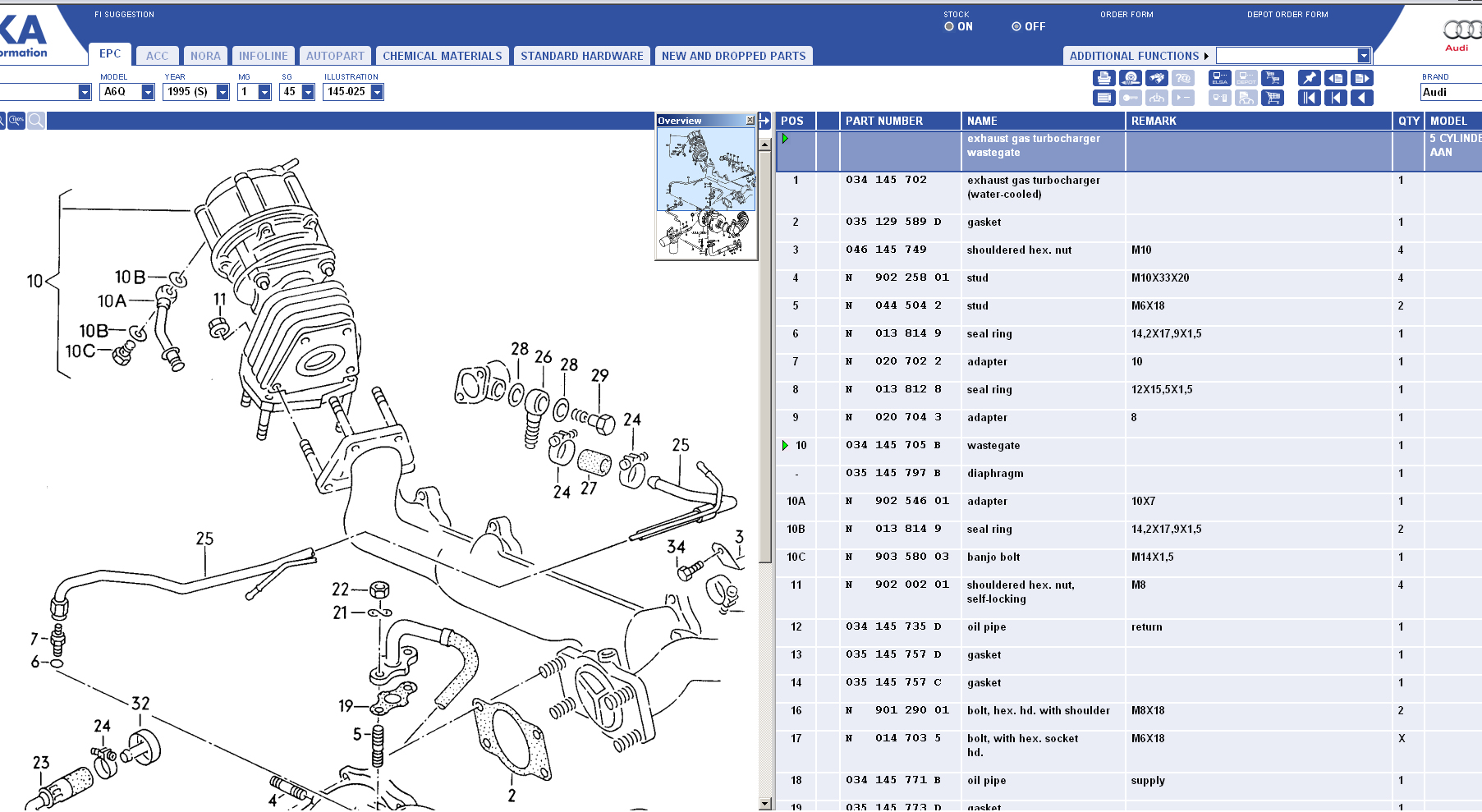

Why can't I find a part number for the wastegate to manifold gasket? Did it ever exist?
I have the copper spray gasket, so I can use that...
Also, I was told NOT to use a gasket between the turbo (GT2871) and the (T3) manifold .....
What about the outlet of the turbo to downpipe gasket (5 bolt T25)?

originally, there is none

Yeah... i saw that too... how does it seal??
Re: wastegate to manifold gasket?
Two flat surfaces is all that is needed for a good seal. Flat being the key word. Really flat. I don't use gaskets on any hotside stuff.
