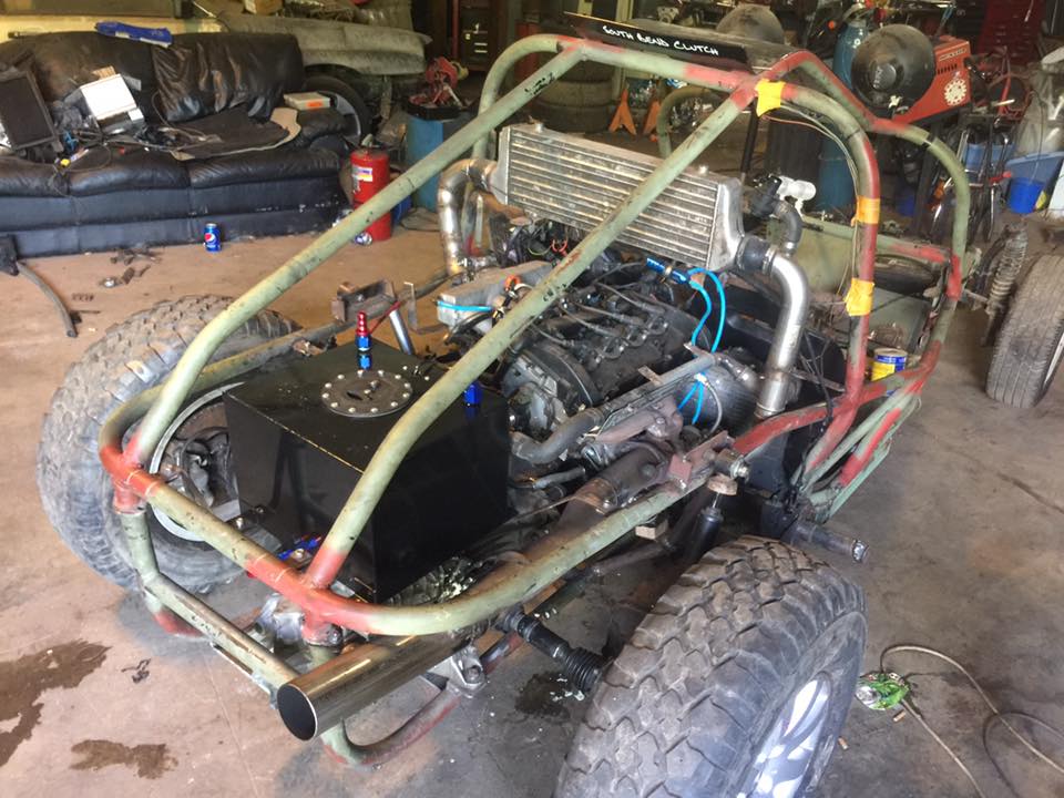

I started this project a little over a year after being inspired by a buggy me and a friend built that was converted to run on a 2.0 ABA engine and digifant 1 engine management. The one i built is a bit more elaborate than that one but i wanted to use a 1.8T for more power and the old aircooled transmissions fall short on holding such power and abuse without dumping a ton of money into them. This is my mid engine 1.8T buggy. i will have better pictures posted up eventually.
Its a normal 70's/80's california style buggy chassis that was originally based on using all OG beetle parts. i have since modernized most of it with common and readily available VW/audi parts. it still retains the original beetle front suspension and steering box along with the beetle rear torsen beam. it has custom made swing arms in the rear for the mid engine setup. the arms where original beetle IRS arms with a box arm kit installed on them.
The engine is literally built out of the junk pile in my garage. its running an 03 audi A4 1.8T bottom end with a head from an 02 jetta engine. it has stock turbo/manifold but the manifold is modified to use a tial 38mm external wastegate with 15psi base spring. its running a stock AEB intake with MK3 0BD1 throttle body. on the fueling it has an 8 gallon ebay fuel cell, ebay bosch 044 knock off, 4bar FPR and stock AAN 20V injectors. the transmission is stock from a 1999 VW passat 1.8T with a southbend stage 2 endurance clutch set including single mass flywheel. axles are modified late audi A4 front axles with tripod joint inners and 100mm outer CV's from MK3 VW. custom machined adapters allow the 100mm CV to bolt to the original 90mm CV stub axle. the stub axles and outer hubs are modified with custom machined parts so that the rear is now 5x112 bolt pattern for using modern VW/audi wheels. the brakes are URS4/URS6 rotors and G60 dual piston calipers on custom made caliper brackets. for stopping and clutch i have an OG neal pedal set from the 80's that was NOS along with an empi throttle pedal. the throttle cable is a PTO cable from an international tow truck as well. the cooling system for the engine uses a radiator from an XJ jeep cherokee, fan is from a W123 mercedes benz, thermal switch is from a URS4, and all radiator hoses are custom made. the fuel management system is digifant 1 from a 1990 corrado G60 that uses a 250kpa MAP sensor from a URS4 ECU with a custom made harness to fit the buggy specifically. for the ignition system it uses a custom made distributor that drives off the intake cam where the original cam position sensor was. for plug wires it has old school NGP high output 16V plug wires with custom 3D printed covers to go over the coil holes in the valve cover so no water gets in there. over all im sure there is plenty more im forgetting lol.
Over all its running at 15psi but can run 20psi max before the limit of the MAP sensor is met. it is scary fast at 15psi although i have had it at 20 and its about useless with severe traction issues on pavement or dirt.

thanks for the positive comments guys! yes its most definitely junkyard built lol. i wanted to use 16V turbo originally but that stuff is getting to be far and few between to find so i opted for a 1.8T instead. was going to use an old scirocco 1.8l engine i have with AAN rod/pistons, rig a K03 or K04 to it and let it eat lol. im mostly impressed with how much abuse the 1.8T can take being beat off a spark cut RPM limiter constantly for minutes on end lol. i have been thinking about fitting the 07K i have to it but i love turbo lol. i have a part mocked up to run a distributor where the air pump went on the 07K so running that on digifant 1 would be no problem since i've already done it on 20v and 20v turbo engines in my 4000 years ago.
