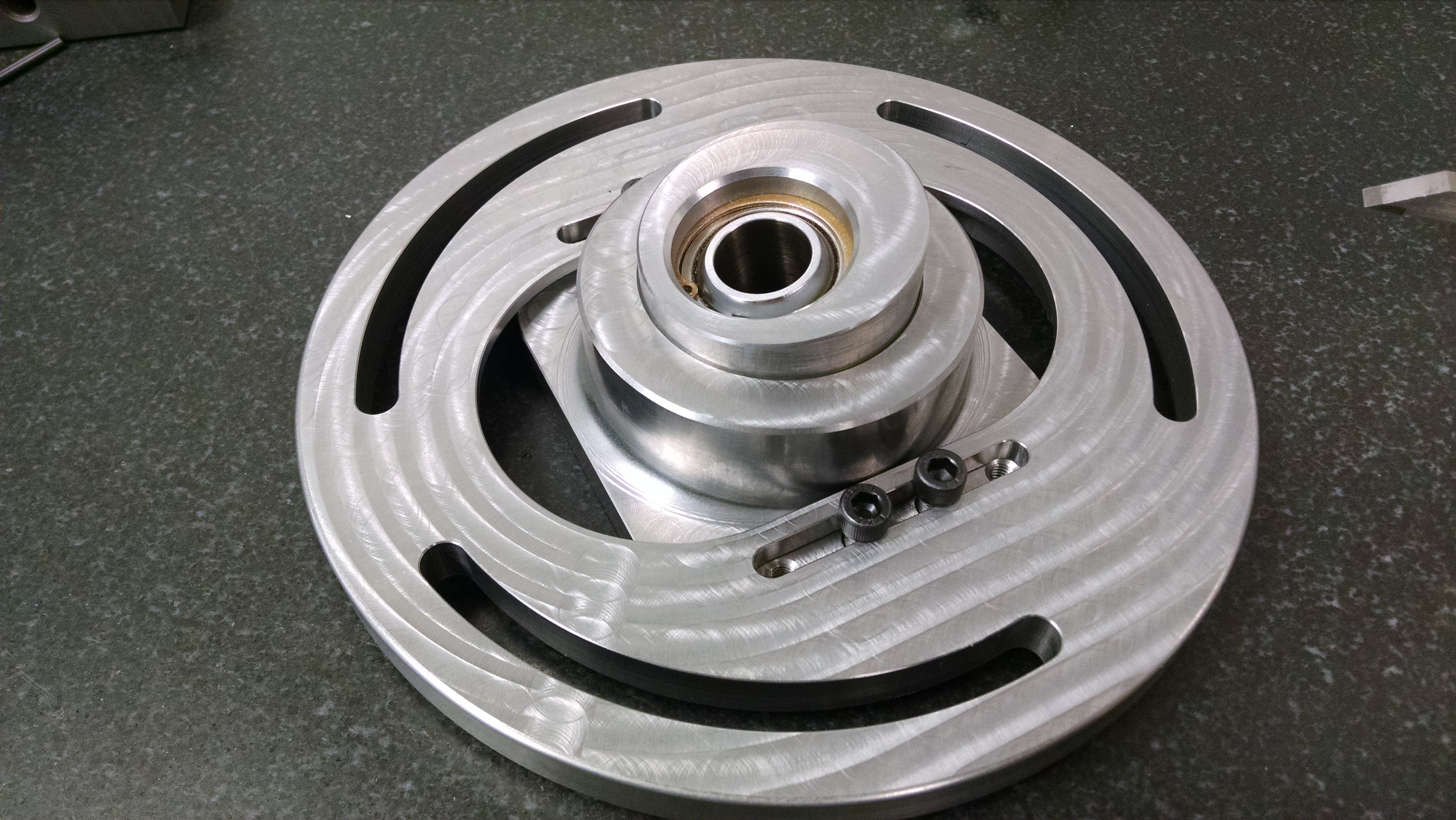

Prototype slider pieces are done.
Re: T44/URS Strut Mounts - Help Me Help You!
Looks sweet Chris! I'm still down for a set of these if we can get a group buy going. Like I said to you earlier, I'm happy to trial-run these and give you my impressions and feedback. Once the V8 is 5-speed swapped, my sights are on coilovers for the 200!
Thanks Kevin. I just want to make sure the tolerances are right on them, but then it'll be testing time. I'm just a little concerned about having some kind of rattle with the way the snap rings are set up.

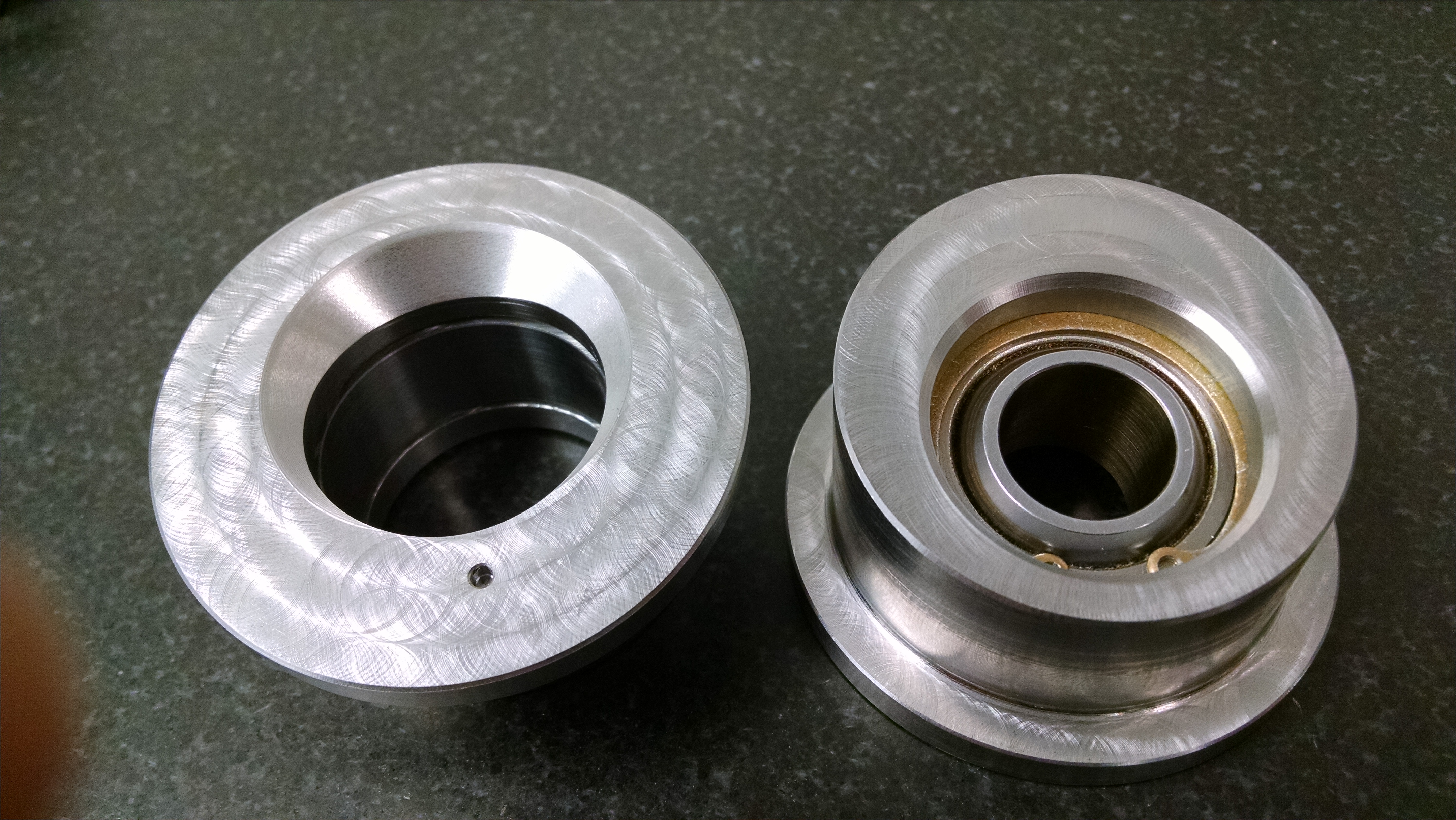

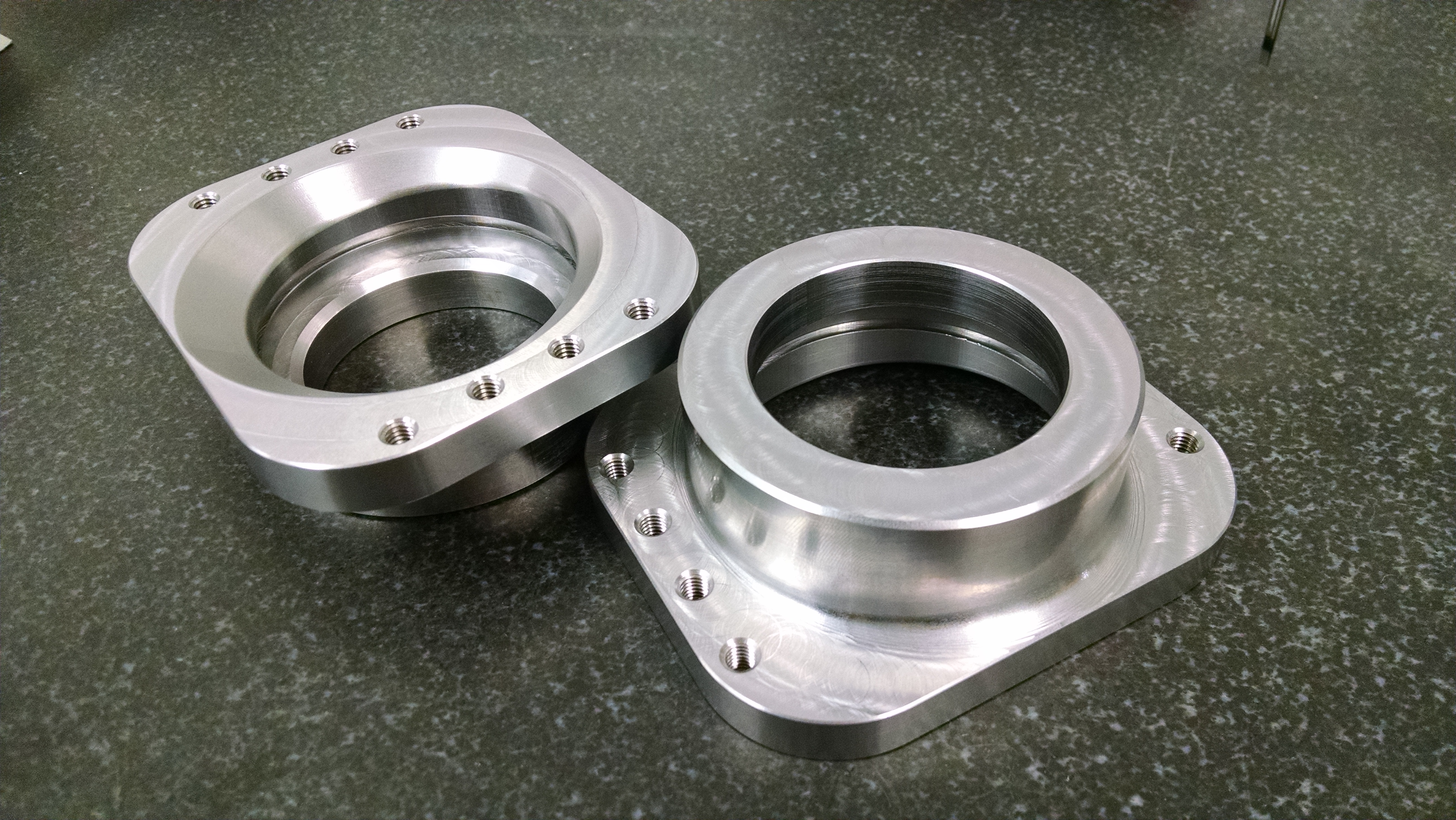

The latest update has the parts almost finished. Just a few little details to fix now.
- IMG_20161018_173131396.jpg (3.39 MiB) Viewed 106563 times
- IMG_20161018_172422933.jpg (3.48 MiB) Viewed 106563 times
- themagellan
- Posts: 873
These are beautiful - What is the cost?
That depends on the interest I'm able to stir up. I will give the rundown after testing is complete and Urs fitment verified. Also, I have to be sure the manufacturer is willing to make more.
How many have they been willing to make thus far?
Two have been made so far (one set). I'm just waiting on them to get zinc chromate coated, then they can be installed and tested.
