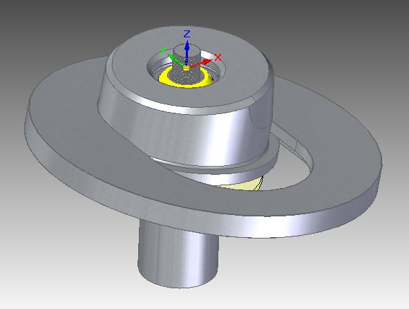

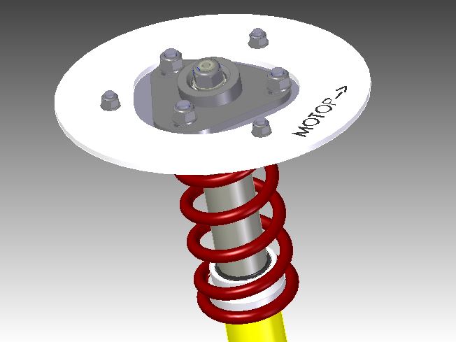

Hey guys, I'm getting serious about designing a new strut mount for our cars to give us the best of ALL worlds. There should be no sacrifice in adjustability or suspension travel as in other designs. BUT I NEED YOUR HELP!
I wanted to make a clean thread where we can talk about design of a new mount only. Once it's finished and prototyped, we can talk other stuff... like price. This probably wont be a cheap solution, but it will be uncompromising. I will probably have Ed's design made too for those who want a different option. We'll have to see how they compare when I'm done, but let's keep this thread focused on this design.
Just so there is something remotely visually appealing here, here's a picture of part of the current assembly (without lower plate showing). I have a LONG way to go with this, but it's better than nothing. Just started this design from scratch a few days ago. I'll go into more details on the concept in a bit.
Strut Mount Progress.JPG (39.52 KiB) Viewed 123905 times
Here's what I need help with for both UrS and T44:
- Measure the angle between the stock strut tower (or the lower plate that sits just under the tower top) and the strut shaft. I measured 9.5 or 10 degrees, but that was years ago...
- What is stock camber?
-How much camber and castor adjustment do you want to be able to have?
- What are the rough dimensions of the opening in the strut tower (to optimize adjustment capability)?
-The distance between the top of the strut tower and the strut's lower pivot point (to determine delta strut angle vs lateral movement of the top mount).
-If possible, the clearance from the top of the strut mount plate (the one which mounts just under the strut tower top) to the hood from various points (near to outside of car, near to inside of car, middle, etc.)
-If anyone has one of the Bicknell Racing red top hats around, I'd love to make a model of that because they're better for this design than the A1 racing ones. I will see if I have one laying around somewhere, but it's going to take me a while to get to one if I have it.

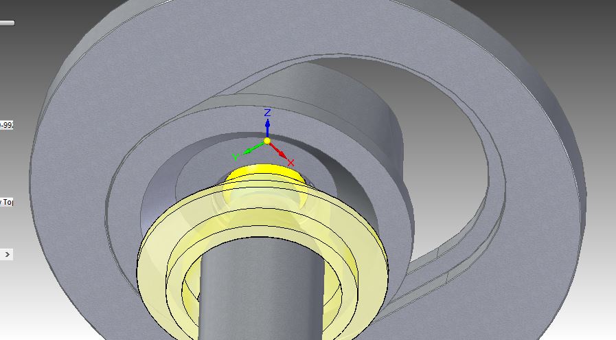

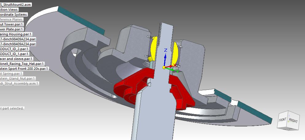

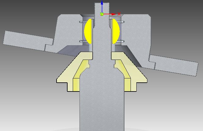

I've made some progress with my "proof" of concept, AKA virtually determining if my idea will fit within the constraints we have to work with. So now you can see a little bit of the concept I have going here. The design is driven by the need for adjustability in any direction, suspension travel, and the space we have to work with.
I am pretty close to being able to determine how much travel can be gained from this, how much adjustment it will provide, and probably of equal importance, how to clamp it all together. Thoughts on clamping include a threaded retainer to go around the OD of the big bearing housing, or bolts. The bolts pose an issue with adjustability however. The threaded collar idea is just going to be expensive! But that's all next on the list.
This picture shows the mount set up for pure caster adjustment.
Strut Mount Progress 4.JPG (28.36 KiB) Viewed 123692 times
Strut Mount Progress 3.JPG (63.52 KiB) Viewed 123692 times
Strut Mount Progress 2.JPG (32.29 KiB) Viewed 123692 times
The lower plate will be able to rotate in the strut tower while the bearing housing slides in the lower plate.

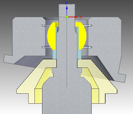

I got your assembly to work in Solid Edge ST7. This is the kind of utility that you pay the big bux for :)
Assembly Opened in SolidEdge Proof.JPG (35.39 KiB) Viewed 123587 times

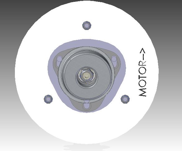

This is how mine overlays yours. Adjustability should be similar or better (the little lip around the outside will go under the plate).
Overlay TOP.JPG (30.71 KiB) Viewed 123587 times
Re: T44/URS Strut Mounts - Help Me Help You!
Looks like you measured 10 degrees in the camber direction to my 9.5. Close enough for me!
Also, I see that you don't have any cant in the castor direction.that was just my mistake when sloppily overlaying the parts for that picture.

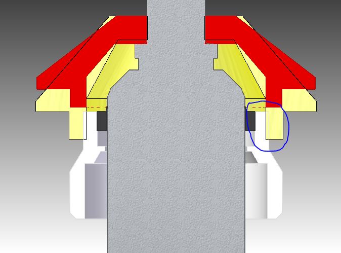

Another question...
Are you sure about the ID of the Bicknell hat? I thought I remembered them being much thinner around the part which centers the spring (I.E. similar OD to the A1 hat, but bigger ID than the A1 hat resulting in a thinner profile there).
Also, I think I am remembering that with the Bicknell hats, the strut would bottom out on its own internals before the gland nut would interfere with the top hat. With the A1, the top hat would hit the gland nut before the strut would bottom out. The attached picture is helpful in understanding why.
You can see the interference in diameter, but also that the Bicknell hat is much shorter allowing the strut itself to bottom out first I believe. That is for an unmodified strut. I'm not sure what the shortened struts are like.

Alright, with a set of calipers and a Bicknell hat in front of me, I measure a 2.071" for the ID of the hat, and a 2.432" for the OD of that same feature. I've also measured 10 degrees of tilt for the bearing housing FWIW.

Thank you, your measurement matches Nick's part file.
I'm not sure what kind of bearing you're talking about, but I can almost guarantee you it's because it would affect adjustability or suspension travel. The spherical bearing I've chosen should easily be able to cope with the stress though, so not to worry. I'd love to see some pictures of what you've got in mind though.
