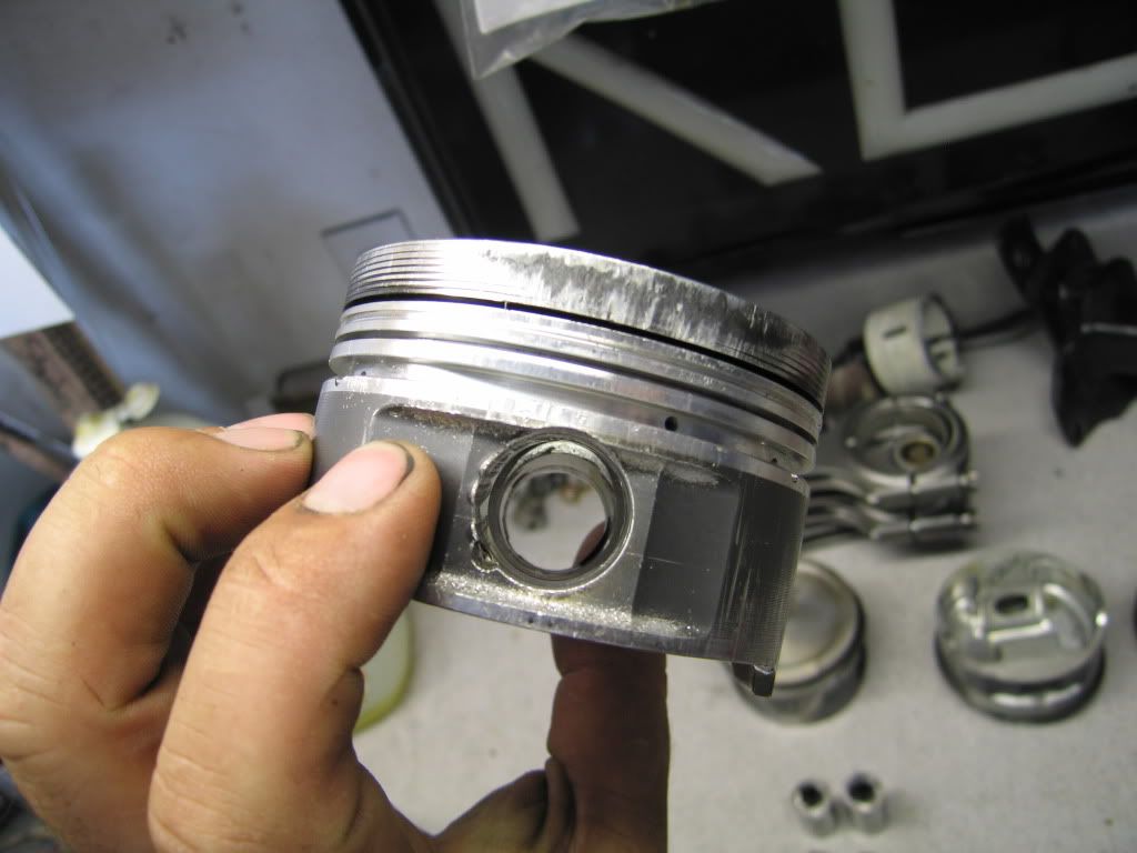

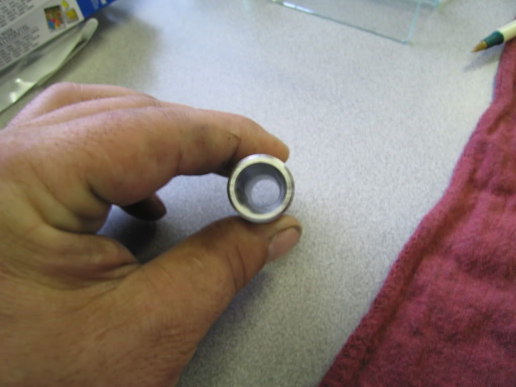

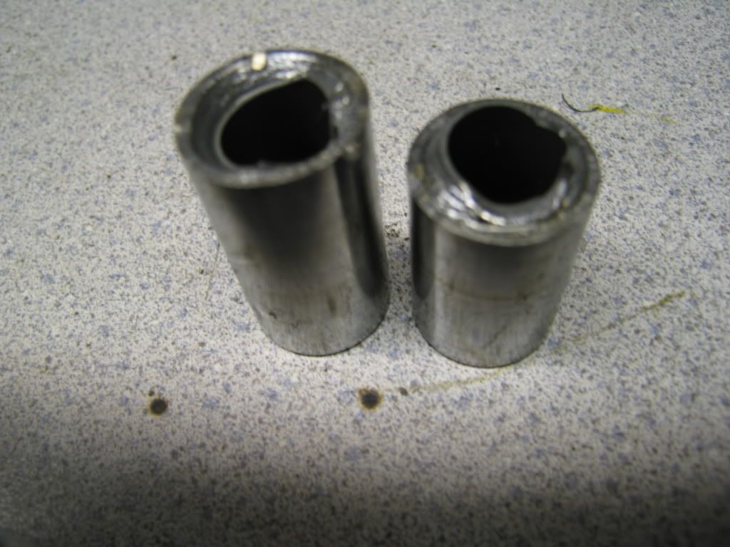

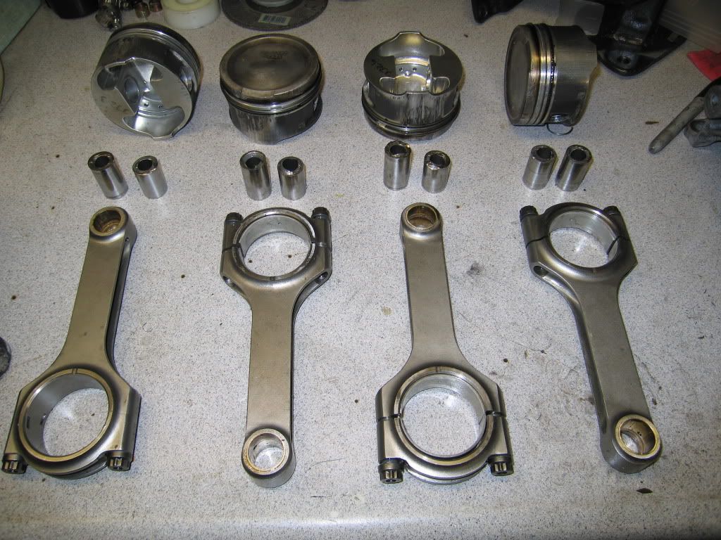

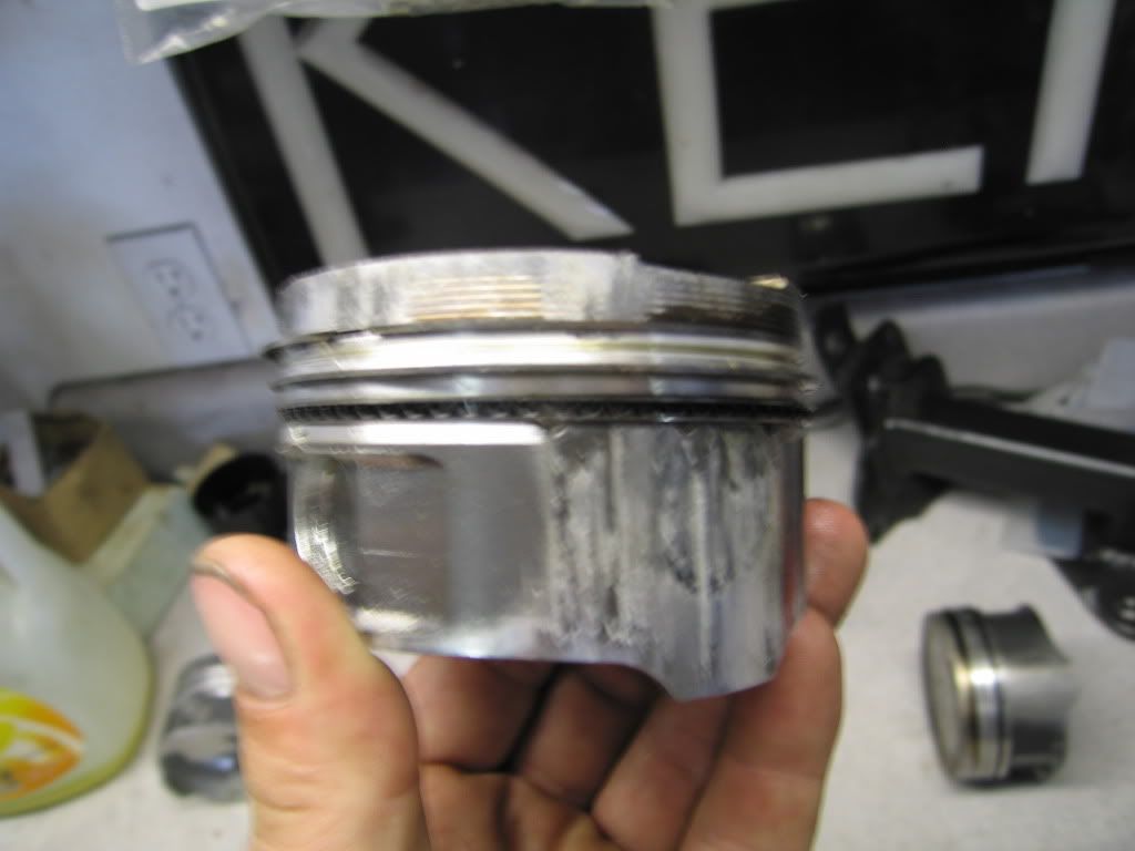

here ya go, Hank.... new partz are here.
wrist pin pix like you requested :)
and some damage shotz as well.... i am gonna make a windchime out of these here partz.... once the neighbor gets home so i can get some fishing line :)
and then the new pieces.... they look pretty beefy. the middle i think is .180 wall, and it tapers out to the ends of the pins internally. hard to take a picture of something like this.

I really have to ask, why do those pins look like a tube inside a tube?
Are they really made that way?
I'd be furious with the piston/pin manufacturer if that's how they are made.

dunno. many things that poor motor went thru.
crank walked, had > 1.1mm end to end play. sideways stress on the pins? probably due in part to the heavy ass clutch, a dual diaphragm pressure plate...
lifted the head twice, torched it the last time.
lots of 8500 rpm rev limiter hits while drag racing.
this is the other end of the pin view. its solid....

Aaron I think they got broken, when crank was walking back and fourth, that’s why it broke in a middle. New parts look sweet when it will run again??

Are the old rods all shot? they dont look horrible, except maybe the right most one.. looks a lil bent but might be the pic?
