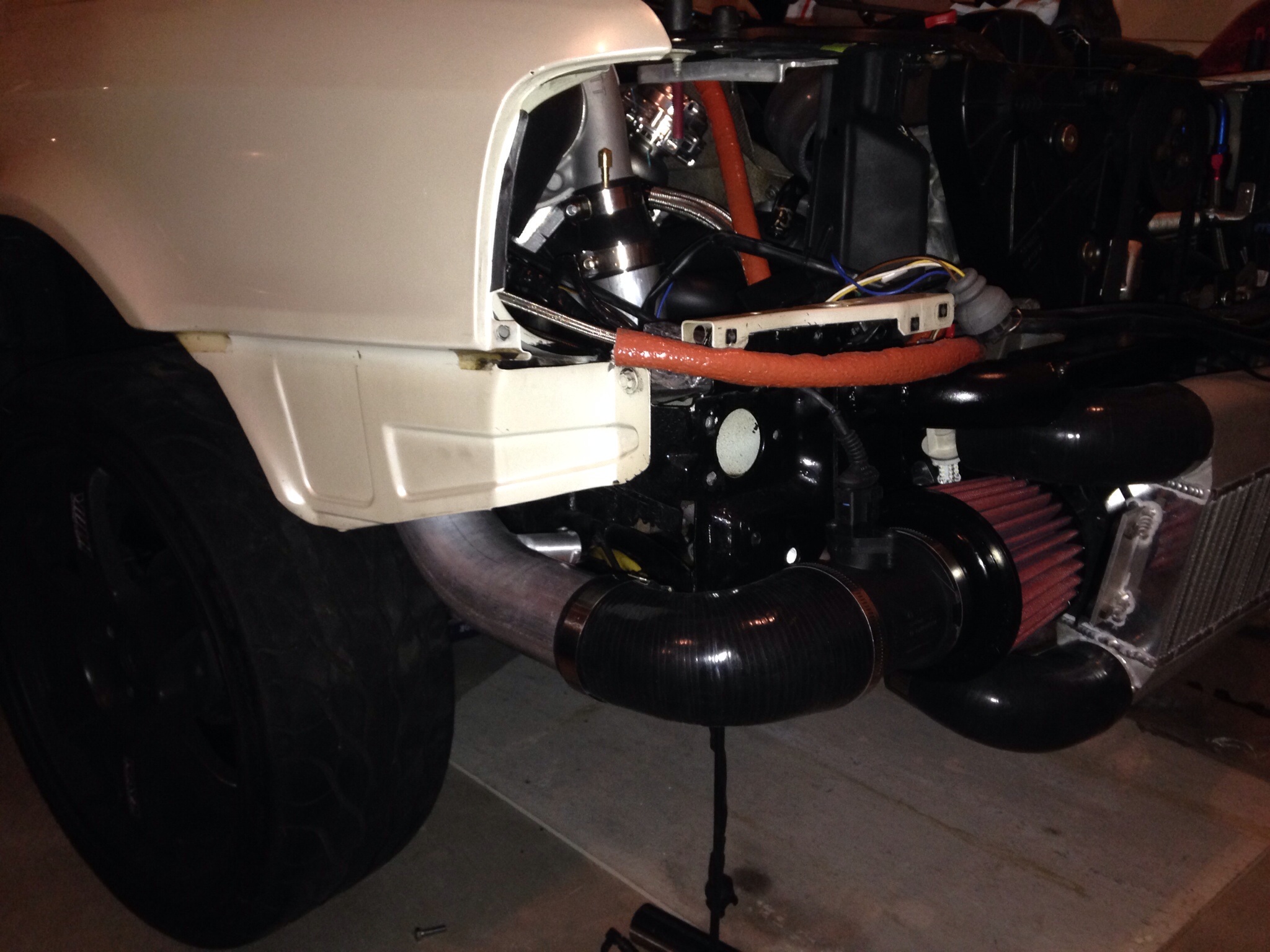

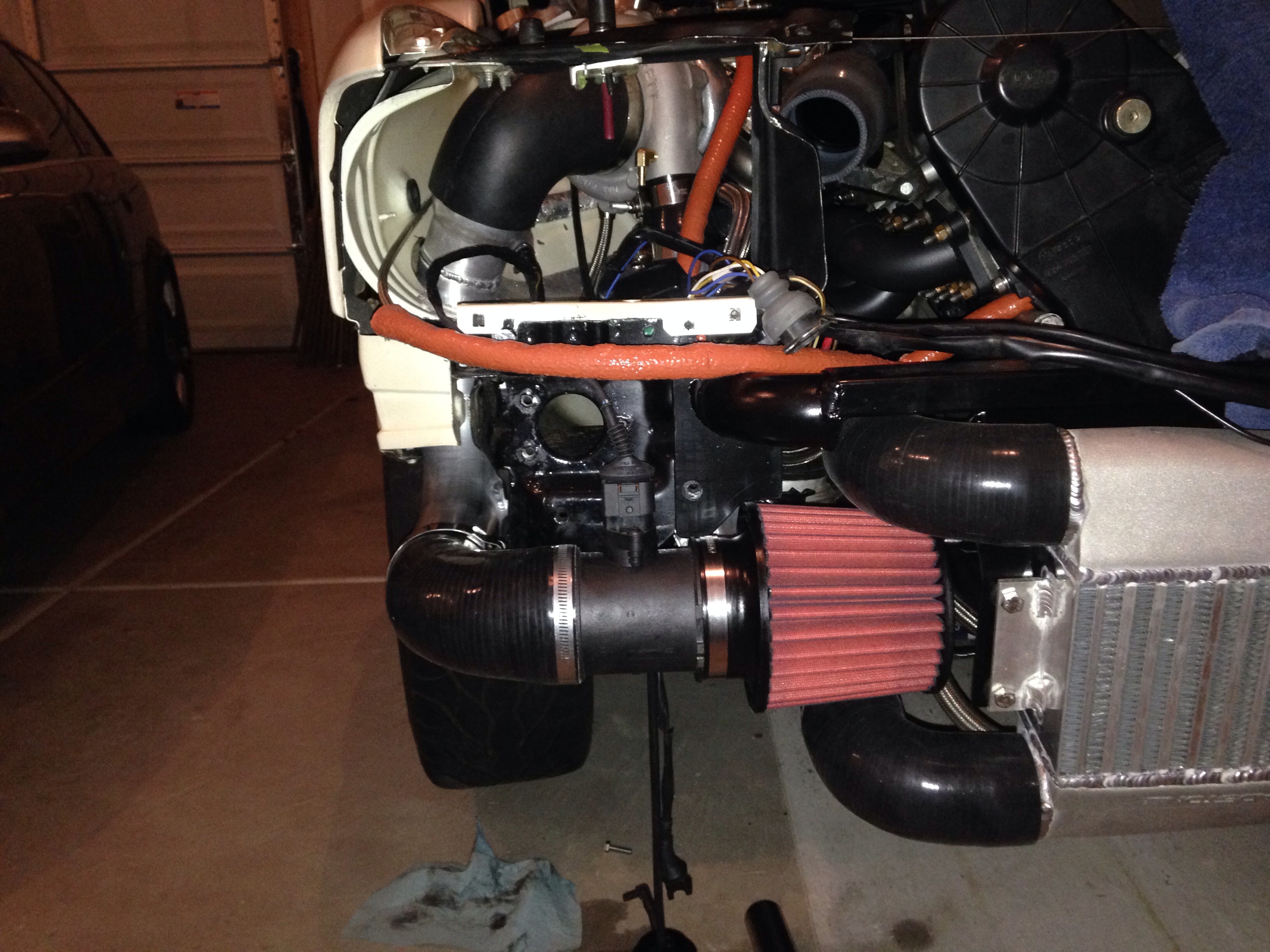

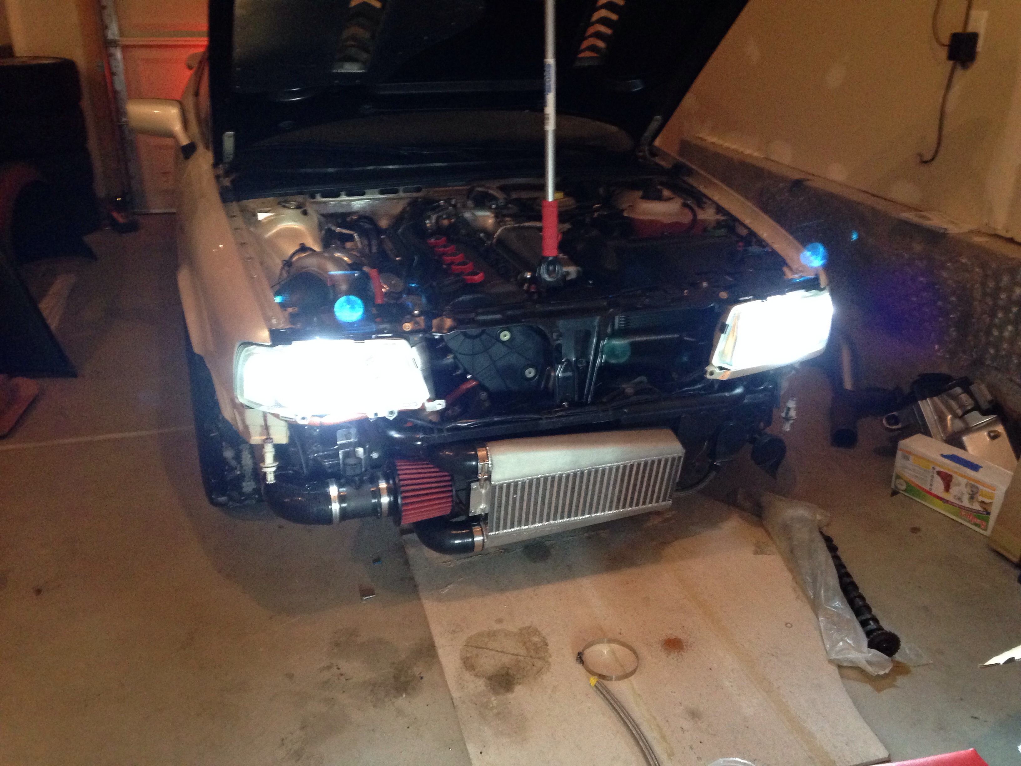

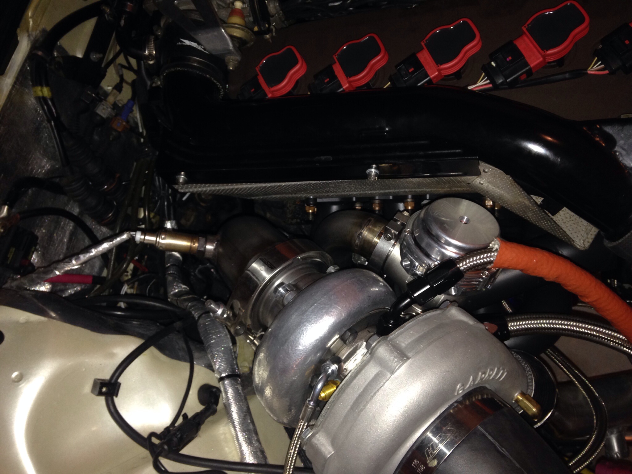

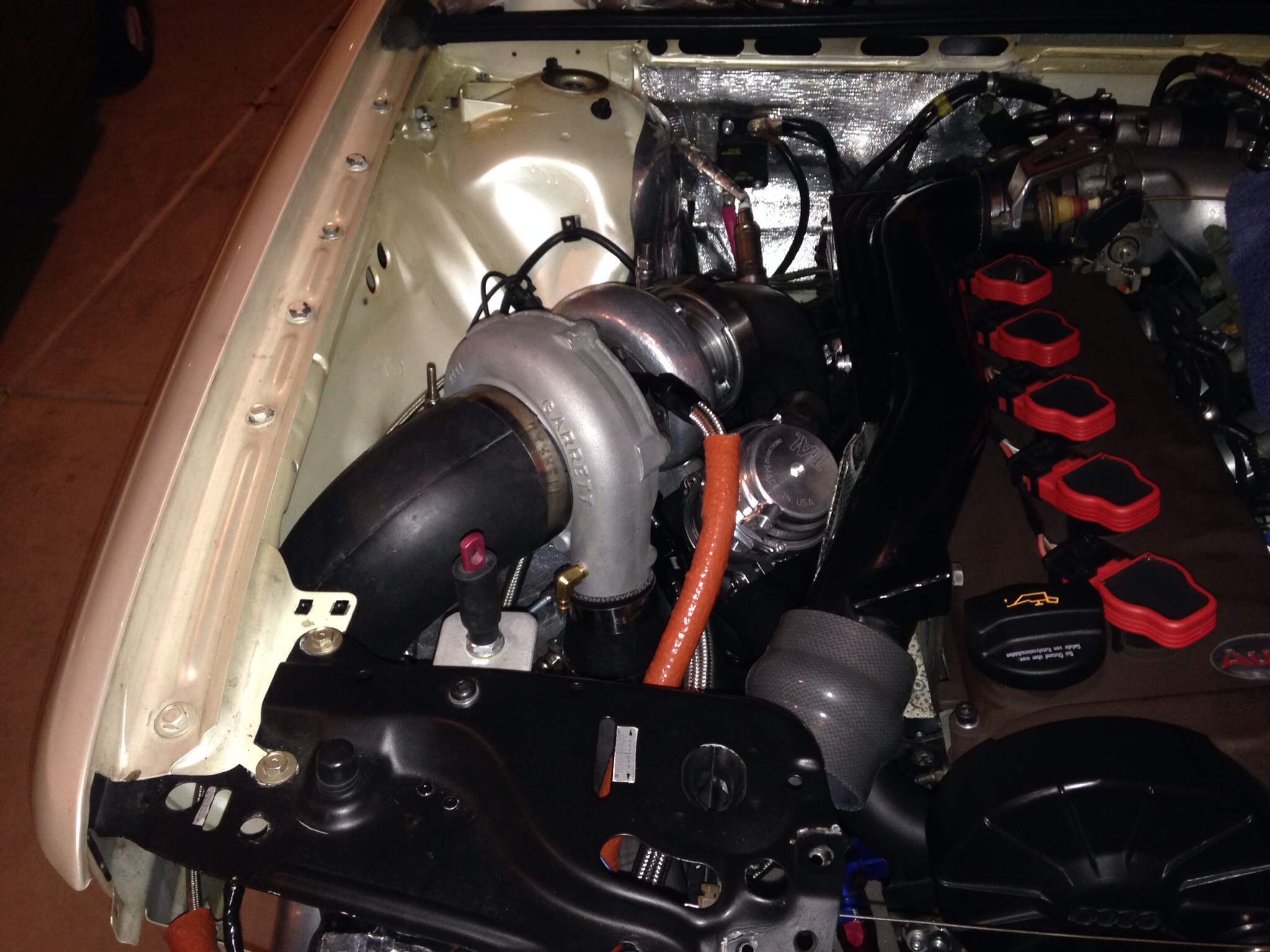

Finally I got all the parts I need. After getting the wrong size air filter called amazon up and they next day aired the correct one so I spent the evening taking everything apart and putting gaskets in place and tourqing every thing down. I also hooked all the turbo lines up. The only thing left to do is install injectors and ecu. This should complete all the mechanical aspects of the build. I want to make sure everything is running correctly before I install the methanol system. I won't drive the car hard at all because it had been tuned for meth so just very slow driving to make sure I have no leaks or unforeseen issues.

All the lines installed
Down pipe and waste gate installed

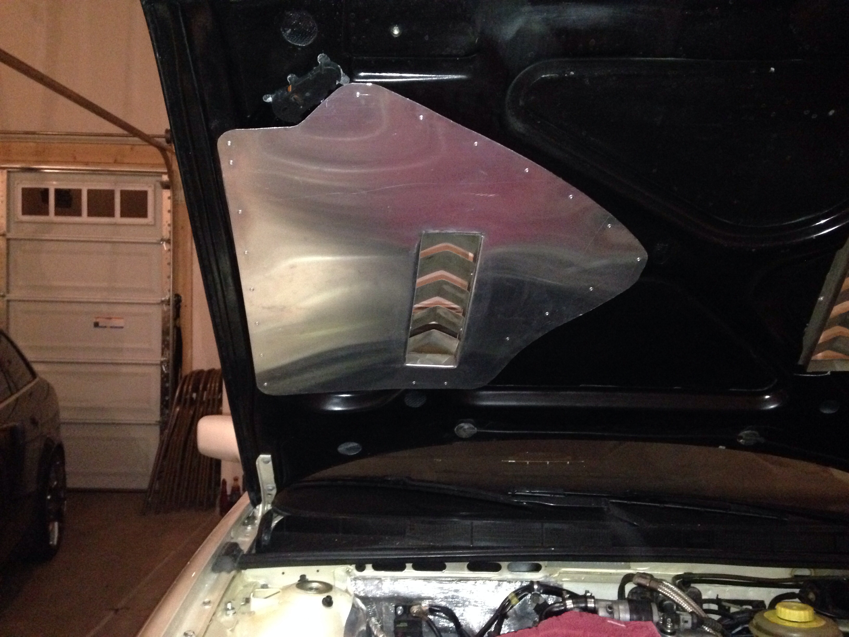

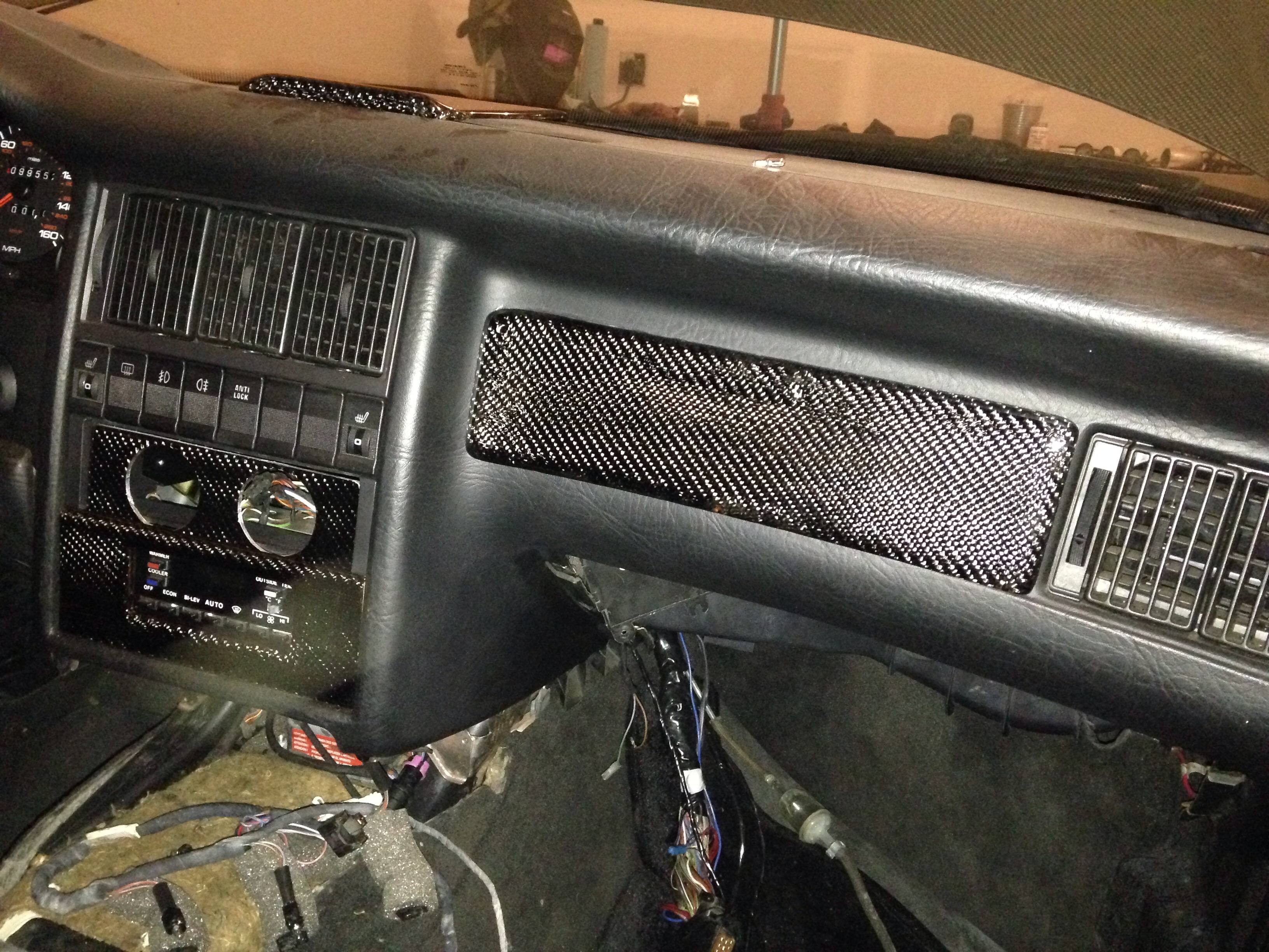

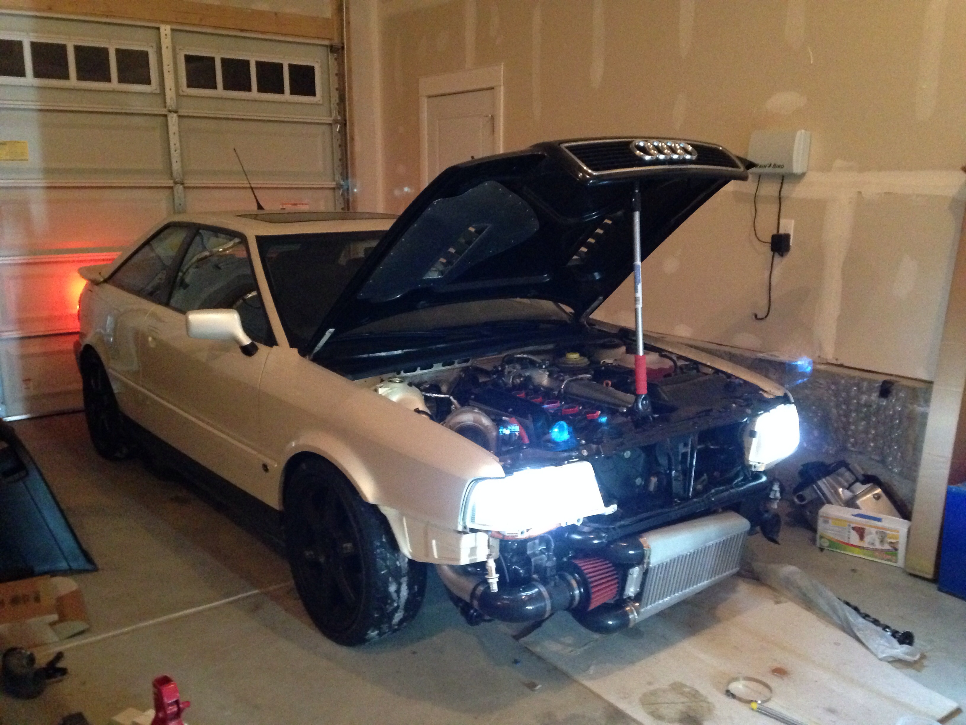

Ok got a little time today so here are the pics of progress. I started to put the injectors in the fuel rail but I need spacers which my bud Brent is going to hook me up with so I decided I would work on the heat shielding for my carbon fiber hood. I also finished up on the carbon fiber bits on the interior. The heat shield took most of my time today about 5 hours but it will do a good job at directing the heat out of my louvered hood.

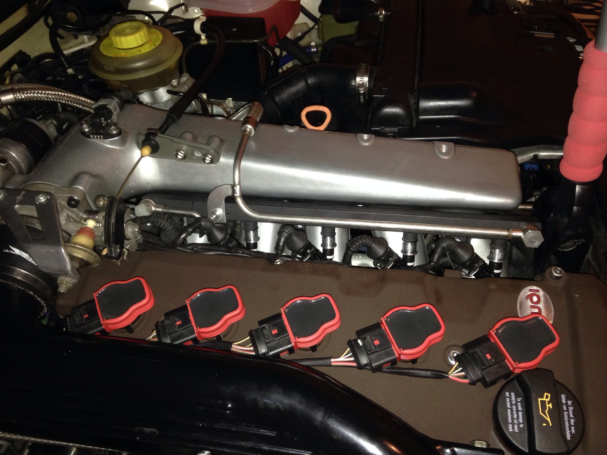

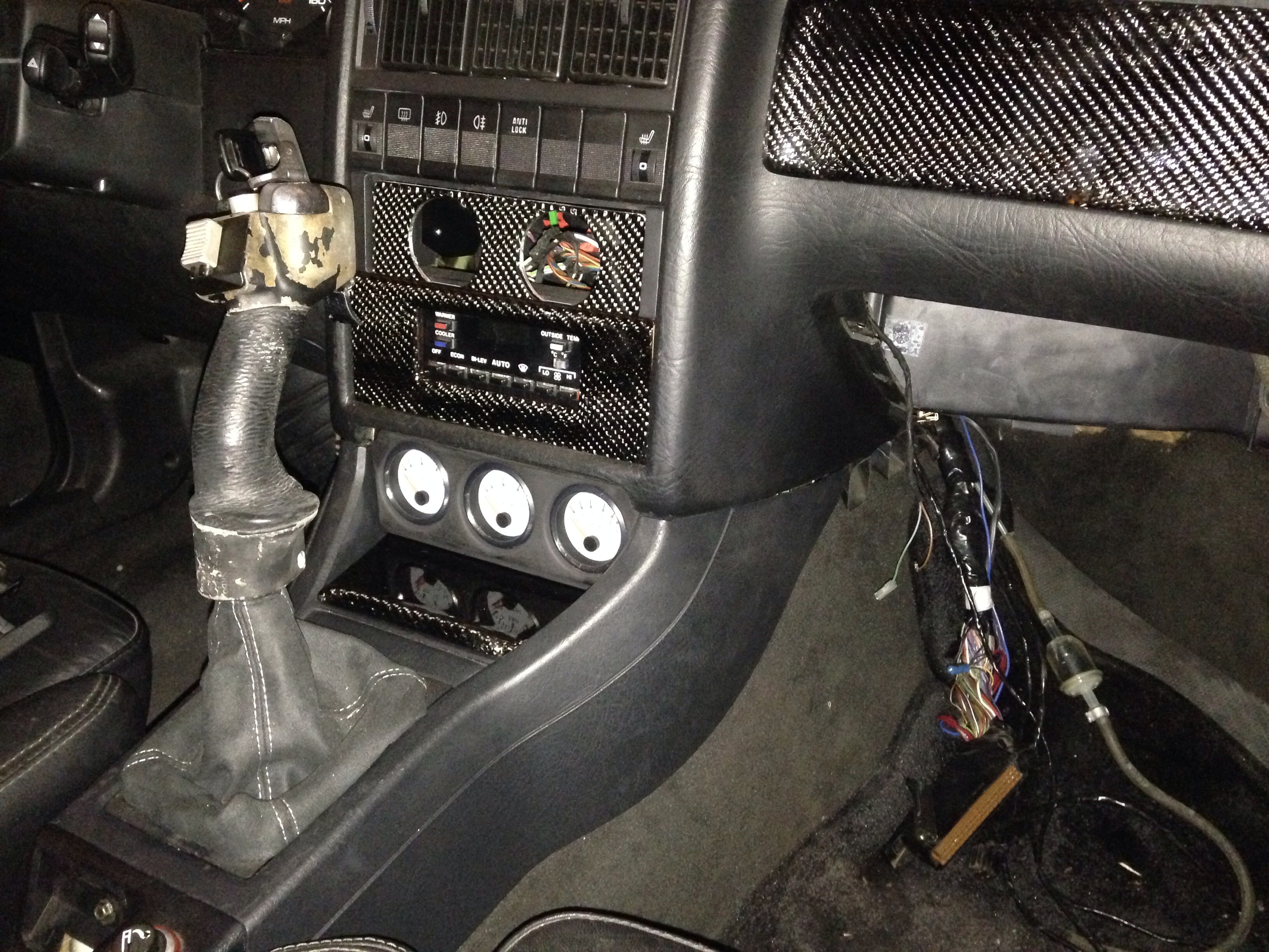

Some progress today. I was able to get the fuel rail installed after sourcing adapters needed to fit the stock fuel rail in its original location. I had some time to work on the interior as well, still a ways to go in that arena but it is getting closer. Once I have confirmed everything is working as it should it will be time to drive the car to Las Vegas to Hanks shop and get it on the dyno for a custom map.!!

Cockpit view with my jet fighter shifter
