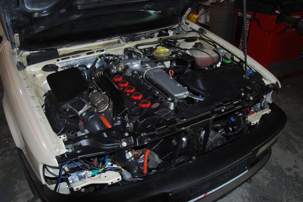

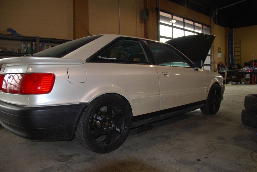

Stopped by the shop today to offer some moral support and try to help out with some wiring. Hope we made a little bit of progress there.
Anyway, I tried to snap a couple pics, but the lighting was compromised from the garage door windows...oh well...
OEM S2 bumpers and Fiber Images hood:
An engine bay on its way to stardom:

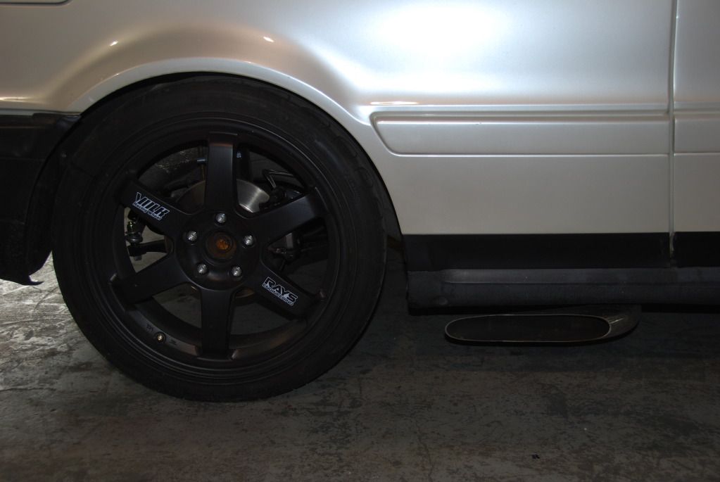

Who doesn't love the lines of the CQ?
Custom side exit:
This thing is gonna be one of the nicest conversions around...great job so far, Nate! Nice attention to detail!

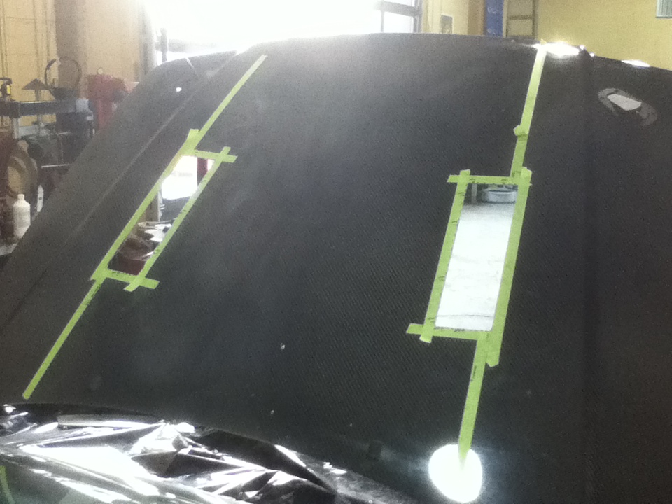

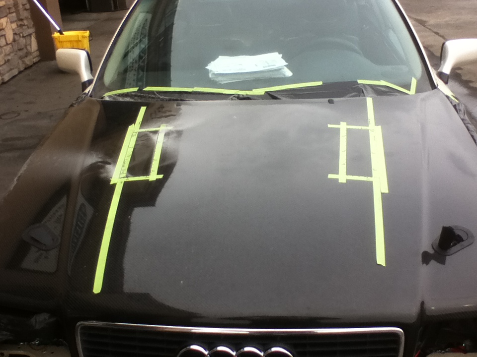

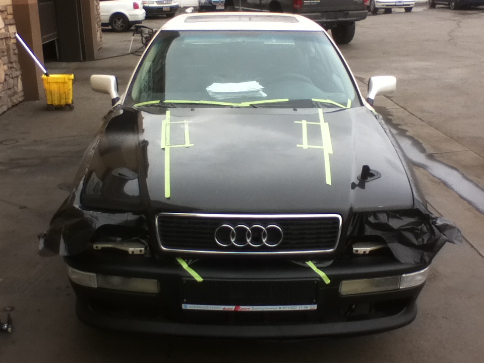

After looking at the car and knowing what kind of HP I will be running I decided that some louvers were in order to vacate heat from both the turbo charger and the radiator to take car of not only heat soak but also the hight heat under the bonnett. It took me about 4 hours to get everything lined up but I finally started the cutting
Starting the hood louvers

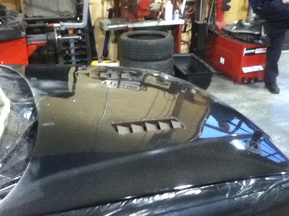

araipilot
Posts: 155
Re: My audi CQ 3B S2 build
Post by araipilot »
More pics of the cut outs
araipilot
Posts: 155
Post by araipilot »

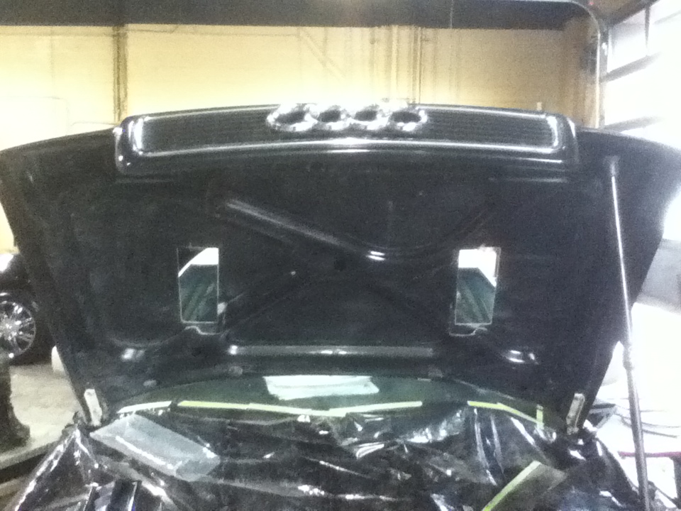

Wow huge holes , got to get it right the first time kind of scary
araipilot
Posts: 155
Post by araipilot »
Had to make sure to take my time only get one shot at this :hide:
araipilot
Posts: 155
Post by araipilot »

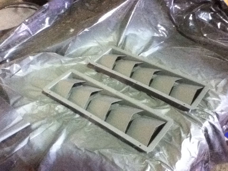

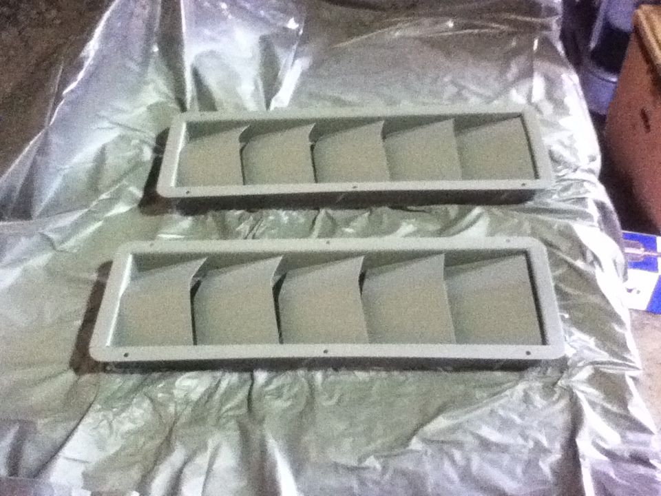

Here are the louvers primer etched just before the final coat of paint

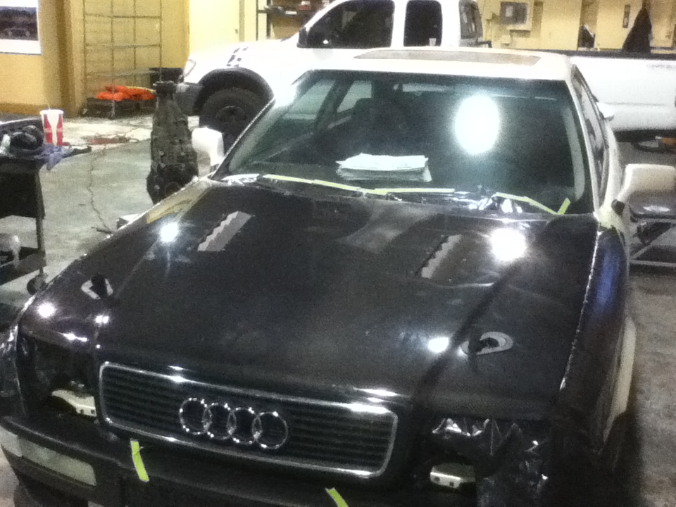

Posts: 155
Post by araipilot »
Painted and installed in the hood, forgot to take a pic of the final painted piece before install but you get the idea, Painted flat earth brown.
araipilot
Posts: 155
Post by araipilot »
Did a test drive today and when the fan went on it was blowing right out of the vent very very functional, I know some might not like it but I have to say for heat evacuation it hits the spot. Also the one over the turbo is brilliant.
