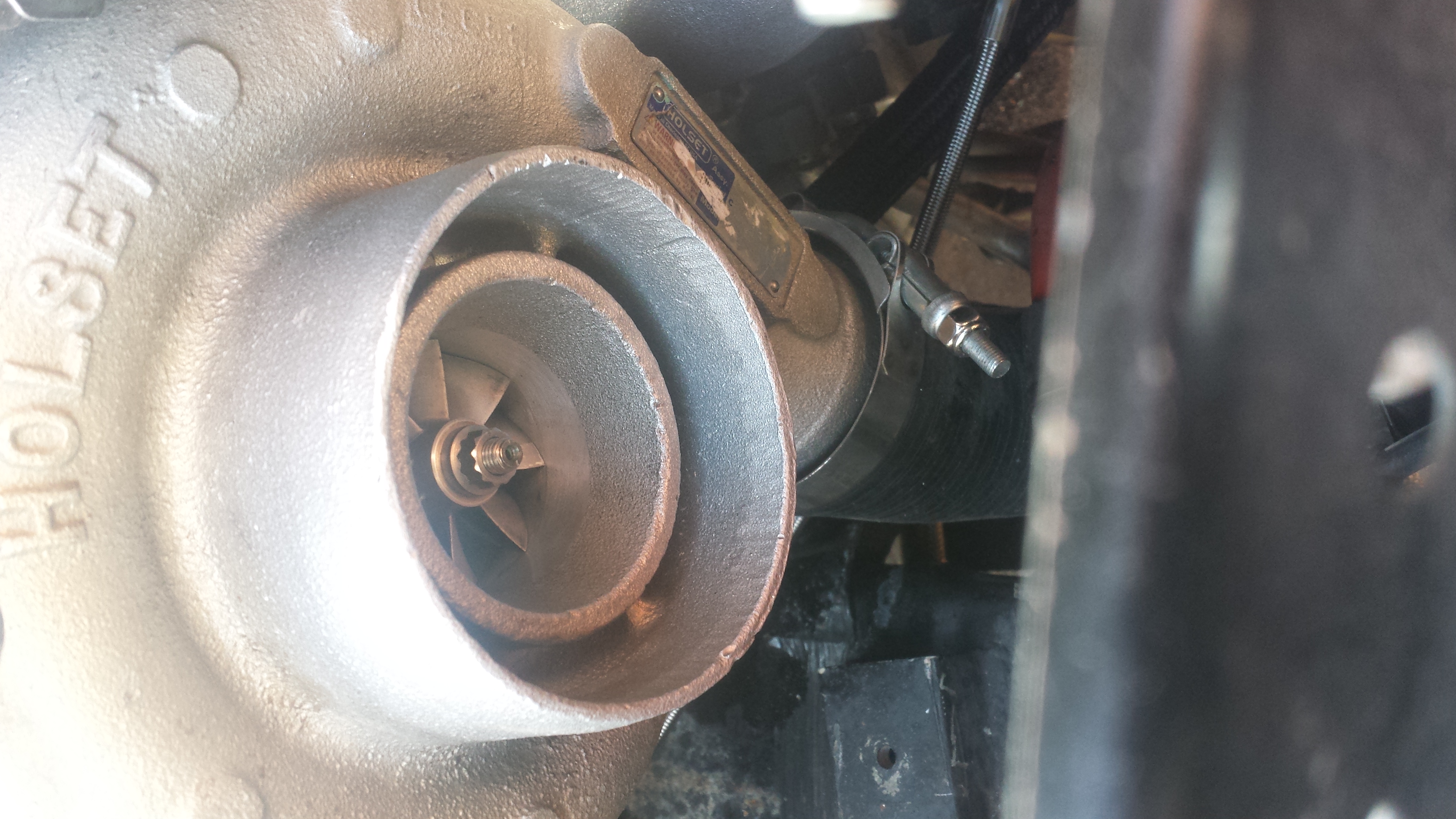

When I see you say "groove" I picture an area in the turbo inlet, except in the larger ID area of the outer hose clamp area, where a c clip would've held the silencer ring. A look over while cleaning showed that area had only way way in tho and didn't do anything for surge.
88a5tq
Posts: 1553
Post by 88a5tq »
Does this answer your question Chris?

Is it an HX35 or H1C? I don't think all (any?) H1C's came with an anti-surge housing.
88a5tq
Posts: 1553
Post by 88a5tq »
Hx35 here

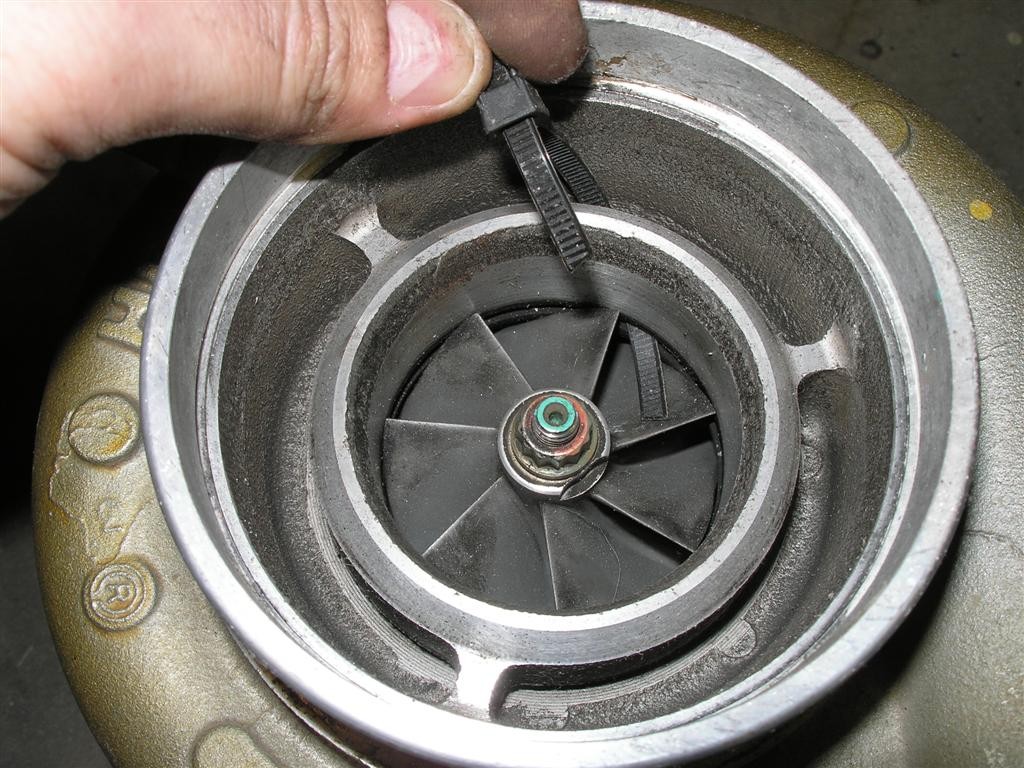

I'm not 100% sure if I can see it or not, but it looks as if you don't have the anti-surge groove cut out. That is why it is quiet! The groove looks like this (although this is an HY):
vt10vt wrote:Is it an HX35 or H1C? I don't think all (any?) H1C's came with an anti-surge housing.
Not all H1Cs came with anti-surge housings, but some certainly did. I had one! My friend had one with the casting for the anti-surge, but it didn't have the groove which leads to the compressor wheel. We cut out the groove very carefully with a dremel and it whistles louder now :D :drive:

I def don't have the groove on mine. I like the sound of dremeling it in tho... I'll go looking for a DIY
Haha, man you aren't likely to find a diy on that. You're better off asking goldfarb if they have an anti surge housing you can buy. It's not worth the effort to have to figure out where the groove should go, get it straight, and go through a ton of dremel blades (mine even needed new brushed half way through!) by the time you're done!

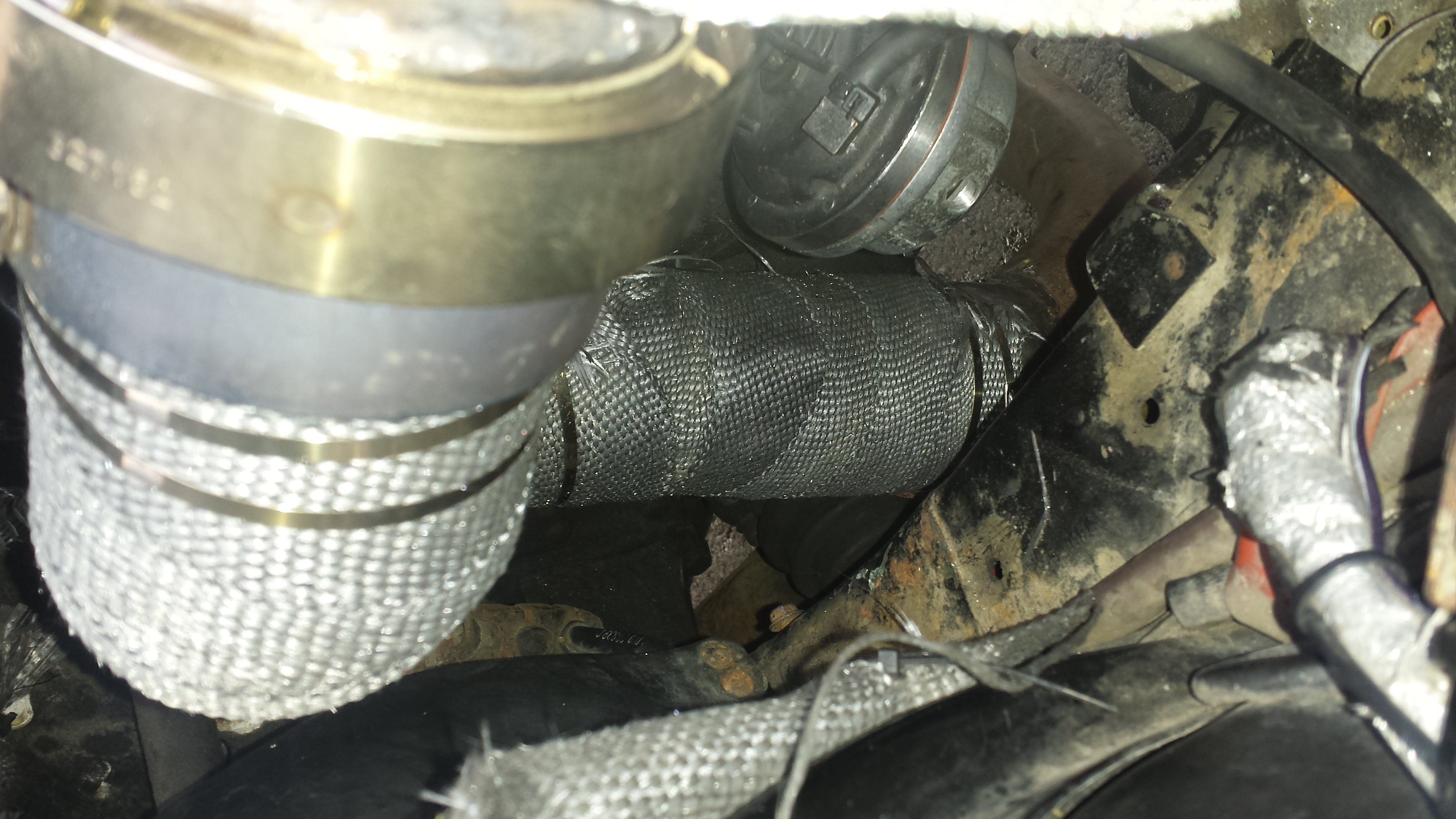

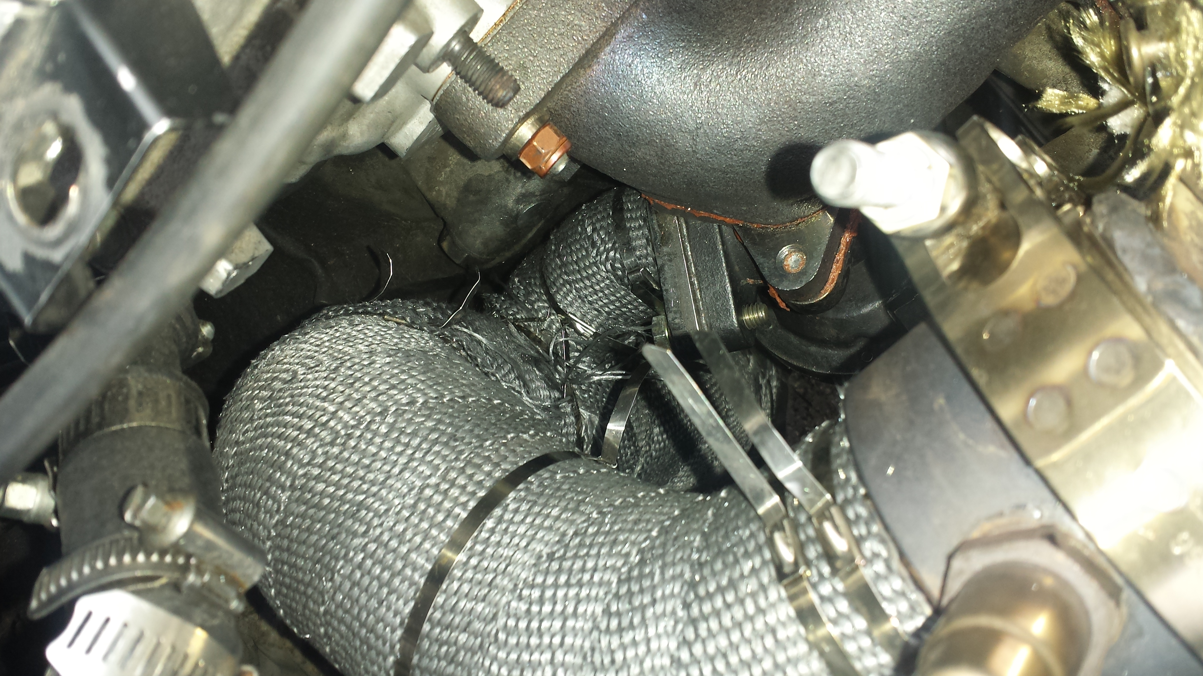

I wrapped the DP in 4 sections with overlap since I did it while on the car. I'm told I'm a quack for even trying lol.
It's fully dressed now above the y-pipe. I was concerned that the WG might overheat with all the heat soak going on. It's still hot as shit right where the v band is. Gonna wrap that part too, I guess, as much as possible.

Thanks. But I just got worried because I wrapped over my vband clamp. You think that will be alright long term?
Looks like it's being controlled to 24-25 psi. I had a guy almost run me off the road so I followed him at over 60 mph through back roads. Car kept up no prob and I felt like it was a a good test of the new setup and longevity. I only just put the wrap on over the v band so if it's a bad idea I can revert it hopefully before a doomsday clamp catastrophe :)

Wrap came out great. Didn't understand your race story but sounds like it performed well? :drunk: :drunk:
I think it's unnatural if you do not use launch with this. It would be very disappointing. Even more so if there was no media to confirm it.
I don't really see why wrapping the clamp would be a problem.

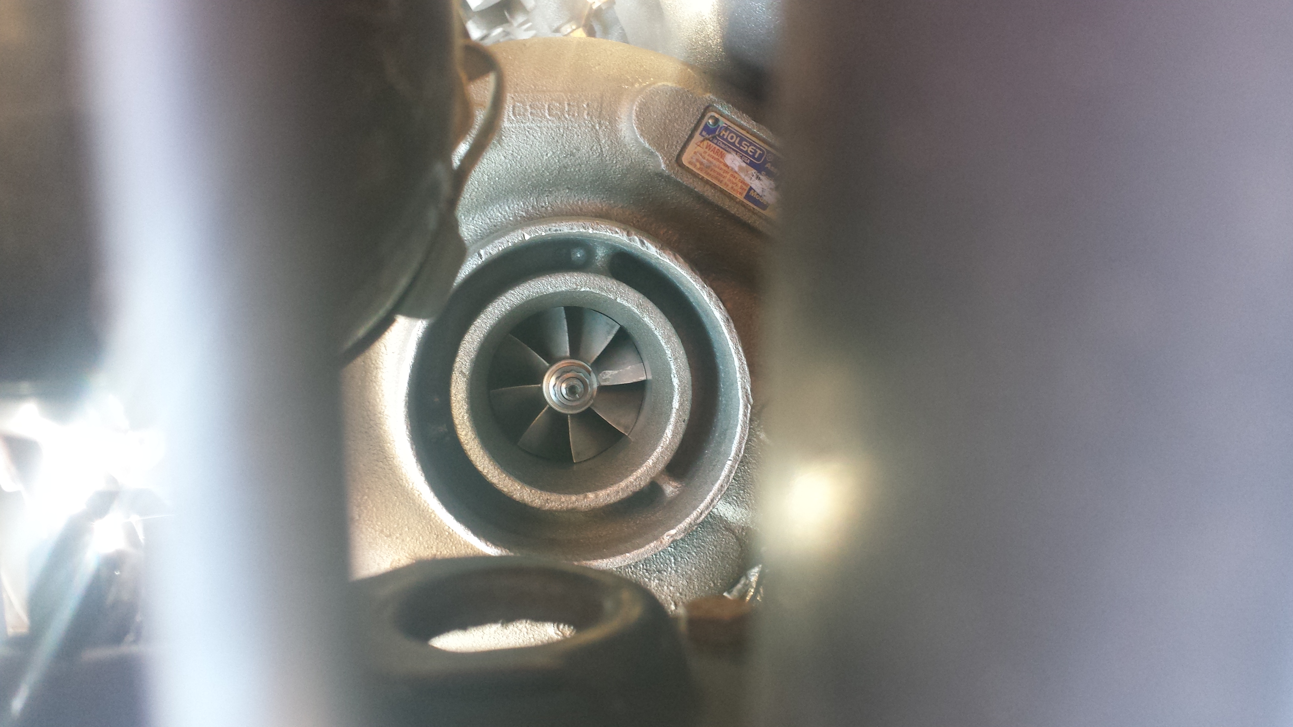

We've hit a brick wall that presented itself concerning Goldfarb. They don't know the inducer size of my 8 blade hx35. Its frustrating as I don't think I could even measure it accurately while its on. I sent them this info from the turbo's ID tag:
3537132
03068978
3537132-03-11/5
HX35
8 blade\ compressor wheel.
That coupled with looking at the close up pics of the inducer leads Brant over there to believe I have a 54 mm inducer. He doesn't have them at that warehouse so he has to check the others over the weekend. :( :( :(
He mentioned selling me a 52 mm and having a lathe bore it to 54 for me since it has a slip-on outlet like my current housing does. Does that sound insane?
Sounds a little silly just for some sound lol. But I'd be looking for one! You don't think you could measure the inducer with a micrometer while it's in the car?
88a5tq
Posts: 1553
Post by 88a5tq »
Like with housing off? I like all my digits in tact lol
Some day I'll rip it off to install the oring
Yeah with housing off. I know they suck. Maybe you could get a special tool for it. I'm sure they make one.

So. As far as holsets go.
Baby H1C is a 54mm compressor with a slip on compressor outlet. Nothing cast for a MWE groove. Available on non-IC Cummins from 89-91. Only had 18cm exhaust housings.
Big H1C is 56mm. 91.5-93 Cummins had them. Available with either a 18cm or 21cm exhaust housing. Has a MWE cover but no groove. Also has a clamp on outlet.
WH1C is a H1C with a antisurge compressor housing and a 12cm WG exhaust.
Hx35 is a 58mm WH1C basically.
