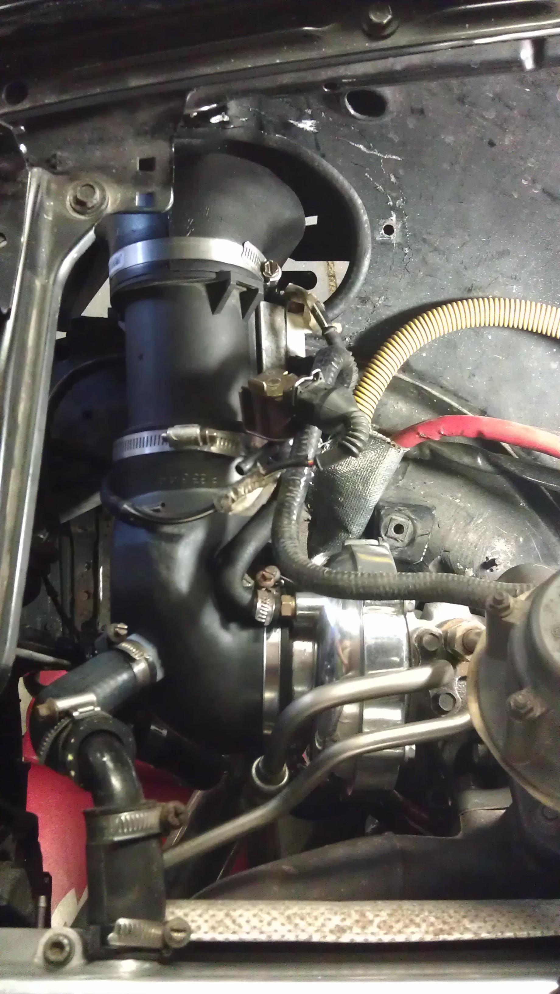

Well I think Ive isolated the hard starting issue. The intake boot failed on me Saturday. Blew a hole the size of my index and middle finger in it. Soooo in order to fix it, I think im going to cut it right before the throttle body and stick an exhaust pipe reducer in there. I tried silocon and a ton of electrical tape but it blew out first time I got over 6psi

Looking like a 2.5" OD reducer to a 2.25" OD exhaust pipe is going to do the trick. Looks like I'll be racing this Friday afterall!

No, he needs what is known as a michelin man hose. It conects the throttle body to the intercooler. Like this

I fixed it! used a $3.50 exhaust pipe reducer and a 2.25" ID tractor radiator hose cut to size!
OMG TORQUE AND BOOST!! Idles better and pulls harder too. Not much...but definitly noticable

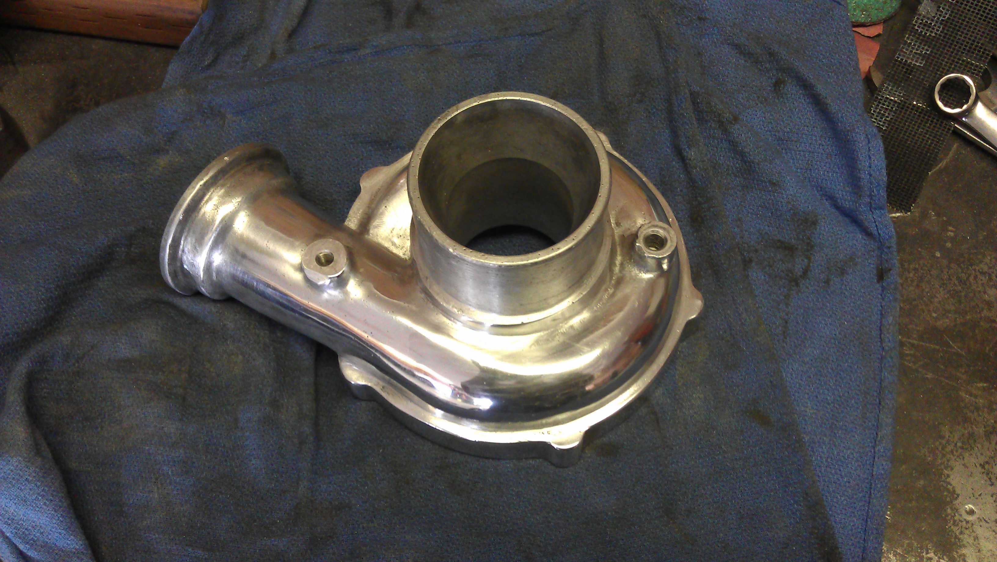

just a heads up, you will be making another mod to fit "THE TURBO"

What exactly will I need to change Dave. I see the v-band but what size is the inlet? Hopefully wont screw up my recirc system

I cut the v-band off, so thats no longer an issue. Its just the inlet to the turbo is much bigger. You will have to figure out a different inlet boot. I used a cobra head for my solution, two actually. I got two in case I screwed the first one up beyond functionality and ended up using both to my surprise. You may do someting similar. I have faith in you to make something work. You already know the juice is worth the squeeze.

scubadave wrote:just a heads up, you will be making another mod to fit "THE TURBO"
Dave,
What cold side housing is that? My Volvo K24's cold side housing has the bypass valve in it.

He had it removed, welded up, and machined nice and shiny
