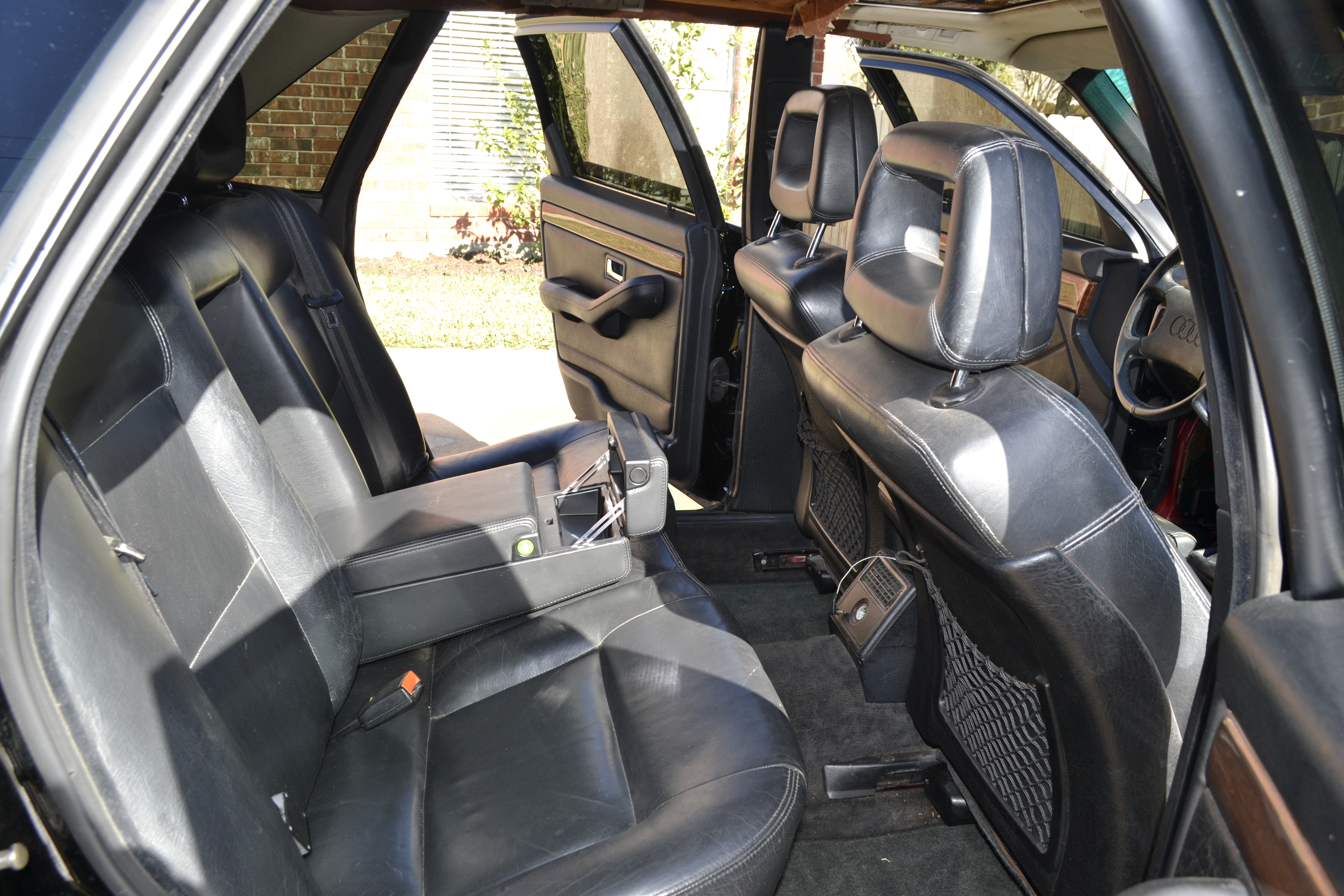

I added a V8 rear arm rest just because I thought it was cool. Nice conversation piece from a D11. Plus it has two compartments to store junk. :)
Thanks Kuma!

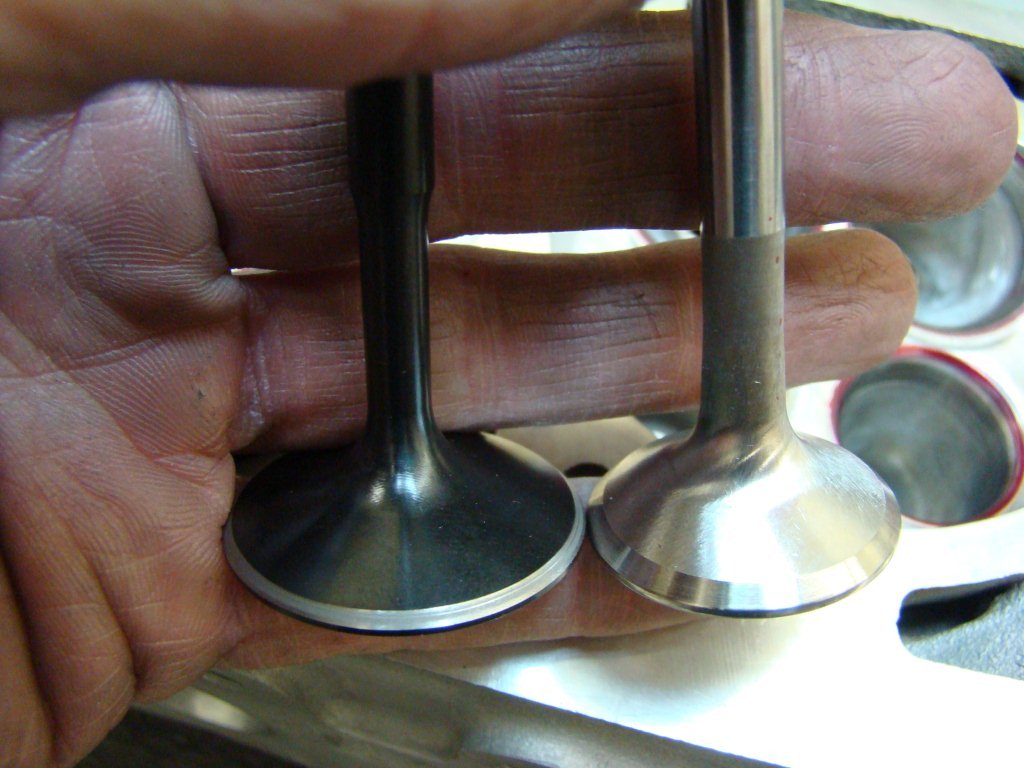

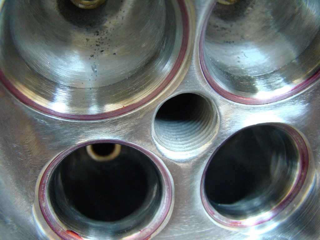

Now back to some engine pics. One of the many key ingredients I have been concentrating on is... They cylinder head. No expense spared there, that is for sure. I believe this is one of the main items that will create big power.... well that and all the other stuff too, but I amreally psyched about the head. The head started off as a 034 stage 2 port with .5mm over valves, titanium retainers, and high rate valve springs. We (Jeff Gerner) went well beyond that now. It now has waaayyy more flow with 34mm exhaust valves and 29.5mm intake. I don't think you can squeeze a bigger exhuast valve in there if you tried.
exhaust port final.jpg (116.66 KiB) Viewed 44177 times
oversize valves.JPG (126.49 KiB) Viewed 44177 times

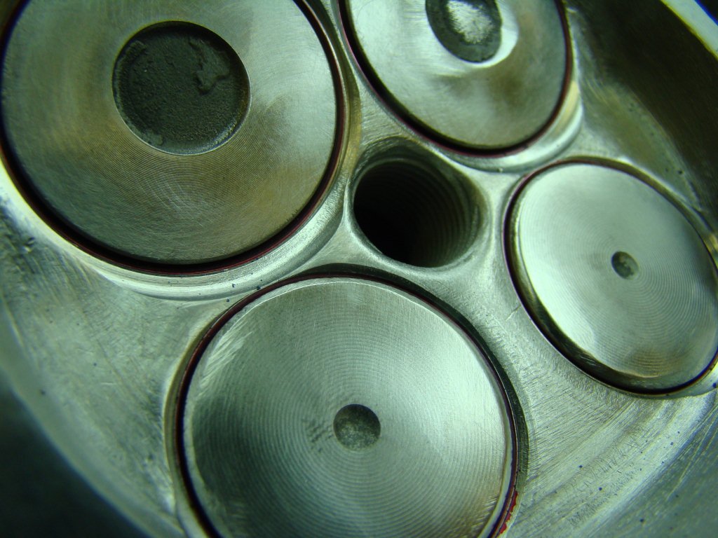

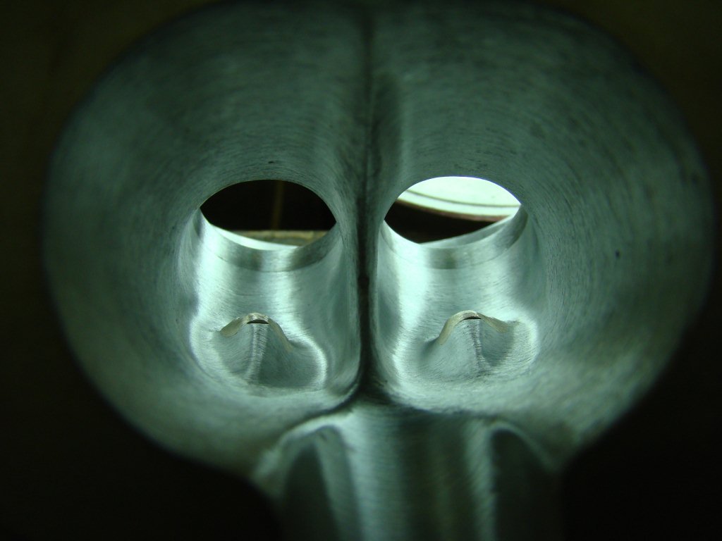

you can see where Jeff worked some material down and gained more CFM from knocking down some ''lips'' around the valves and spark plug area.

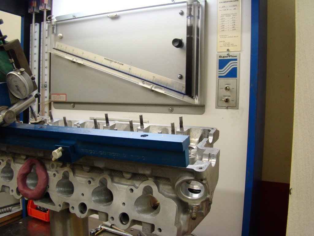

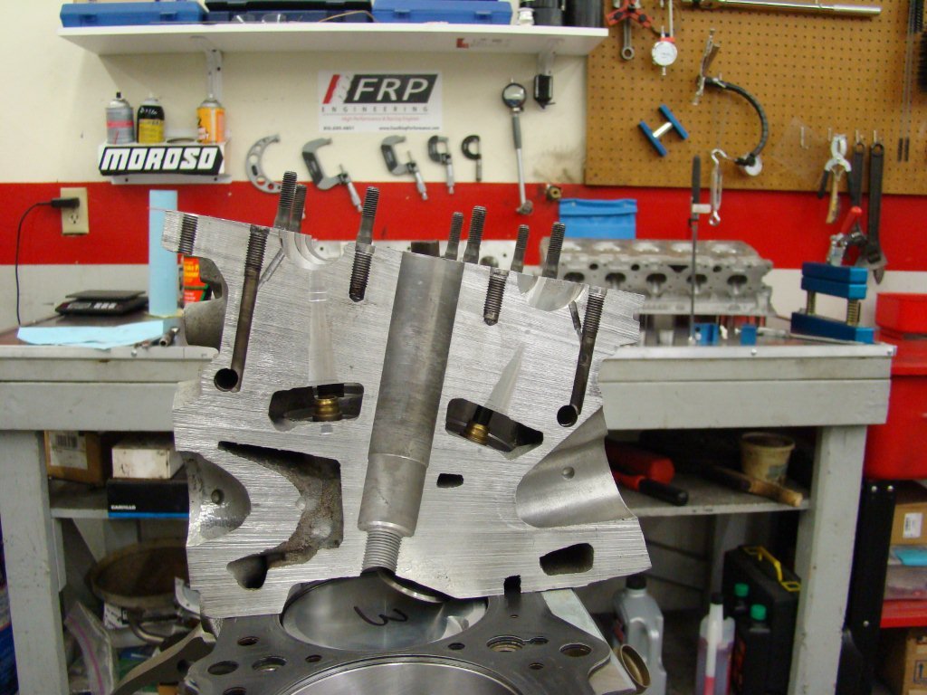

LET ME SHOW PUT UP A COUPLE MORE PICS TO SHOW YOU JUST HOW SERIOUS JEFF ABOUT HIS 20 VALVE 5 CYLINDER ENGINES......

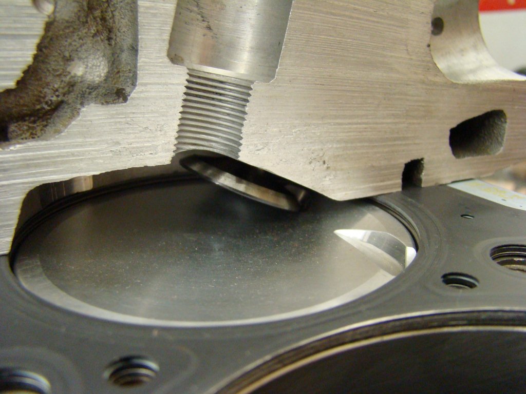

Yeah. Jeff has a cut-away 20 valve head... checking the clearance of the valves to piston tops. And no, that is not the gasket we are using. We are waiting for a solid copper gasket to come from a supplier.

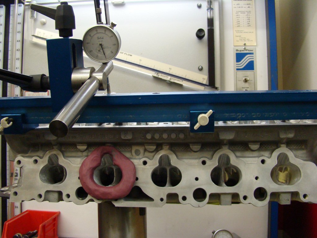

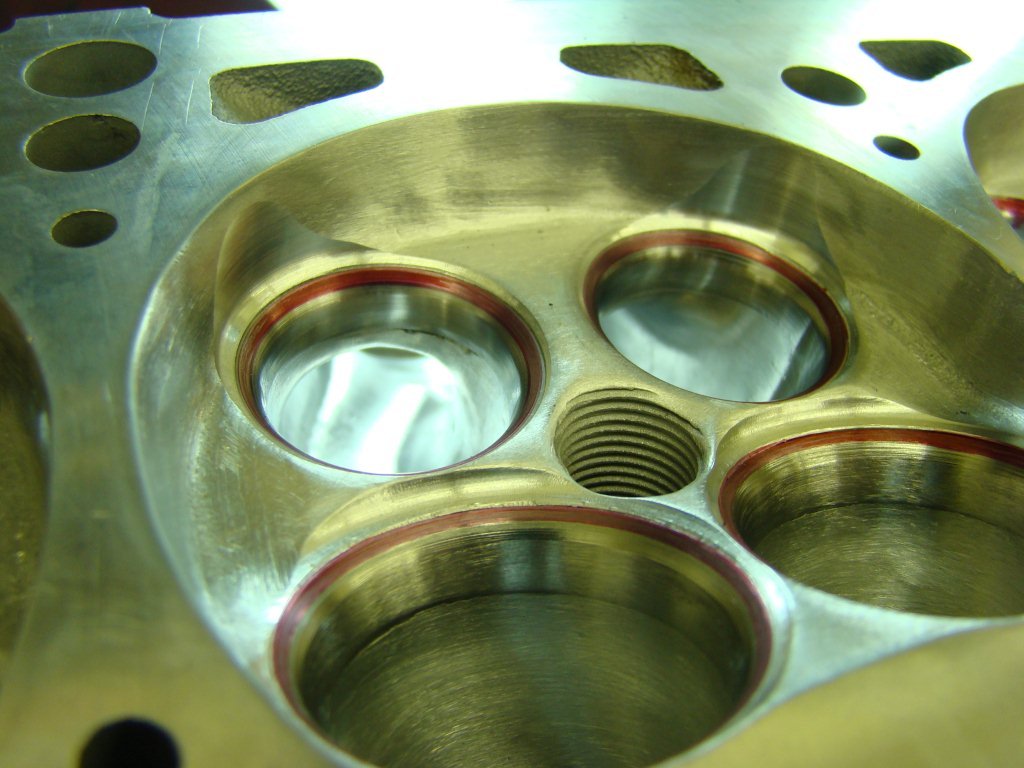

Another cool pic of working the ports to increase flow. I lost my phone that had some final pics after the porting but this gives you a good idea of where it is going.

This is all by hand I am guessing too, right? Truly a work of art.
