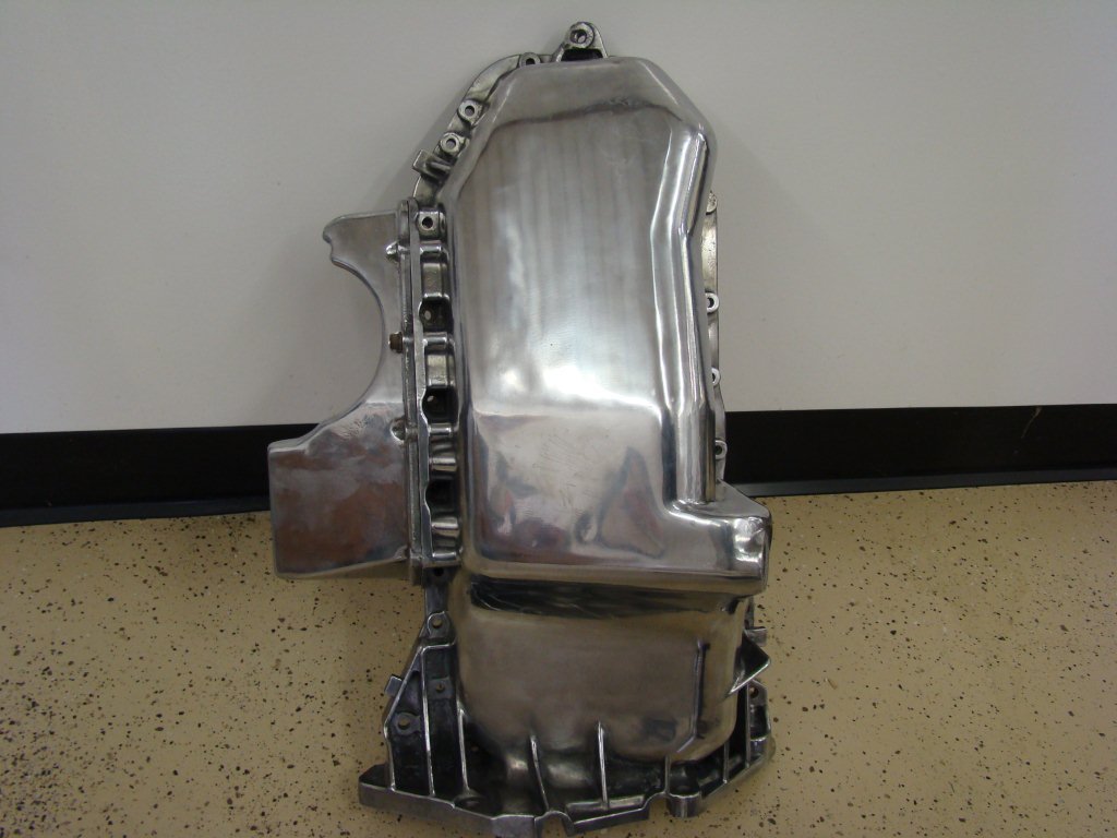

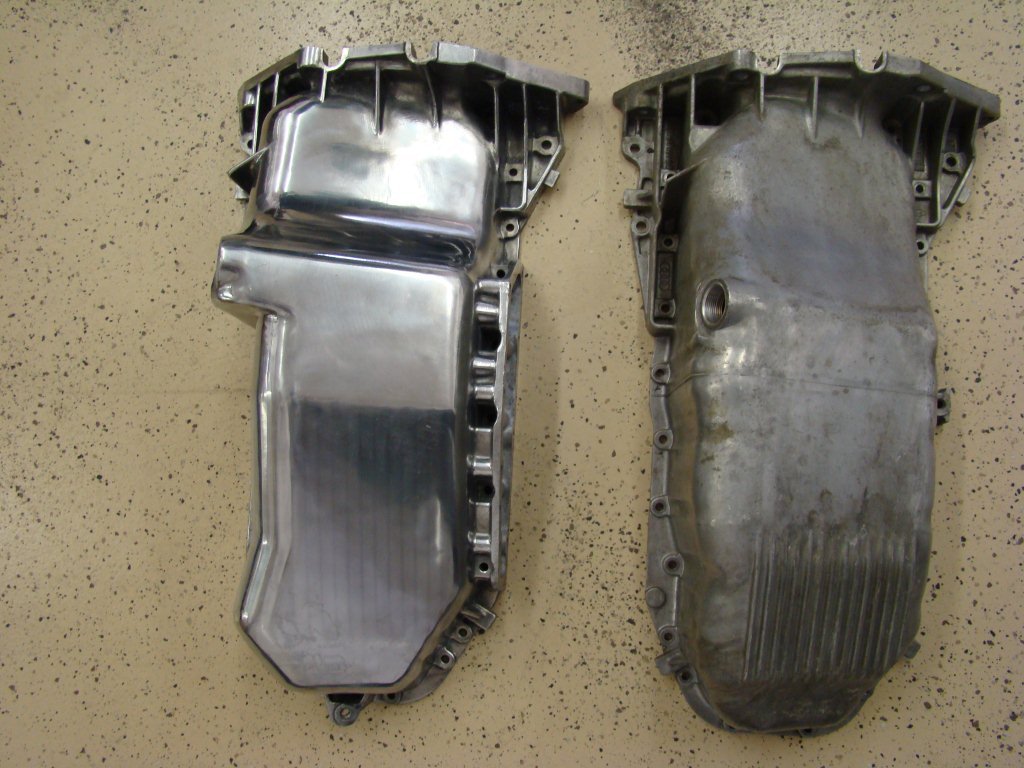

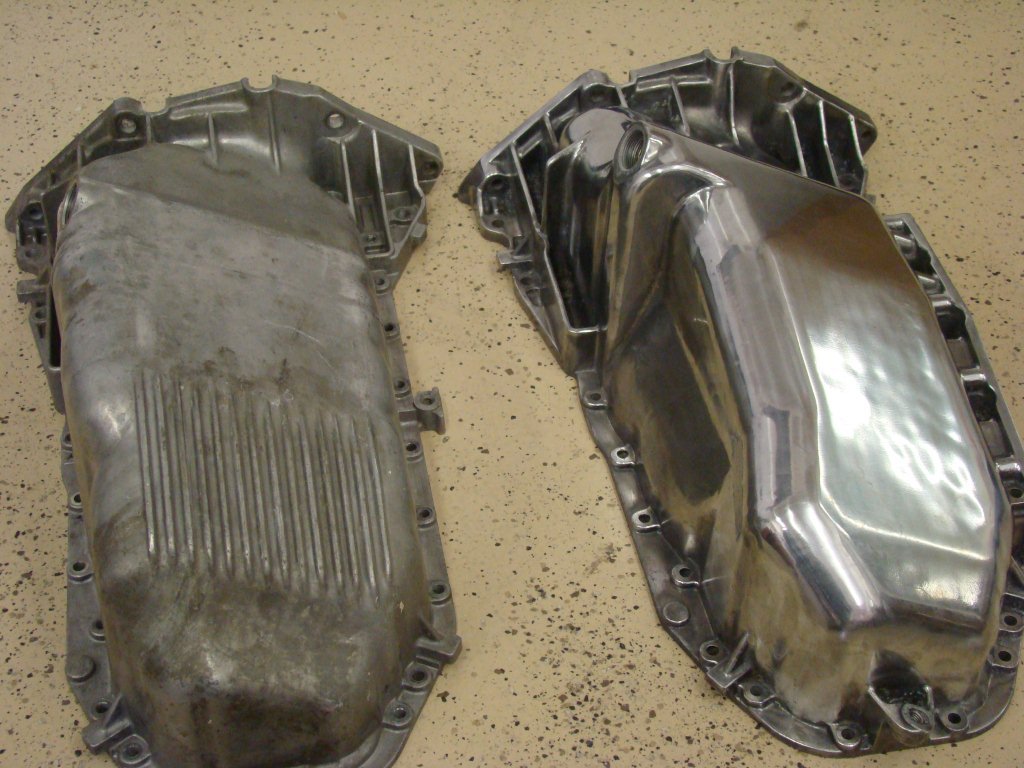

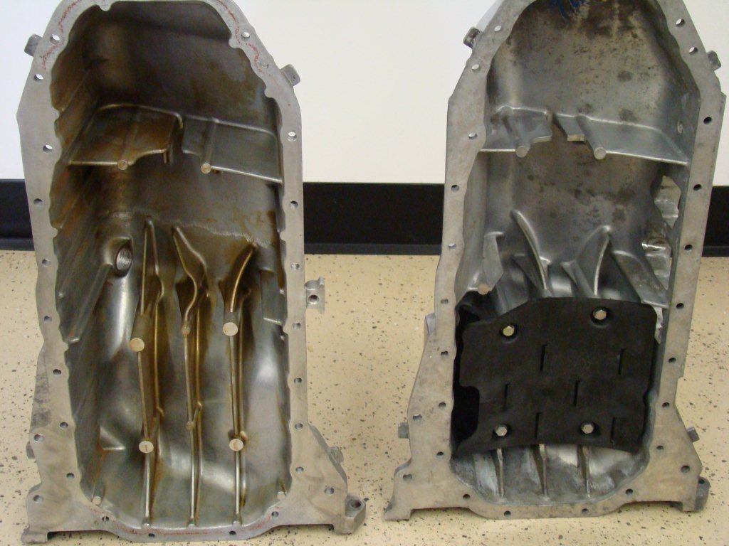

Here are some pics of elbow grease application. some shot comparisons of My 7A next to an AAN pan. I like being able to use the 7A baffle with the AAN windage tray. And yes, I shaved off the cooling fins, made it a lot easier to polish. I don't think it will cause problems. That is what the external oil cooler is for.

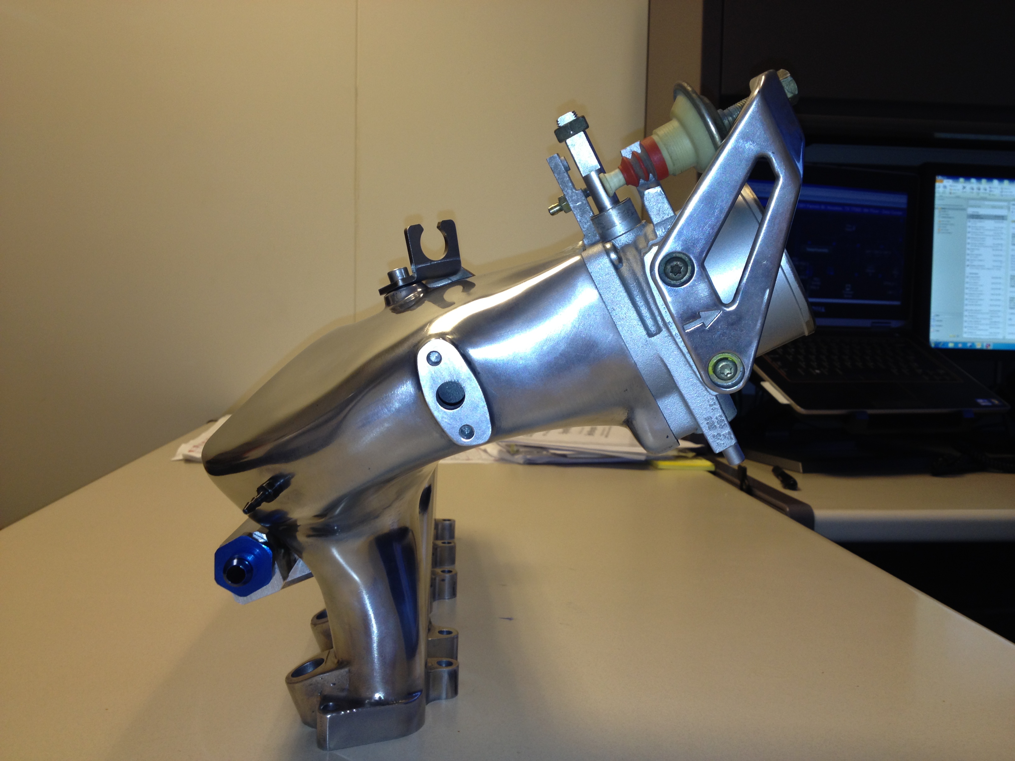

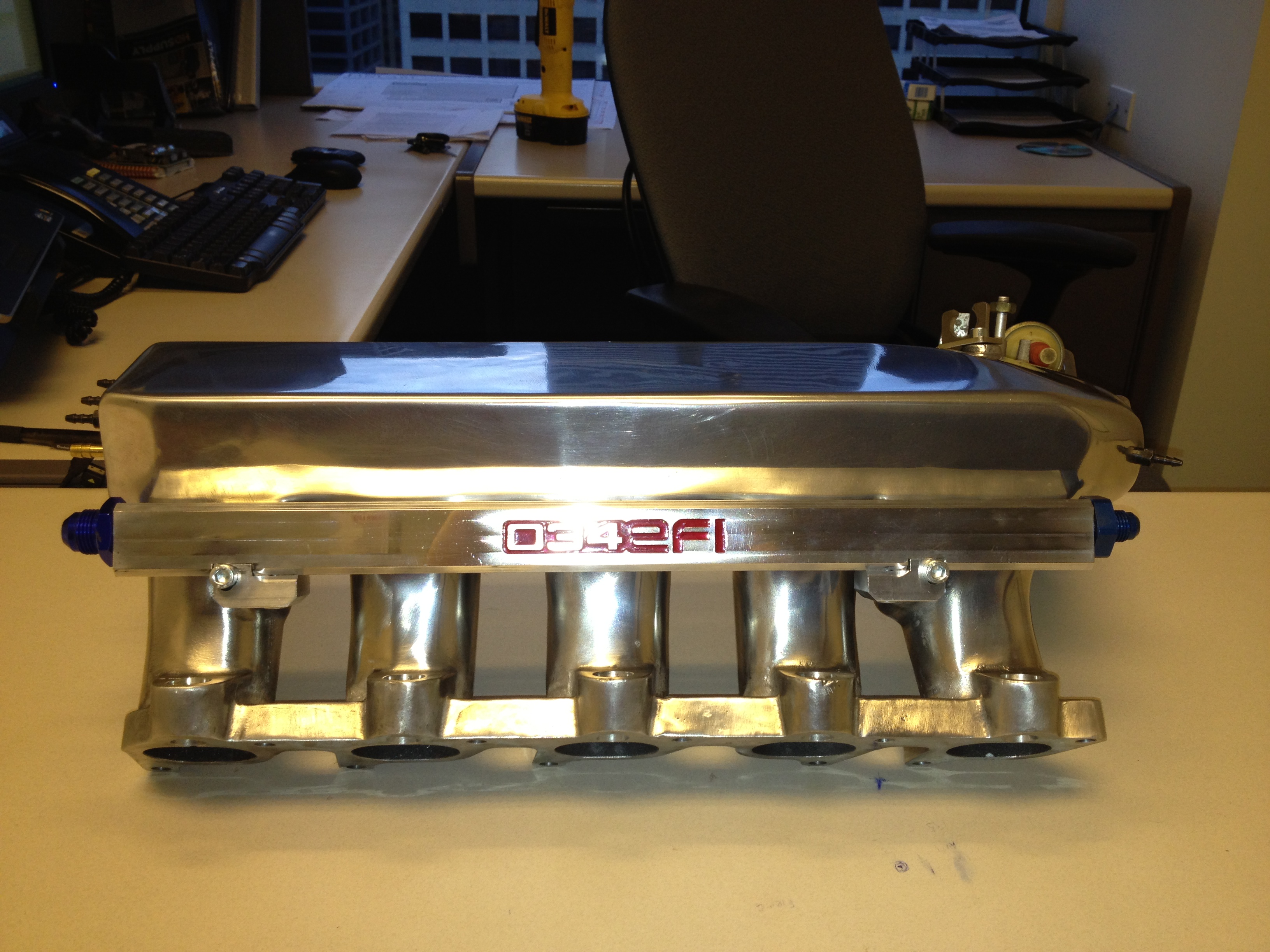

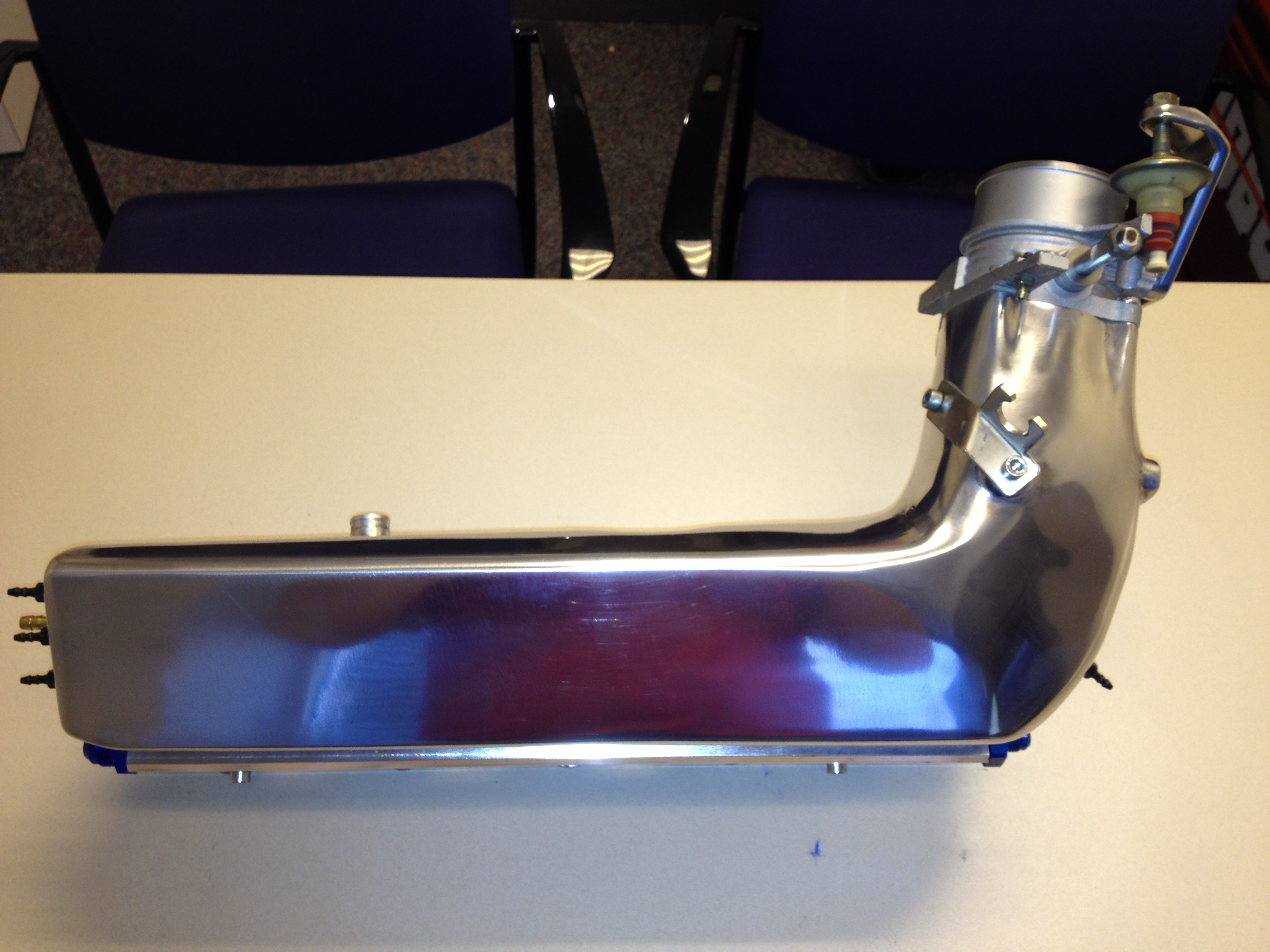

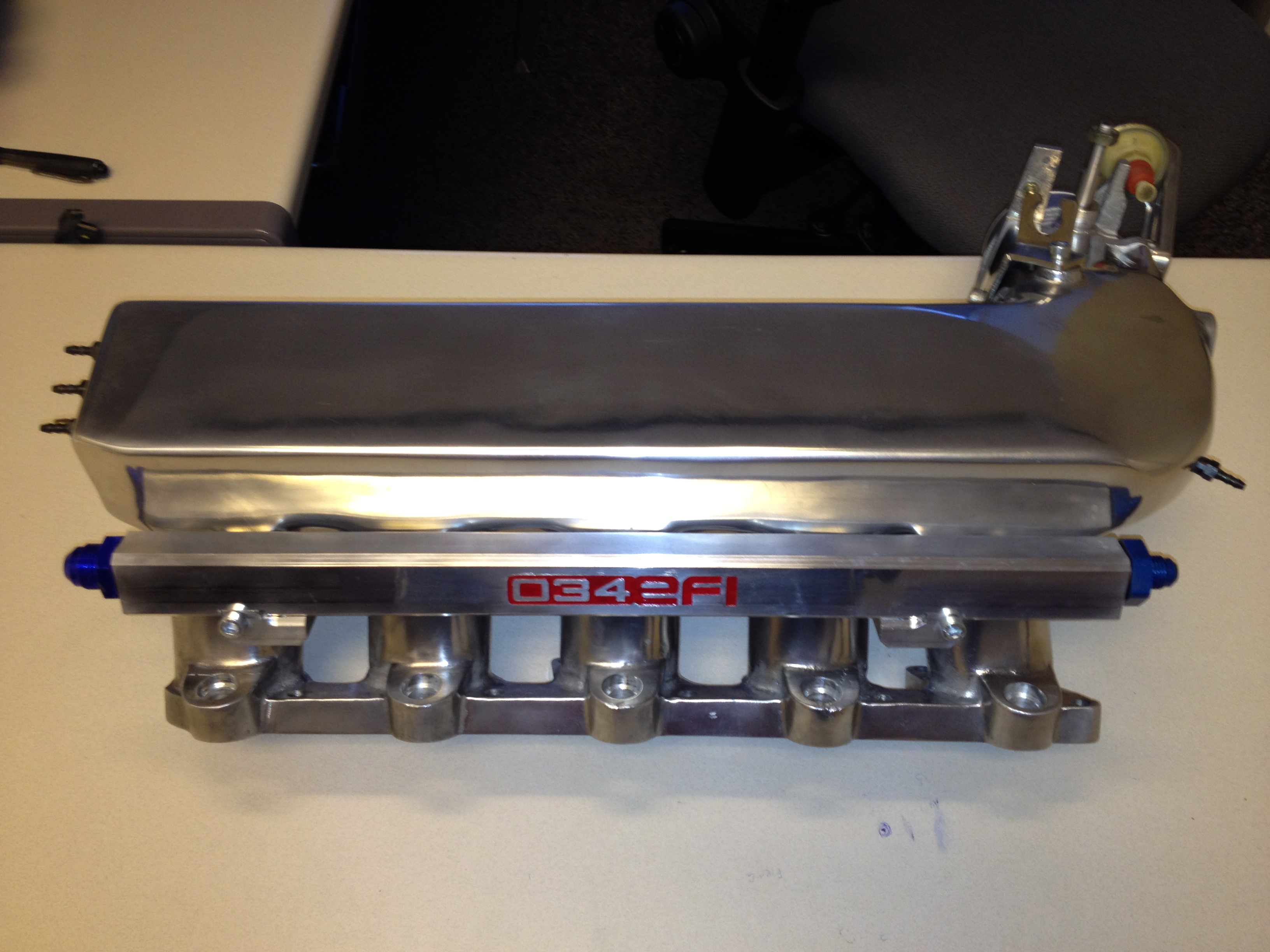

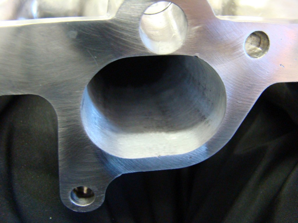

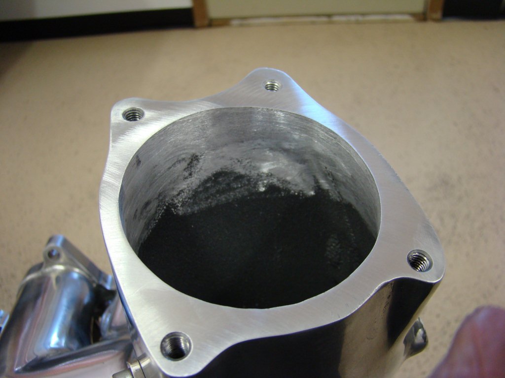

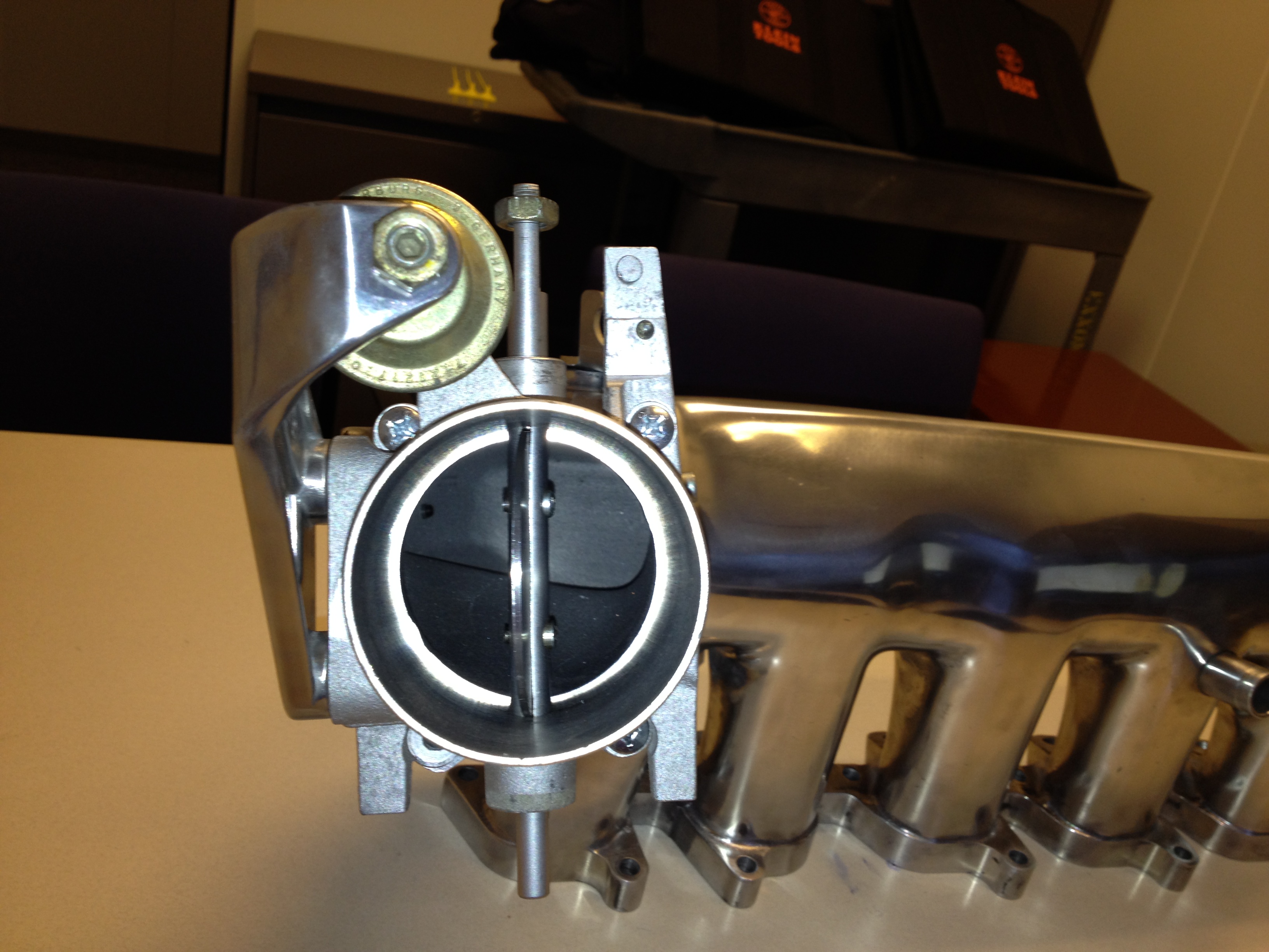

showing some more pics of intake manifold mixed with some more elbow grease. It is a Polished Wagner High Output manifold with a 034 fuel rail that has the runners port matched to the head and the intake bored to match the bored throttle body. In one of the pics, you can see how much ''meat'' had to be removed to match the 70mm throttle body.
2.5TYPE44
Posts: 461
Re: Josh's 2.5 200QT
Post by 2.5TYPE44 »
removing 5mm to match throttle body

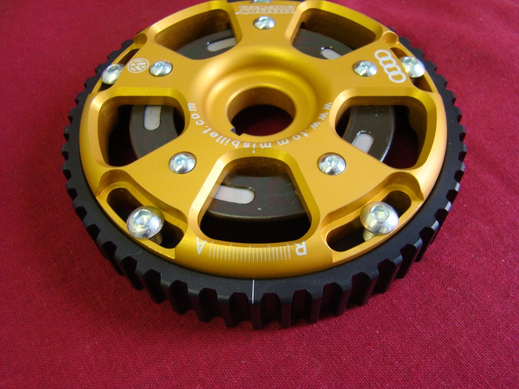

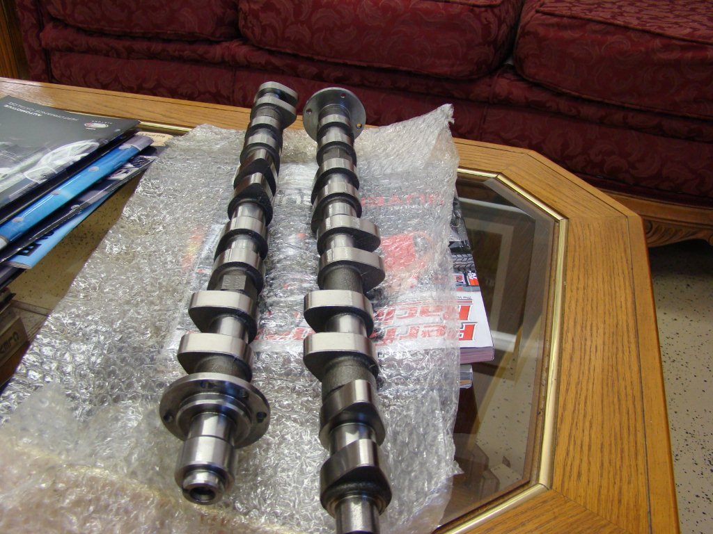

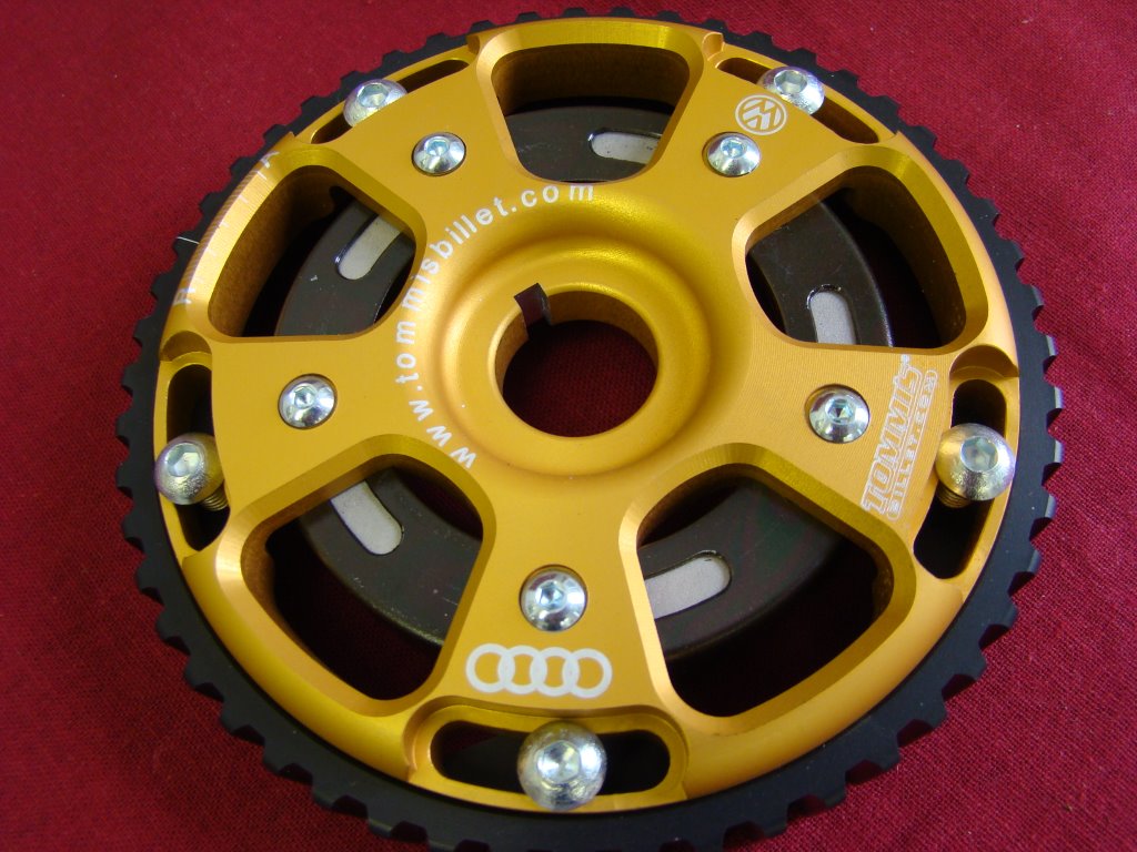

here are some more goodies for the breathing monster. Tommis Billet adjustable cam gear and Cat Cams.

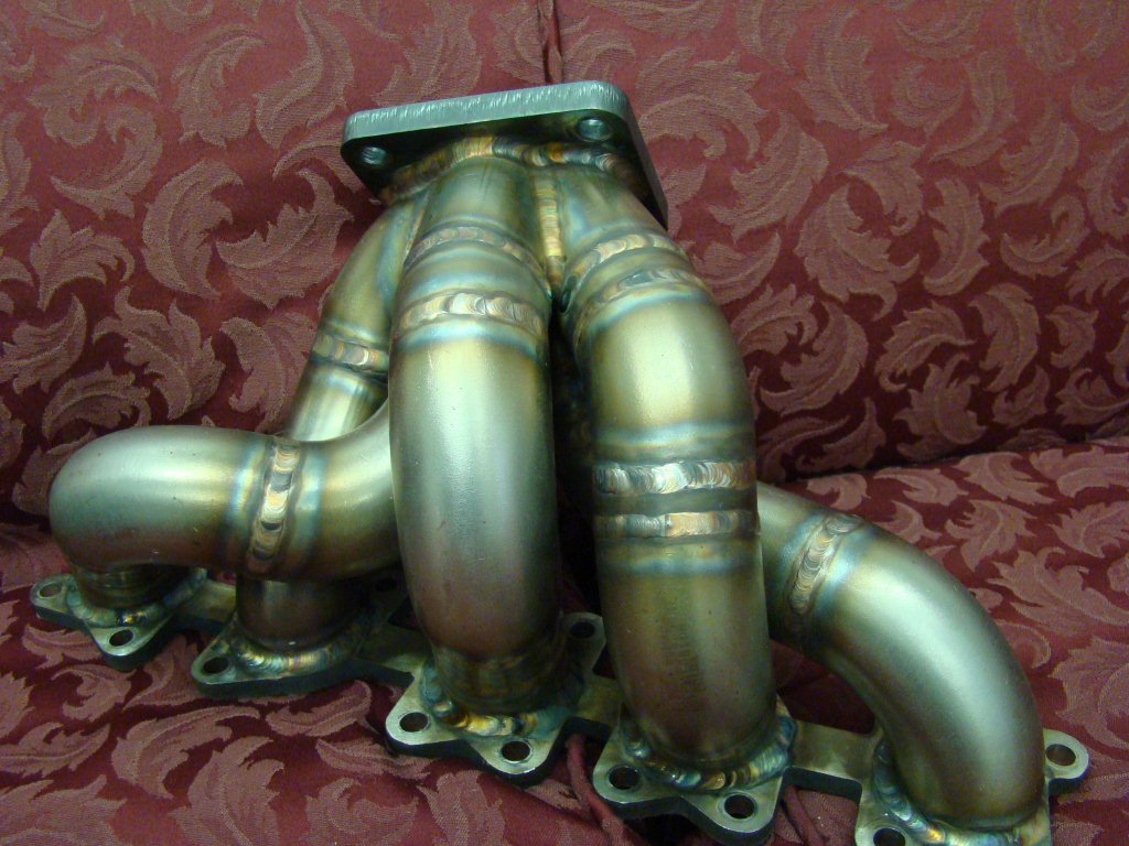

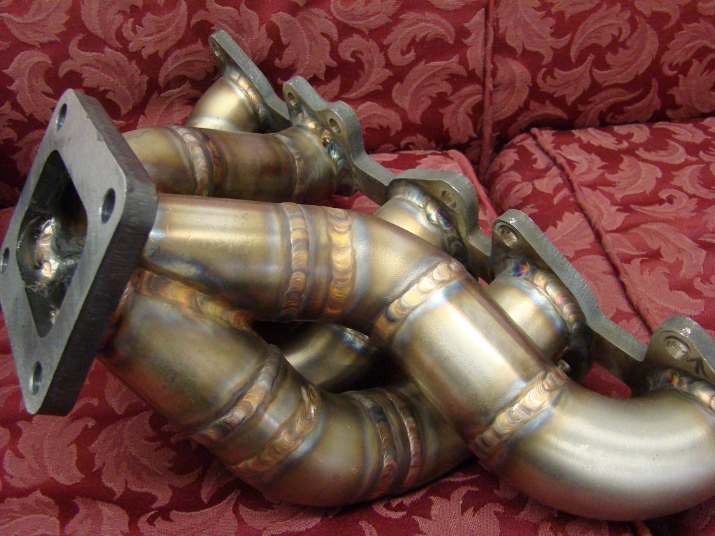

nice high flow stainless exhuast manifold guaranteed for life and proven to flow enough for Jeff's Bonneville race car

I'm still going to use the lightweight hydraulic lifters which is why we are limiting it to around 8000.... maybe 8500 rpm. Jeff had to specify the duration of the cams to Cat as they did not have a pre selected pair of "of the shelf" selection. I want to try to push it as far as I can while still making it a daily driver. I don't want to have to wrench on it and adjust it all of the time. I could be forced to go to solid lifters later if I get greedy for more rpm and horsepower, but I will fight it as much as I can. I'm trying to use self control and not going all out like putting some massive turbo and winding it out. I want to try to build it tough and treat it nice except for an occasional hard pull leaving some loud American V8's in shock as they see a big four door luxury boat blow past them.

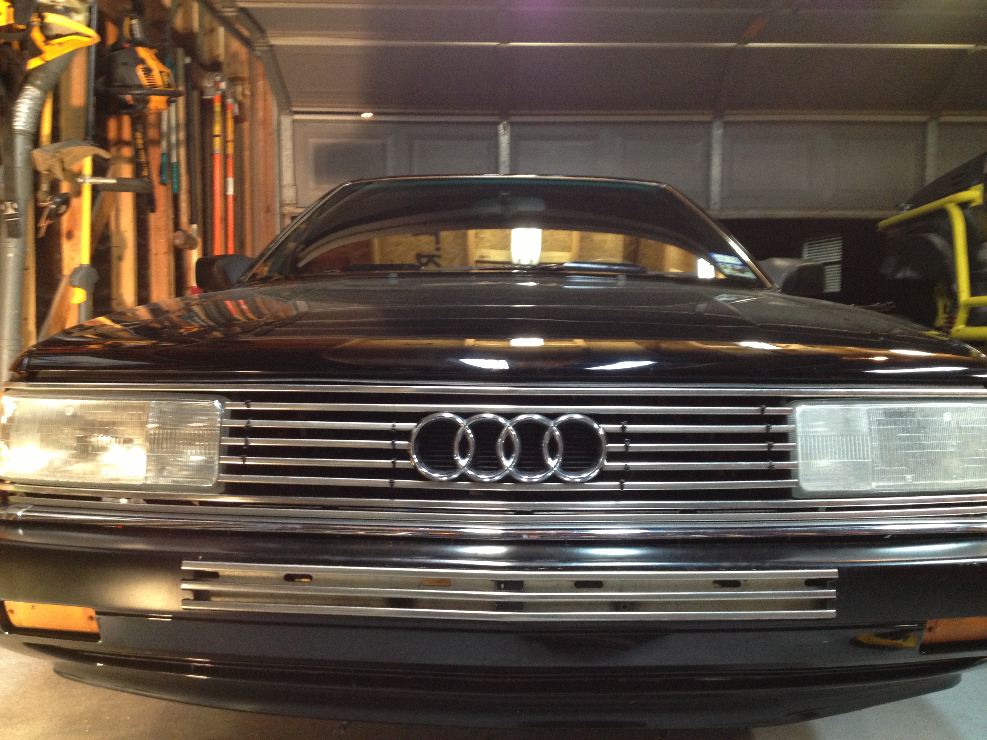

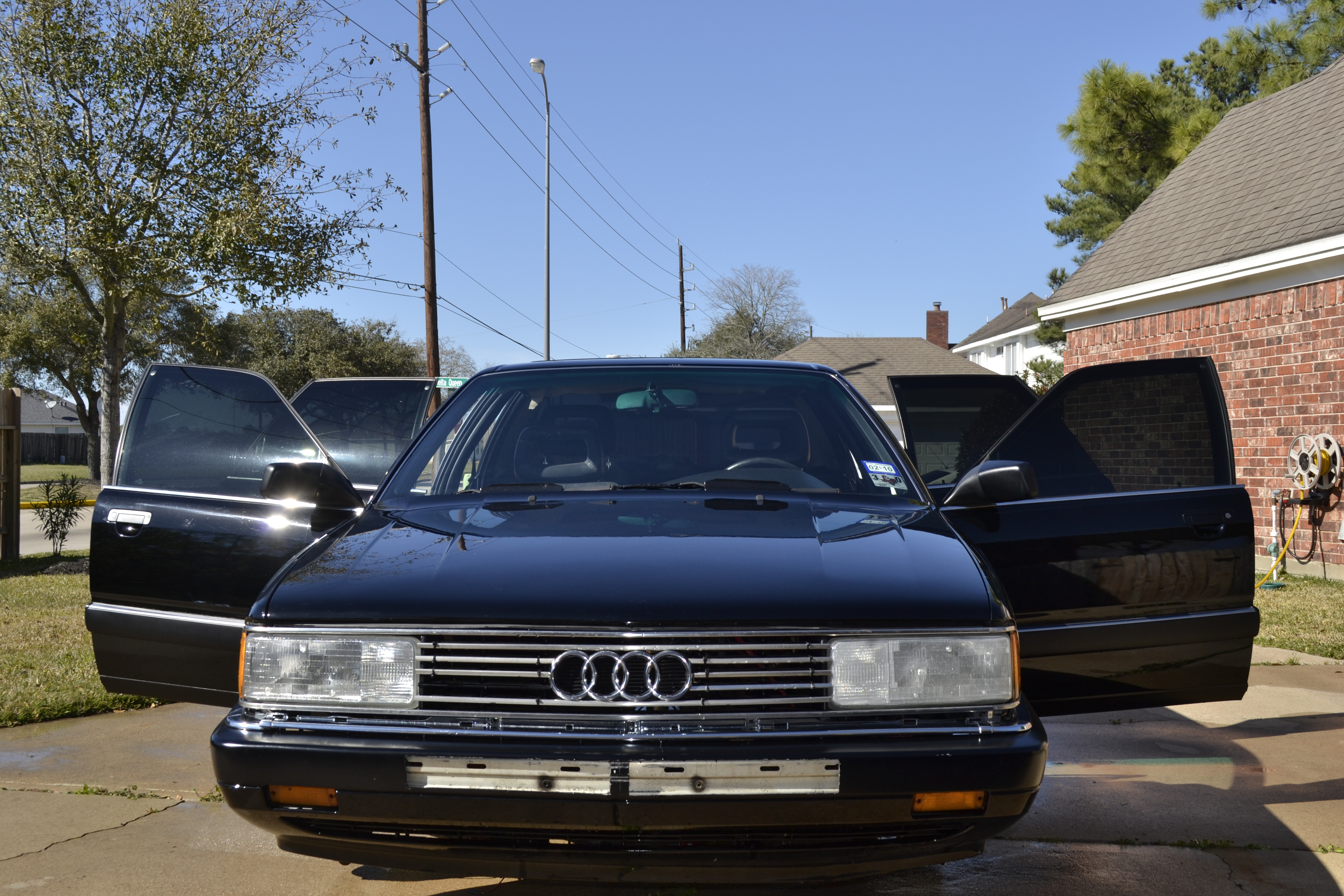

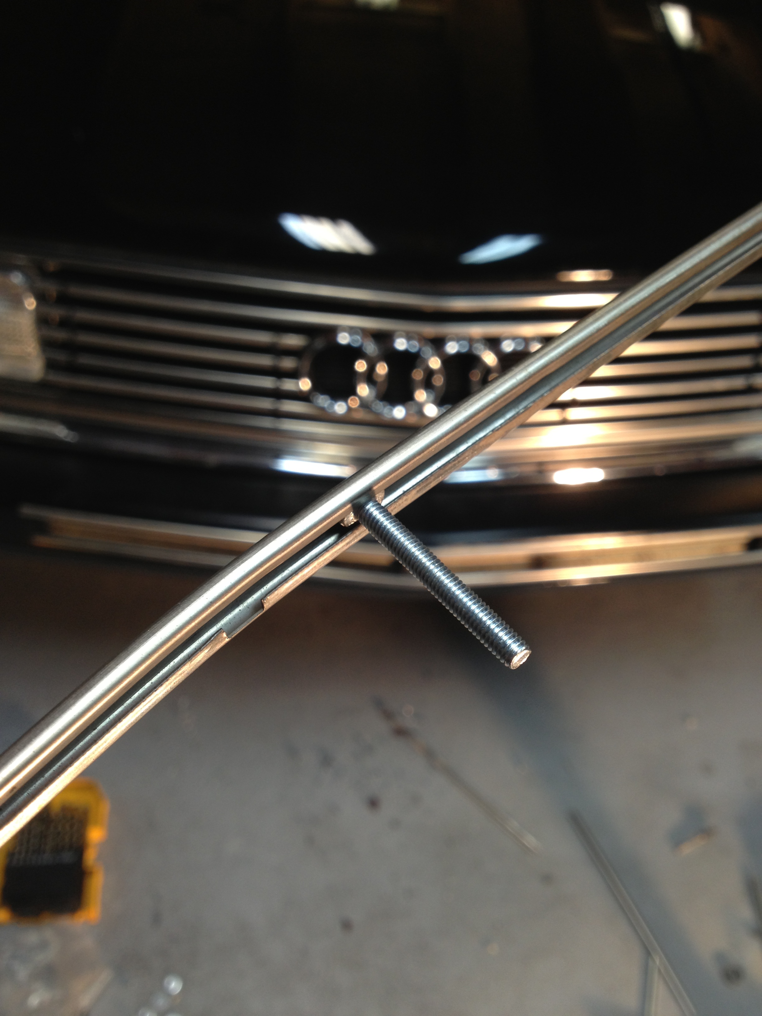

I started changing the front for two reasons.... One is.... you know that rubber filler that runs along the bottom of the head lights?... The one that is no longer available... I had to come up with something to hide the gap. The other reason is... I am going to need to increase airflow to the intercooler up front. So I am working on a stainless grille for the factory grill as well as the bumper. I gathered up some factory 200 trim pieces to keep it as factory looking as possible. You can see where I am adding a long stainless trim all the way across the front just under the headlights and where the black trim used to be which I no longer have. Don't make fun of it yet. I still have tie wraps holding the pieces to the factory grille until I bolt them on. The pieces on the bumper are bolted on. I sloted some stainless bolts to slide into the channel where the factory plastic clips used to be. (hated them, always breaking) I still need to cut out the air slots for the aluminum portion of the bumper. I am cutting just below and above the bends to leave them in there to keep the rigidity and not compromise too much strengnth. I pray that I never have to worry about a collision and if I have one, the air slots I am cutting out will be the absolute least of my problems.
Here are some ''in progress pics''
And what does anyone thing about a small, subtle, low, cowl hood. maybe 1 1/2''

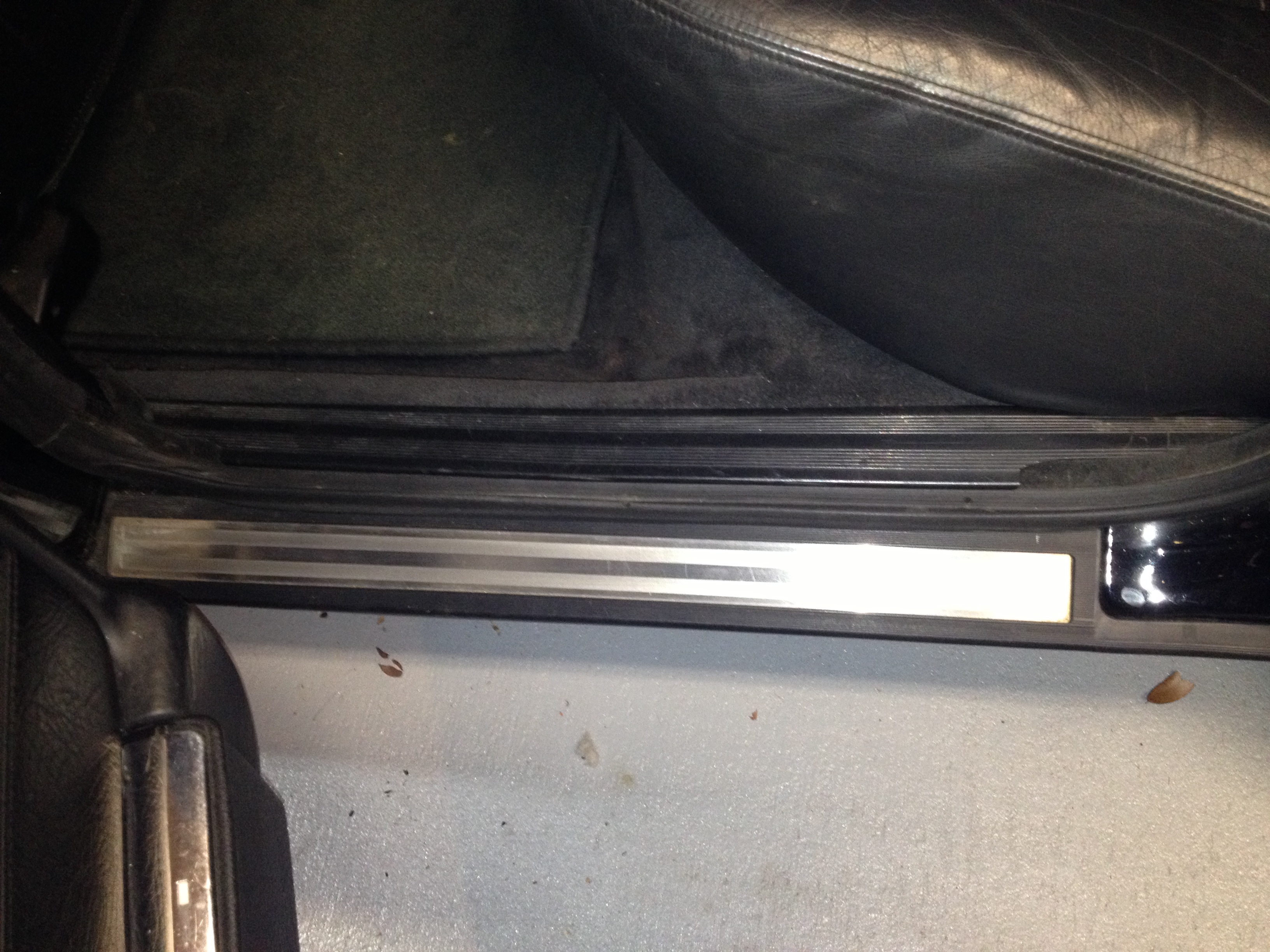

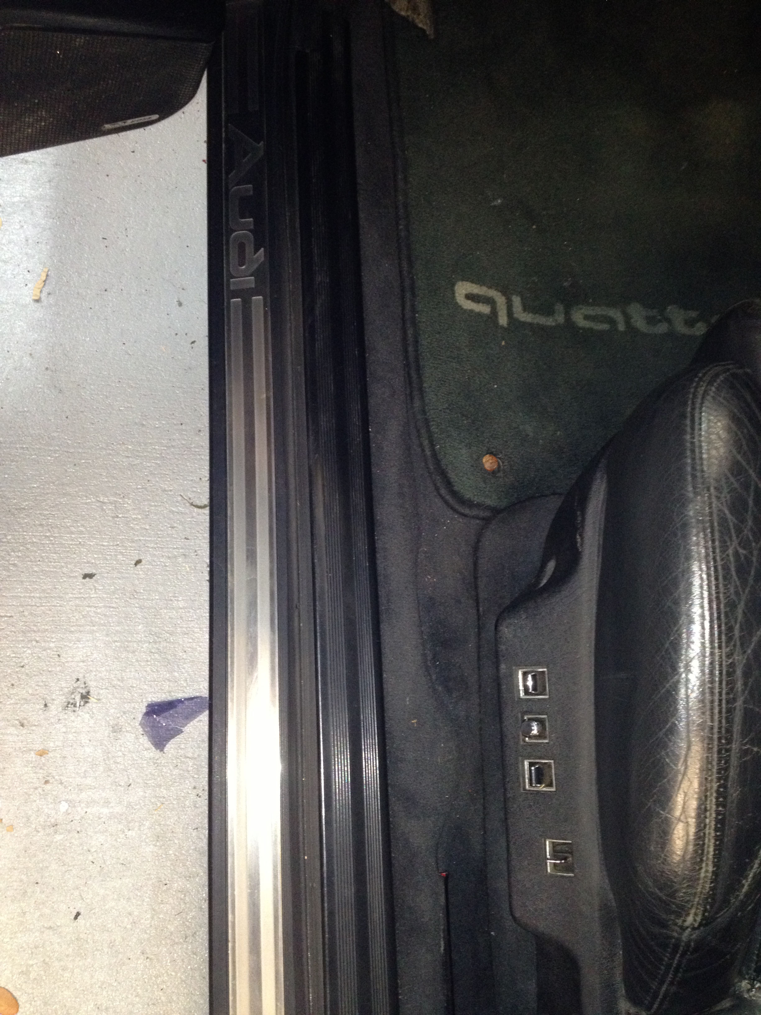

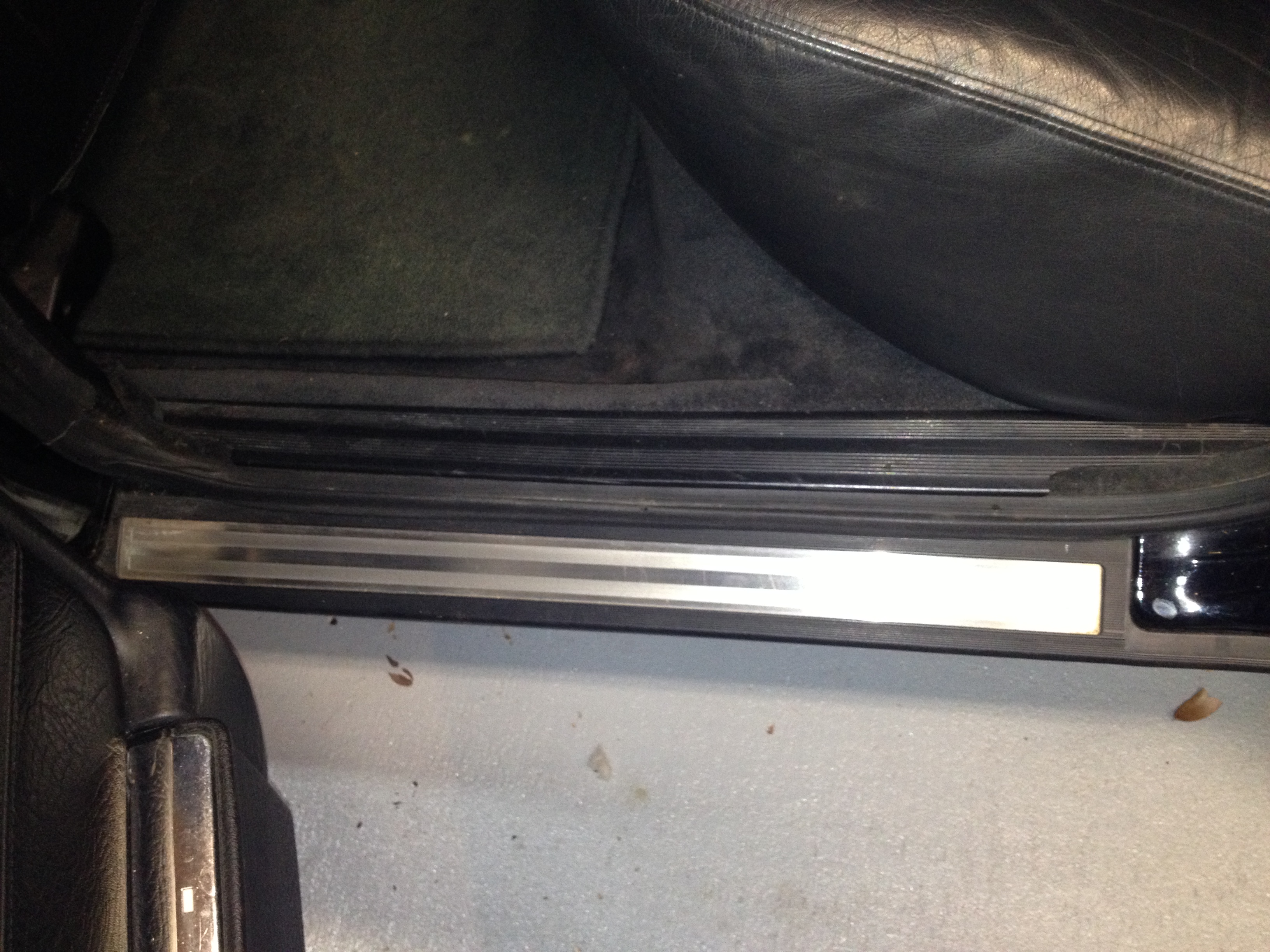

I also added V8 brushed aluminum entry guards with the Audi logo as well as the V8 C pillar trims (I think that is what they are called)
