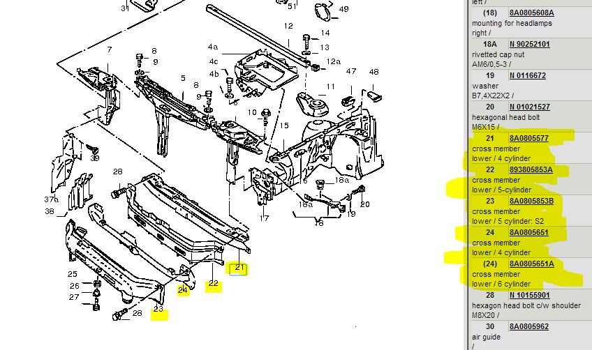

Not true. Without the bumper support ("rebar") there is nothing forward of the engine to distribute load across the chassis in the even of a crash. European cars got a bumper support, it was just fixed directly to the chassis rather than to gas struts (**Edit** - I think this is the same as the NA b3 80/90 front bumper support). You can see the exposed steel bumper support in this picture of a wrecked european Audi 80:
Image[/url]wrecked Audi 80 B4

Re: Pat's 1990 CQ - AAN swap
the german wrote:
Mcstiff wrote:
the german wrote:I would recommend against cutting away the bumper support- it is there for some very good reasons. With what you have marked out there even a low-speed fender-bender would cause a lot of destruction, and anything high speed would be pretty catastrophic. You are adding a lot of power; keep the meager safety structures the car is equipped with. :beer:
Counterpoint, all the B3s and B4s in the rest of the World do not have the aluminium bar. Yes, the euro bumpers have a bit more structure (plastic) but it seems like a safe guess that the chassis was not designed for it to be required. :hide:
That's a cross member (the one in your pic looks like #21 below), all B3/B4s came with a version of one depending on engine; independent of the extra North American (Canada seems to have gotten "US" spec) impact bar housed in the unique non-"euro" bumper.
As seen here:

Alas you are right- that is the cross-member. :hammer:
That said, I still wouldn't run without the bumper support... but I'm rather fond of being alive and having the ability to walk so maybe I'm an outlier here. ;)

We should not forget the large number of Europeans in wheelchairs because of the great Audi crashes of the 90s :P
I'm for safety but, as I mentioned, I believe the chassis was designed without the bumper bar. It's main existence was to suppord the modular US bumper which was required to meet the US requirements that minimal damage occurs in impacts <2.5mph in an effort to limit the "maximum feasible reduction of cost to the public and to the consumer" http://en.wikipedia.org/wiki/Bumper_(au ... essional-5
To bring this detour full circle, notching for a FMIC is not a big deal.
