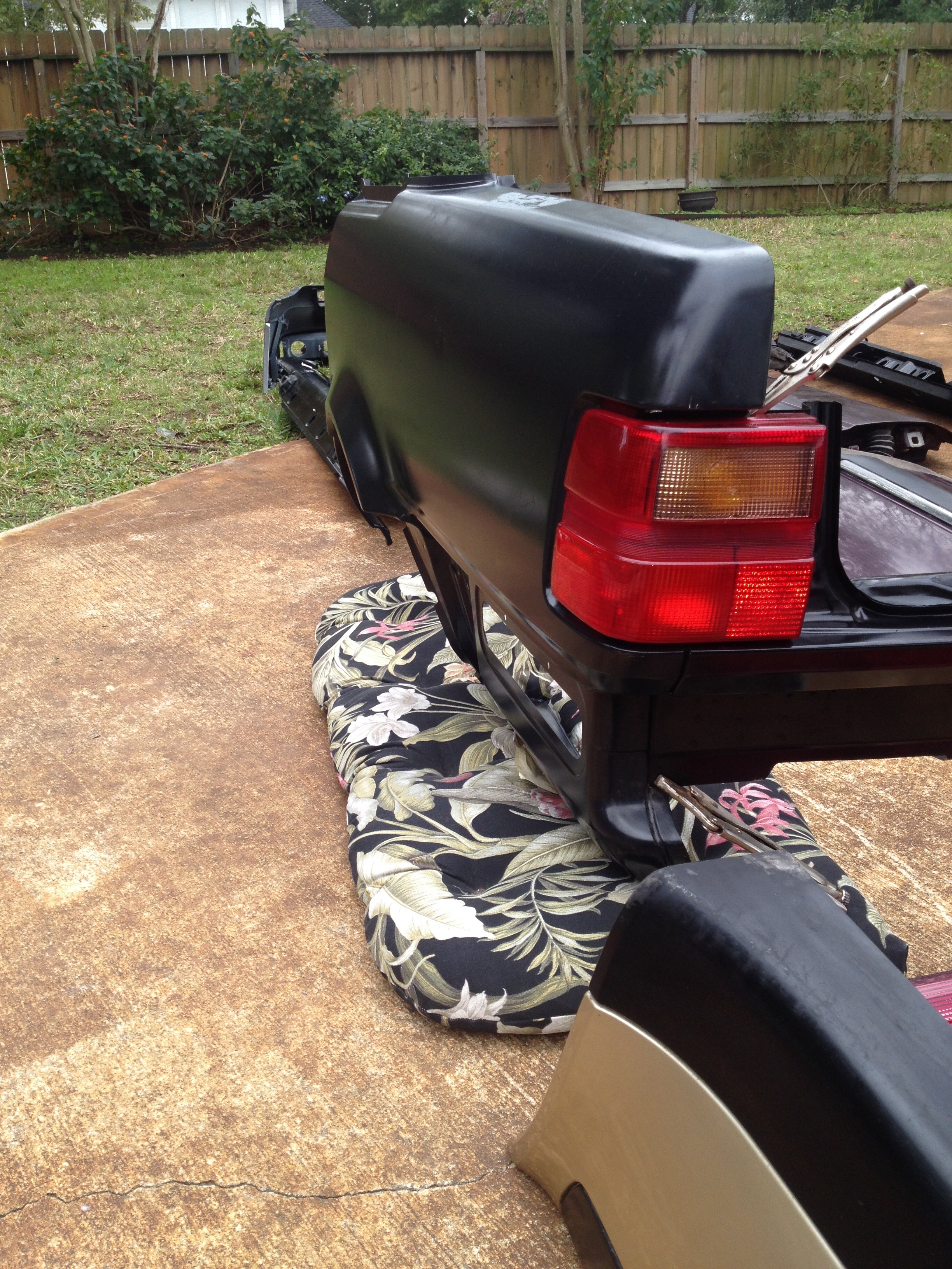

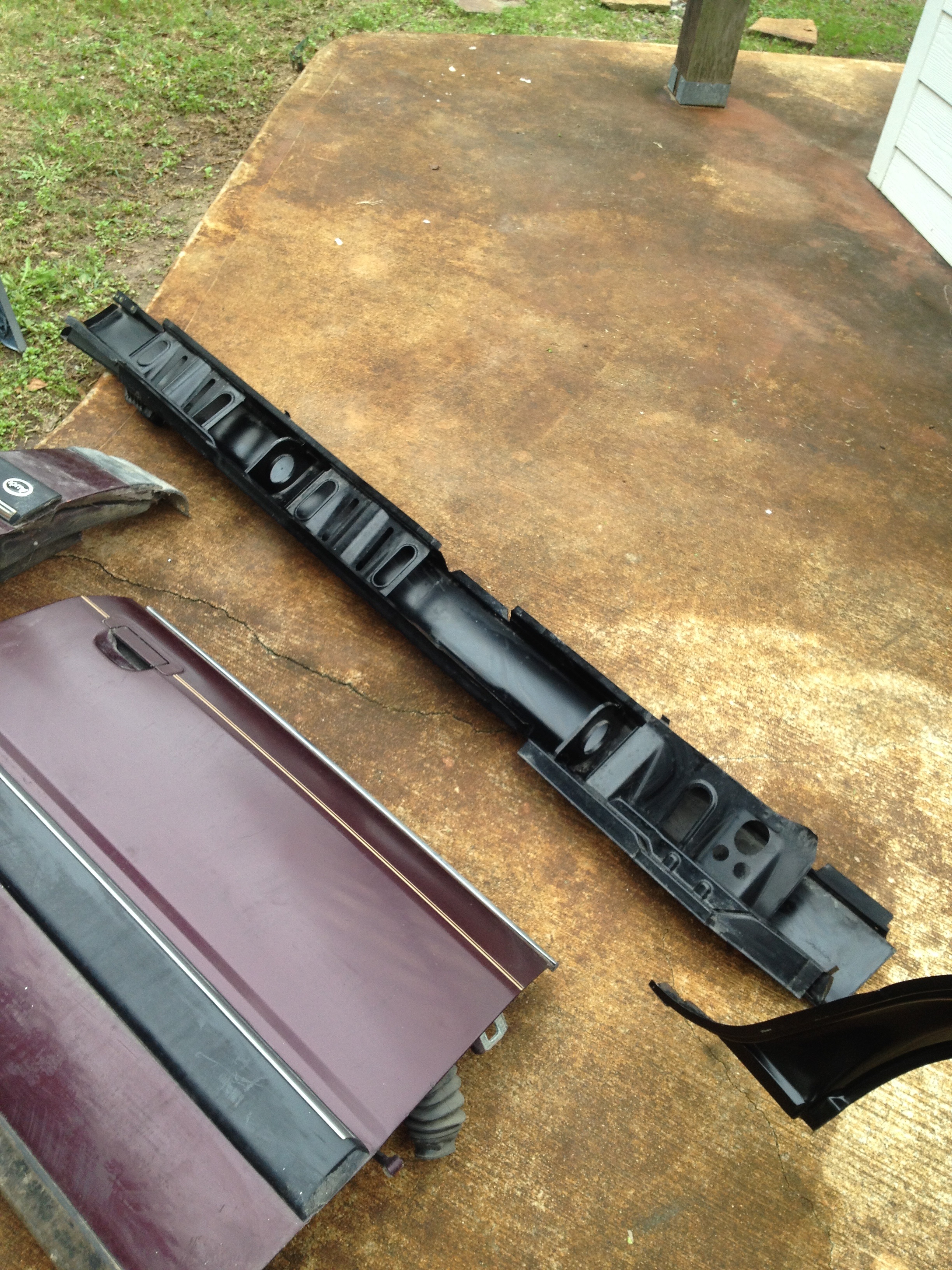

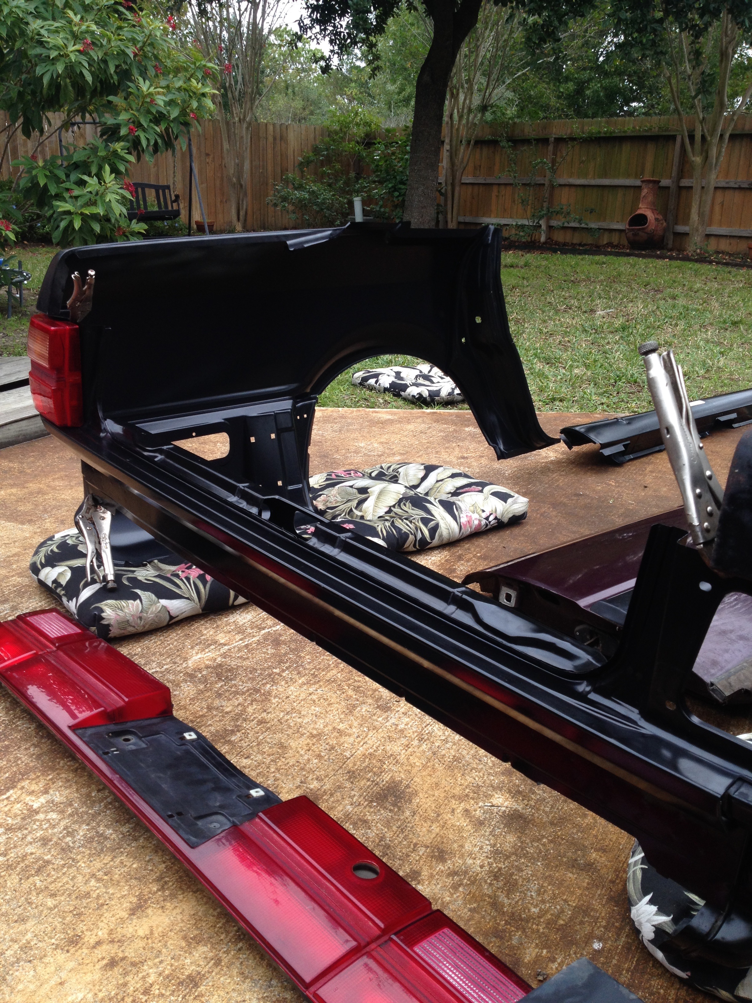

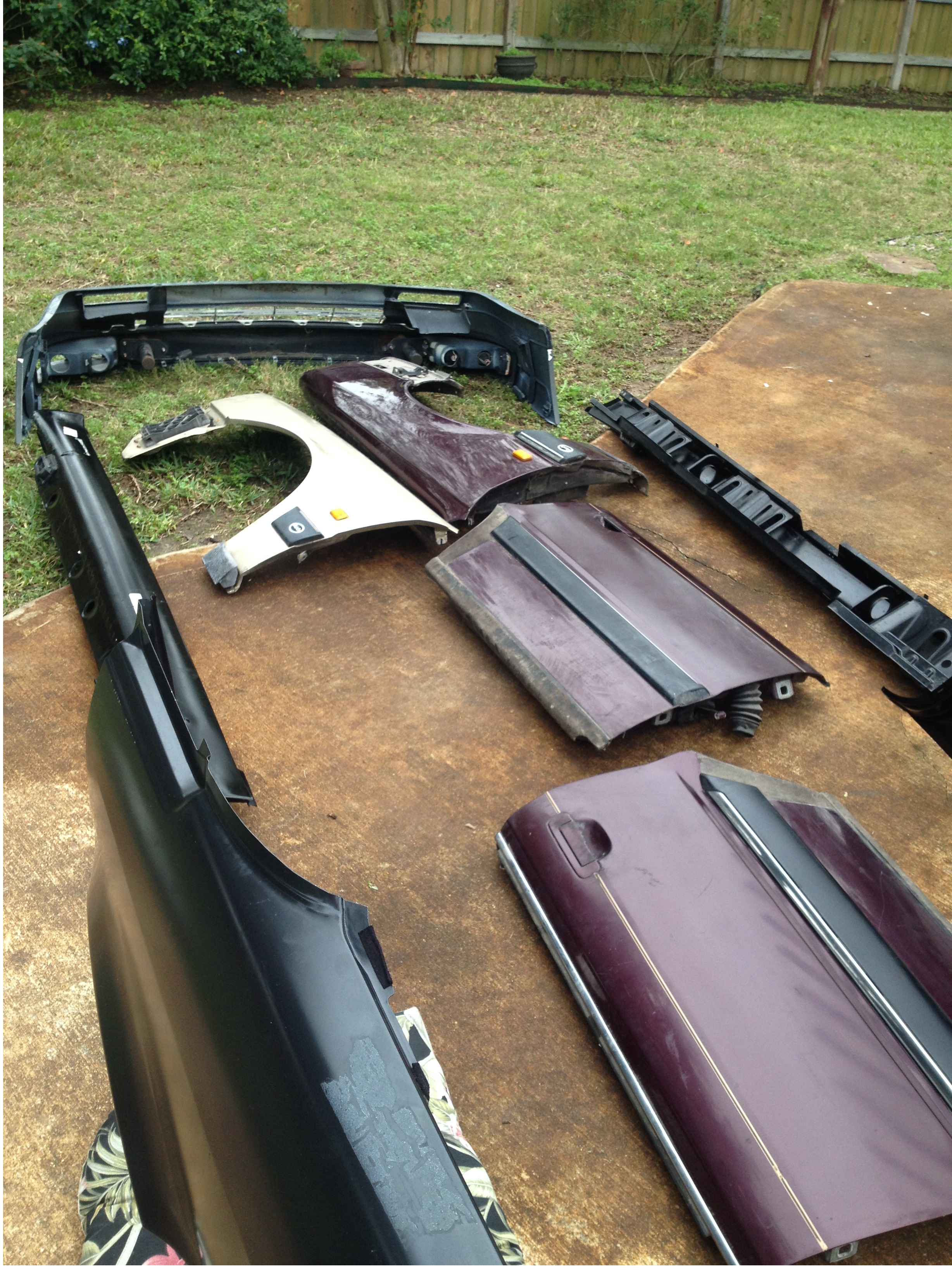

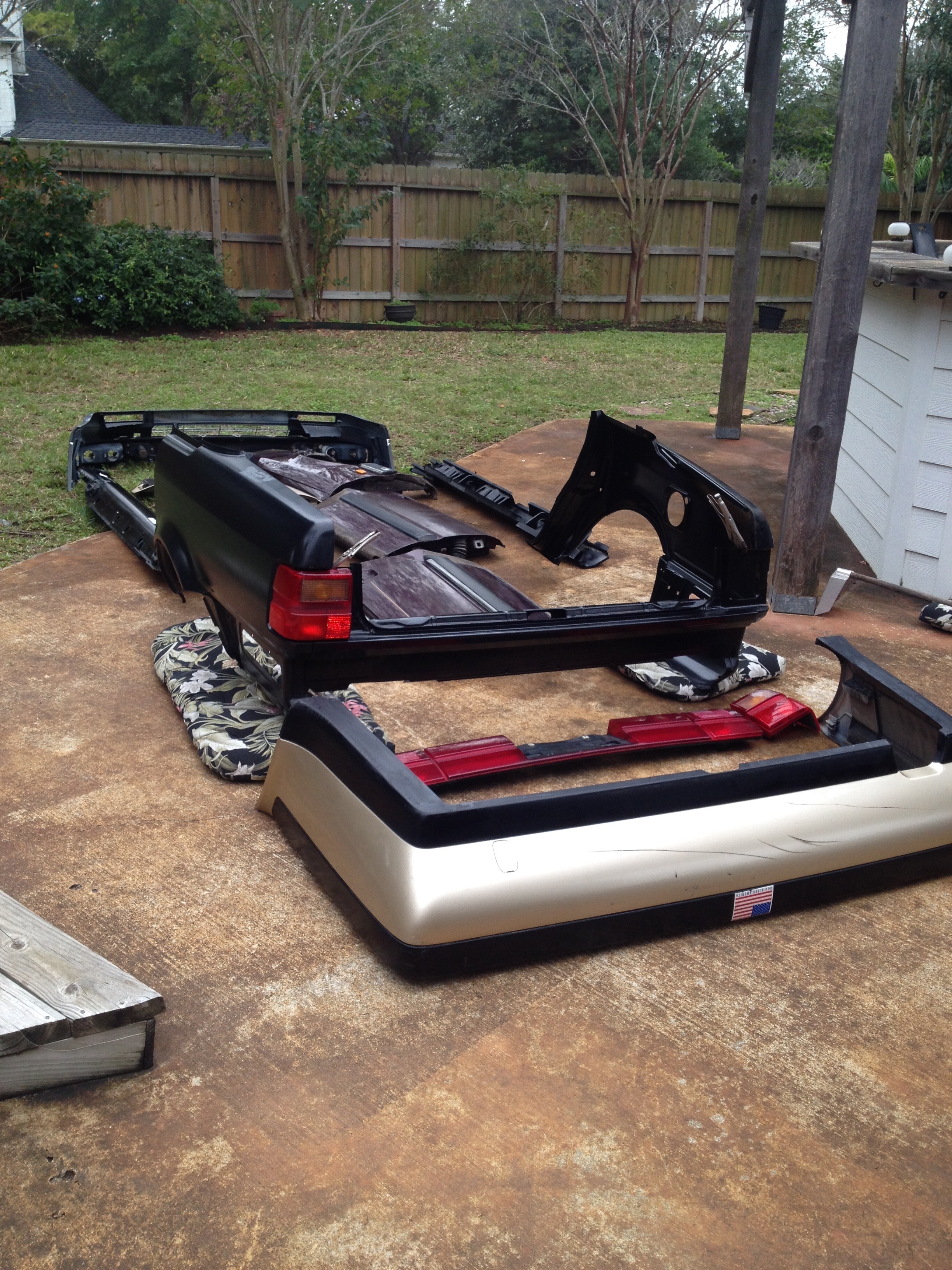

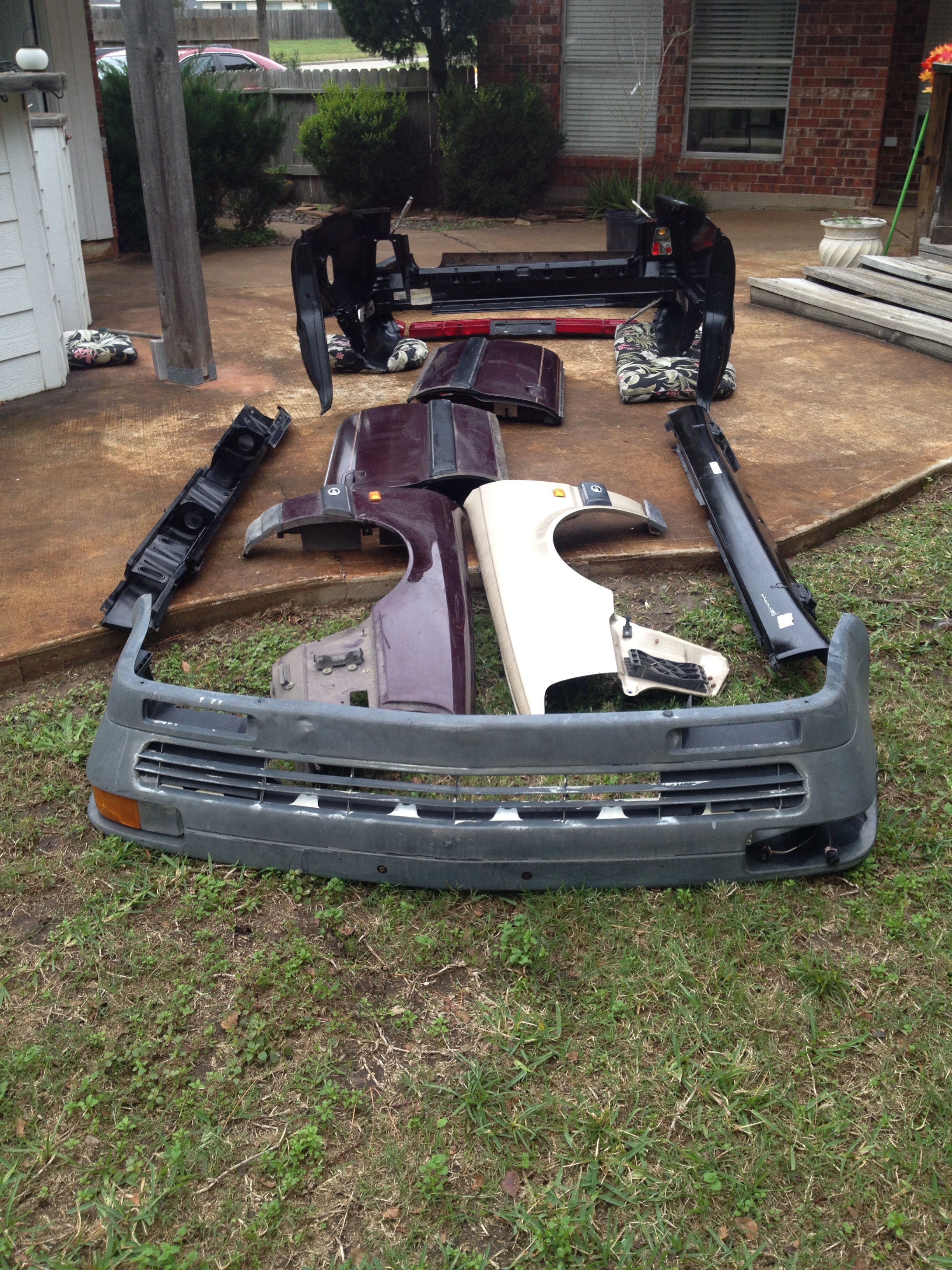

I have been wanting the V8 body, but with my motor and trans. That has got to be the best type 44 combination that was never made. It is not practical to cut up a V8 donor car to take the panels unless you are a body guy. The time it would take to clean where you had to drill out the spot welds and pry on the panels to get them loose from the donor car would add up to a lot of time at a body shop if you could find one to agree to mess with it. So I was super excited to run across brand new OEM Audi sheet metal to do a complete factory V8 conversion. This has got to be one of my best finds yet. Super rare and definitely not available anymore or in any warehouses. I found some old pricing that showed when they were available that the rear quarter panel was selling for $745.00. I don't even want to think about what the rear center section cost or the V8 rocker panels. The rockers are heavy duty. Someone ordered these V8 body panels about 15 years ago to do a conversion and has been sitting on them and done nothing with them. So I jumped at it first chance. It is amazing what some people have stashed away in their barns. Having new panels makes it somewhat feasible to do the swap. The car is a sentimental car and I know it would have been cheaper to just buy a V8 donor car and put my motor in it, but I am not parting with this car.
I am going to run the car for a while as a 20 valve bodied ''sleeper'' for now, but I have something stashed away for when I go to paint the car again. I really wish I had the V8 rear fenders to allow for some real fat tires and deep dish wheels. I also want to put flares on the front. I cant decide if it is going to be the 200 20V fender or if it is going to be the V8 fender with the 200 lights grafted into the fender. it seems that the V8 front fenders ''overtake'' the rear V8 fenders and a nice combo would be 20V front and V8 rears.
So I definitely will (eventually) go with...
1. V8 rear quarter panels
2. V8 Rear bumper (Really want to cut the rear and add air foil)
3. V8 rocker panels (unless I can blend the v8 doors and 200 rockers and make it look decent)
4. V8 rear doors
5. 200 Europoean Type 44 headlights
6. 200 Grille
7. ???? Use 20 Valve fenders or V8 Fenders and graft in the 200 lights???
8. V8 front bumper with CAC clear lenses to match the Euro headlight reflector.
4. V8 rear doors
6. 200 Grille
- V8 Conversion 2.JPG (2.87 MiB) Viewed 35140 times
- V8 Conversion 7.JPG (2.97 MiB) Viewed 35140 times
- V8 Conversion 6.JPG (2.84 MiB) Viewed 35140 times
- V8 Conversion 5.JPG (3.12 MiB) Viewed 35140 times

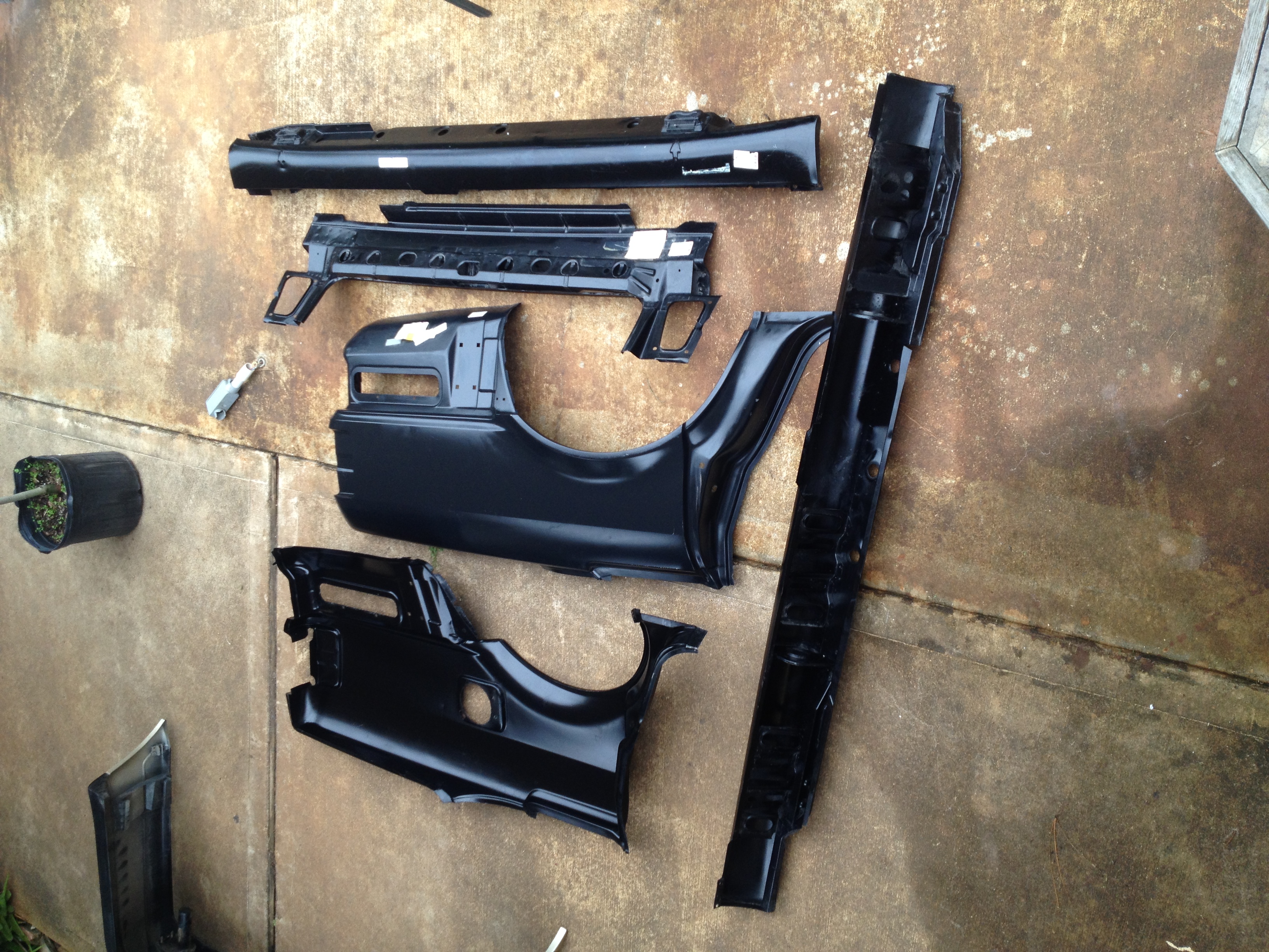

more pics

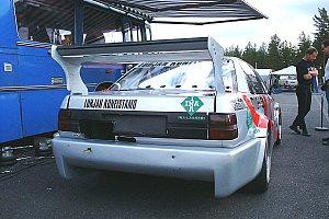

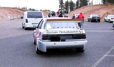

It would be kind of cool/unique to alter a V8 rear bumper like this and then add two splitters to separate the wind flow into two small outer sections and then one larger in the middle.

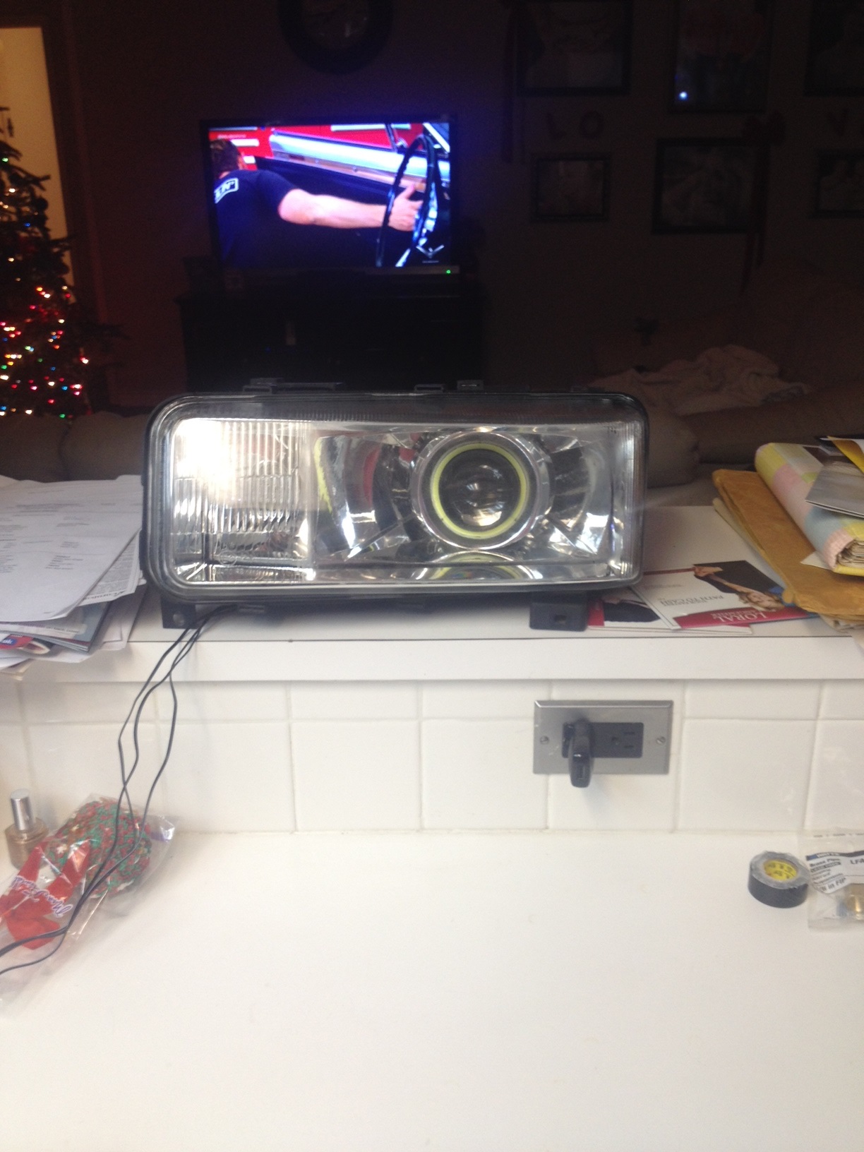

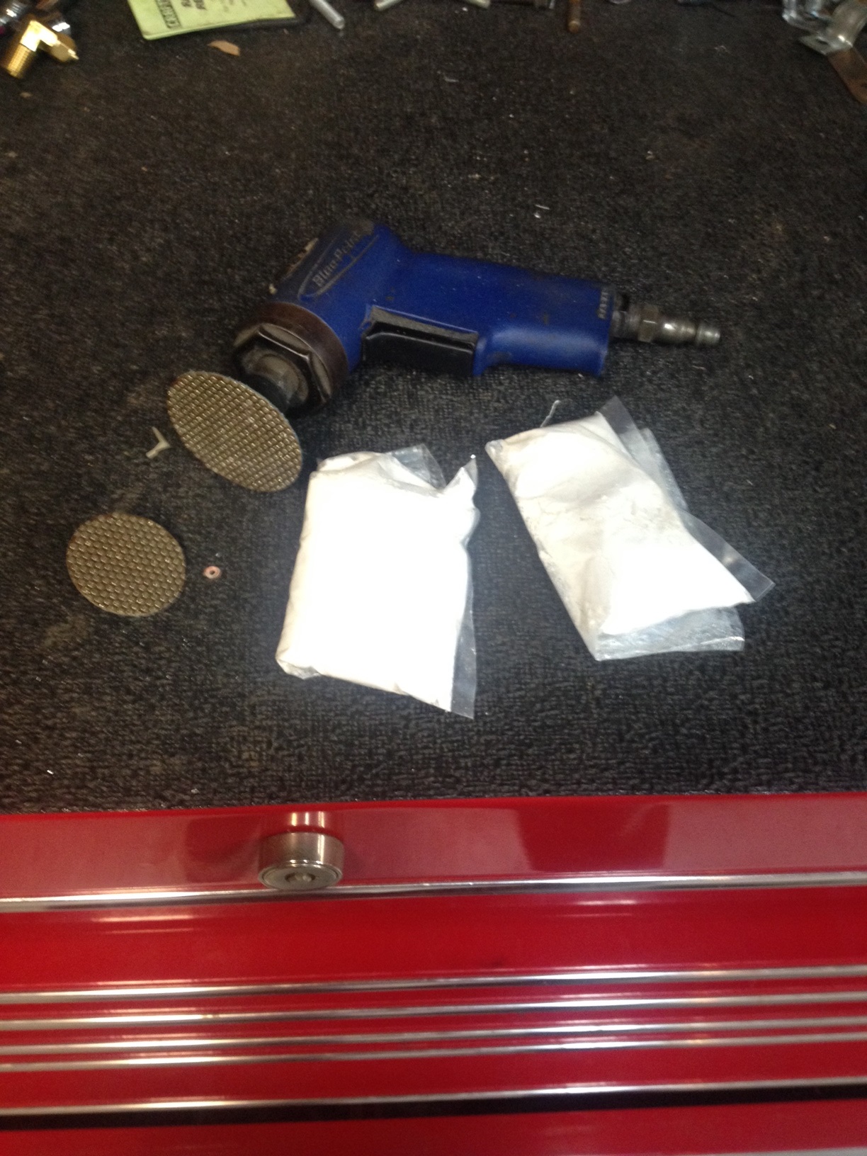

The solution is time/patience/diamond pad/air sander/water. Another hour of polishing and it should be to where I am happy with it. I didn't think it would come to doing this myself. I figured I could drop the pieces off to a glass shop but no one wants to touch them. So I had to do them myself.amd is the best wrote:I haven't been following this close lately however the headlights look like they're coming together great man! Let me know when you have a solution to the glass and I'll be sure to do the same
Here is some tips...
1. watch out for heat! It can get hot quick and possible shatter.
2. don't try to go to fast.
3. don't grind/sand too much. You can't put the glass back
4. get a cooking pan filled 1/4 way up to keep the glass partially submerged in water for cooling
5. tape the perimeter area off that you don't want to hit with the sander. It gets hard to see where you need to hit when you get the slurry water in the glass.
6. you don't need much cerium oxide. a small pinch will last forever. The stuff is awesome. You can't do it with out it.
- glass polishing.JPG (547.87 KiB) Viewed 35081 times

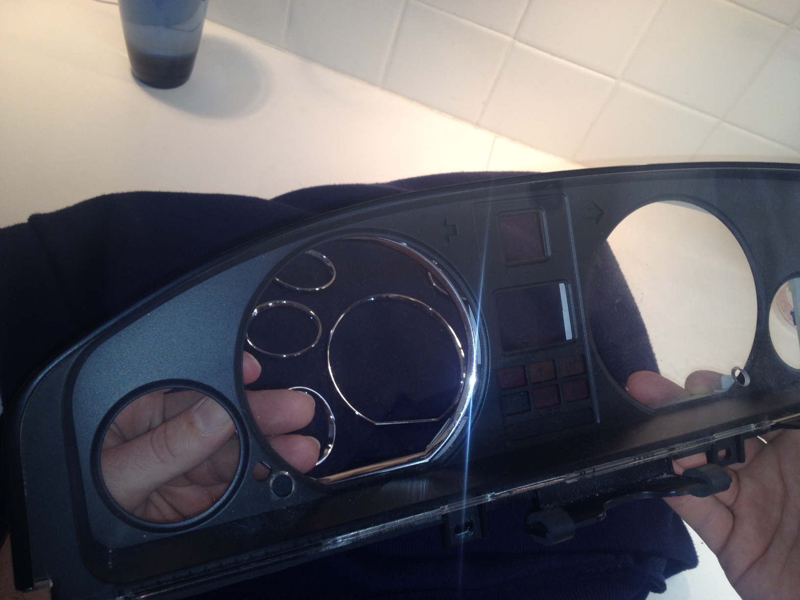

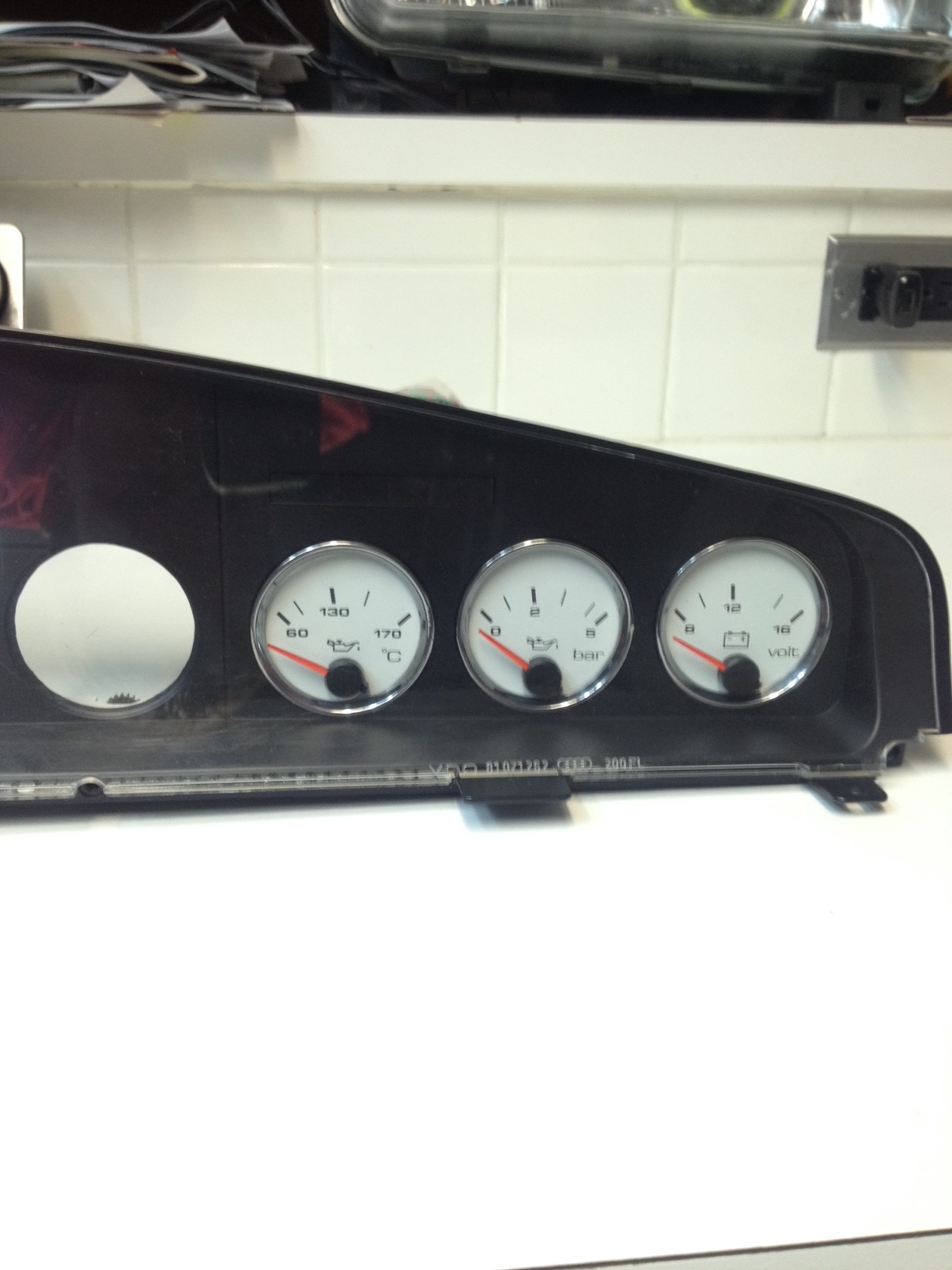

I couldn't leave the dash alone. After adding the white face gauges, I decided to add bezels from an A6. Then I decided to have the bezels from the A6 chromed. I sent them to some place up north called Paul's Chrome. They turned out really nice. I just had to polish some of the copper and nickel plating off to get them to seat back into their holes. I think the last think I might do is have the chrome bezels pin stiped with a small red ring to give each gauge some contrast. The chrome tends to take the color of whatever it is near.
- chromed 2.JPG (454.96 KiB) Viewed 35077 times
- chromed dash.JPG (294.1 KiB) Viewed 35077 times

DUDE! These came out great! I need to do it. Can you let me know specifically which abrasive disks you used?2.5TYPE44 wrote:The solution is time/patience/diamond pad/air sander/water. Another hour of polishing and it should be to where I am happy with it. I didn't think it would come to doing this myself. I figured I could drop the pieces off to a glass shop but no one wants to touch them. So I had to do them myself.amd is the best wrote:I haven't been following this close lately however the headlights look like they're coming together great man! Let me know when you have a solution to the glass and I'll be sure to do the same
3. don't grind/sand too much. You can't put the glass back![]()

Glad those NOS V8 panels worked out for you Josh. I've still got that other V8 fender.
Re: Josh's 2.5 200QT
Thanks Scott. I'm actually leaning more to have the 20Valve front fender with the V8 front bumper and 200 Euro lights. I have a V8 fender and a 20V fender. Want to trade a V8 for another 20V fender to match? I should have my car back in the next two weeks to start on that part of the project. I'm getting pretty excited to have my car back to start working on it again.
