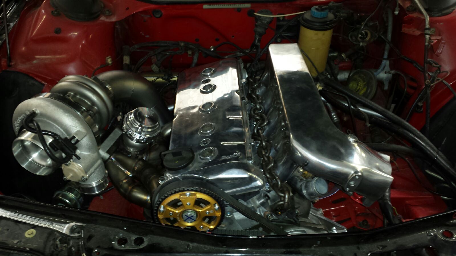

1000rpm is extremely over the top. Jims 2.3L would spool almost identical to my 2.6L with the same turbo/manifolds. My 2.6L would spool around 500rpm sooner than a 2.2L for reference. So It gives a nice 500rpm bonus of turbo efficiency that would otherwise not exist. Nice upgrade
2.5TYPE44
Posts: 461
Re: Josh's 2.5 200QT
Post by 2.5TYPE44 »
Even better for a daily driver. :)
2.5TYPE44
Posts: 461
Post by 2.5TYPE44 »
So using that comparison... My 2.5 with quick spool valve and the EFR turbo, I should be able to spool faster than your 2.6... :D
Yes. A short rod ratio wil help spool the turbo as well, which a short deck 92.8mm motor does vs a 159 long rod tall deck. If I had to guess, I'd say this big 63mm turbo will have 30psi by 4000-4100
2.5TYPE44
Posts: 461
Post by 2.5TYPE44 »
Sounds fast and fun enough. Now get off the computer and build a car! :rofl:
Hank wrote:Yes. A short rod ratio wil help spool the turbo as well, which a short deck 92.8mm motor does vs a 159 long rod tall deck. If I had to guess, I'd say this big 63mm turbo will have 30psi by 4000-4100
I would think around there. Dad's 64mm was exactly that, 4000-4100rpm, 92.8 2.5l stroker with qsv
Now I'm stoked to see 07k difference :D

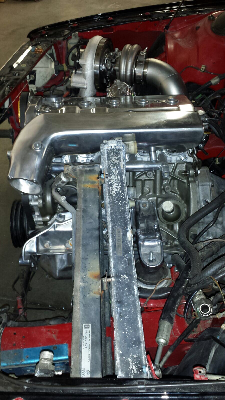

Using an RS2 intake? So you'll keep the conventional routing of the intake behind the head? Was curious to see how the Wagner would interact with the radiator.
2.5TYPE44
Posts: 461
Post by 2.5TYPE44 »
Keeping the Wagner intake. Moving the radiator and a.c. condensor just behind the throttle body, using a RS2 water manifold
2.5TYPE44
Posts: 461
Post by 2.5TYPE44 »
I don't have the ABS in the way, the bomb, and I did a vacuum booster conversion so there is more room now. A picture can describe it better. This will give you an idea of how it will be but just with the old radiator. I like not having to route the intake behind the motor. I figured the farther it stays in the front of the bay, the cooler and the shorter the route, the better.
