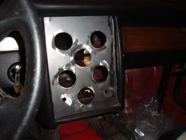

so ive been working little by little here, seats mounted, alomost done tacking the cage in. got the dash panels cut out for the gauges and toggle switches, will be powdercoating them satin black hopefully this week.

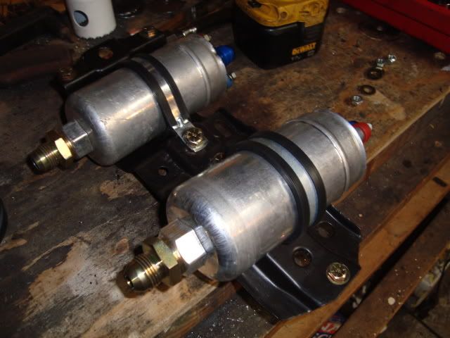

also, started to mock up my fuel pump mounts and tried to figure out how im going to snake two -8 lines down there to feed both of them, but we will see once i bring some line home tomorrow. the hard part will be to try and get the line to not go up at all, seeing as how the pumps are currently just gravity fed.

so the initial fuel pump idea is no longer, and i have opted to put the pumps pretty much directly off of the fuel cell in the trunk. then the idea was to put the y block under the car where the pumps mount stock, and run the line up over the driveshaft and to a solid SS line up the car to the engine bay, as it is done stock.
problem there would be the fact that i chopped the floor out in that area to make the downpipe...so running the fuel lines right next to the downpipe, didnt really seem like a good idea to me at all. so im going to run the lines up the drivers side of the car, right along the brake line that goes to the rear. this will be good in two ways....itll keep the fuel away from the downpipe, and it will also come up to the bay on the side that the fuel rail is going to be, which will make the plumbing a bit shorter up there.

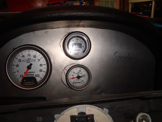

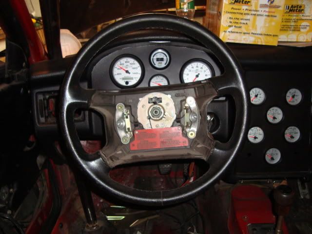

well, i got my gauge panel powdercoated and all the gauges ready to rock, all i need to do now is powdercoat the dash panel and ill be ready to wire all that stuff up.
also, got the brand new g60's mounted on the front. waiting for my rims to get here hopefully sometime next week.

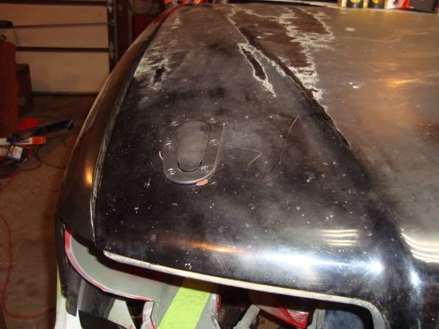

also got the hood pin setup done. and boy was that not the funnest thing ive done in a while. whomever has the nutsack to do this on a limited edition carbon fiber hood....is off their farking rocker. (aaron)

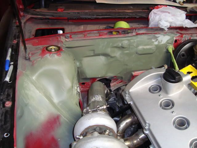

as it sits now i have about seven inches from the block to the bar across the front of the car. i still need to get the timing belt stuffs on the motor, and i need to fit a radiator with fans in there too....so i may chop the bar running from side to side and move it foward as much as i can and still fit the intercooler between the bumper supports.

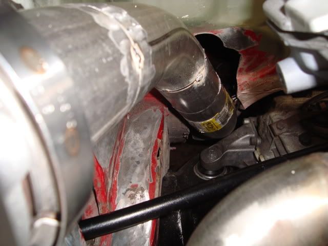

semi-mocked up my intercooler piping today, man that was a breeze compared to other setups that ive done, i actually didnt think itd be that easy.

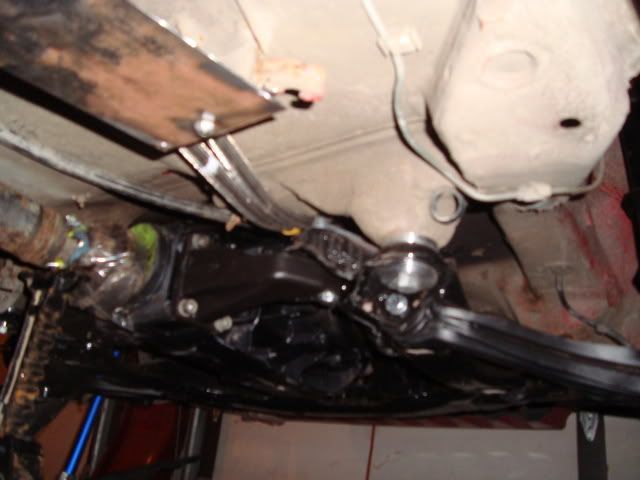

so i think i got the downpipe situated, what a farking pain in the nuts that was. i guess since the intercooler piping was a walk in the park, the donwpipe decided to be quite tough to figure out.
it spits out right behind the tranny mount, on the subframe down there, and thats as far as i made it. i did try and get it a bit longer, but then i couldnt fit it all in the car in one piece, so this is the first solid part of the system, then everything else will be expanded and band clamped, cause u-bolt clamps are the suck. perhaps ill even go baller and vband it all, we'll see.

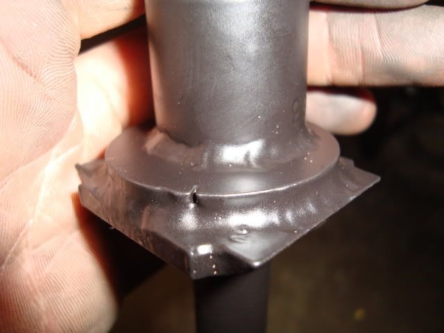

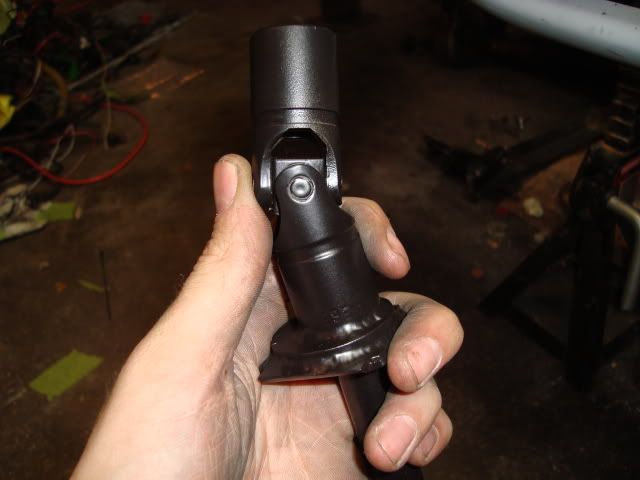

also got the solid shift linkage finished and coated. as well as some other bits.

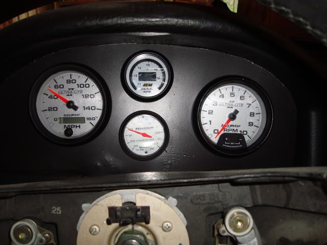

dash is fin

speeding-g60
Posts: 2152
Post by speeding-g60 »
and i thought i was a gauge whore... haha.
Zerb
Posts: 858
Post by Zerb »
hahaha. and these are the cool LED backlit ones too, so at nightime when i cruise the strip with my street driven track car, itll look cool as shit to the cops who pull me over
