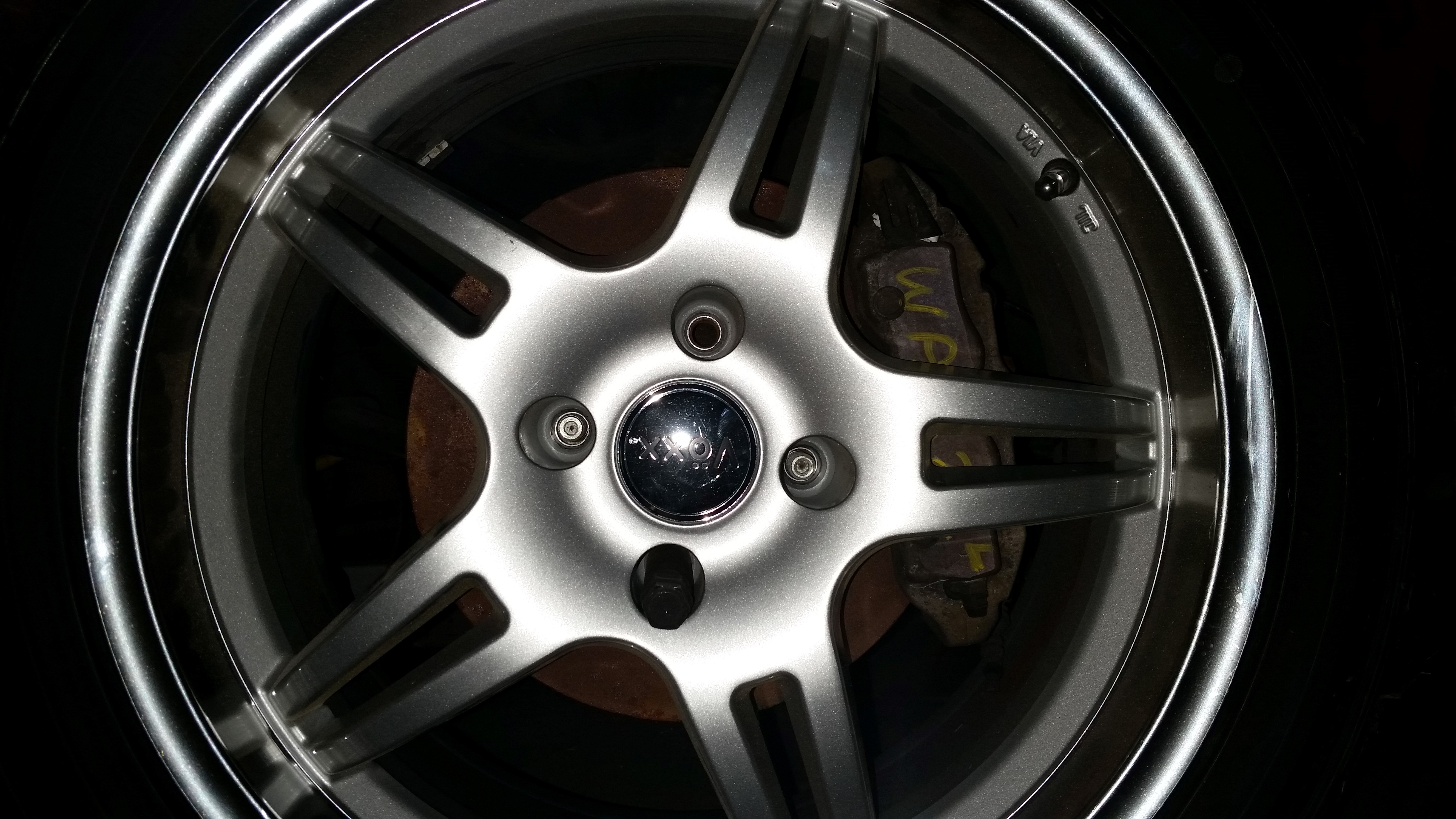

Re: Eric's V8 CQ
Teaser...wrong rotors, but you get the idea.
- teaser
- 20160928_224357.jpg (2.37 MiB) Viewed 59458 times
