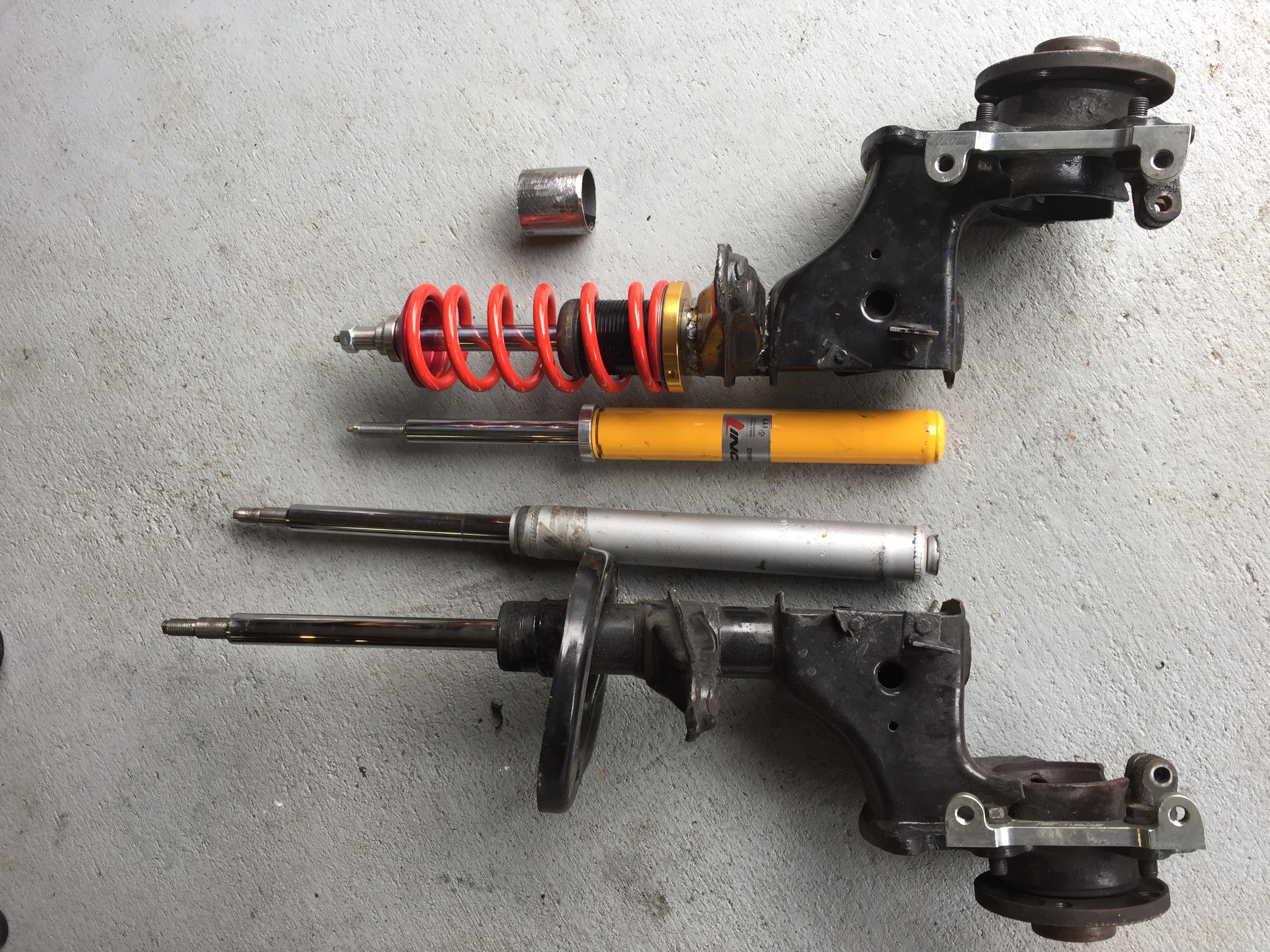

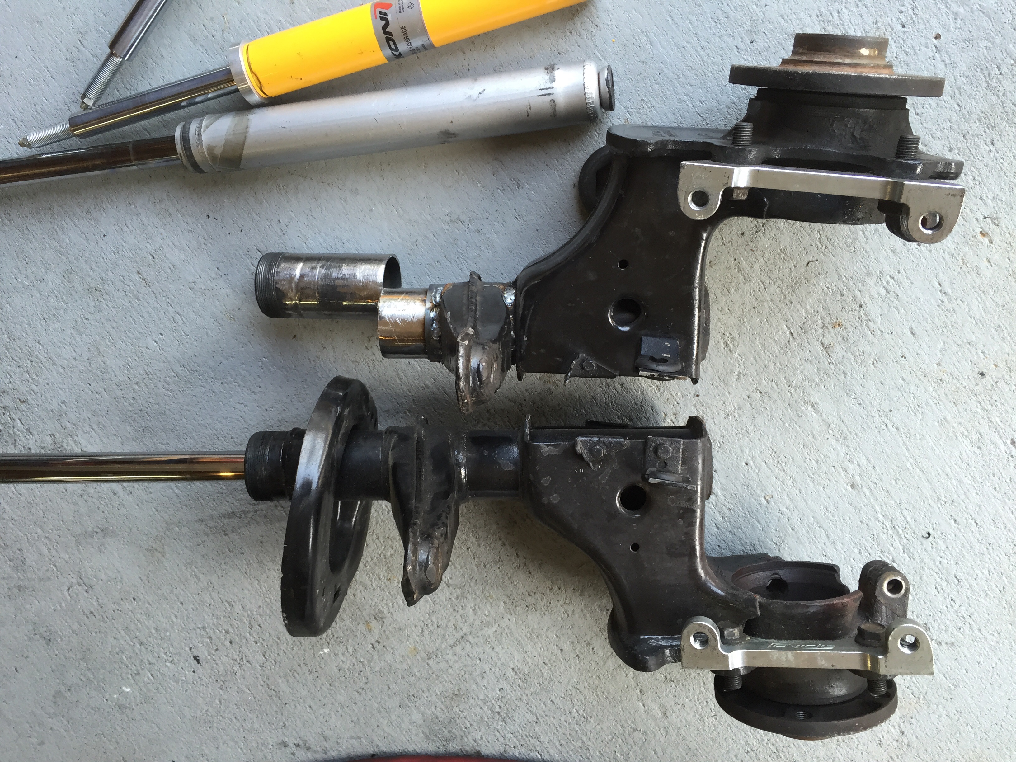

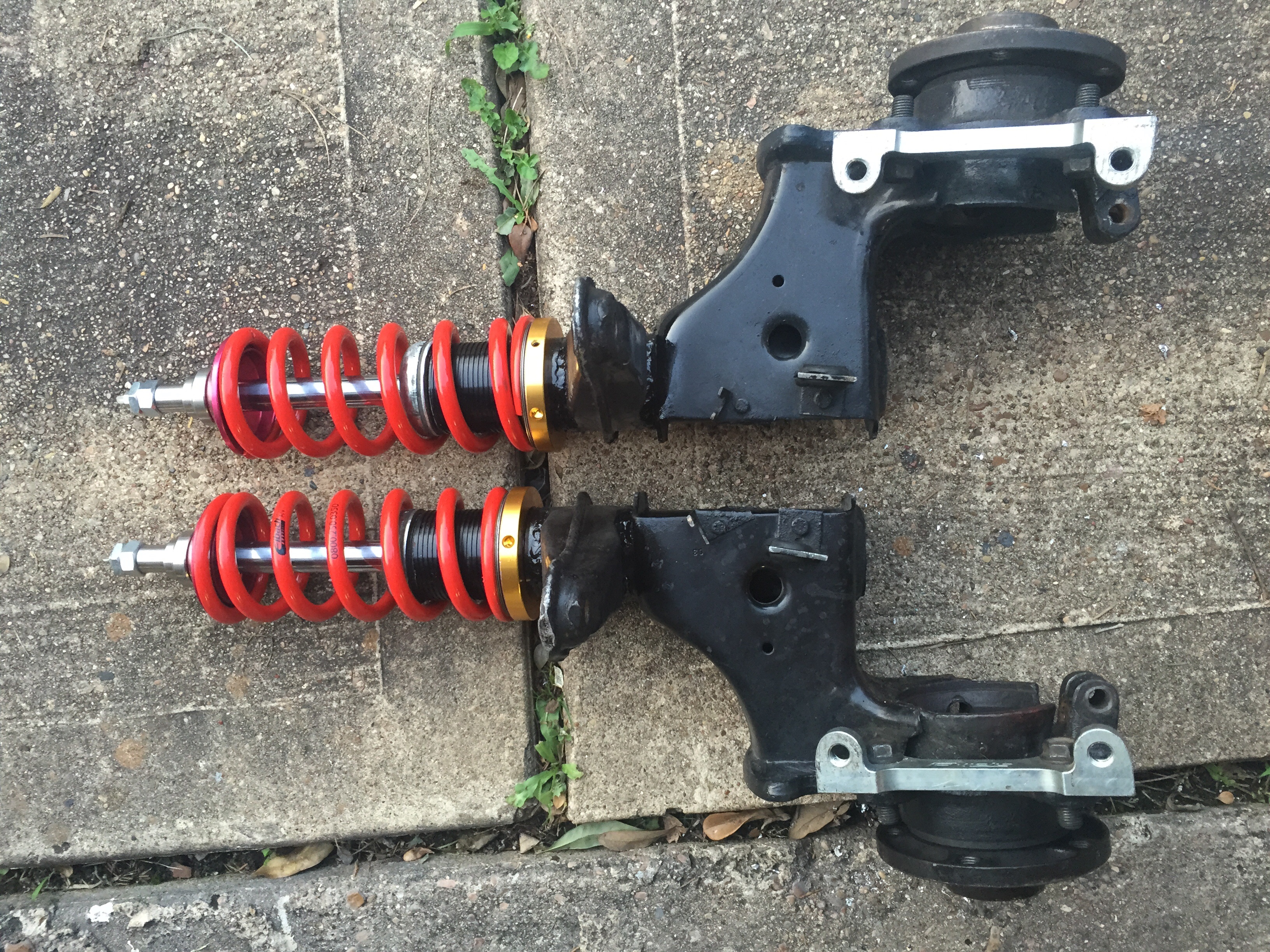

I sectioned/shortened the strut housing by 2 inches and also lowered the steering arm almost 2" to correct the angle of tie rod from arm to rack. I used 8" springs that are supposed to have 5" of travel. The adjustable race Konis' have 5inches of stroke as well. I just hope the car is not going to sit too low. I am hoping the 2Bennett Camber/Caster plastes give me enough adjustment.

Re: Josh's 2.5 200QT.
That's the way to do it

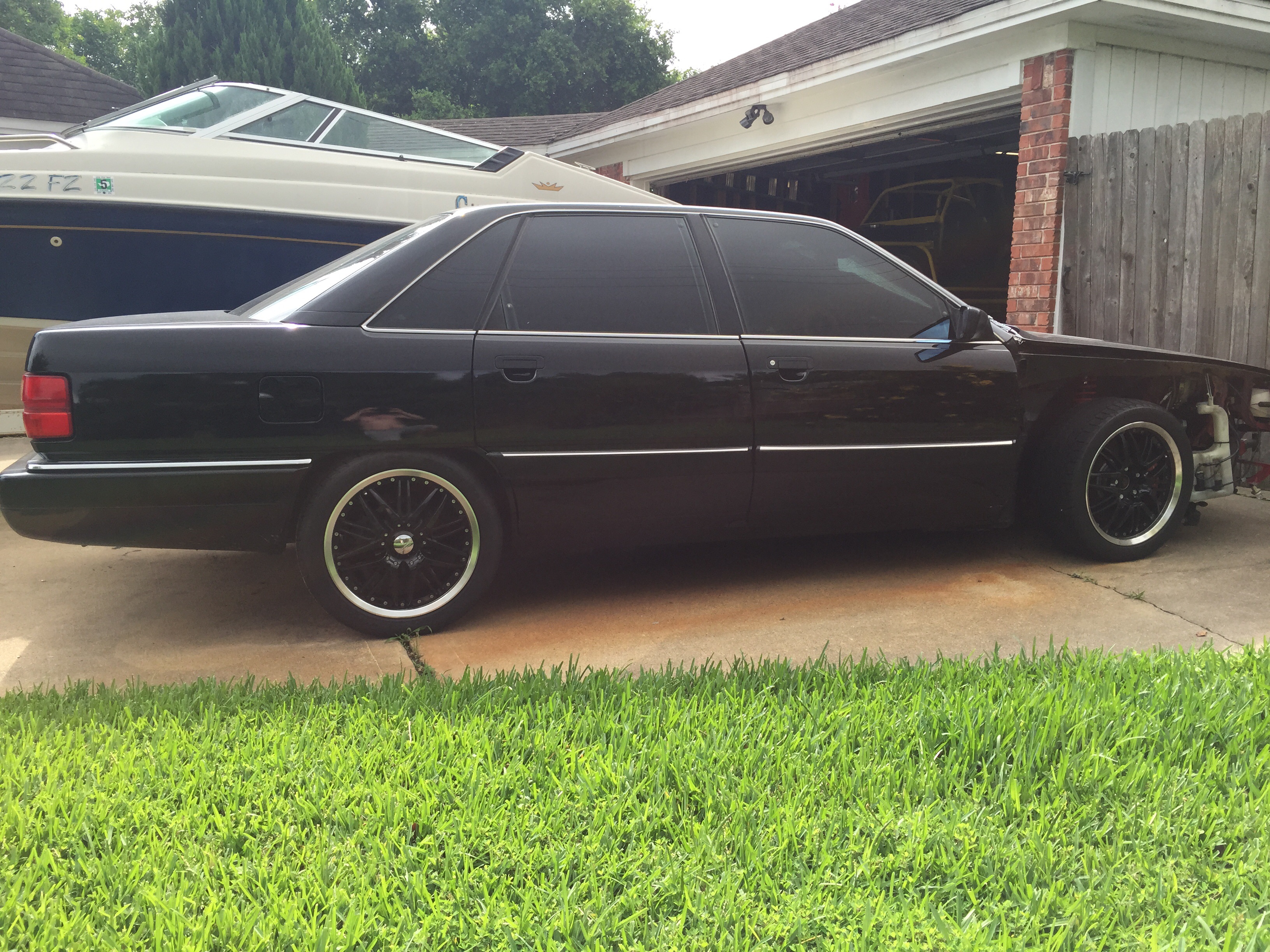

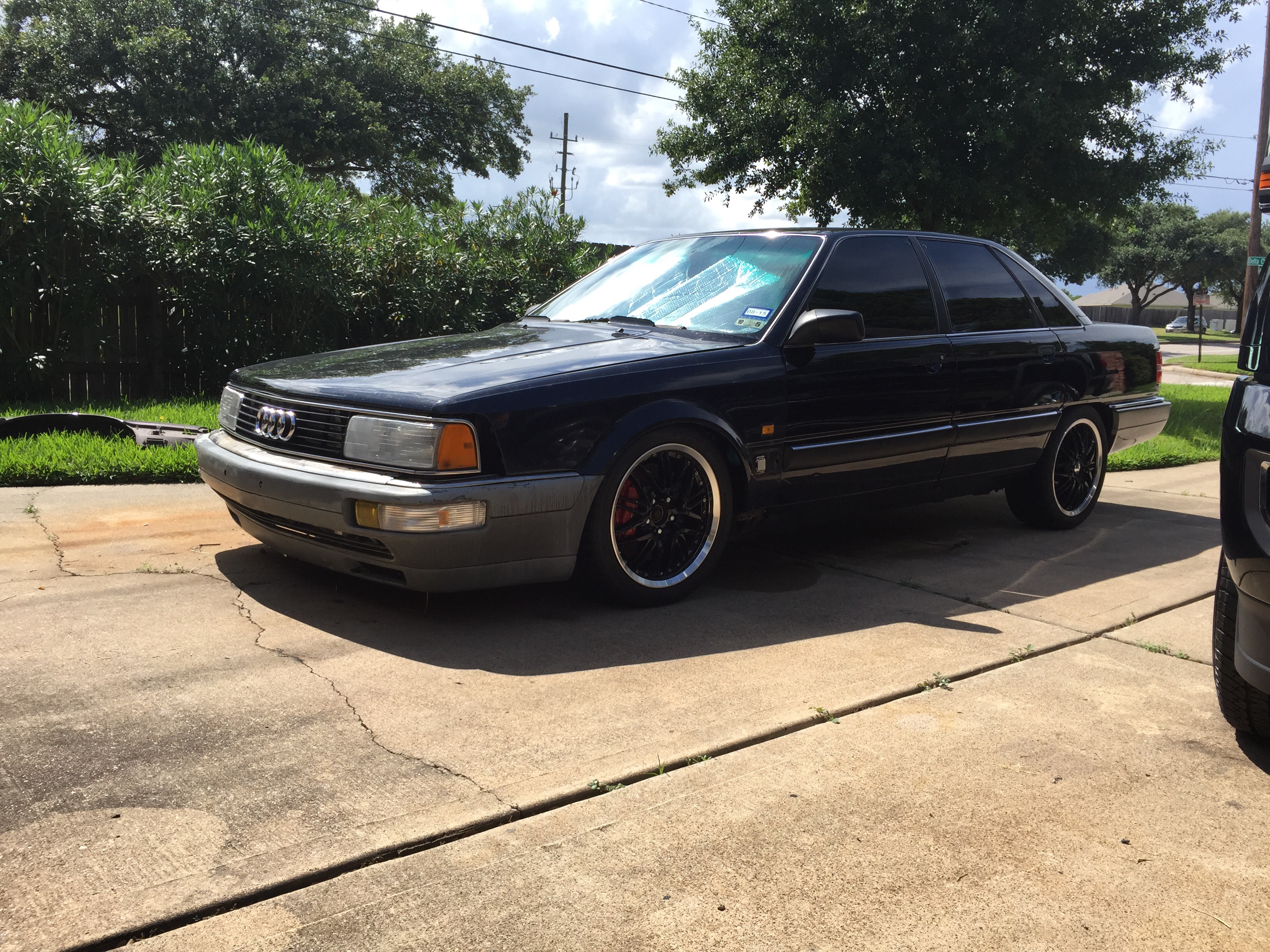

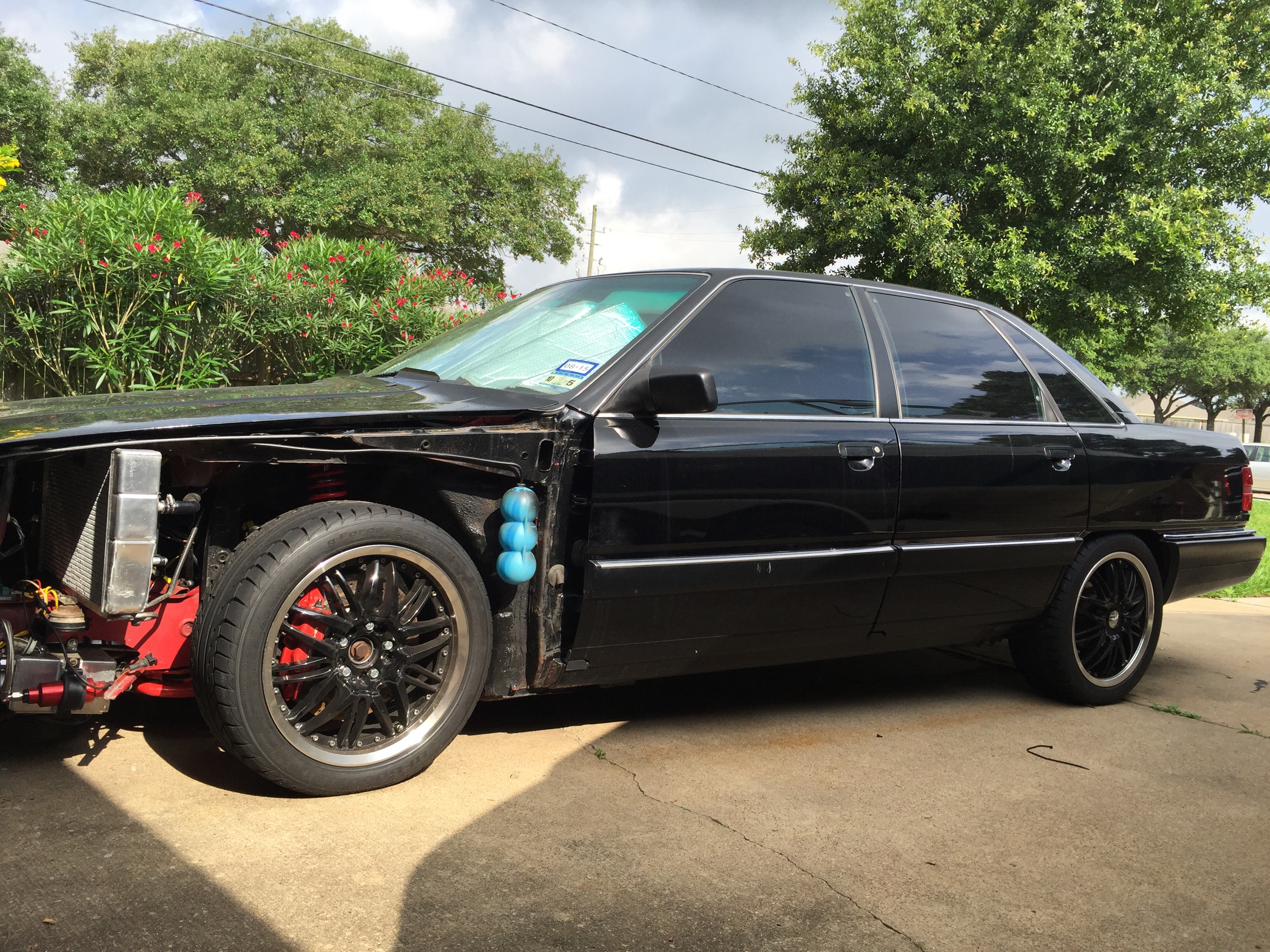

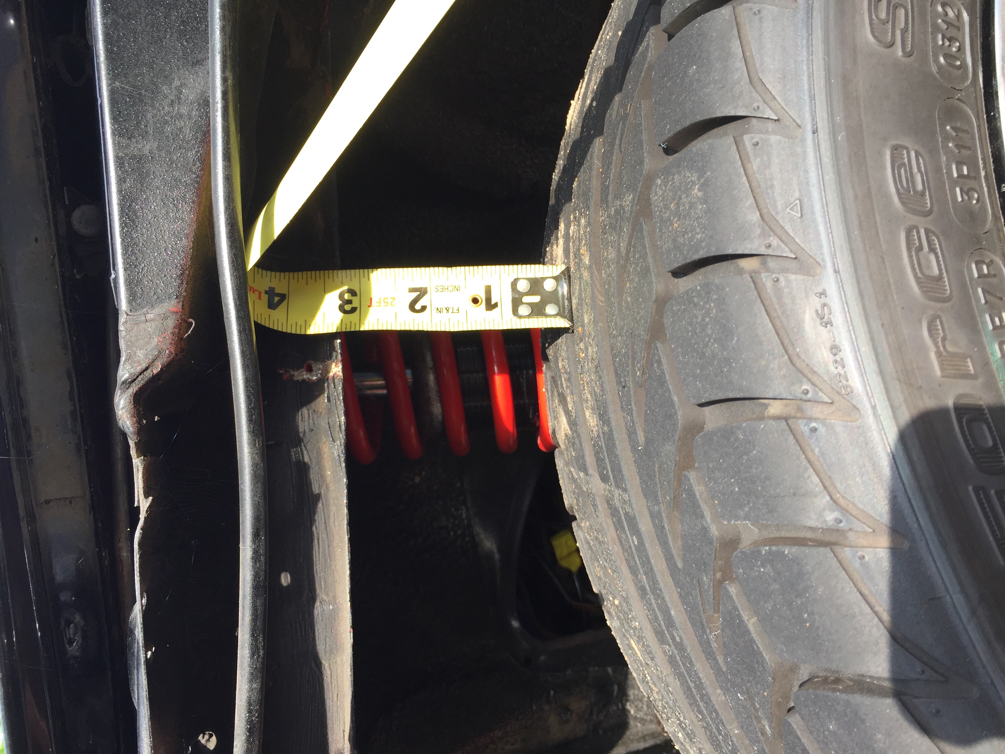

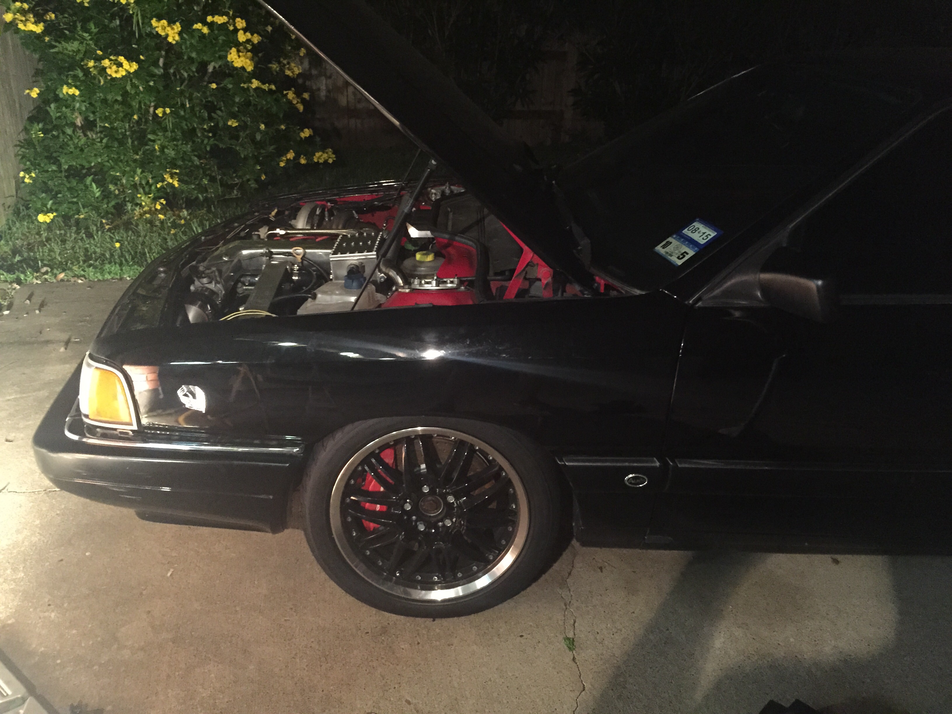

It sits really low now. I need to put the V8 fenders on now.
Wow. Is that with the collars all the way down?

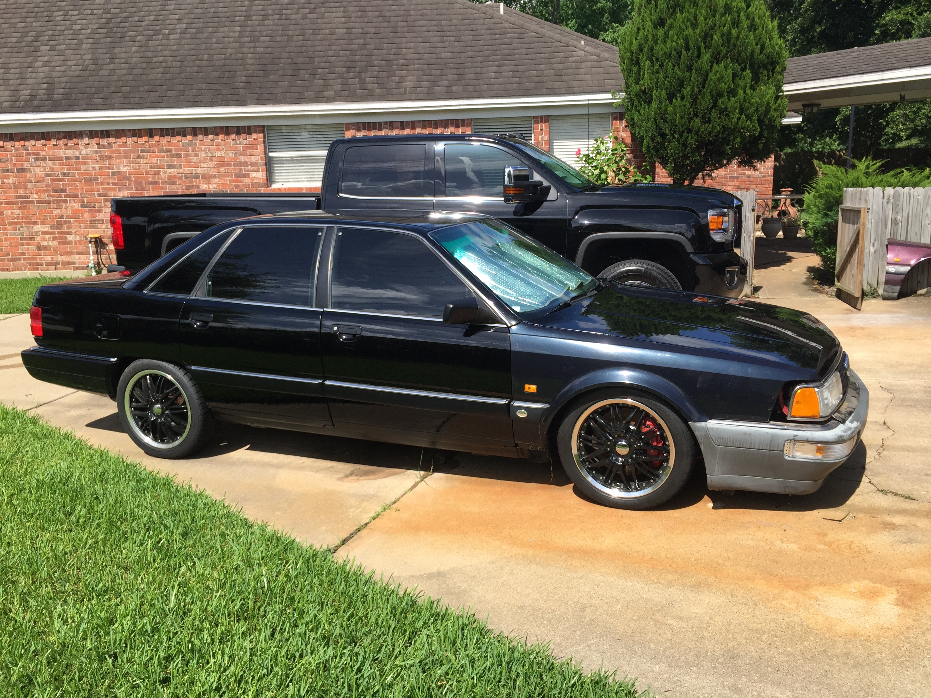

The collars are about 1/2 inch from being all the way down. I dont want to go any lower. I have to leave room for suspension compression. I only have about 3" of upward travel before the tire hits the upper body. I took out the plastic fender liners to check for clearance. The front rides unbelievable smooth with 8" coils. The steering arms are perfectly level/horizontal. The car is super responsive and predictable through the steering wheel. No delays or slop. Now I have to do the rear in a bad way. When I rip on it, the back dumps fast and the front comes up making it hard to keep from breaking loose the front two tires and spinning. Even with the H&R lowering springs in the back, now the car has a big rake. It looks like the ass end of the car is way up in the air.

Interesting - great to hear it rides well. Given your statement it sounds like you have ~2" of compressed travel at the current height? Any of the "pogo" effect?
Sorry for the questions but I'm very interested in making a competent suspension for the car and it seems you're well on your way. Yours looks similar to the Talladega 5000!

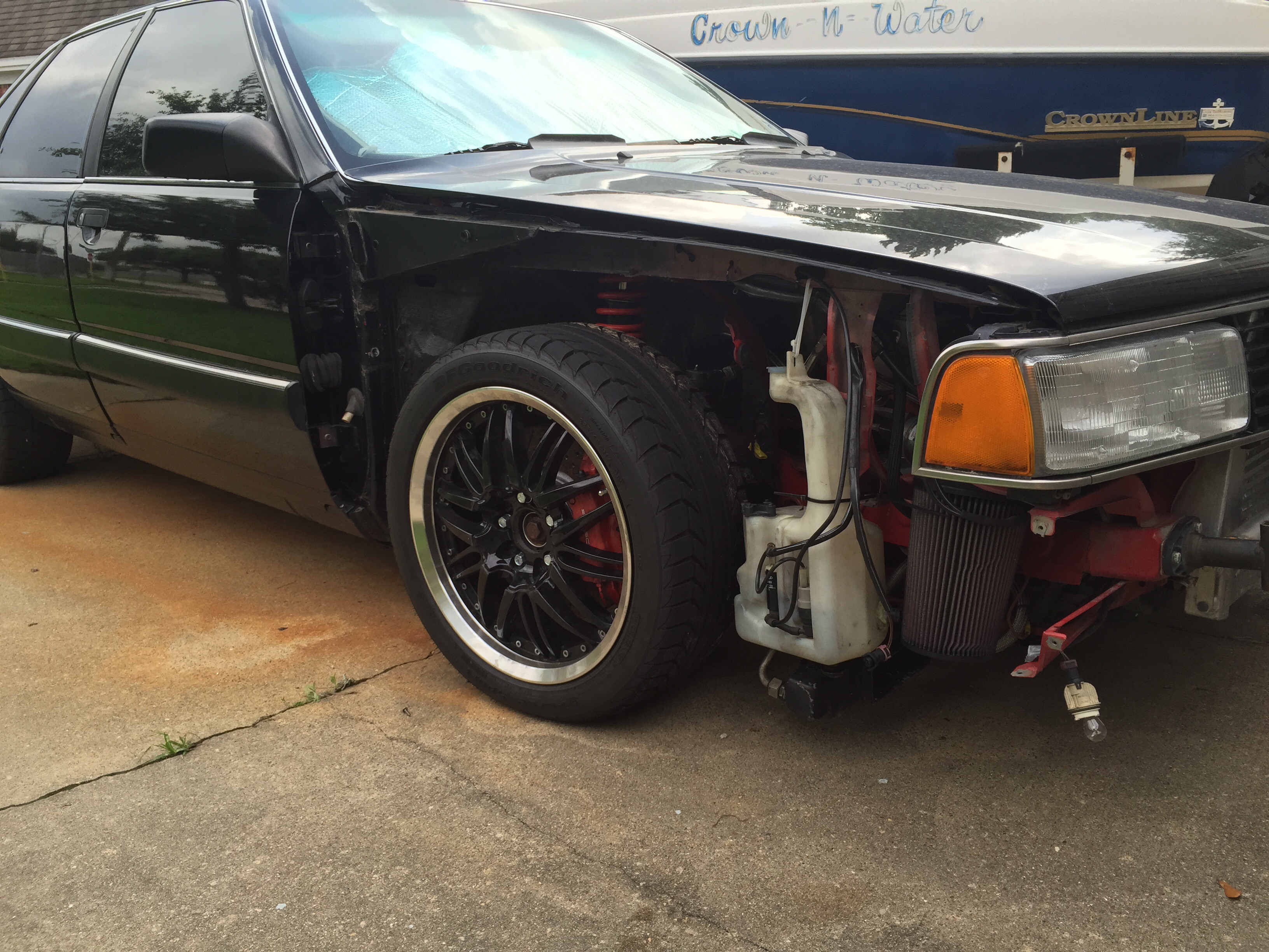

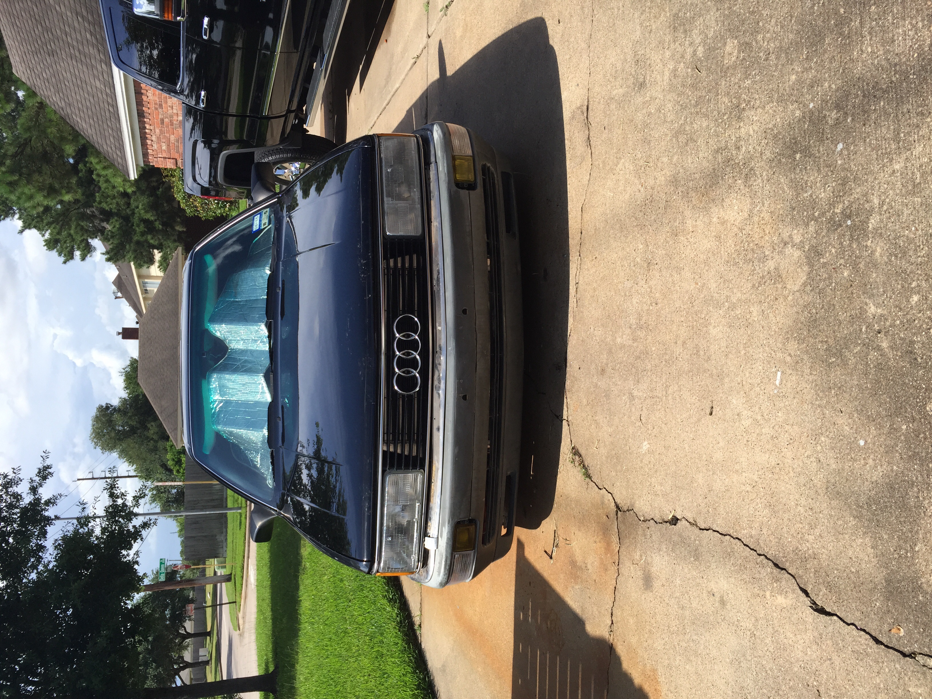

I finally made it back home. Unfortunately I lost my GoPro somewhere between Ukraine and Turkey. I can borrow my brother n laws go pro and record a couple of rips. Since I lowered the car with the coilovers, it created a clearance problem with my 20 valve fenders so now is the time to start converting to the V8 fenders and bumpers. I started to lay it out today to see what it would look like. I am going to use the V8 fenders but keep the 200 headlights. So I have to section the front section of my 20 valve fender to fill the gap where the headlight meets the fender. Then I also have to weld the lower rear portion of my fender to the V8 fender. The rest should be easy. I'm wondering if the car is going to be too low. I like that it rides good, no coil rubbing/binding, and is very responsive/tight and predictable.

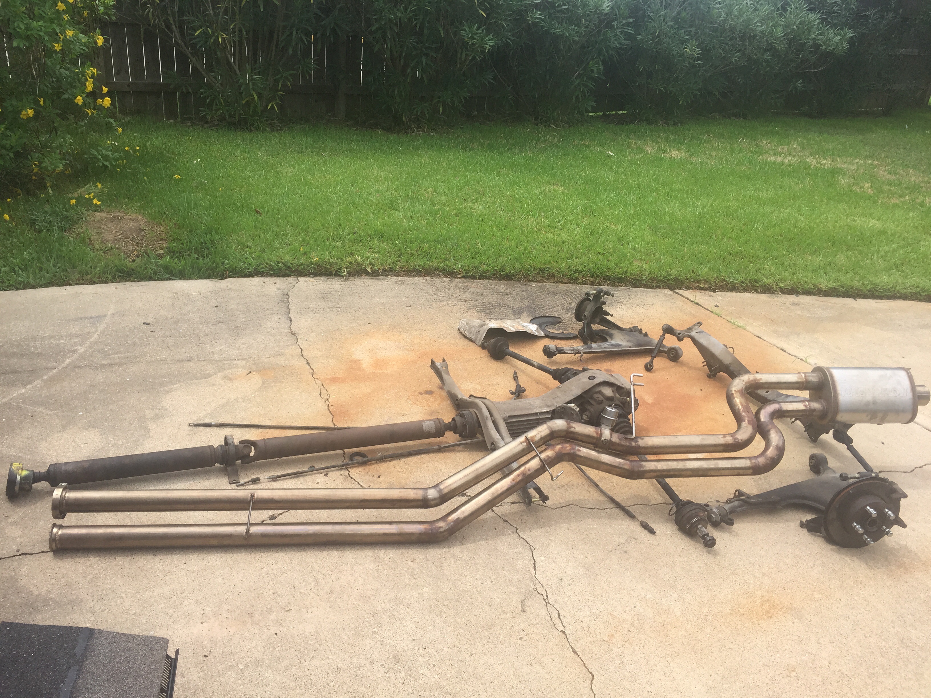

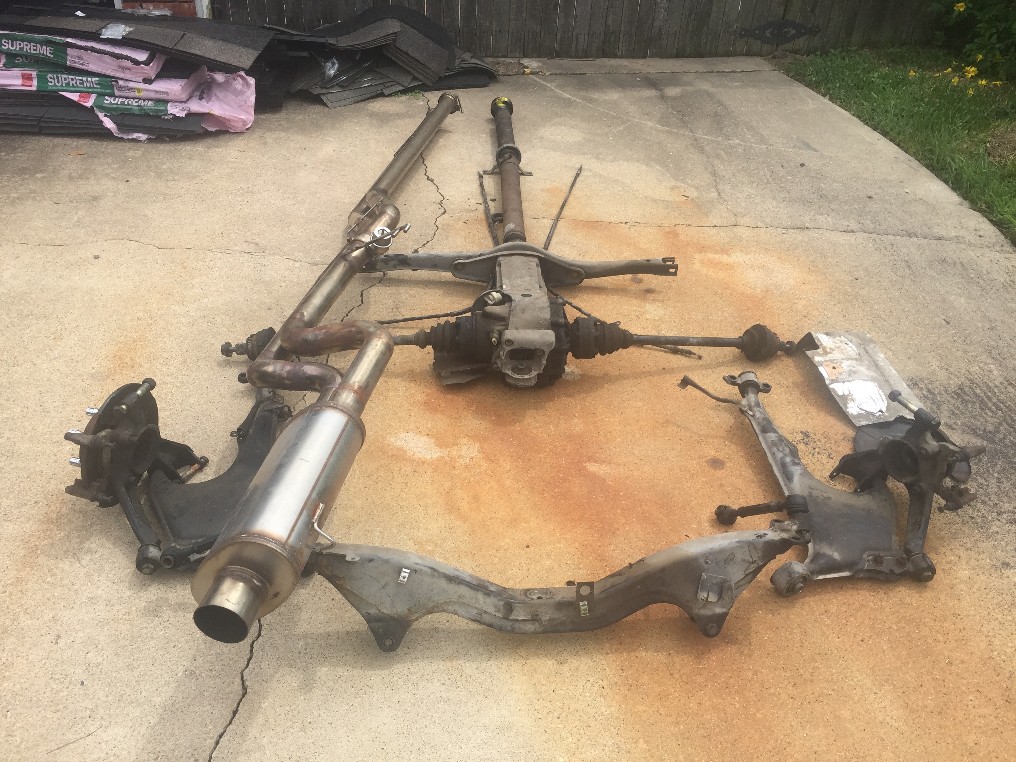

I started working on my rear coilover project and when I climbed under the car, I found that the rear diff is empty (all of the fluid is on the outside of the diff with dirt caked on), the rear diff bushing is missing, and the driveshaft carrier bearing is toast. I have no freaking clue how this thing put down 650+HP to the ground without the rear falling apart. Time to take care of it and do it up right. I also found the track arms bad, bushings bad, cv boots torn and slinging grease, and both parking brake cables seized. I have a lot of work ahead of me.

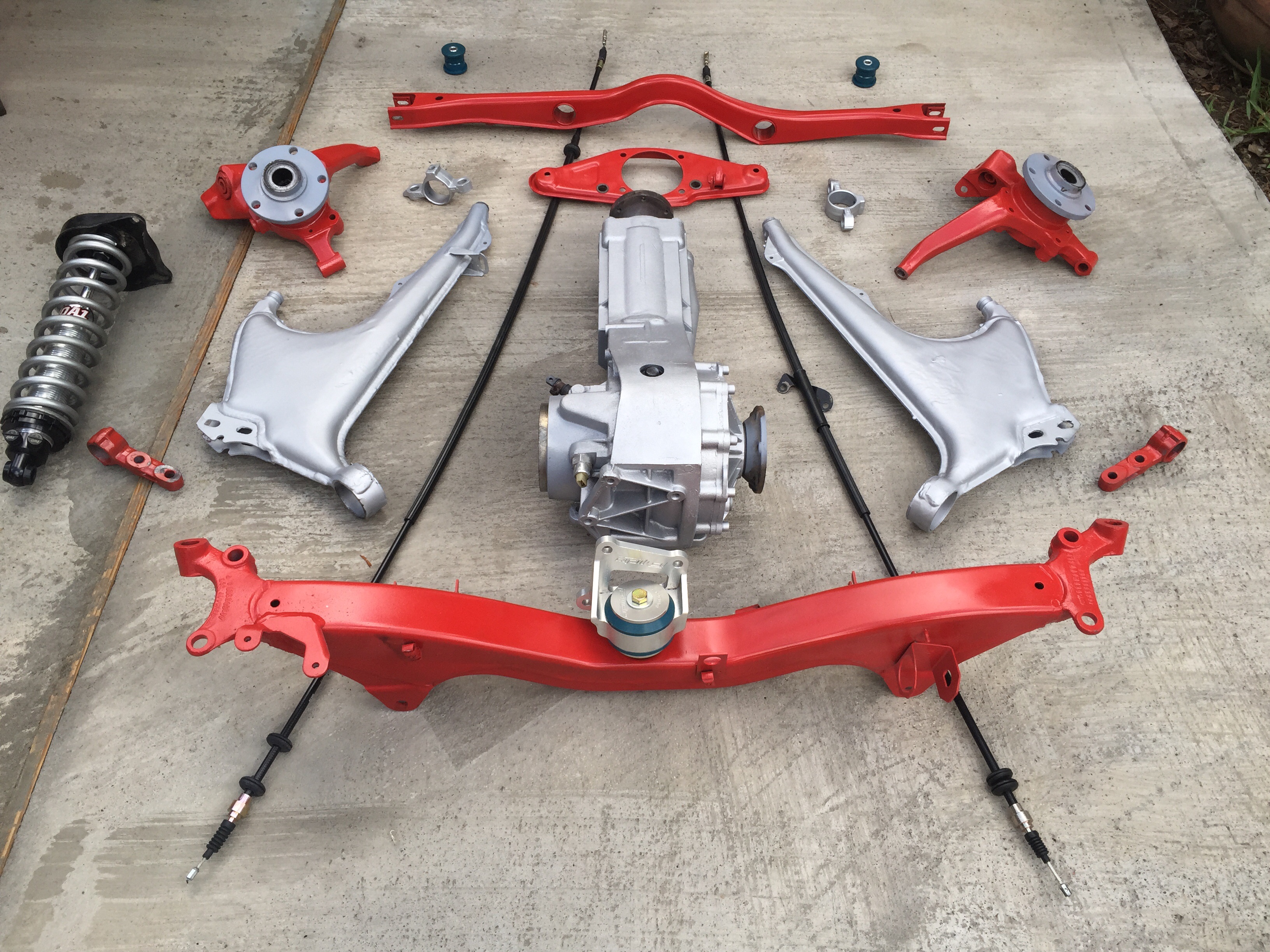

Made some progress with engine degreaser, brake cleaner, a trip to the car wash, and some paint. I hate working on greasy cars. Now I can start working on replacing the seals on the diff, rebuild the driveshaft, and CV Axles.
I ordered 17 bushings and only needed 13 bushings for this damn rear end. that is four short of what most cars have. My rear main crossmember bolts directly to the bottom of the car without bushings.
Here's what I ordered
Apikol rear main diff mount/bushing
034 street density front/inner diff bushings
Apikol outer front Poly bushings
Energy Suspension Poly front lower control arm bushings
Powerflex spherical bearing/bushing for control arm rear/inner
OEM knuckle bushings
OEM toe adjuster bushings
Left parking brake cable
Right parking brake cable
Left track arm
Right track arm
Not sure if there is anything else...
Left track arm
Right track arm
