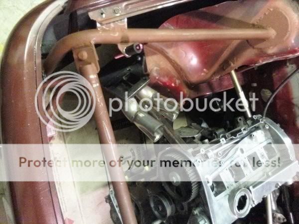

and the exhaust mani, its coming along. hopefully it gets finshed soon so i can get this car back here and work on it... goal is now Aug 30th i think.... Pacific Waterlands show.....
but the manifold is a true twin scroll set-up. paired cyl's into each volute. and yeah, i know 4 is a little longer than 1, but it will be alright i think....

a_CQ wrote:Sweet....question on exhaust mani...why not run 1+2 to front and 3+4 to rear....that way #4 would be shorter..
i don't know too much (next to nothing) about twin scrolls but going on pure speculation.. the idea is to have direct 1/4 into one scroll because they rise and fall together as well as 2/3 into one scroll because they also rise and fall together.. thus giving each scroll a constant and even pulse of exhaust gas pressure?
yup. to keep even pulses. even (some of) the old VW 8v manifolds had two outlet ports and a dual tube downpipe
1+4 and 2+3
http://i18.photobucket.com/albums/b116/ ... 090010.jpg ... 090010.jpg
1+4 and 2+3
- speeding-g60
- Posts: 2152
correct. you utilize paired cylinders together per volute.qezel wrote:a_CQ wrote:Sweet....question on exhaust mani...why not run 1+2 to front and 3+4 to rear....that way #4 would be shorter..
out on the Interwebz wrote:[/quote]A twin scroll turbine housing uses dual side by side passages into the housing. When coupled with a pulse converter manifold that separates exhaust pulses as many crank degrees in the firing order as possible, a twin scroll or divided housing works to reduce lag, decrease exhaust manifold backpressure on the top end, reduce the potential for reversion, and increase fuel economy. The twin scroll is based off the same reasoning a tri-Y header uses: keep spent exhaust gases out of an adjacent cylinder drawing in fresh air. At high rpm on a turbo car, exhaust backpressure is usually significantly higher than atmospheric pressure, and often higher than intake manifold pressure as well. A divider between each of the two volutes allows the cylinders to expel the exhaust gases without it interfering with the fresh air for combustion. Since there are two openings, each a smaller overall volume than a single scroll design, the exhaust velocity of each pulse can be maintained. This also spins the impeller more easily because lag is a function of the scroll area. A single turbine housing opening isn't as efficient since cylinders on the exhaust stroke of the 4 stroke cycle contaminate the cylinders that are on overlap with exhaust gas. A conventional turbine housing is not as effective in using exhaust pulse energy to help spin the turbine up to speed as it does not exploit the energy contained in the pulses as well.[/quote]
