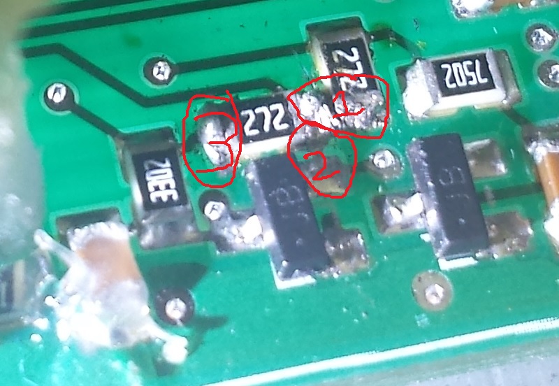

anybody have any insight concerning the following picture and questions. Below is the IAT circuit section that needs modified for using the 1.8t iat sensor. My temps have gone haywire and when I attempted to reheat the sauder joints of the left 272 resistor, I ended up losing the connecton entirely and am stuck with 154 C.
VEMS IAT Circuit.jpg (133.75 KiB) Viewed 29946 times
Spots 1 and 3 were all warmed with the sauder gun. Are the legs of the 272's both supposed to be melted together in spot 1? In spot 2, is the leg of the JB (3 legs) component allowed to touch the 272's leg?

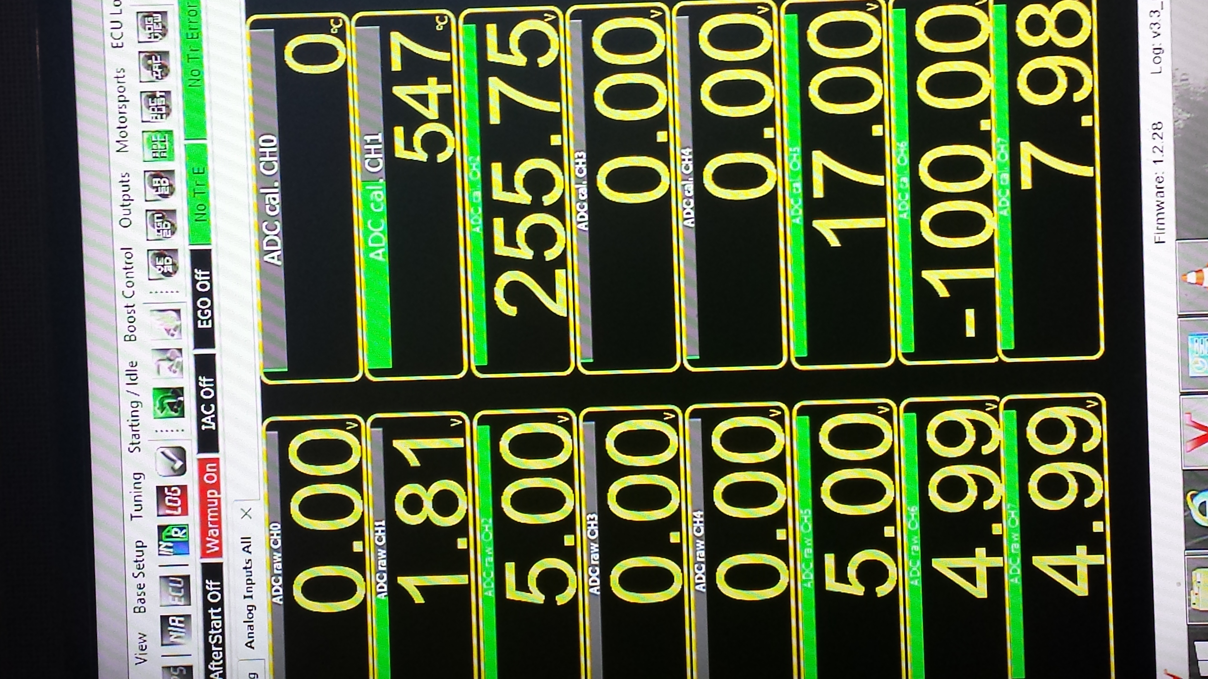

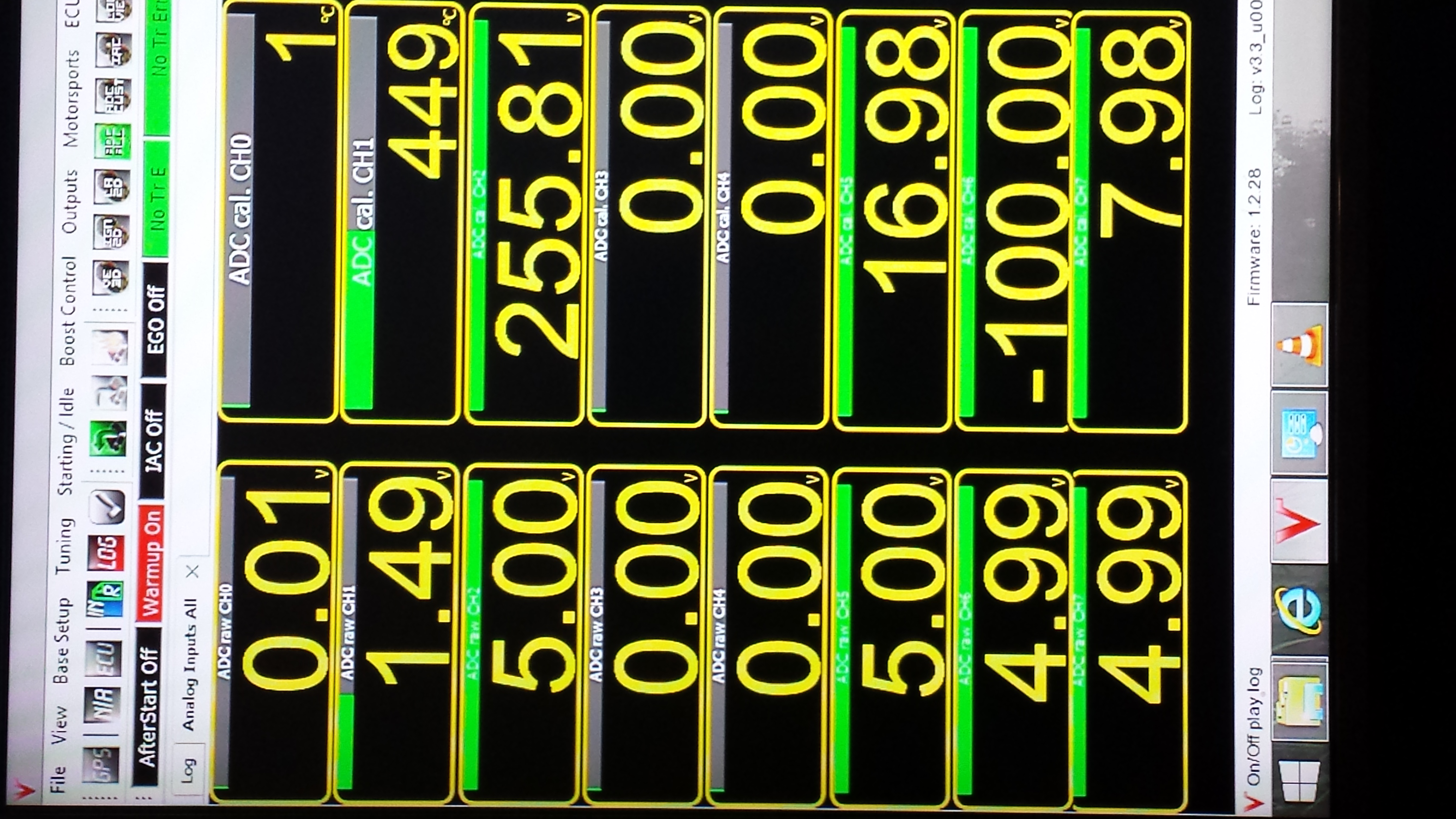

Marc helped me with the circuit above. I went back to review my log when this all went crazy and found that the only things that changed on my ADC ALL page was that ADC raw CH1 slowly rose to 1.81 v and ADC cal. CH1 went up 100 C. That 100 C seems significant. Idk.
Before:
After:

I feel like Marc deserves some big time credit for his work today. He repaires my IAT circuit and got 3 gauges working again and all since the ecu left my hands yesterday from PA! Seriously awesome support folks!

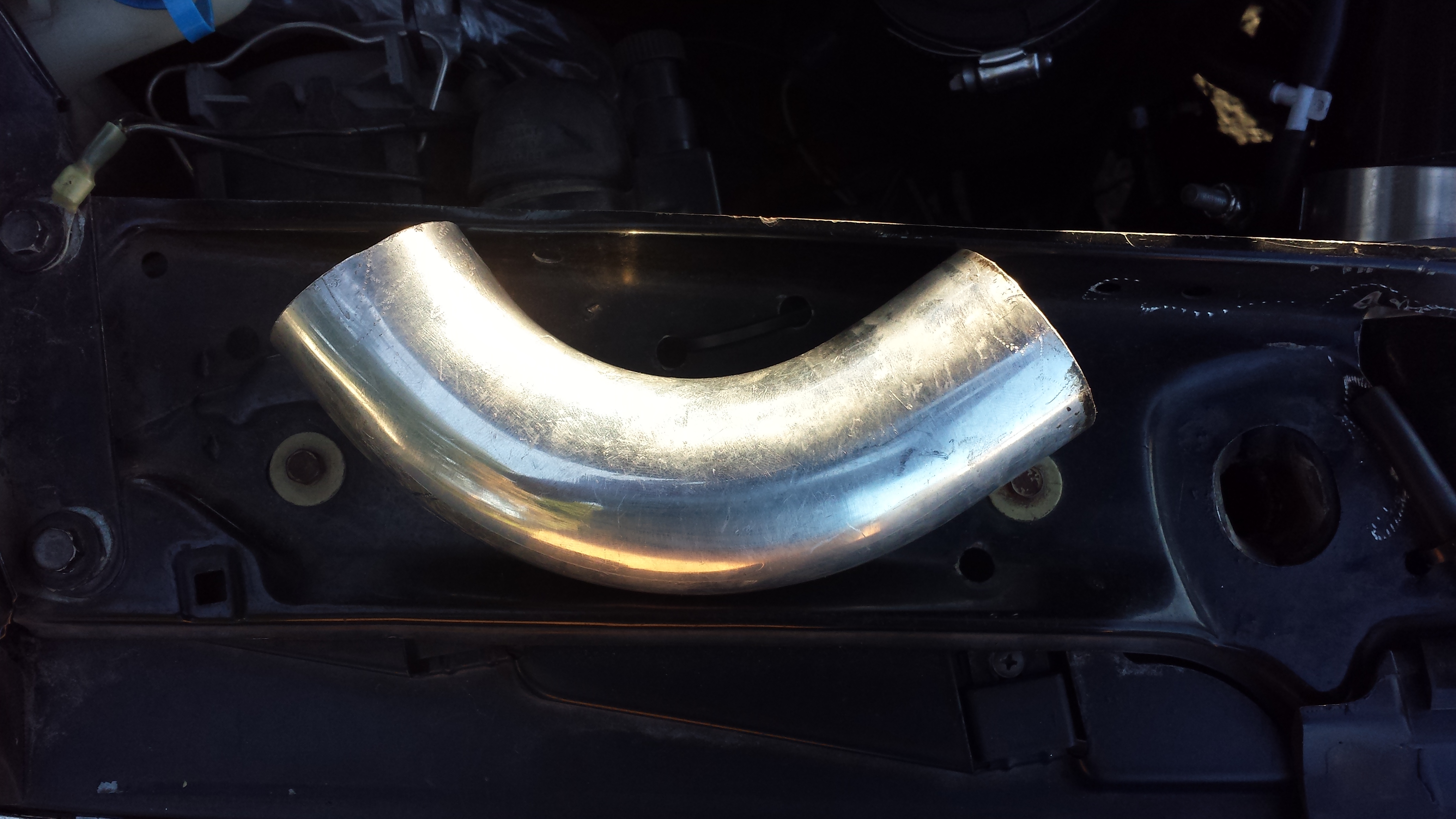

All is well ATM. Actually I had to pull this aluminum elbow back out after it was choking up my top end. Couldn't flow as much as the old silicone elbow (cut down stock turbo-IC hose)
Seems to flow much better. It's strange because the wall thickness is only slightly thicker than my other 2" OD pipes. ID is slightly less but OD of the Chinese-source elbow is small enough that the pipe can nearly fit INTO the other IC piping that 2". No I didn't bother measuring any of the pieces lol.

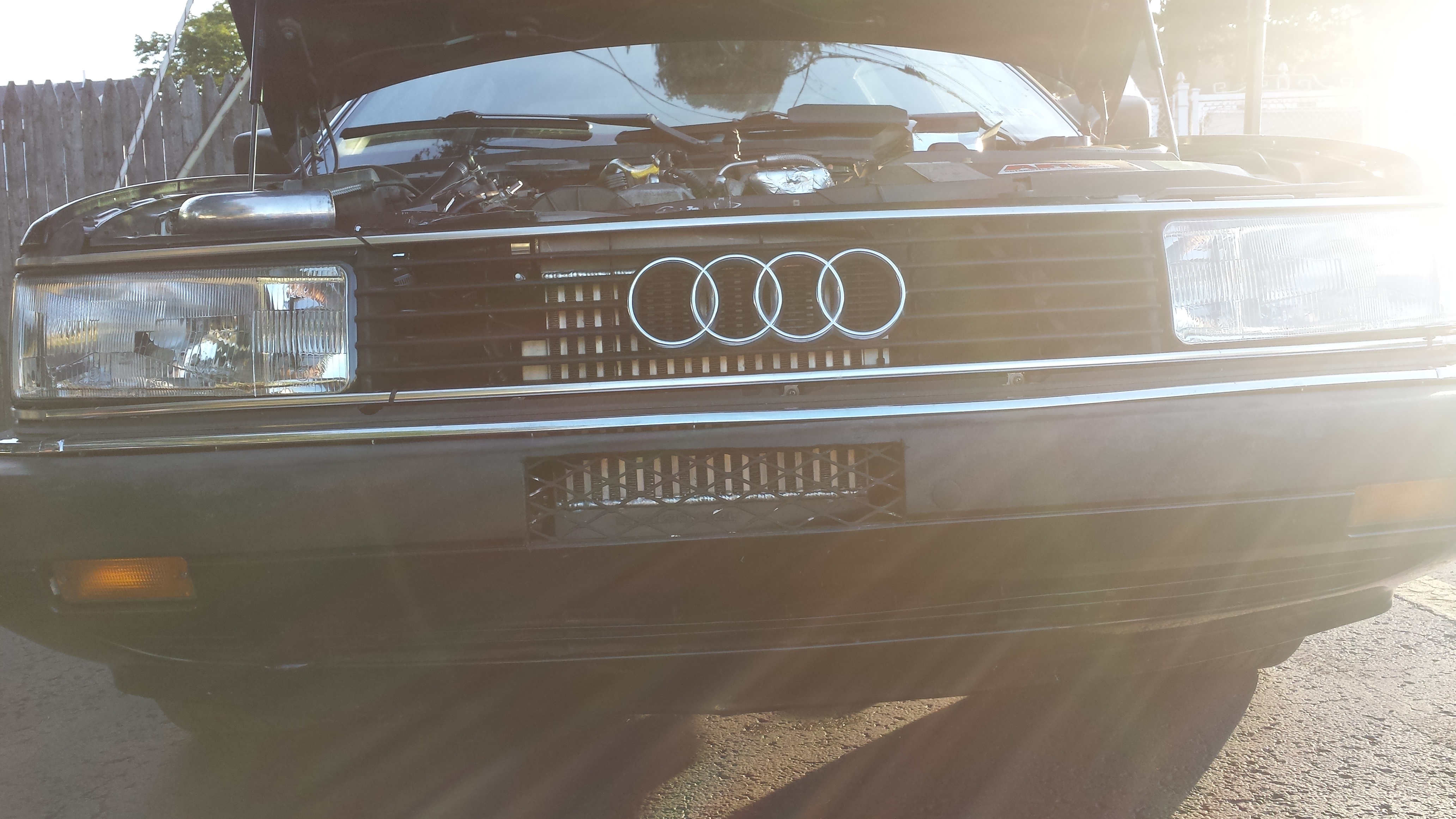

And now for a quick photo carpet bombing
That's the IC with a flat black painted grill to keep birds out.

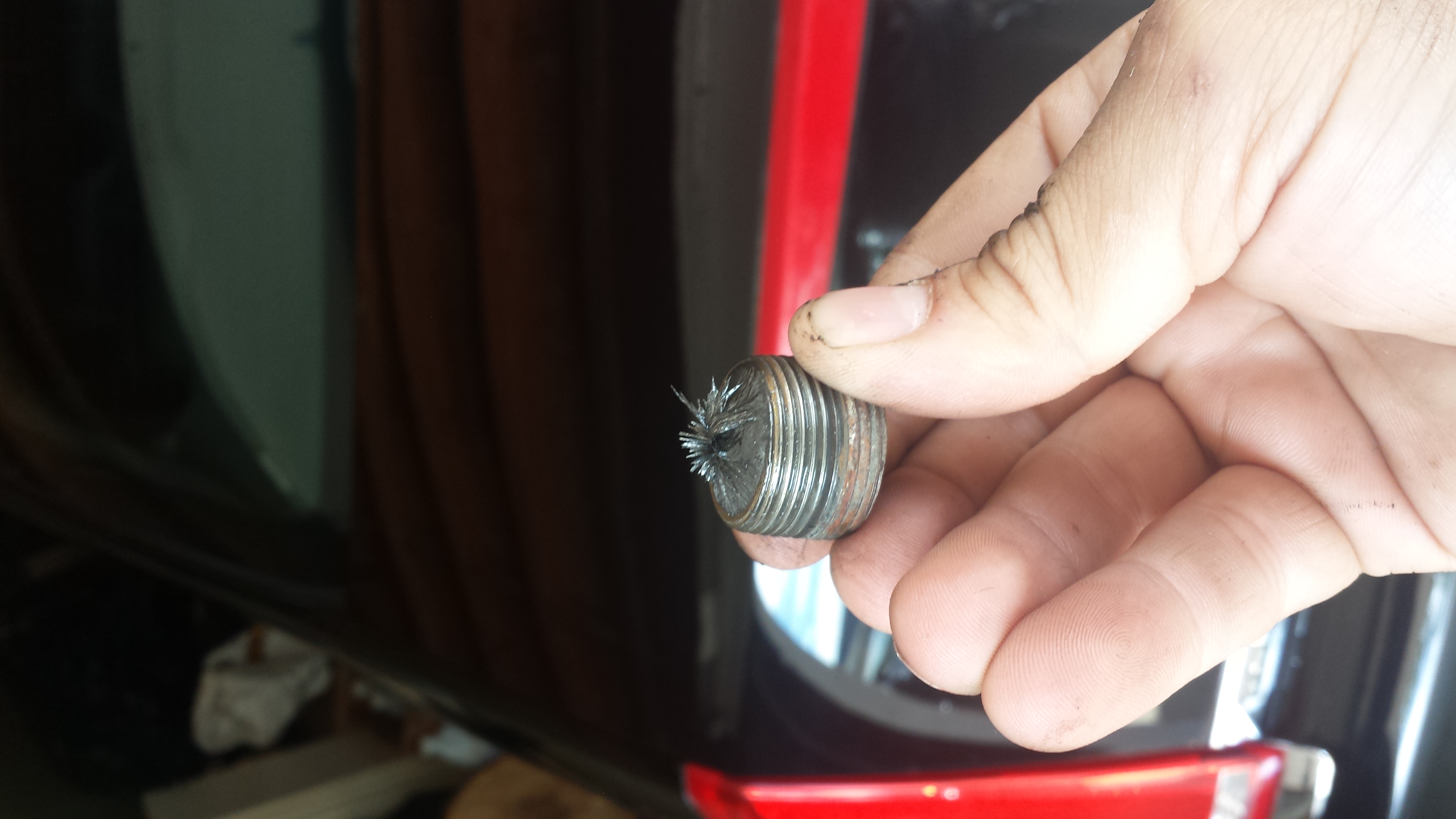

Dang this fill plug is nasty! Didn't realize they went to magnetic on the 200's tho
Ended up only being able to put ~2.9 qts in after jacking the back of the car up as well as the pass side for awhile to drain

Well when I saw the collection of sh#t hanging out on the magnetic drain plug I had the realization that it probably had no further magnetization left for the other still-suspended particles and new drain and dilution were my best option. Trans worked great and I actually thought the sticking of 2nd gear was due to my half-ass'd shifter bushing repair using a zip tie inside a short piece of vac hose :D it's pretty funny but effective. Good thing I'm the only local that knows it's there :hide:

The metal shavings are pretty normal by the way. Just the product of constant metal on metal interaction. The same thing happens in your engine! (get a magnetic drain plug). Also big time in the power steering systwm and everywhere! The great thing is that agnostic particles are super easy to catch.
