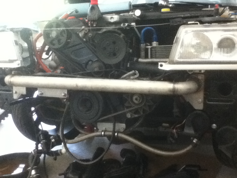

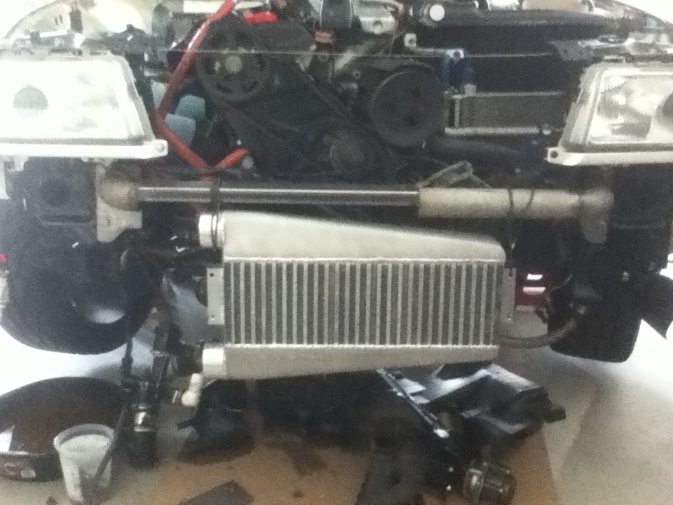

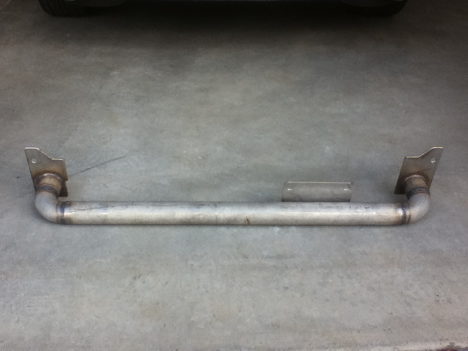

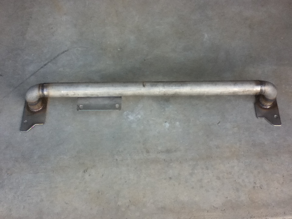

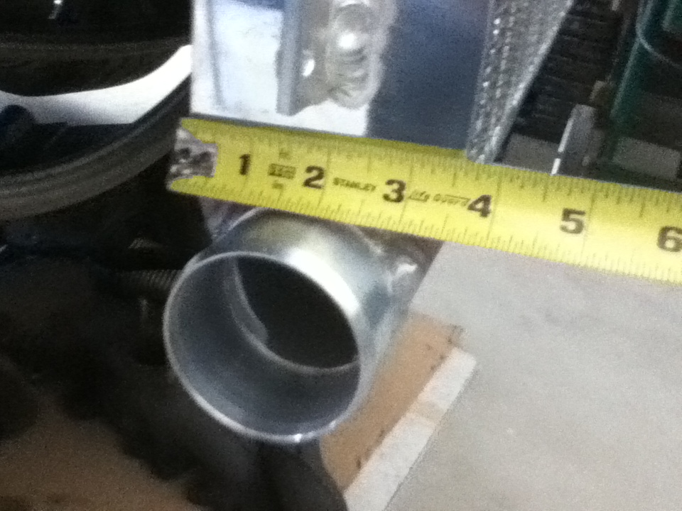

Ok so today I spent a lot of time trying to fit the large intercooler under my cross member support and unfortunately I found out that the intercooler is too large for my current design so I had to cut up my cross member to make more head room and even still I am having fitment issues. I may have to cut the bumper up a bit to get it to fit due to It's rather large shape. The 3.5' wide core can support 730 BHP. I may have to scrap the straight across design all together and make a support that goes in front or behind the IC.
Had to cut up the cross member and install a flat bar that gave me more head room
IMG_0157 - Copy.JPG (256.96 KiB) Viewed 36355 times
IMG_0158 - Copy.JPG (246.42 KiB) Viewed 36355 times

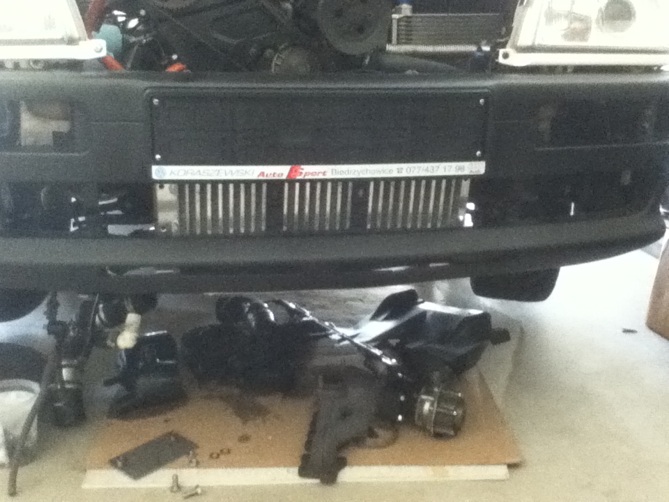

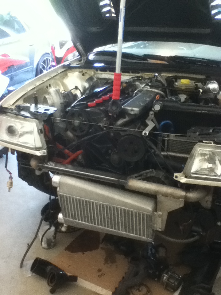

Couple of shots with the bumper fitment
IMG_0159 - Copy.JPG (231.83 KiB) Viewed 36355 times
IMG_0161 - Copy.JPG (246.04 KiB) Viewed 36355 times

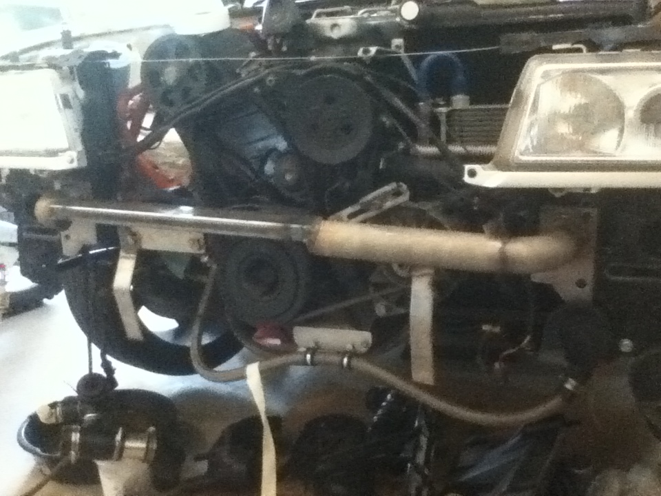

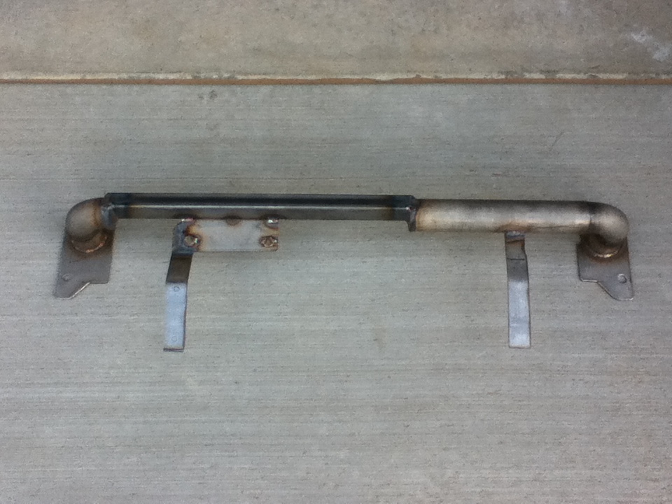

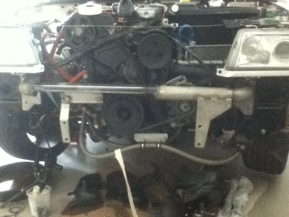

It has been a couple of days since I had time to work on the car. Got a little time today and I think I have the cross member and additional supports for the IC done and welded up today. I will need to do some bumper trimming, just so happens that there is some damage right where I need to trim so it worked out well. I had some extra 2X1 steel that I welded in place to make more room for the IC. Just remember that when you weld stainless to raw steel you have to use 309L to prevent weld failure.
Needs a bit more fitting but its almost there

On the car from the side

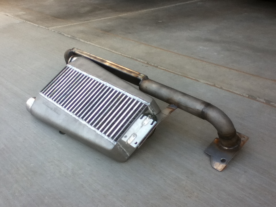

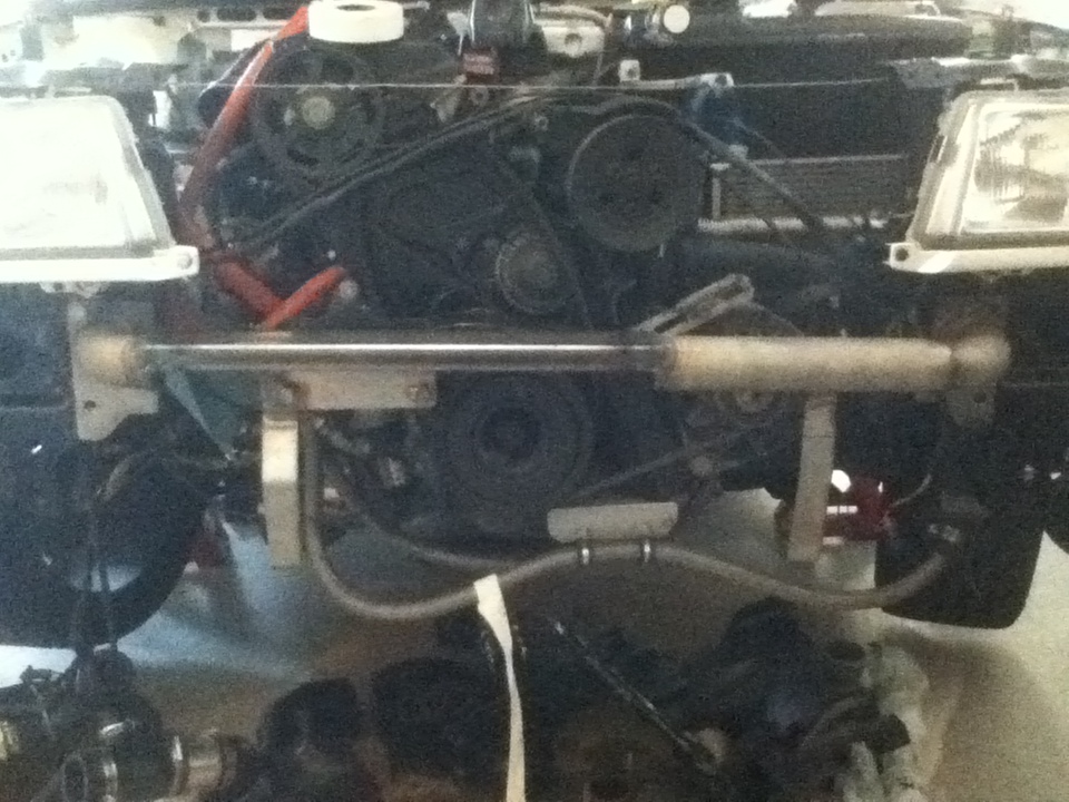

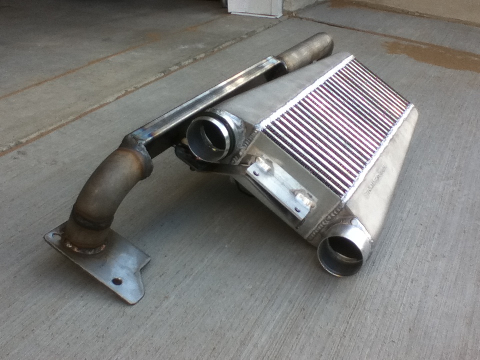

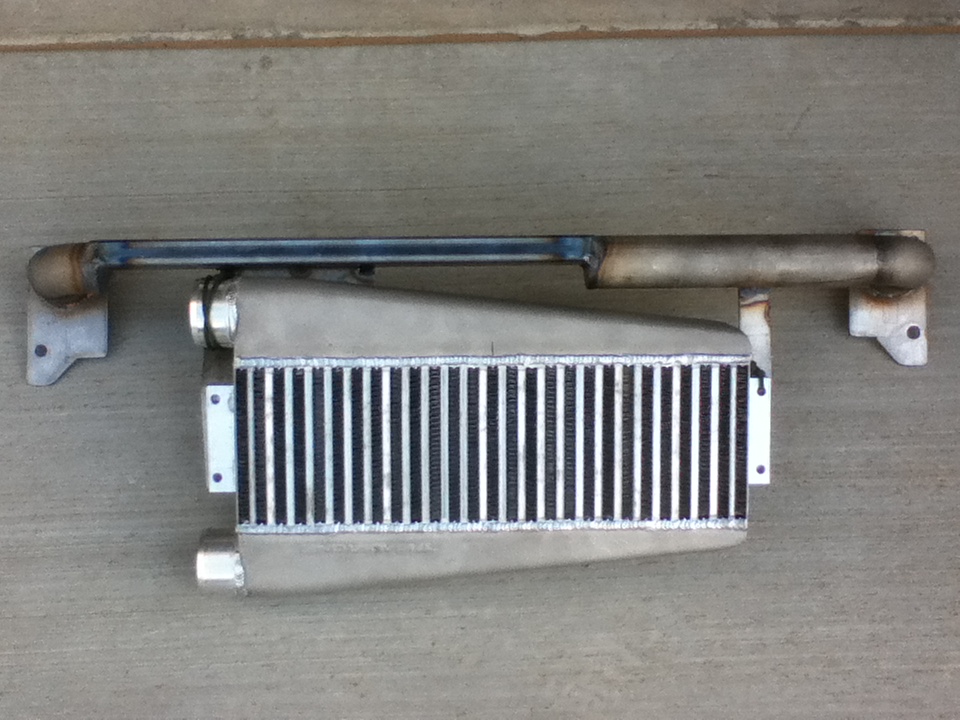

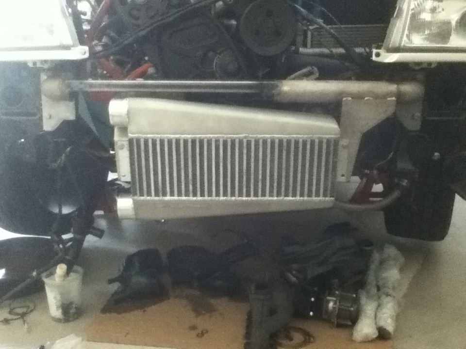

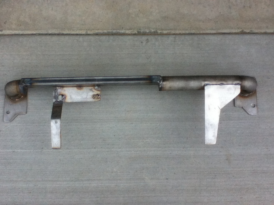

Ok revision #3. I think I finally got the intercooler cross member done. I had to make a larger support so the flex would be minimized. I also welded a brace in the back for extra strength. I think this took longer to make than the headers I made. I probably removed the brace probably 25 times trying different combinations for fitment compliance. The next step is to get the bumper to fit nicely.
I will have to fiberglass a hump on the bottom of the bumper to get the clearance I am looking for. It seems I take one step forward only to have three additional steps. I know that in the end it will be more than worth all the hard work
Larger intercooler support

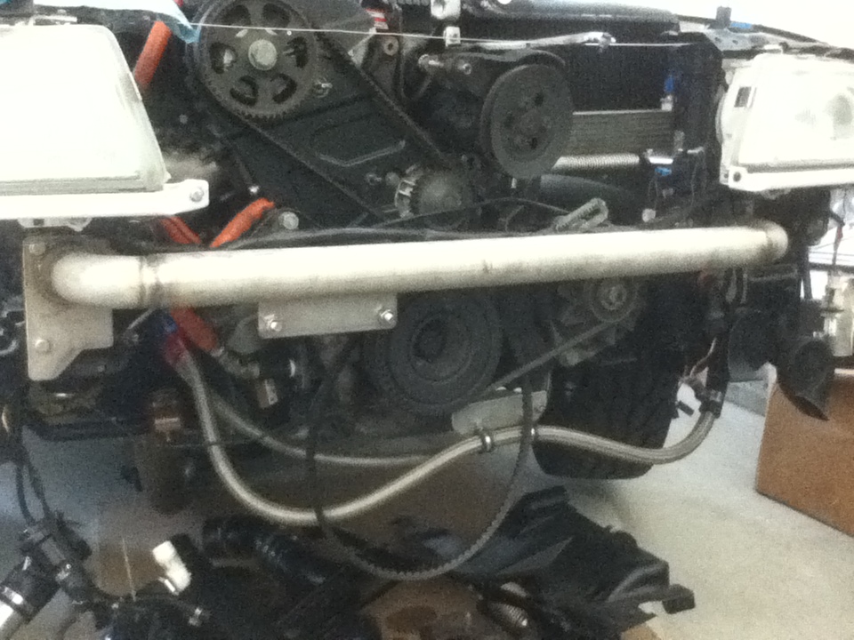

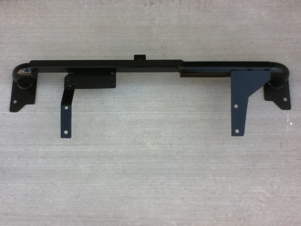

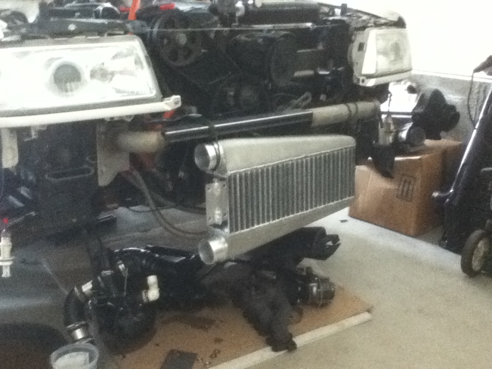

Here is the support on the car. The other support was too flimsy and the way I have the intercooler slanted slightly I ran the risk of the intercooler kissing the harmonic damper. I still have to install some rubber washers to give some vibration resistance.
I am pleased with how solid the arms are and it should prove stable enough for anything on the road. It also looks much better even though you wont see any of this once the bumper is installed
Just finished drilling all the holes
Finally mounted on the car, still needs powder coating

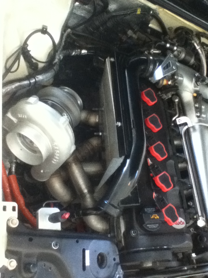

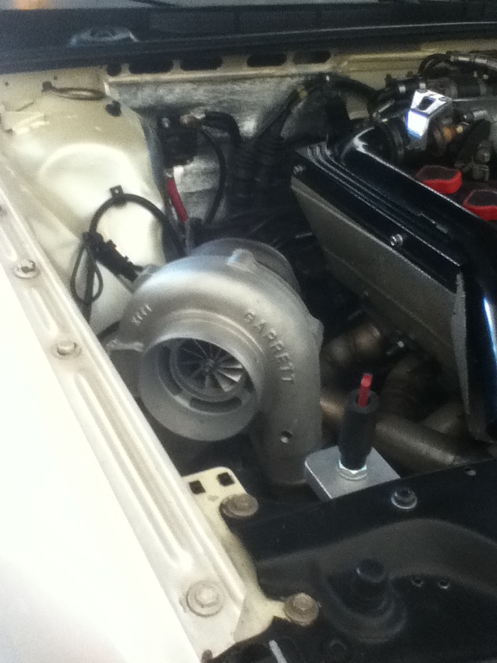

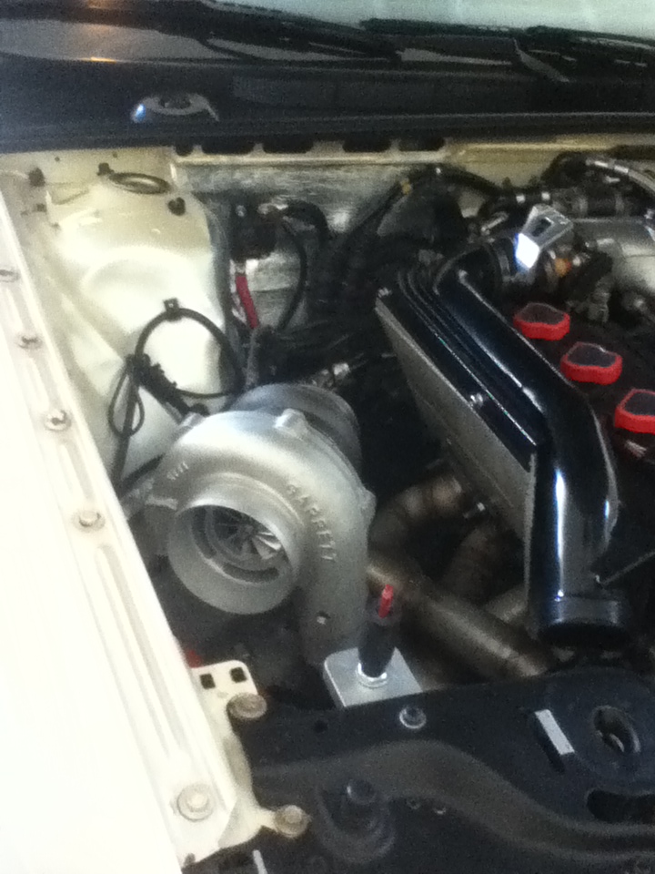

Ah, today I finally got my turbo in after more than a month of waiting. I will be running a GTX3076R with an A/R .60 it should meet my target HP goal of 600 BHP, 450 WHP. With the turbo I was able to finally weld up the T-3 flange. I waited because I wanted to be absolutely sure of down pipe clearance that I will be fabricating. The billet wheel sure looks the business. I can't wait to get her back on the road!! I still have to pull the head and replace the exhaust valves that I also received today. I went with some stainless steel ferrera Inconel exhaust valves that will do the job nicely.
GTX installed
GTX installed

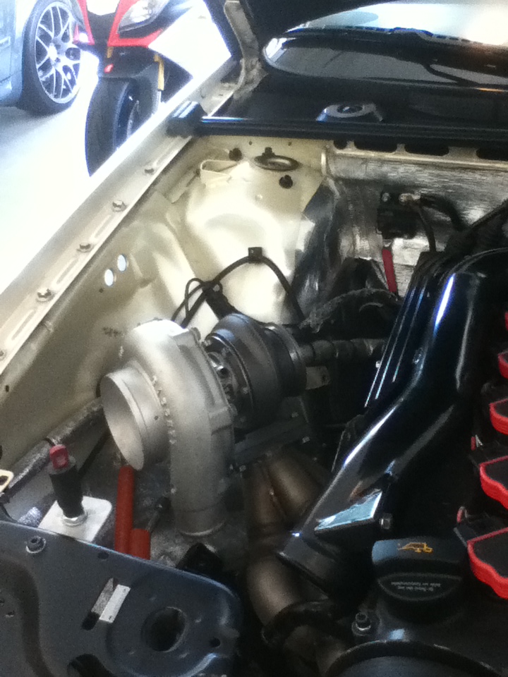

Here are a couple of shots from the drivers side. I will be cutting through the side wall for the cold air intake that will be located behind the bumper

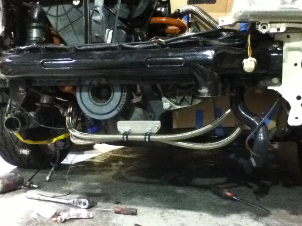

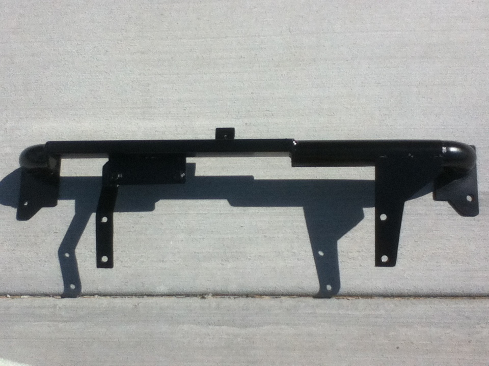

Cross member has been painted ready for install, I have been running around a lot lately but not much is getting done. Still moving forward ever so slowly. Tomorrow I will attempt to get all the oil lines and coolant lines taken care of. I still have to purchase an oil restrictor for the Garrett turbo charger. A .040 should do the trick

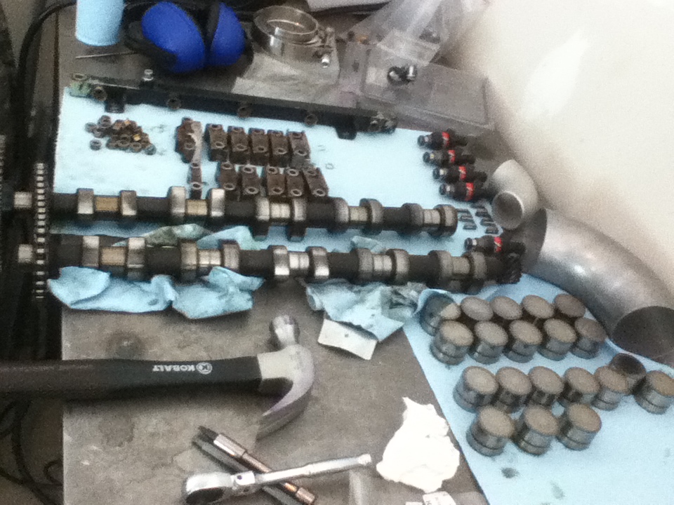

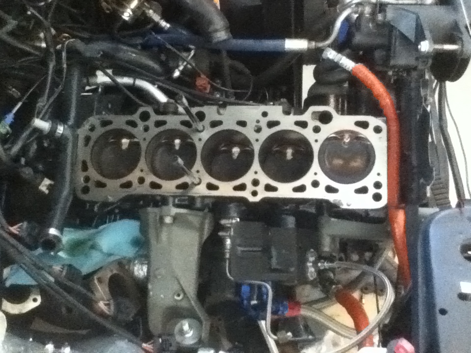

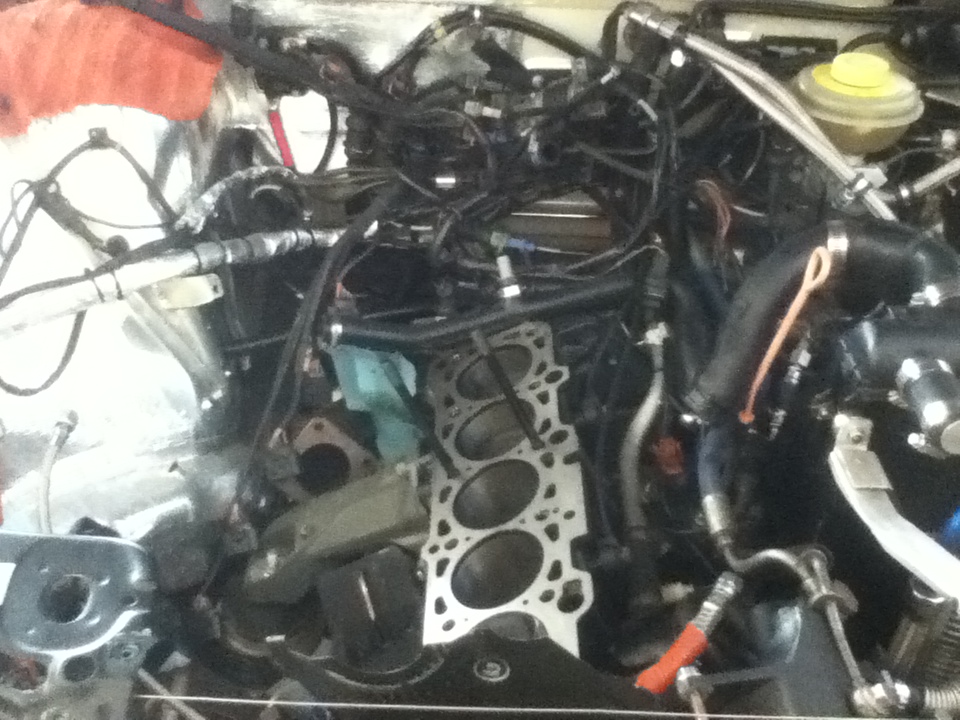

The past couple of days has been sourcing parts for the turbo like the an fittings for the oil and coolant supply. I have everything that I need I hope, so now that I am just waiting on parts its time to move on to the head. While building the motor the valves were fine but later I found out that the sodium filled exhaust valves are rather prone to break under load, wish I knew this before I put everything back together.
Today was spent disassembling the motor for head removal, it wasn't terrible difficult just time consuming, a lot of little things to remove and not a lot of space to do it in. I was able to remove the head and get the valves lapped and changed out and reinstalled today. I need a new MLS head gasket before the head can go back on which I should be able to have tomorrow if all goes well.
Got everything off for the head removal
all the little bits that take the time away from your life
need I say more
need I say more

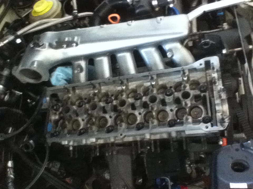

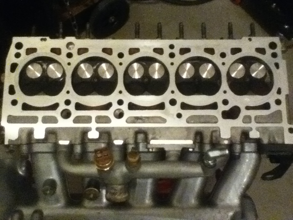

the head is off, I wish those pistons could stay looking like they did when they went in.
Head cleaned and valves lapped ready for re-entry Sulu
