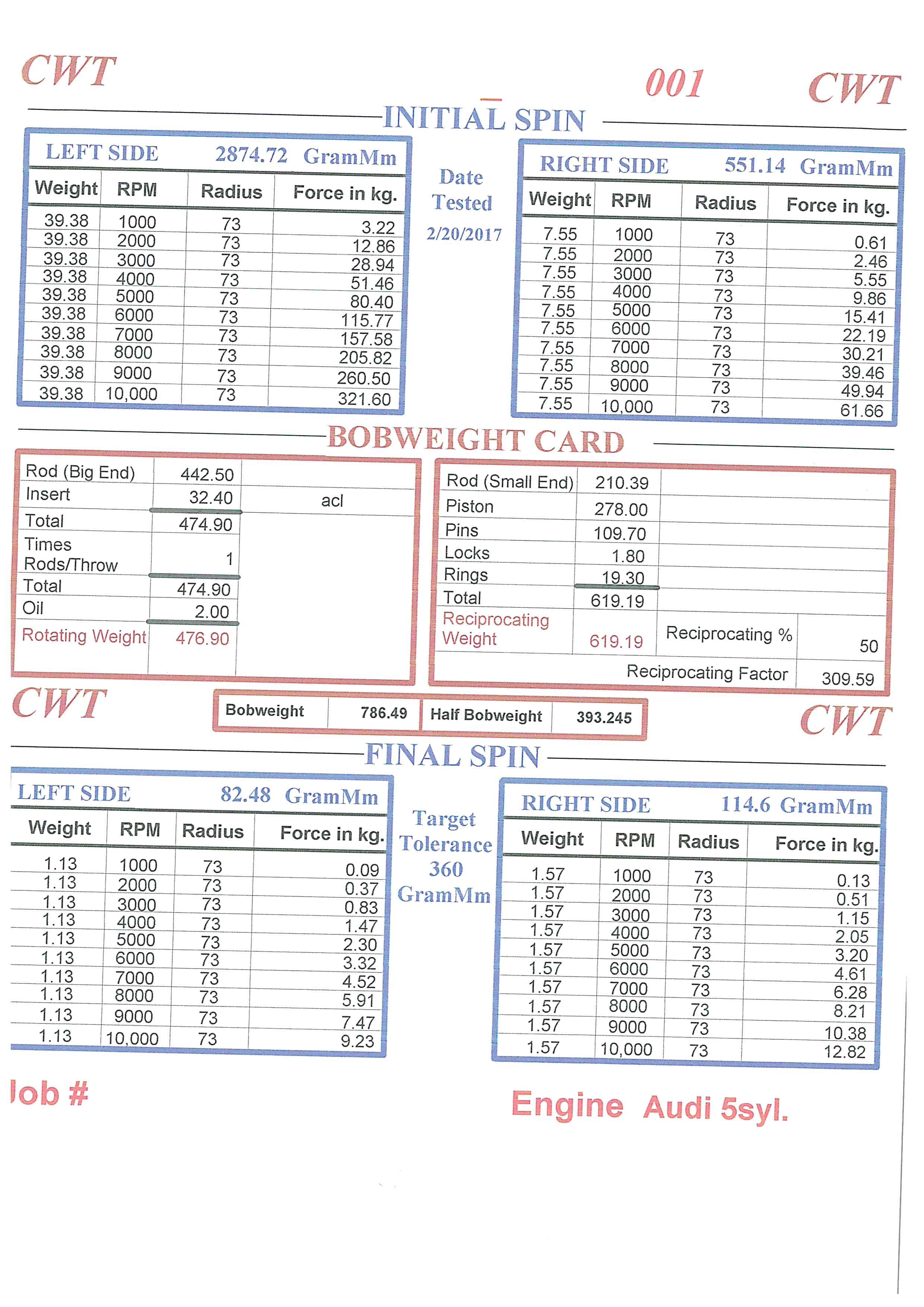

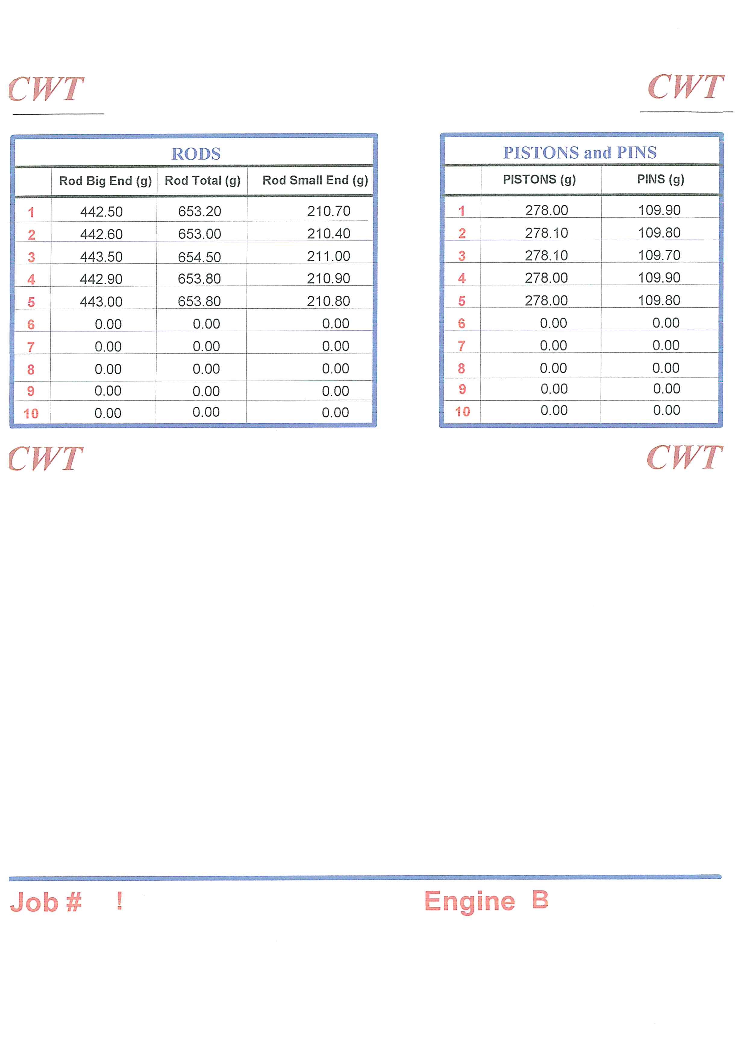

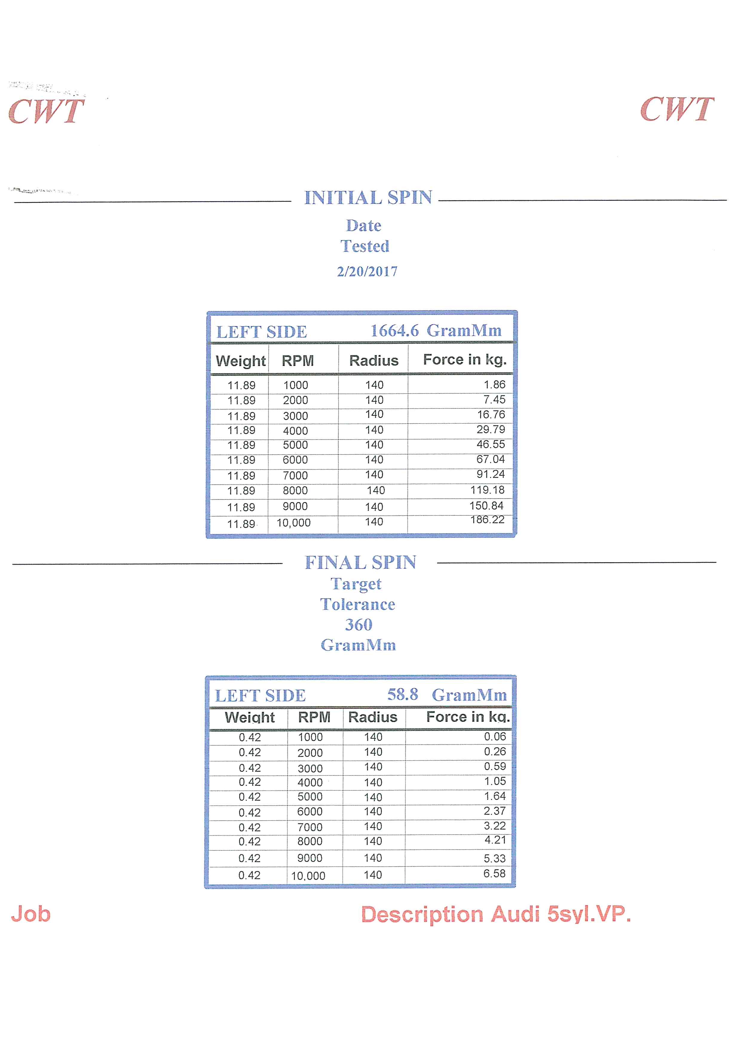

Got the rotating assembly balanced last week.
balance
balance
pistons rods weight
pistons rods weight
flywheel balance
flywheel balance

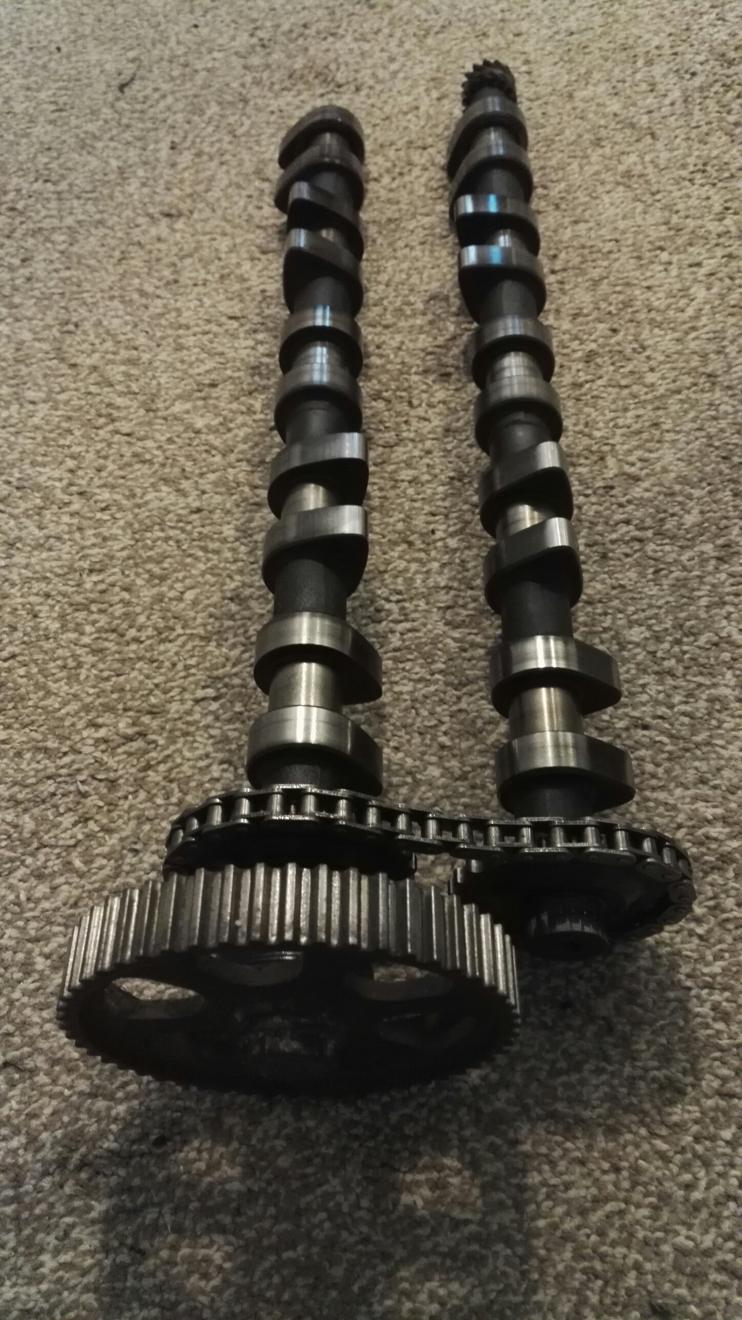

Some parthoarding done, all of these came through S2forum members:
7A cams from same guy who sold me 200 20v flywheel and 7A dampner.
7A cams
7A cams

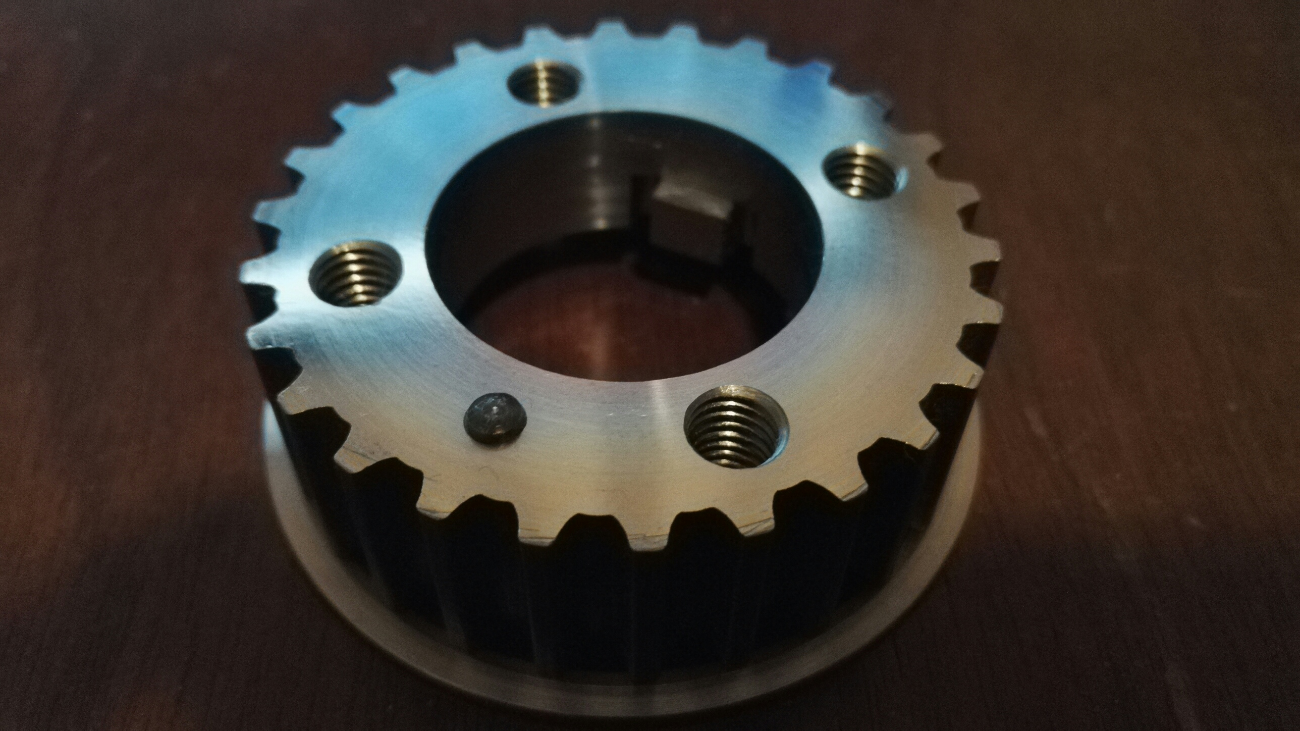

Terrybullwon cranck gear
gear
gear

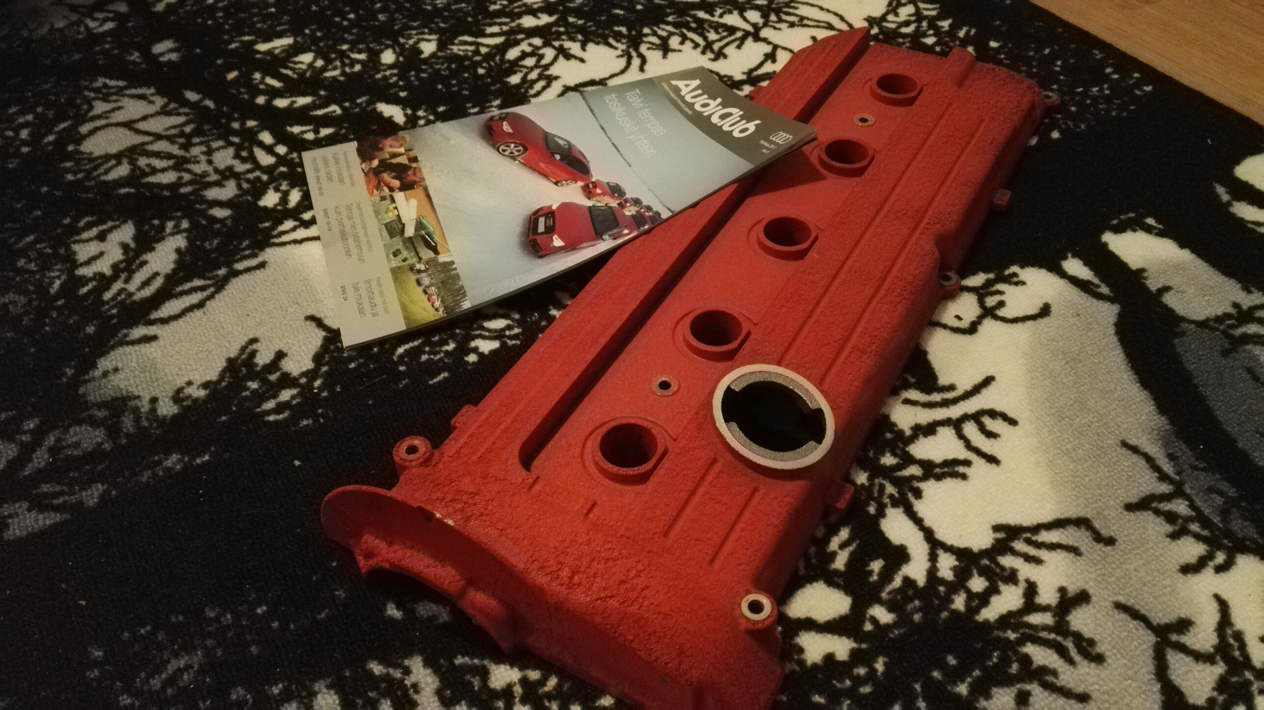

Fancy red camcover and some propaganda newsletter ;)

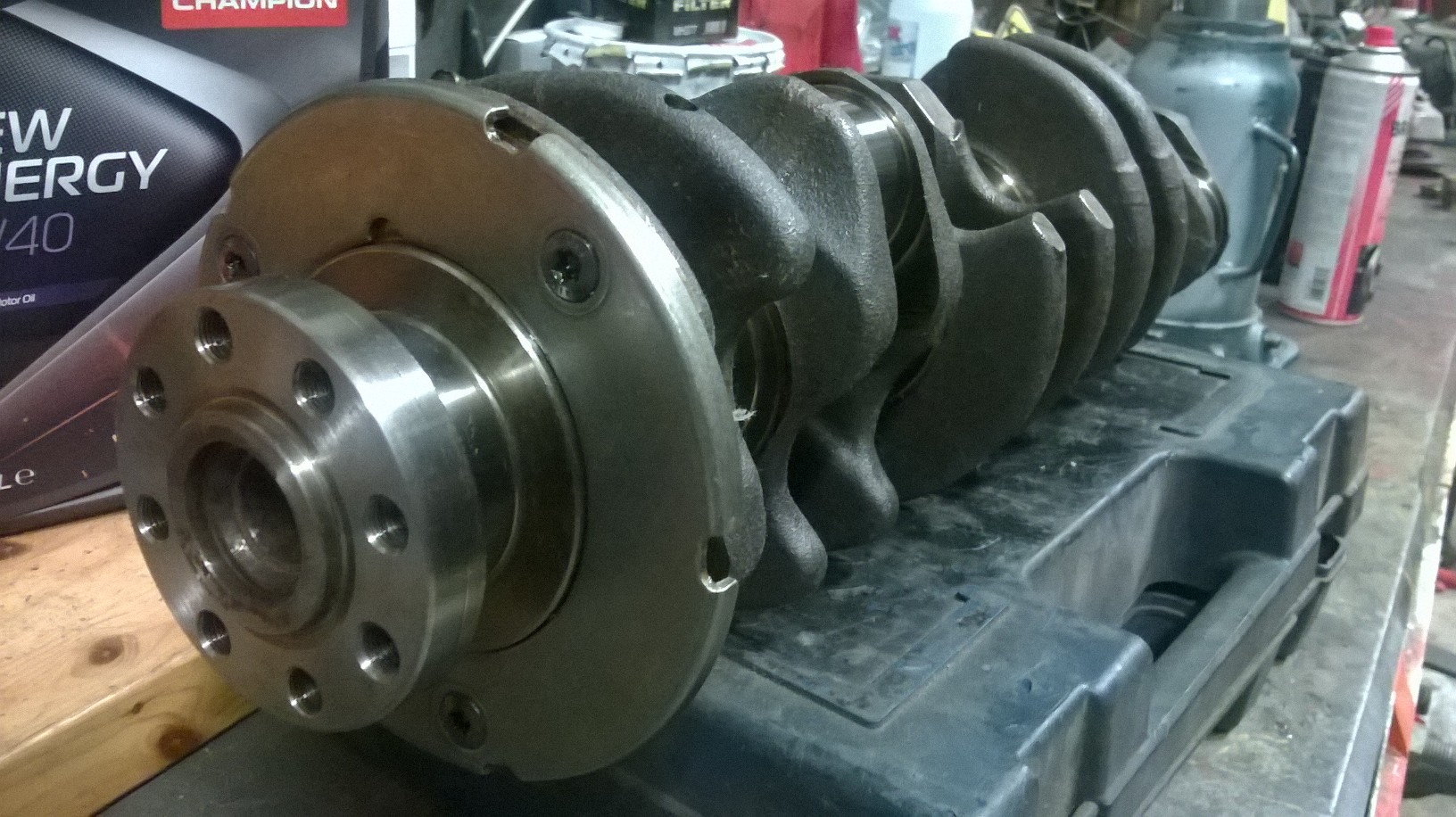

Decided to try and use the triggerwheel on ACV crancksaft.
Didn't find any how to or BTDT on this from the web, so maybe not so smart to go this road but we'll see.
trigger
trigger

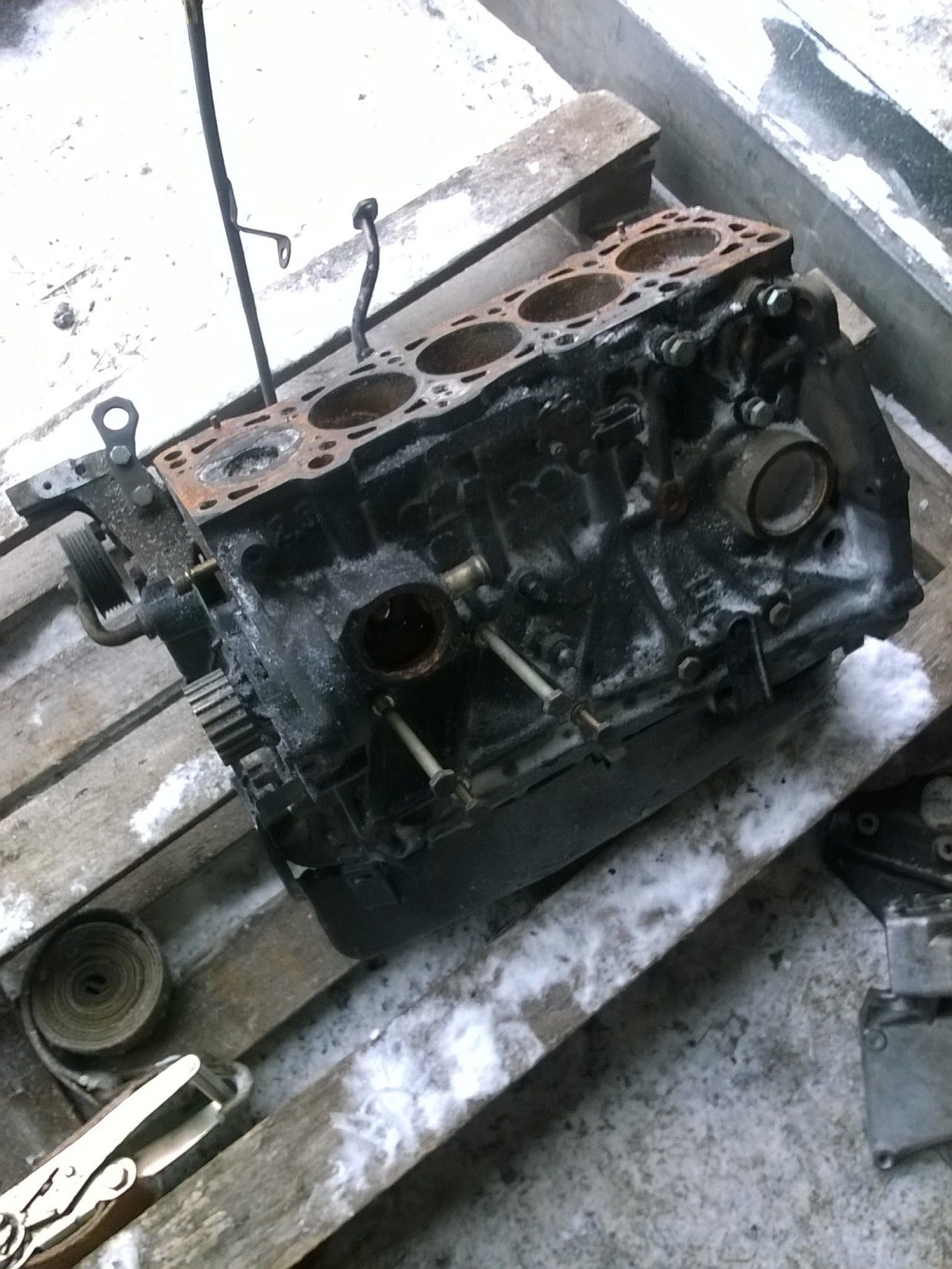

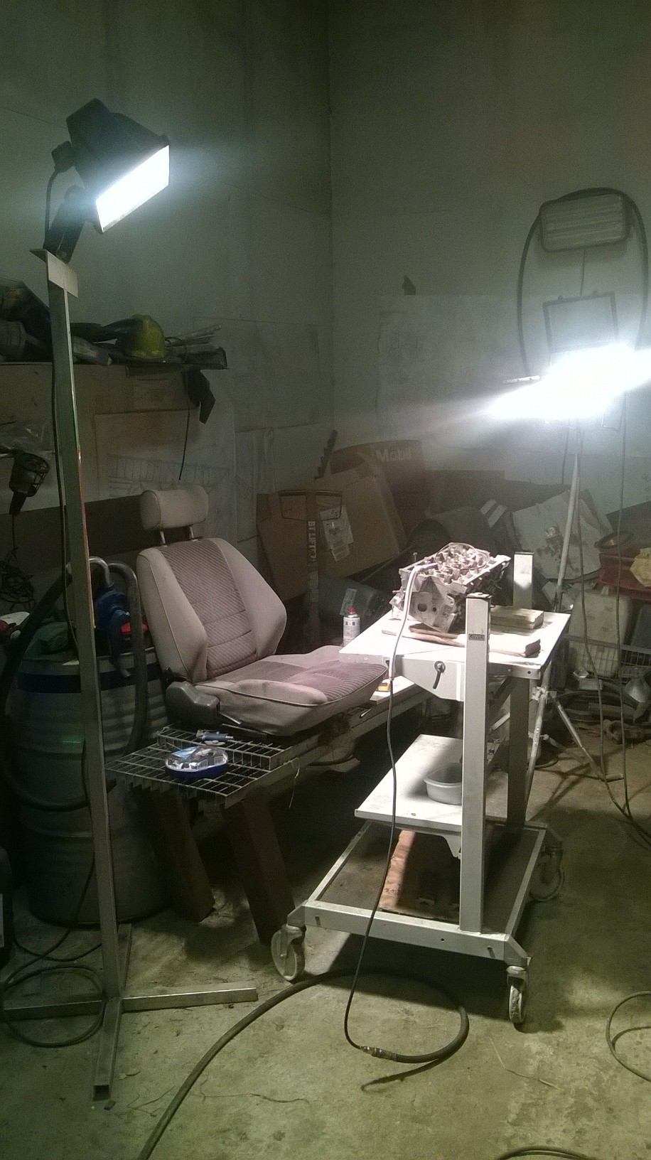

A few old pics when decided to start building the engine, just because started spamming with photos:
Treasure just as found from local junk yard, ACV block from -97 transporter 8-)
junk
junk

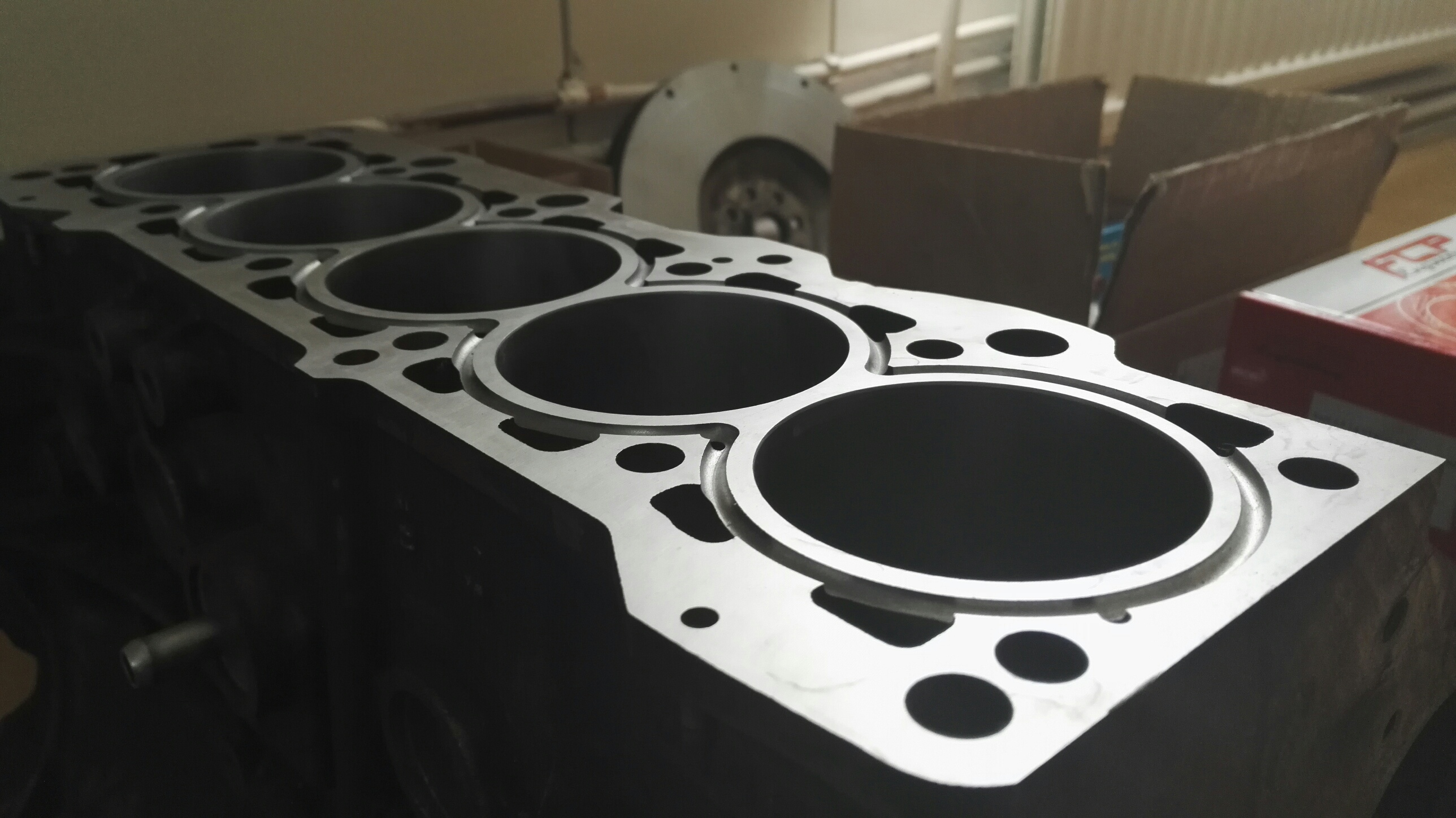

Driving this thing for 2 weeks now and some 1500 kilometers (930 miles..) with no hiccups what so ever.

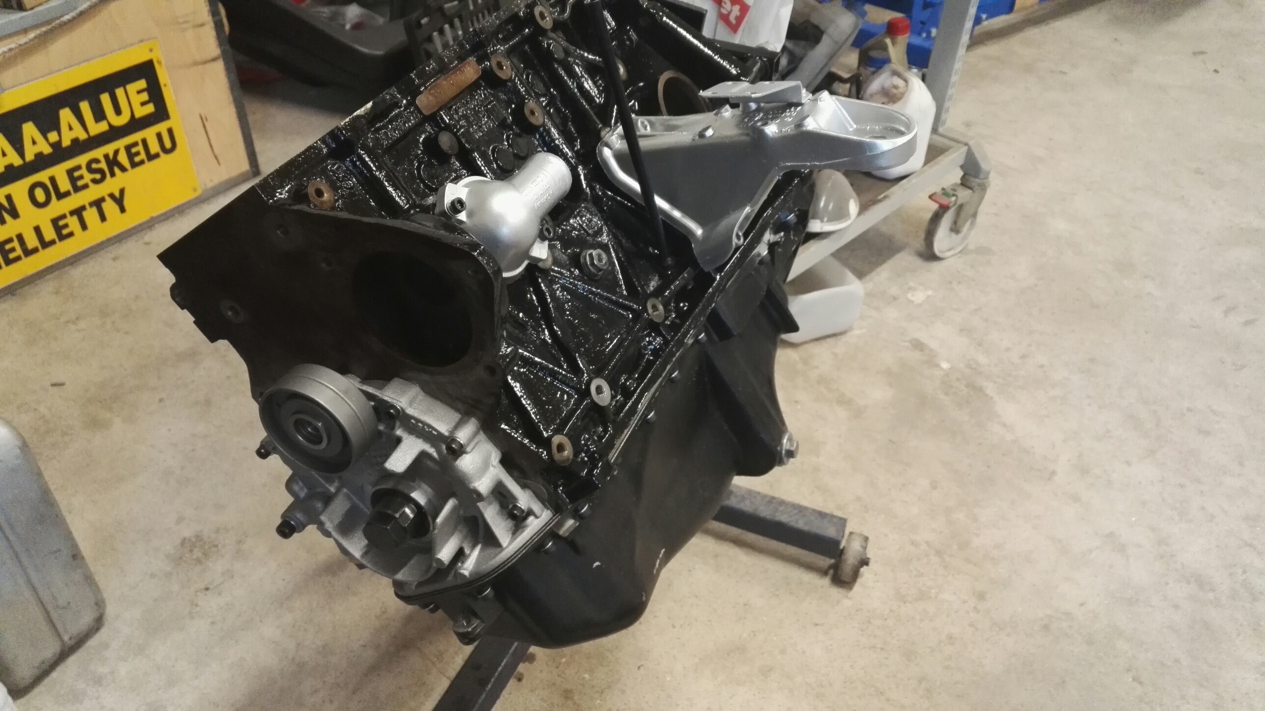

Got the stroker block from the machineshop, waiting for head to be ready. Might start to assemble the block slowly..
block
block

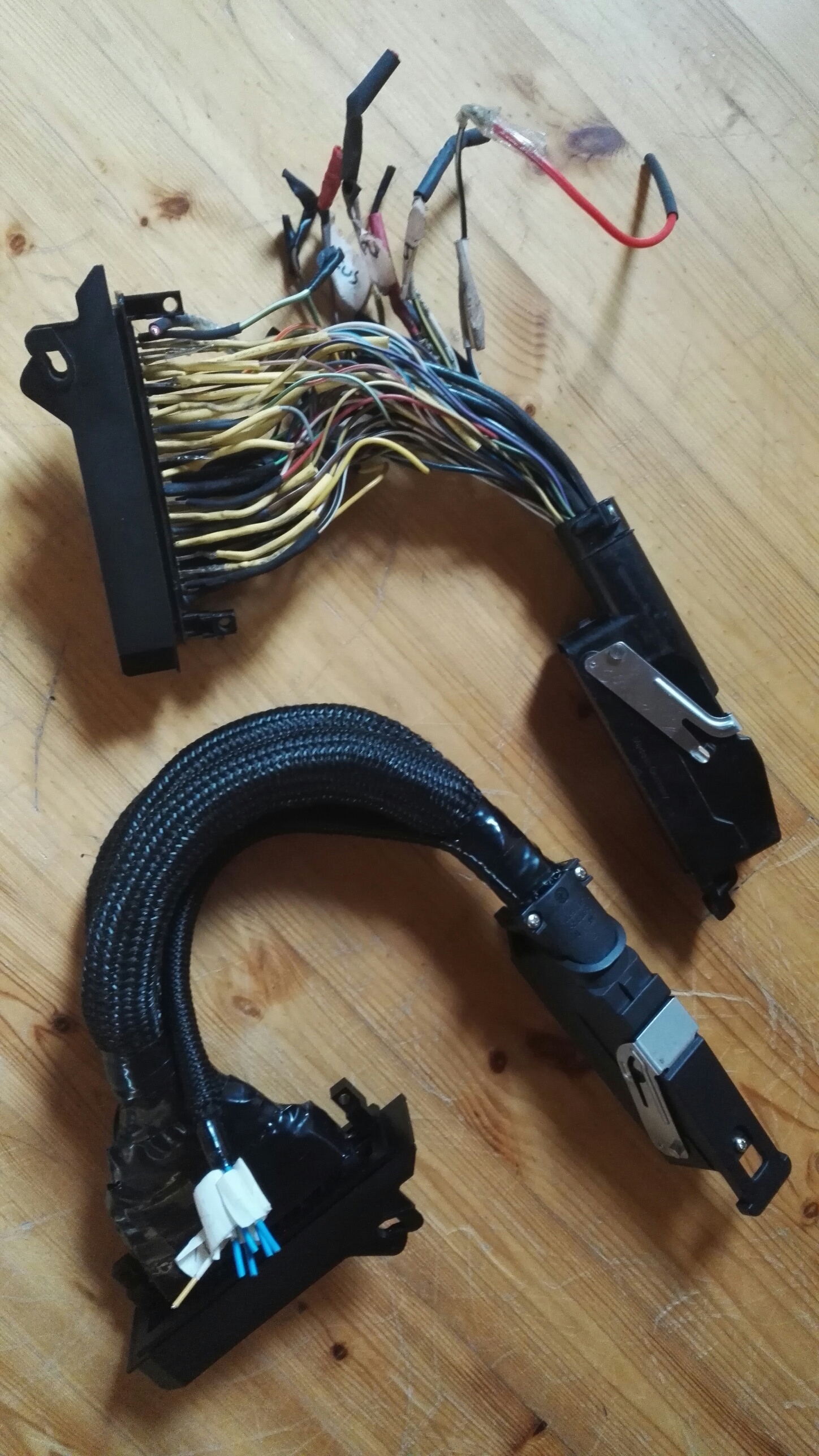

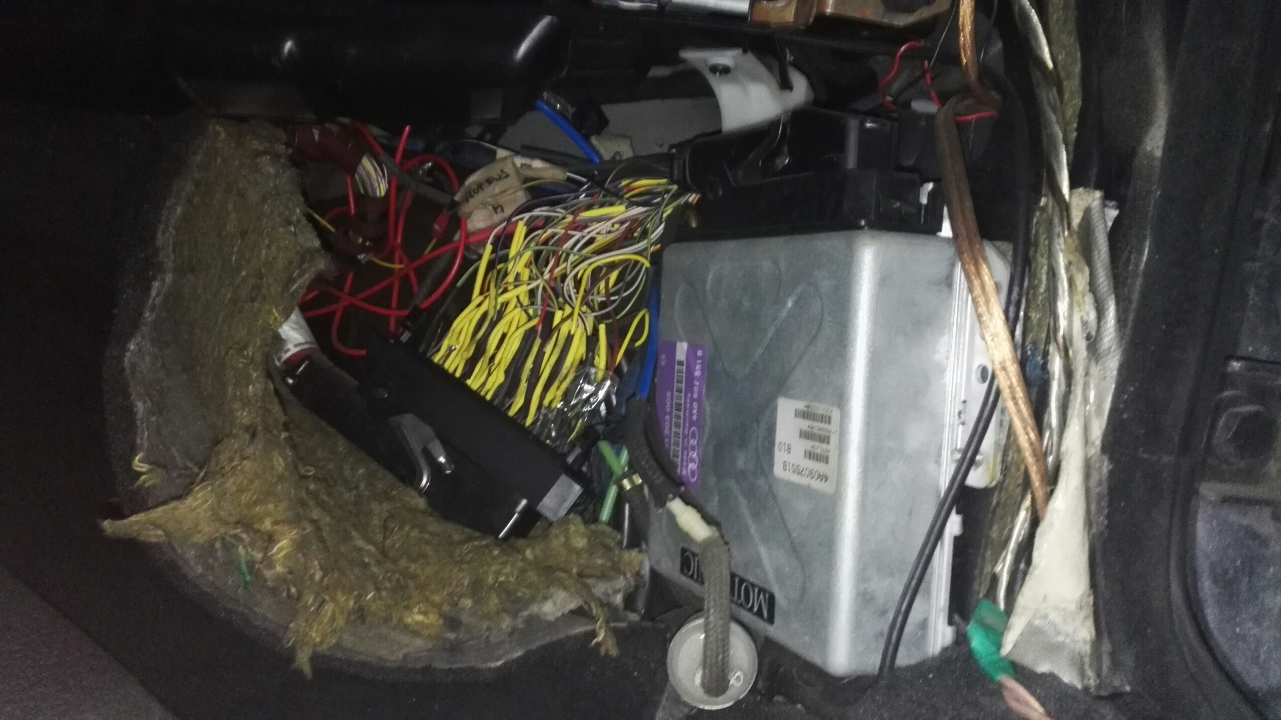

Took a look at current ecu and found out some electrics needed some attention... :roll: .. so I made new 3B wiring harness to AAN ecu adapter.
mess
mess
There were some Audi S6 ecu judging by the numbers, I took a look inside but didn't dare to mess with the boards..
The more I find this stuff, the more I'm amazed it even runs..
3B - AAN
3B - AAN

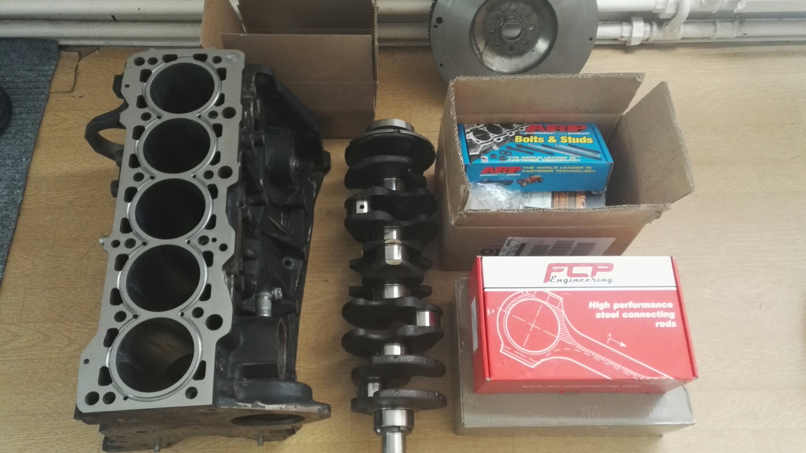

1. Old engine and trans out, all of the pistons have substantial side rocking at tdc, explains the blow by?
2. New bottom end mostly assembled with everything new and in upper end of clearances

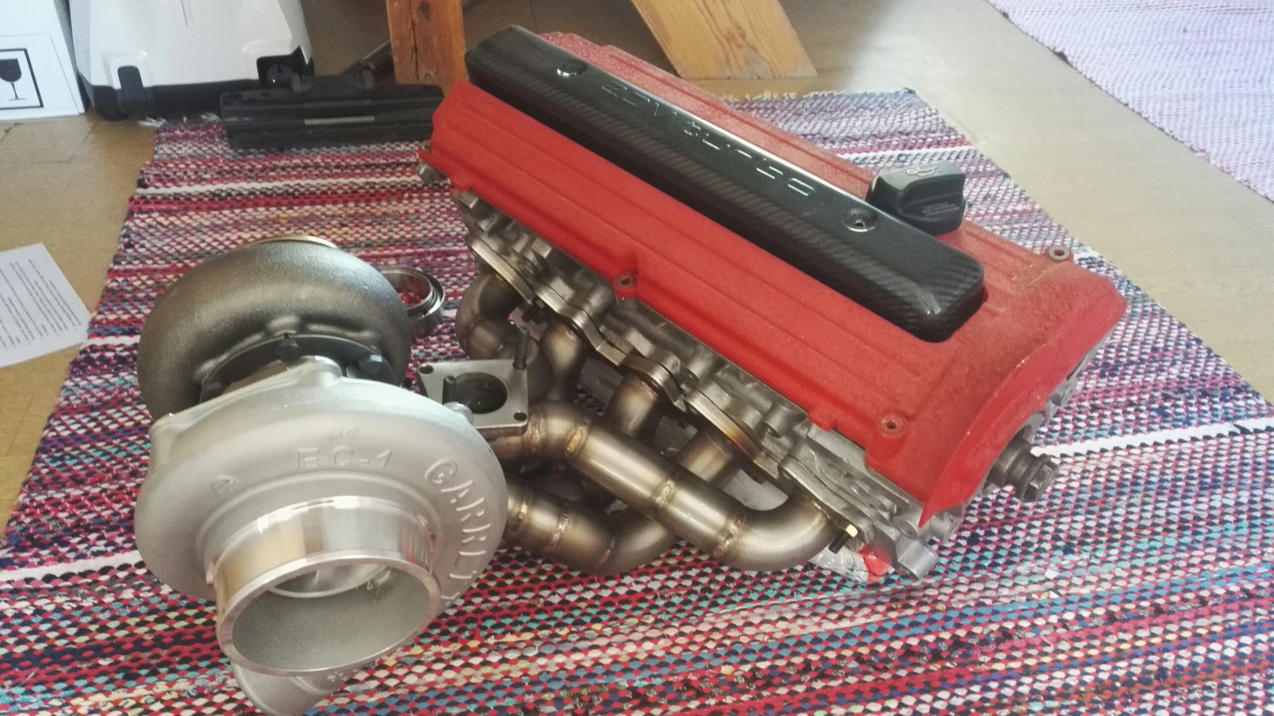

4. EFR turbo changed to GTW garret by recommendations by experts, GTW3884R on shelf waiting for the head to find it's place
5. Tube header waiting for EGT nipples, downpipe for BN-Pipes 2x2.25 full system and maybe a heat wrapping as well?

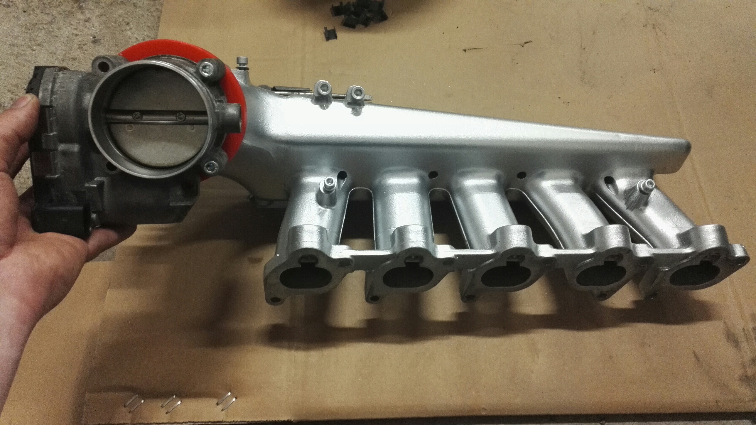

6. Engine needs some wiring for VW Lupo 60-2 trigger, typ44 1T electronic throttle pedal + 70mm RS4 throttle plate (WOT shifting at 1/4 mile)

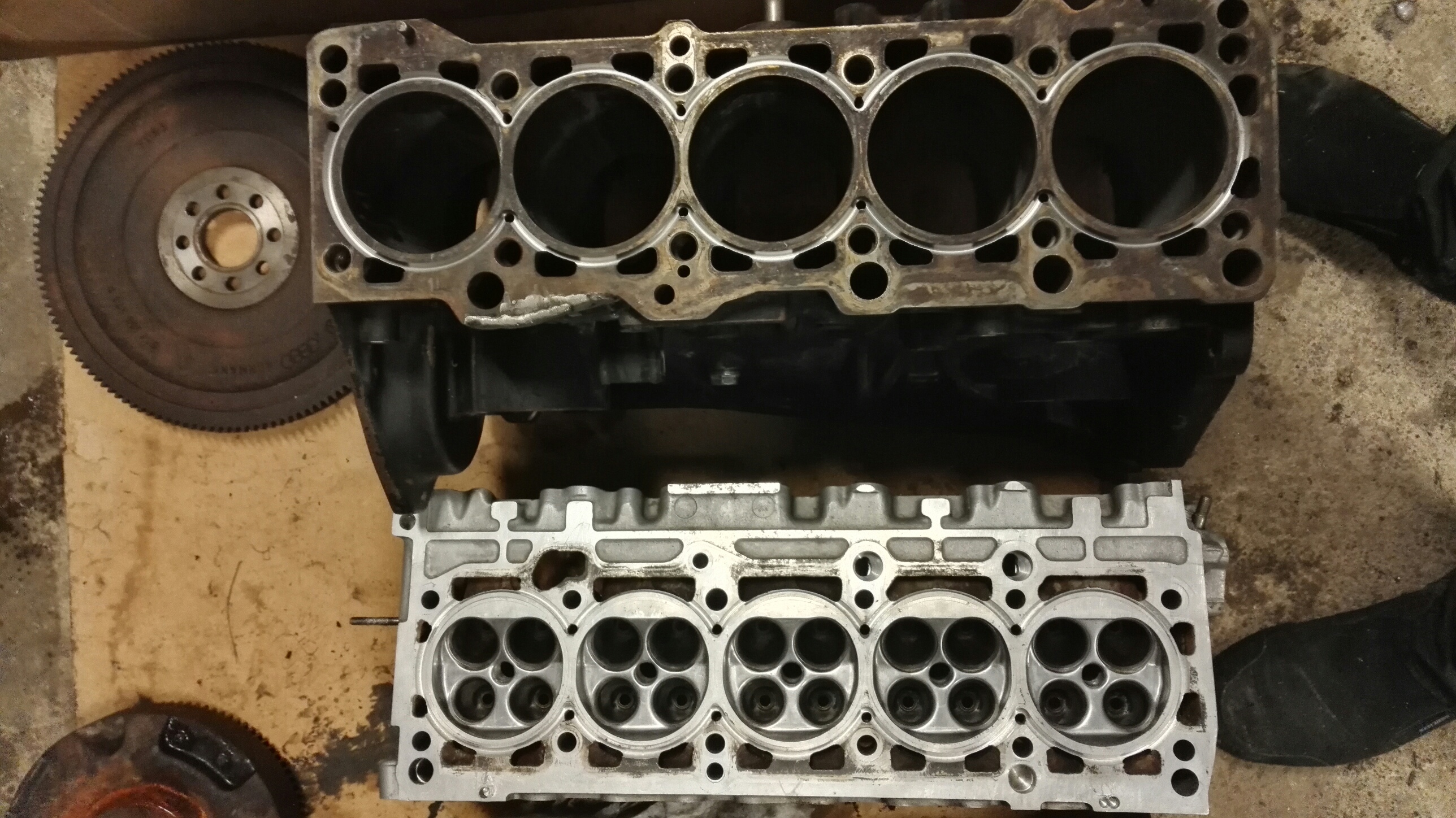

This thing started with a new heart today.
ACV 2.5 tdi block + 7A head and cams paired to Garret GTW3884R 62/64 and 01E from a tdi A4 B5.
I have to say I'm quite happy, this is the first engine I've built from scratch and it started right away. :)
Ran it to temp and re-torqued the head studs.
Some more wrenching tomorrow. :P
