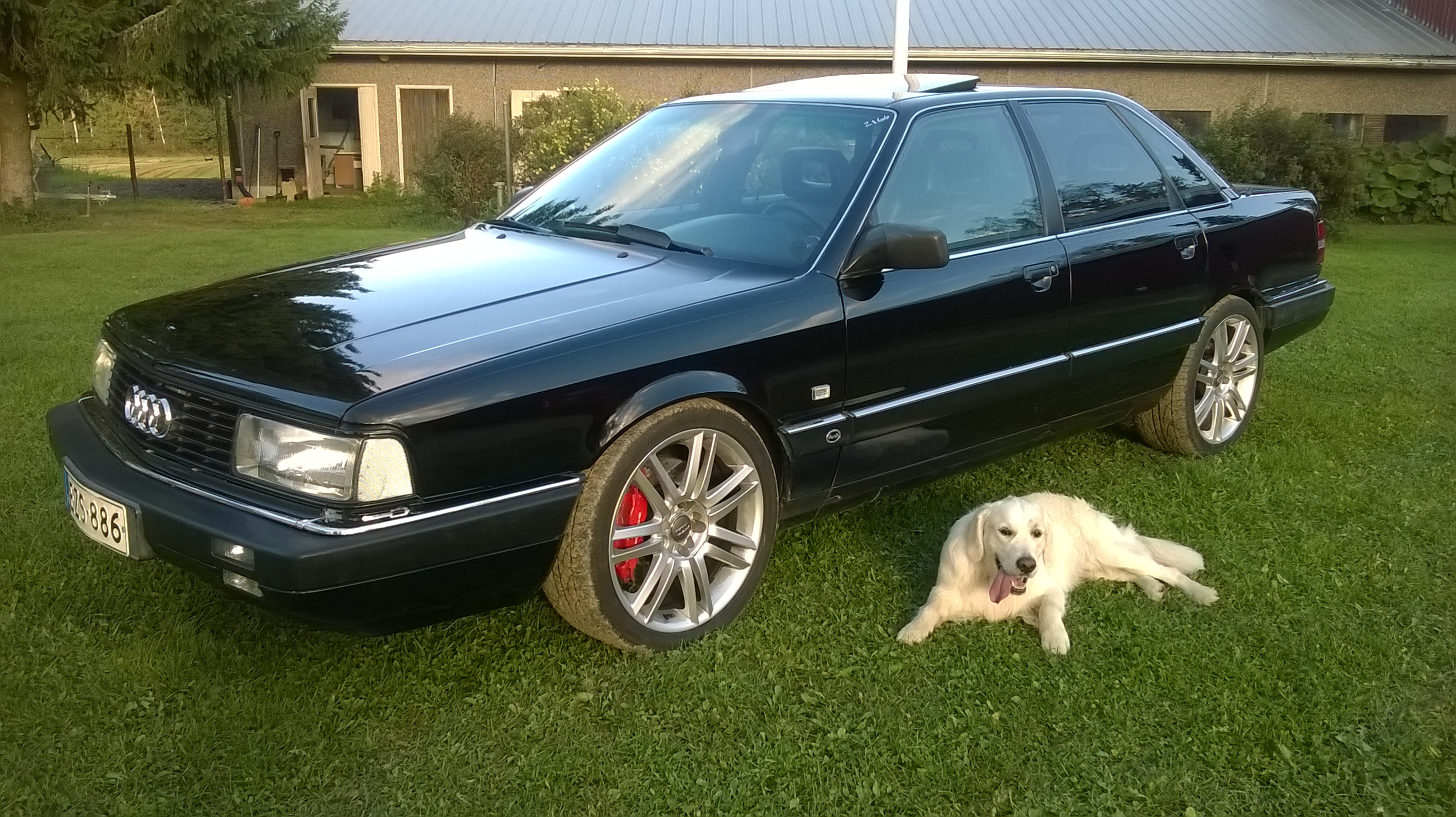

Currently I don't have many good pictures of the car, but I managet to find some from my phone..
These are all from last summer and the car is currently in winter storage.
(Crazy to keep quattro in winter storage, I know, but maybe next winter after some fixes..)
This one has the "USA front bumpers" which are kinda rare over here.
Missing a trim piece from front left corner below side reflector.
And Custom Auto Craft red rear lights of course. ;)

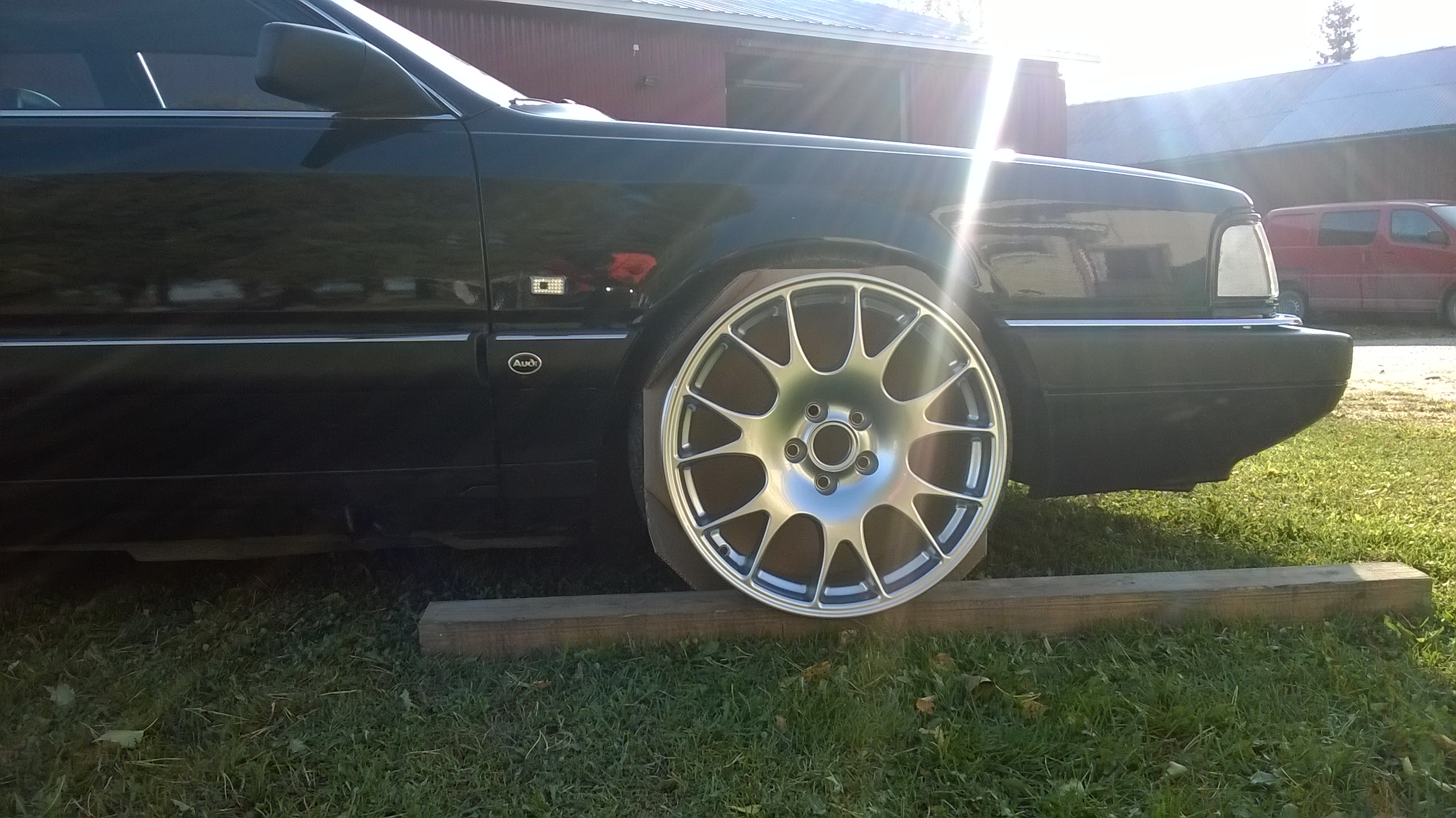

Accidentaly bought new rims for this one as well from Audi Tradition. Audi OEM BBS CH028.
I might try these or sell these, not a 100% sure yet.

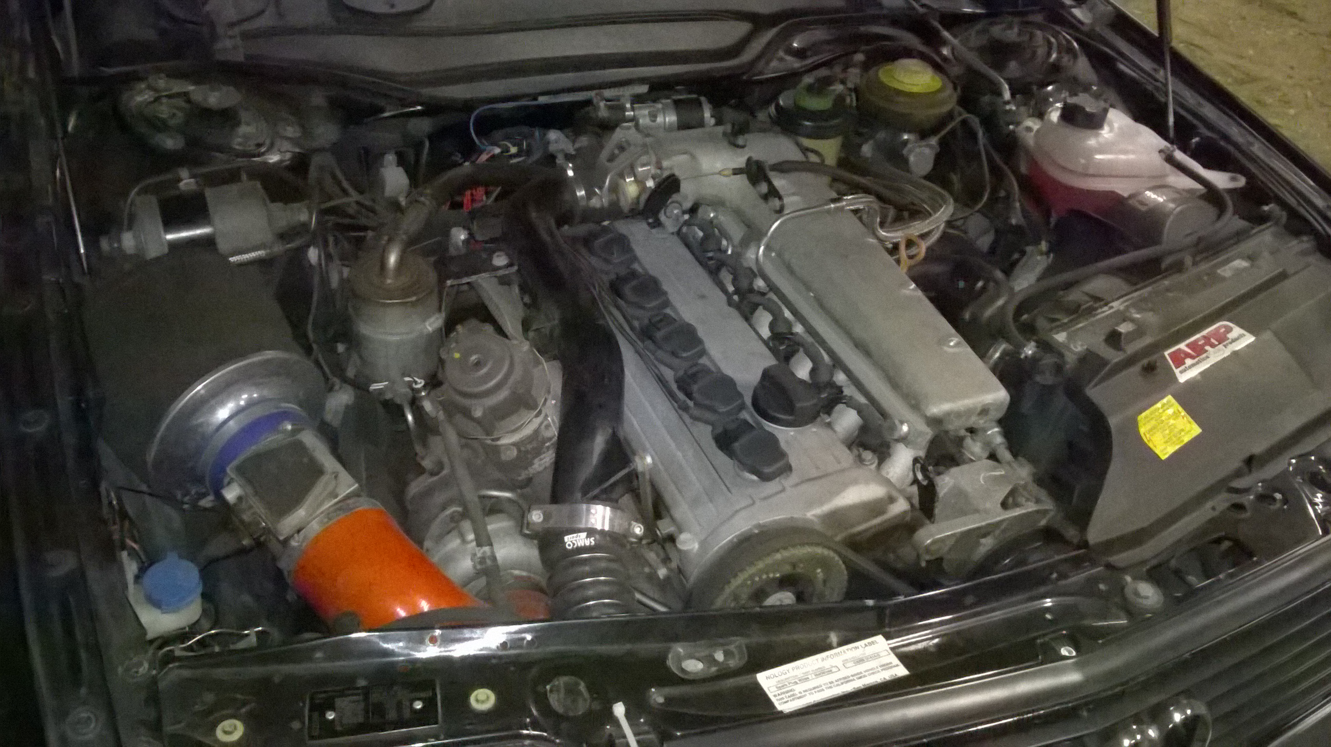

Heres one bad pic from engine bay.. Needs a clean up + something more. ;)

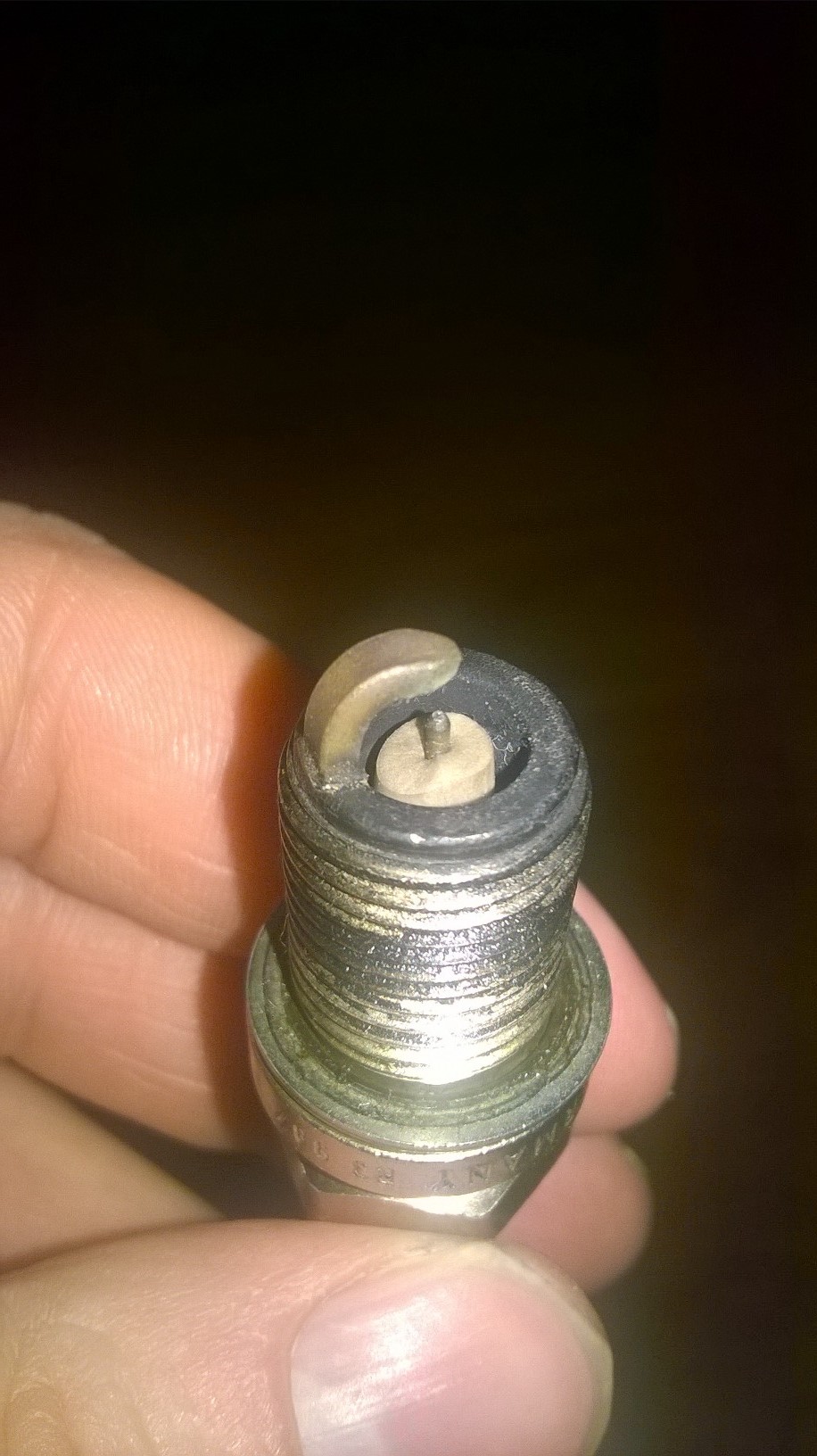

This happened last fall, the reason for compression testing:
Bosch FR5DP. :shame:
But, because I need to do the same mistakes over and over again before I learn something, I got new Bosch plugs. :foff:

The destroyed Bosch plug was on cyl 4 last summer, so no clear indicators IMO from damages that the plug could have caused..
Missed a bullet there. :P

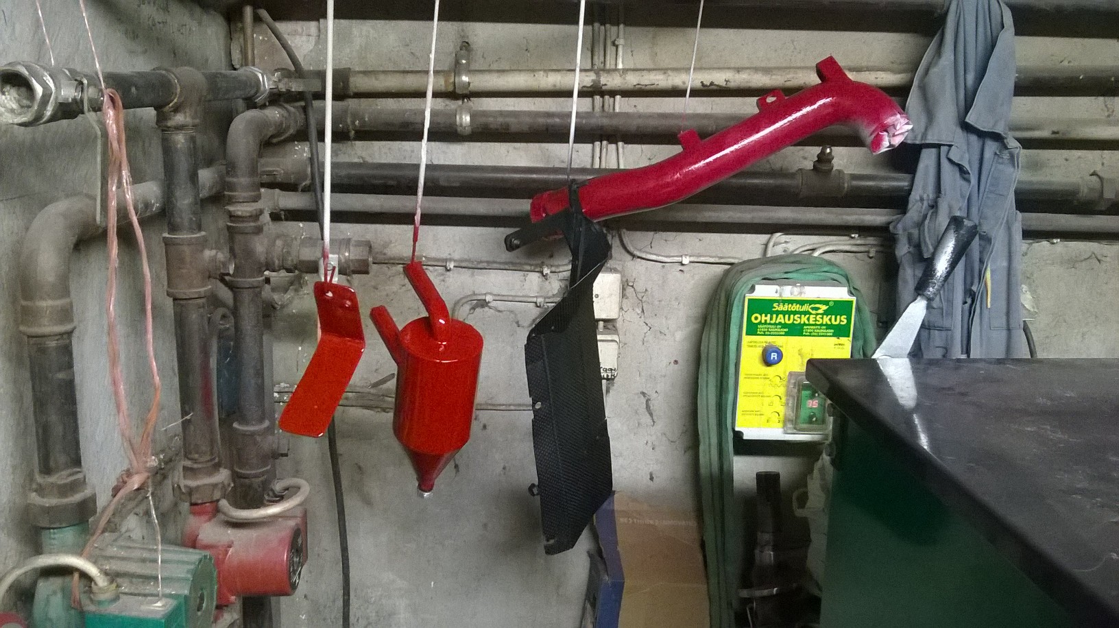

Painted some bits and bobs, but failed miserably. :lol:
Turns out I need to keep the hood closed from now on.. :rofl:

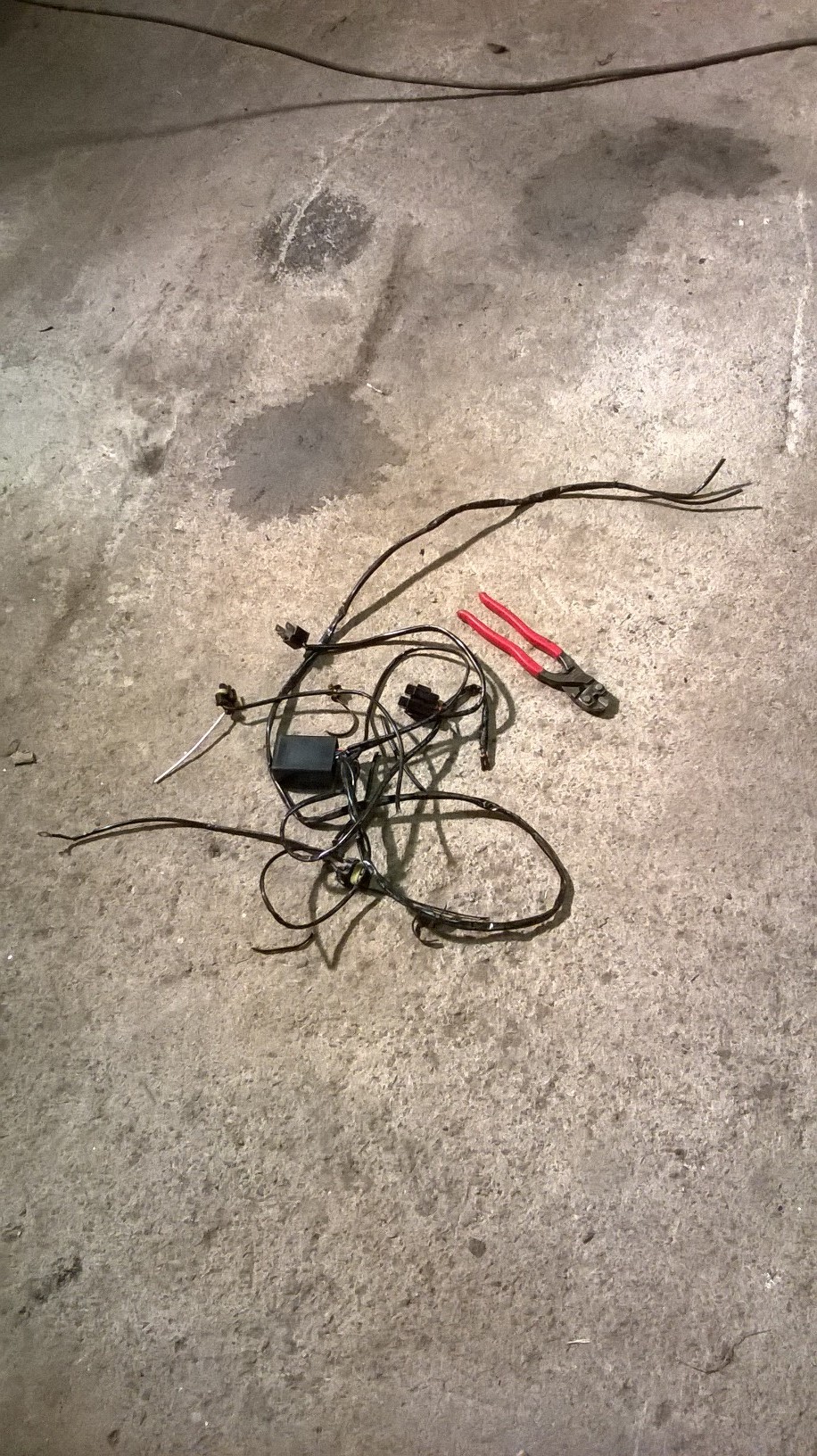

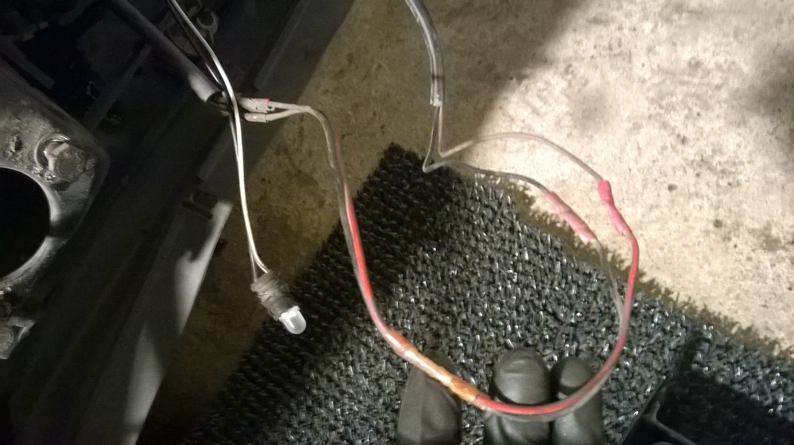

While taking everything apart I found out that this one is assembled mainly using drill screws and with electrical miracles as this:
:shame: :bs:
This one has also had xenons at some point..
But never again.

Ok, so the wires are mostly sorted now.
Got rid of all of those horrible connections and made somewhat a harness for lights in bumper.
Might still redo the coil wires at somepoint as they seem a bit odd...
