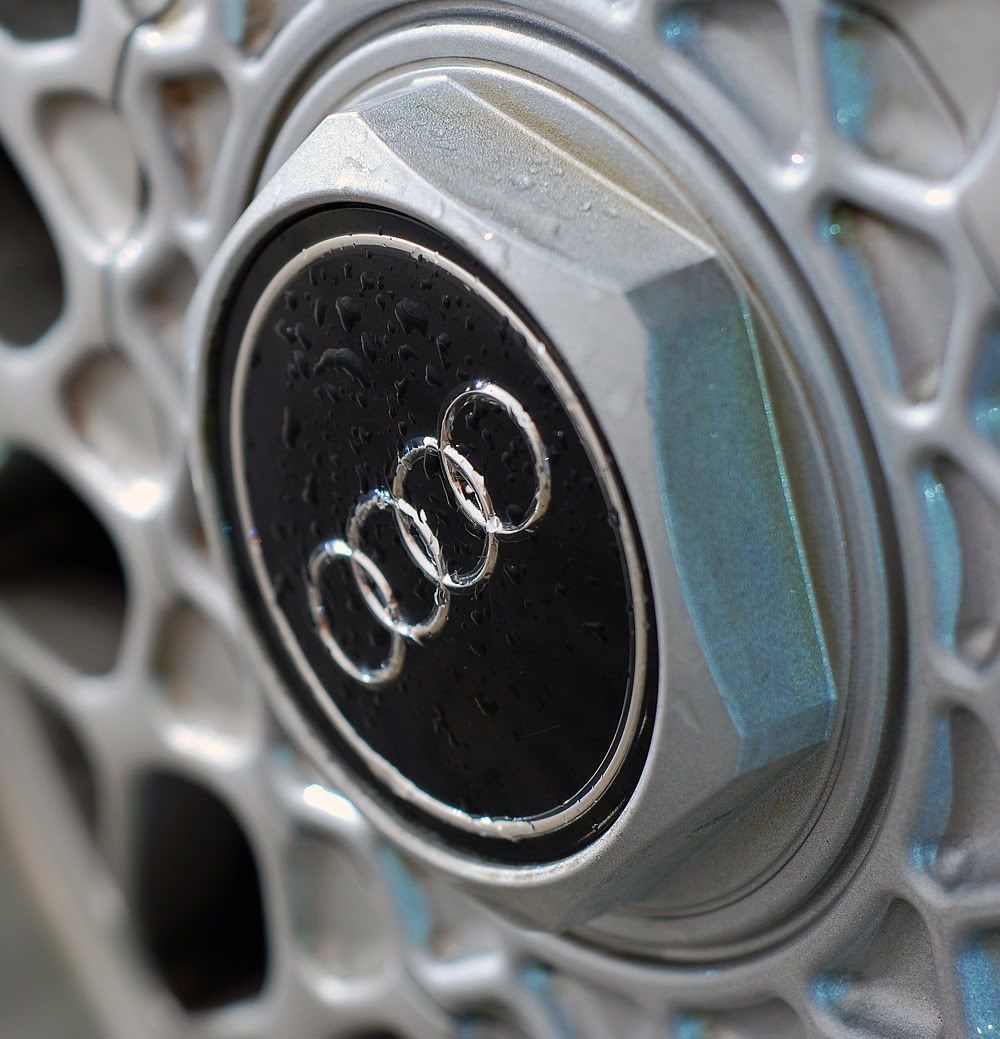

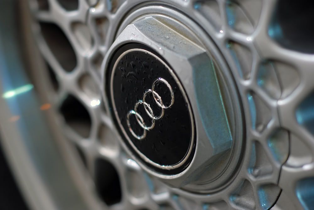

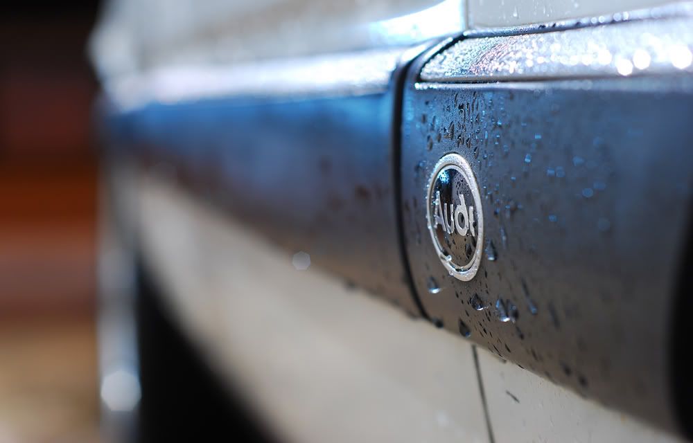

well, I'm a sucker for editing my own pics. I have to get up in about 6 hours...but these were worth it to me.
Low res sucks (and photobucket rapes my pics), but if you want anything in high-res, all you have to do is ask!

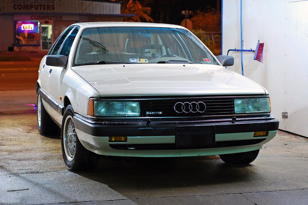

and then for some reason, I felt compelled to edit one of the front shots to get this kind "looking down the side" effect that I wanted to capture while shooting. (unfortunately I had a really difficult time of it) I really had trouble with the cropping of it...but this was the only version that felt at least almost right.
I wanted the effect of a meaty stance...its something I can see when I'm actually looking at the car in person...but its really hard to convey with photos for some reason.
hope you all enjoy them
