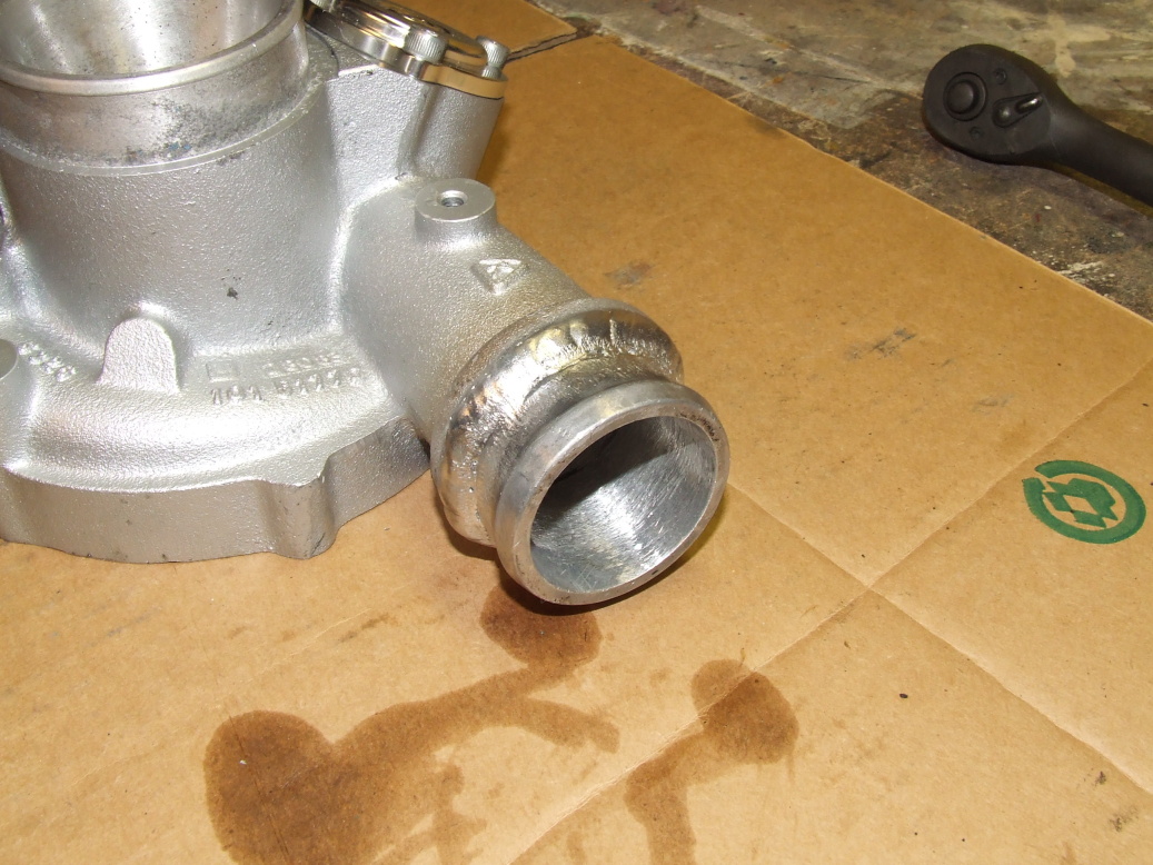

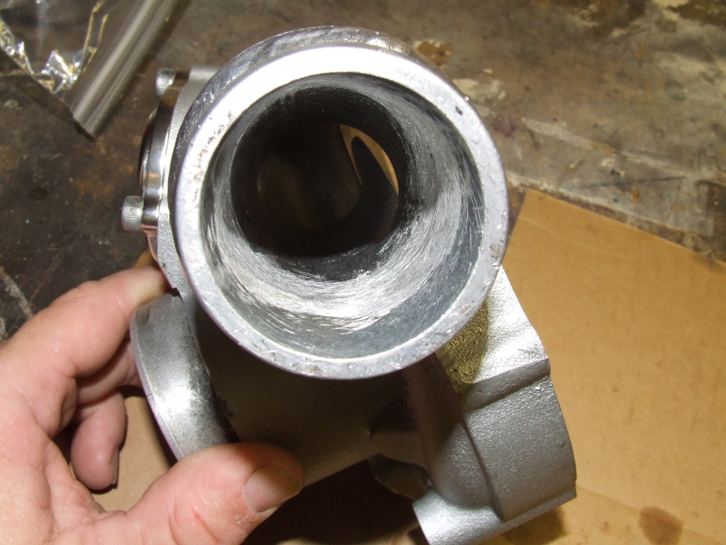

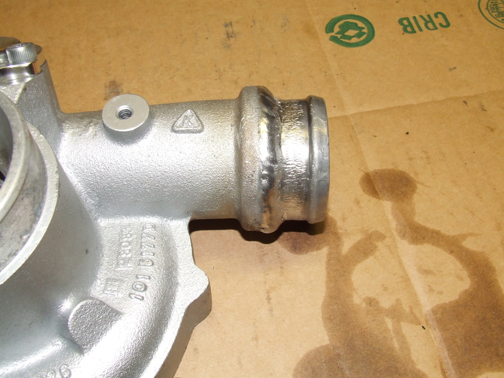

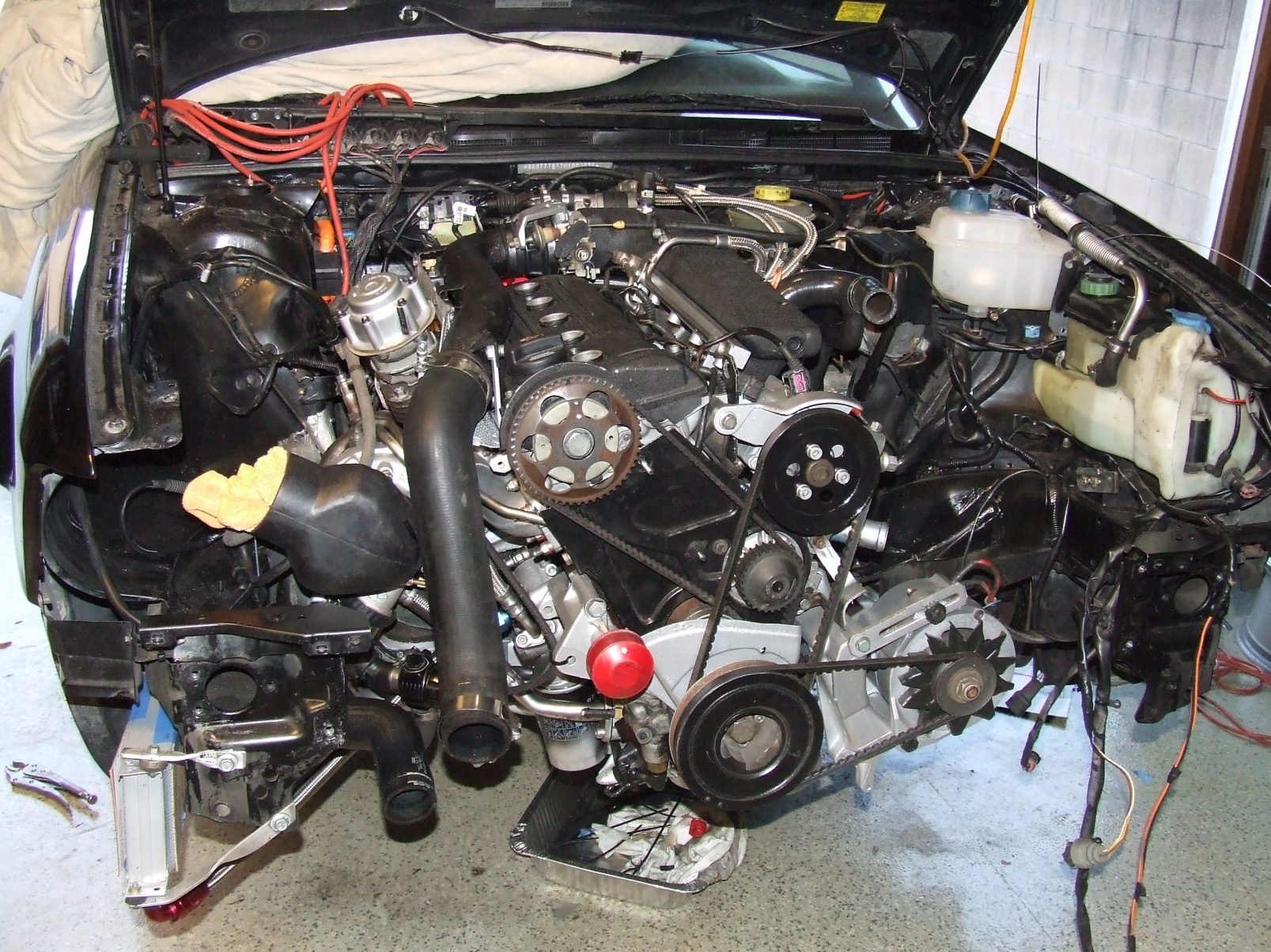

Ive cut the v-band off the volvo turbo and welded the stock k24 outlet

Weld looks great - nice thread!

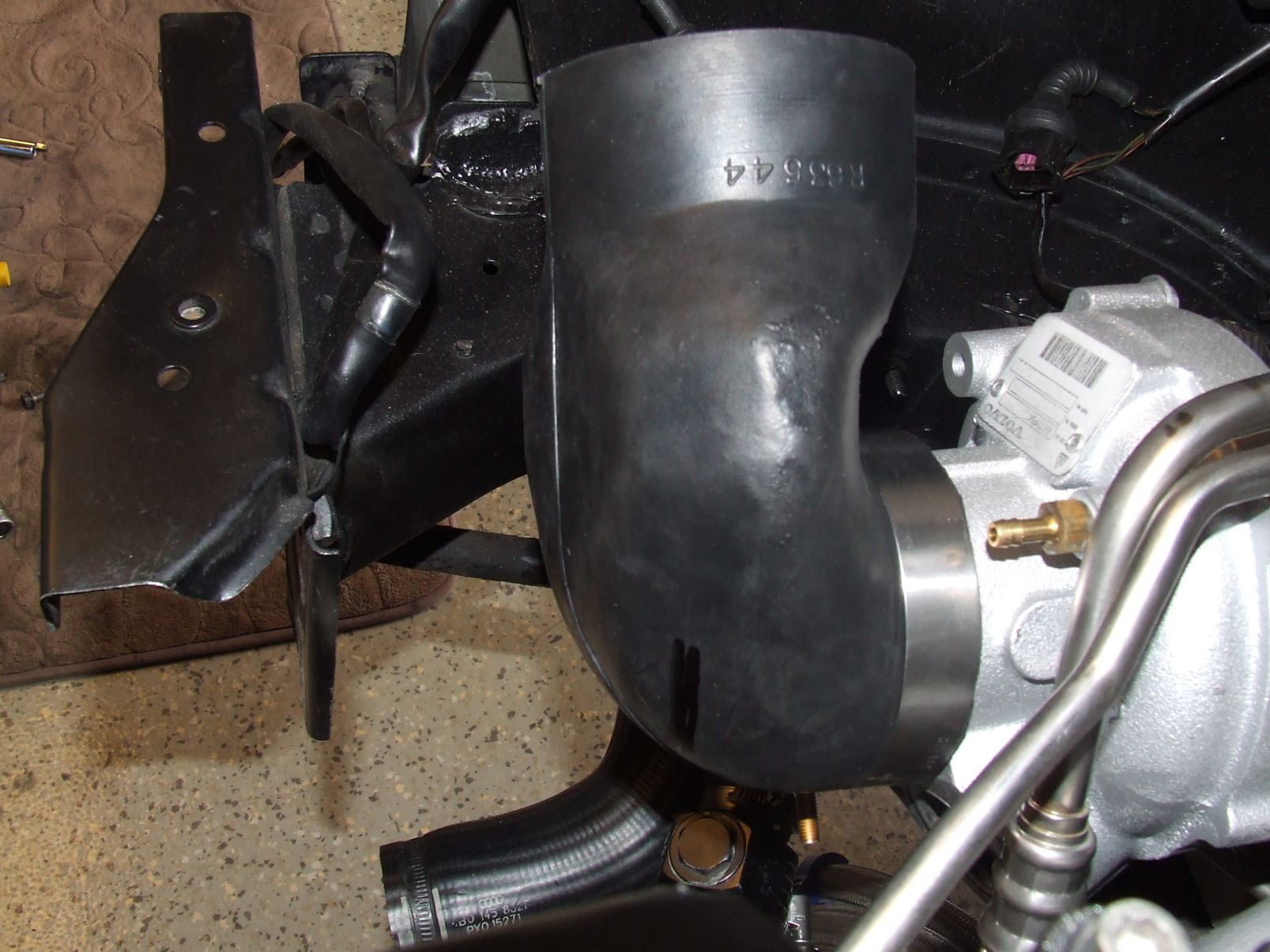

made some progress:
i had to play a lot till that cobra head was fitting
however i ordered some low profile mushroom filter, i think i will go with that.

I would go cobra head and real filter like the aem dry over those crappy mushroom filters. They suck and tend to fall apart
Posts: 2144
Re: another S2 conversion
I have run a lot of cobra heads and they work great. No restriction.
When Eric was installing his Volvo K24, he had me turn down the inlet so he could use a smaller cobra head to clear everything.

DE80q wrote:When Eric was installing his Volvo K24, he had me turn down the inlet so he could use a smaller cobra head to clear everything.
yes, i've read that, but its too late now. i wont remove it. maybe later

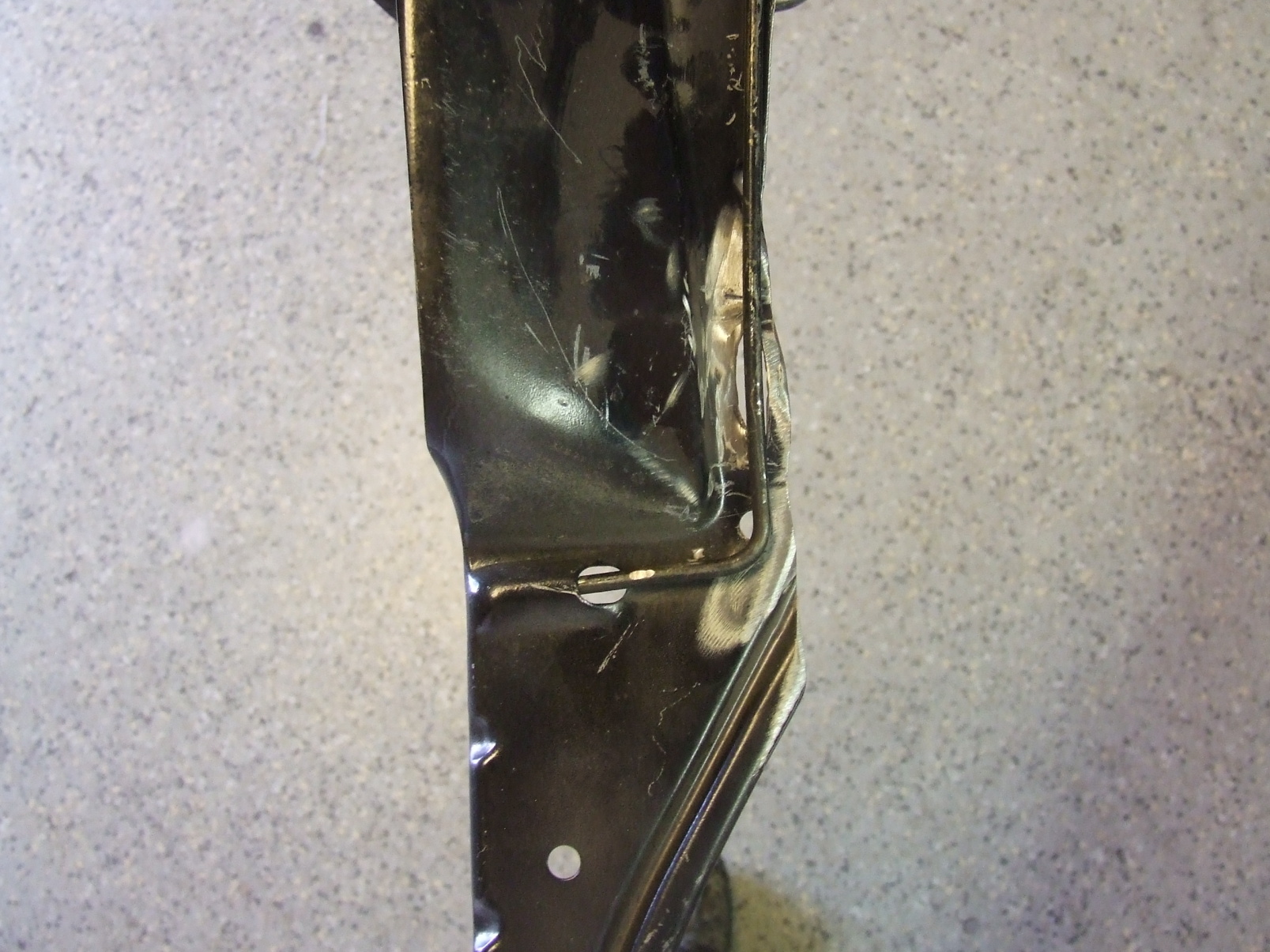

the interesting thing is, David had the same turbo, exhaust manifold, and cobra head, and he had no problem. mine was an inch longer, i had to trim from the cobra head and from the passenger side frame

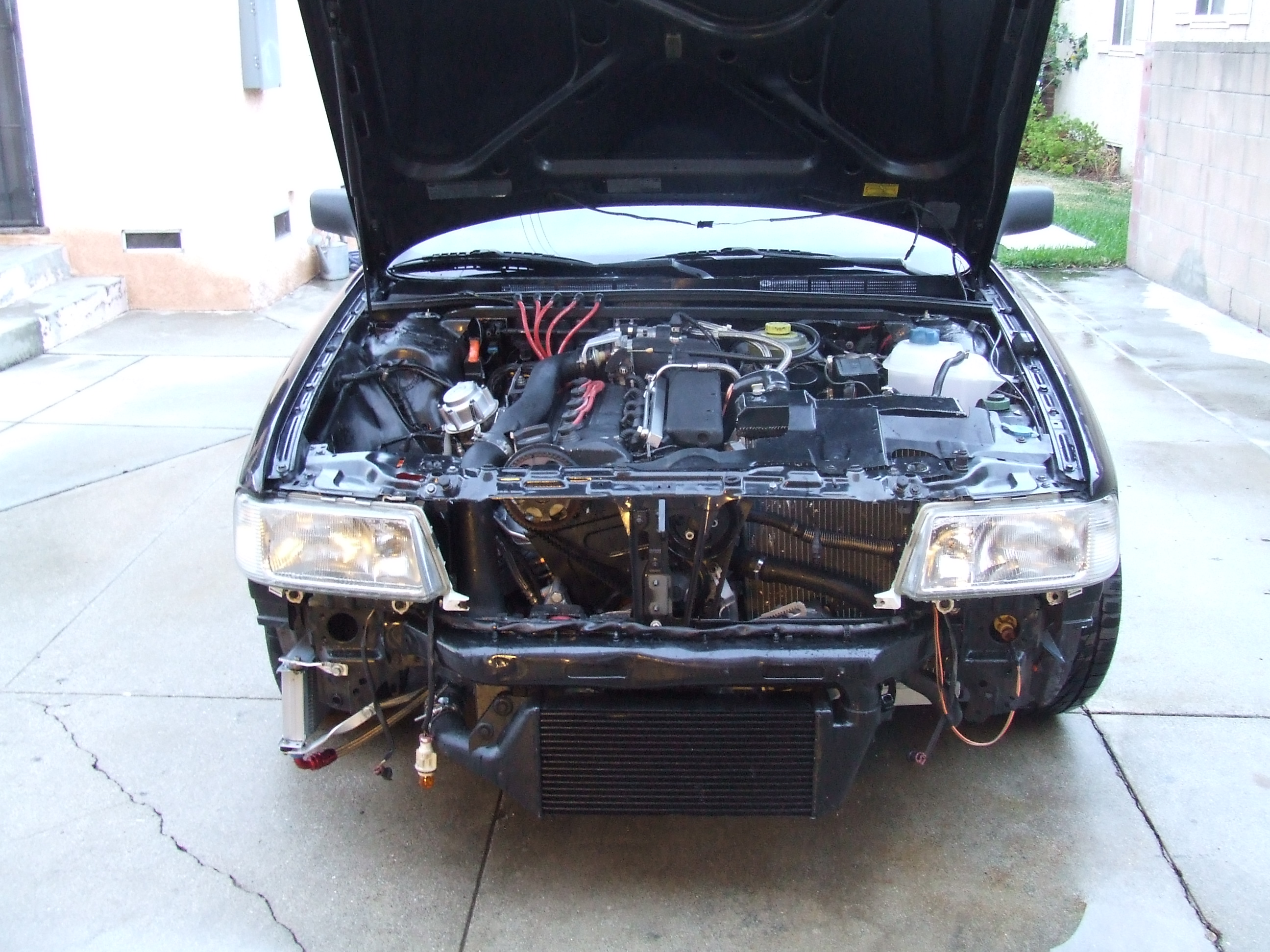

After installing the vems.... had to find the spark, timing, too much fuel.
Of course not much luck. so at this point i gave up. I knew i cant start it and i only can do damage.
100000x to my good friend mr. greg w. he towed my car from LA to Vegas.
Once we were at Iroz Motorsport, I had high hopes
Prof. Dr, Phd Guru Wizzard Hank started the car in 20mins.
Thank you for Collin and Josh, they are excellent guys and to Marc S. for the phone support!!!
We had a problem with my ecu, #5 injector was spraying whenever the fuel pump was on...
Hank's and Marc's skill solved the problem, again.
Car is running, and registered.
Need to adress few things before next week trip to BBQ:
Alignment, address some oil leak, weird brake sizing, maybe bad MC?
