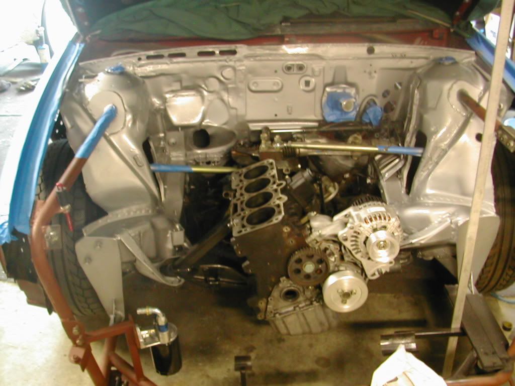

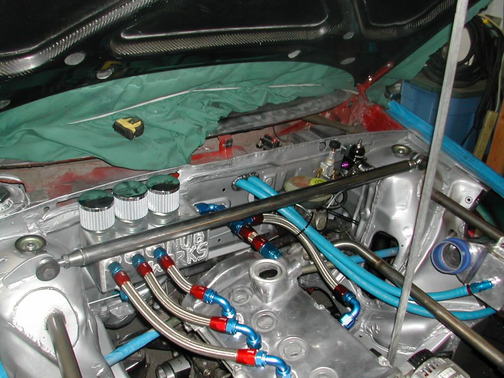

got the AWIC system finalized.
got the engine bay painted up all nice and pretty. was all black. then Derek comes by to pick up the TIG machine and brings a good point to the table; lighter colors set things off and make it brighter and easier to see. A LA rally car stylez.... also can spot stuff like leaks easier against a lighter backdrop as well.
have more stuff completed, just not pictured yet. floor of car will be black. interior silver. bay silver. cage and tube work dark bronze.....

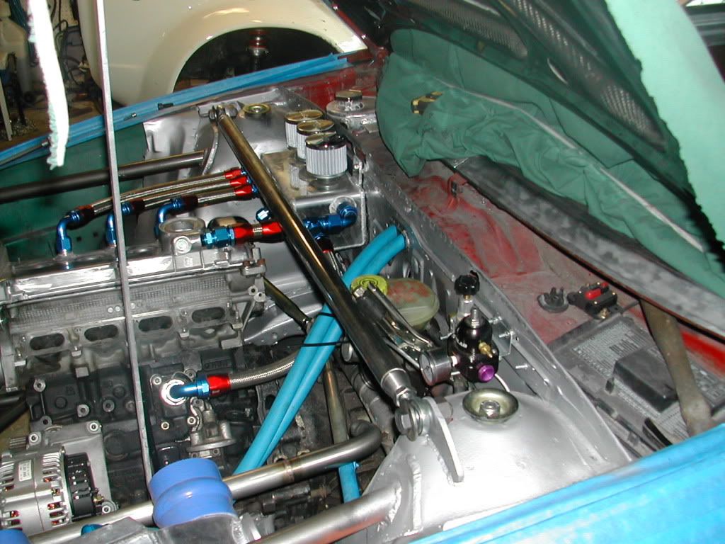

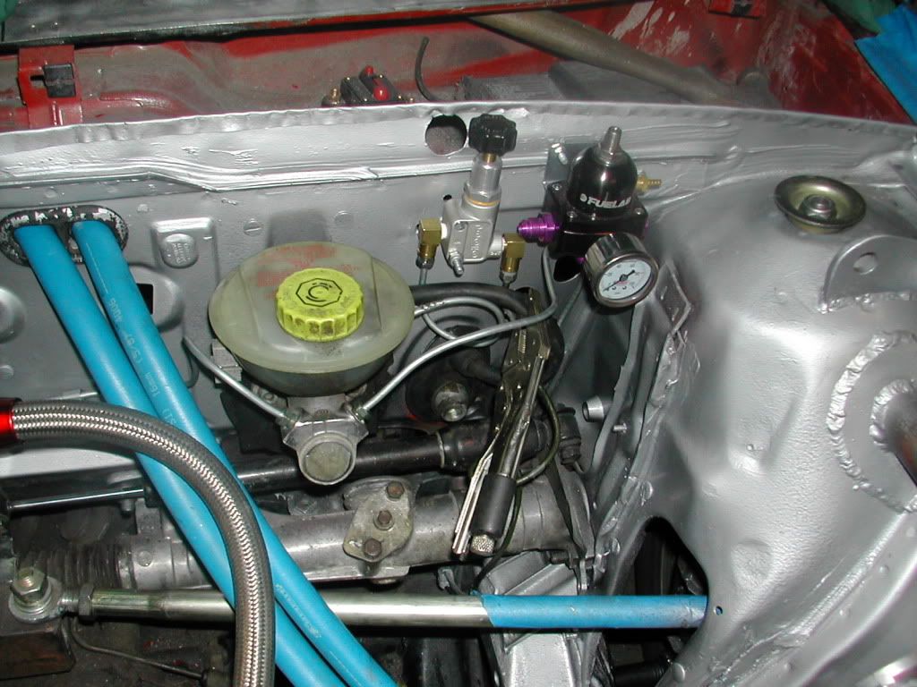

oh yeah, forgot. the prop valve is mounted and plumbed in, as well. found some slick little 1/8" npt male (for the Wilwood valve) to 10mm european standard bubble flare socket adapters. can have for straight or 90 degree. made that part super easy to accomplish.
also put on the tabs for my strut tower bar. DOM tubing is in the mail. using some spare 5/8" Heims ends i have. i ordered extras, or changed my mind on something i guess. and spare stuff does not hurt anyways....
also, i ran the AWIC pump, it flows really well for what it is. ran thru the core and back to res. i like it.

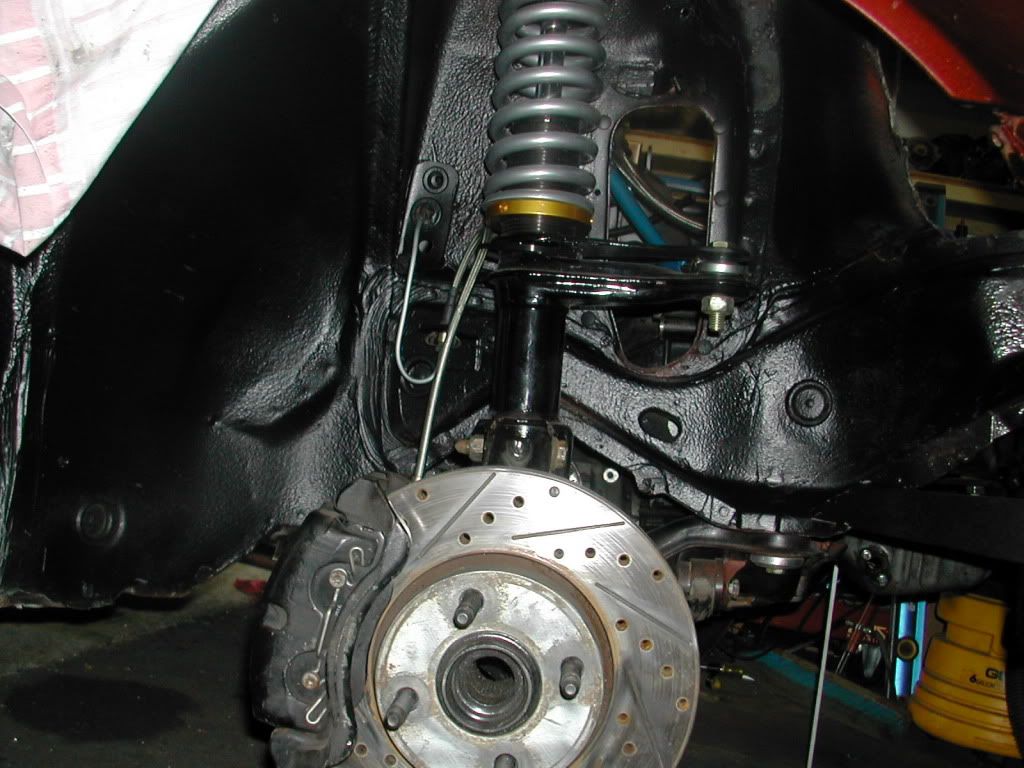

finally did the complete front suspension/brakes/spindles, etc. COMPLETED. (except for pass front axle, i forgot it HAHA). once i toss in the welded diff, driveline, and clutch slave line, the drivetrain is COMPLETED. still have to replace all the bolts for the subframe and control arms with new. and make the spacer for the rear tie rods. torque the axles studs/nuts too.
made new brake lines for both front sides. bled brakes in ~15 minutes maybe? Motive and Speedi-bleeders rock. yes they surely do.
wired in the "Aaron-harness" to the relay panel. checked functions of switches for operation. all is well.

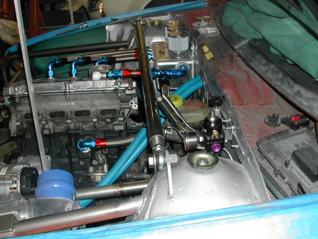

NHRA Gen Regs Rulebook wrote:[/quote]1:5 FUEL SYSTEMSaudifreakjim wrote:Isn't there a 6" from the firewall rule for fuel pressure regulators? I got dinged for it at the strip one day. I never looked up the rule, but check it out.
Location: All fuel tanks, lines, pumps, valves, etc. must be outside
of the driver’s compartment and within the confines of the frame
and/or steel body. Cool cans, fuel-distribution blocks, etc. must be
located at least 6 inches forward of the flywheel/bellhousing area
on rear-wheel-drive (RWD) cars, and on opposite side of
flywheel/bellhousing area on front-wheel-drive (FWD) cars. Fuelpressure-
gauge isolators, with steel-braided line, may be mounted
on firewall.[/quote]
so the way i read it is that if it has SS braided lines its ok. they do not have ruling on an AWD car there.... but it says forward of the FW/bellhousing area on RWD, which we can "say" would most be like our setups.
with the experiences i have with NHRA, if they "specifically say it" cant be done, then it cant be done. but if they dont "specifically" say it, then its fair game where common sense prevails....
i guess we will see when i go to run it... thanks for thinkin of me
and FWIW, the rabbit FPR is on the trans side of the car and i have never encountered anything about it.
but i am gonna look deeper into it for sure.... *EDIT* i could find nothing that may prevent me from running it the way it is. but if needed, i could change it around pretty quick. seems someone ordered about 20 fittings extra when he designed the fuel system :slap: (DUMBASS!!!)

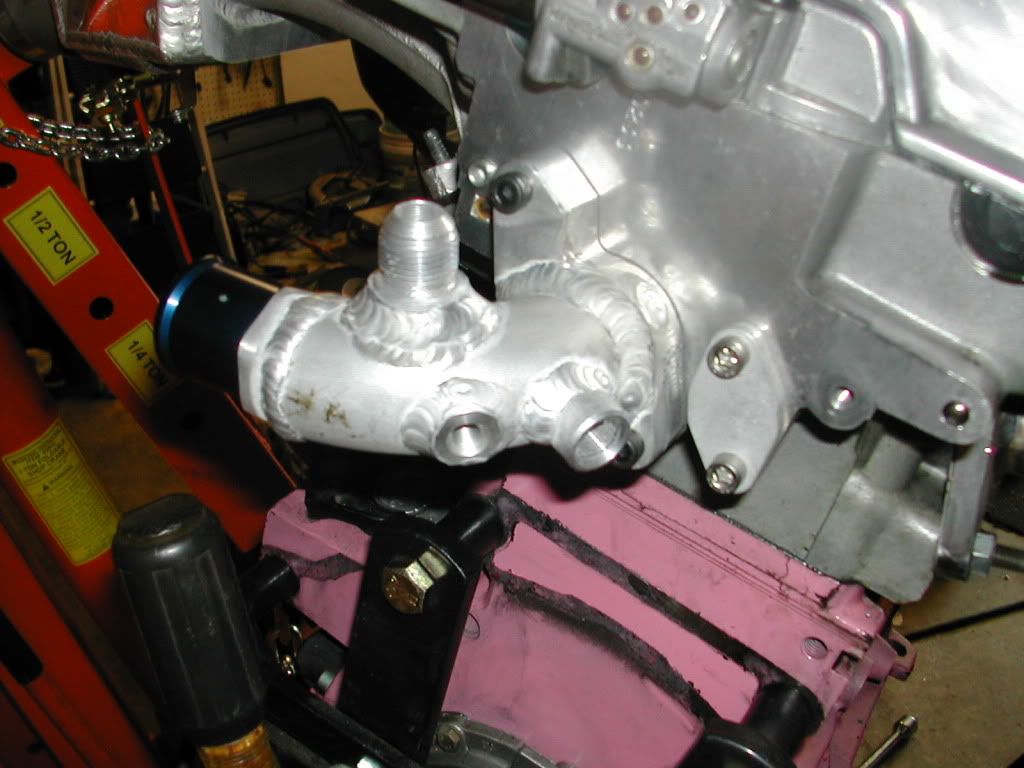

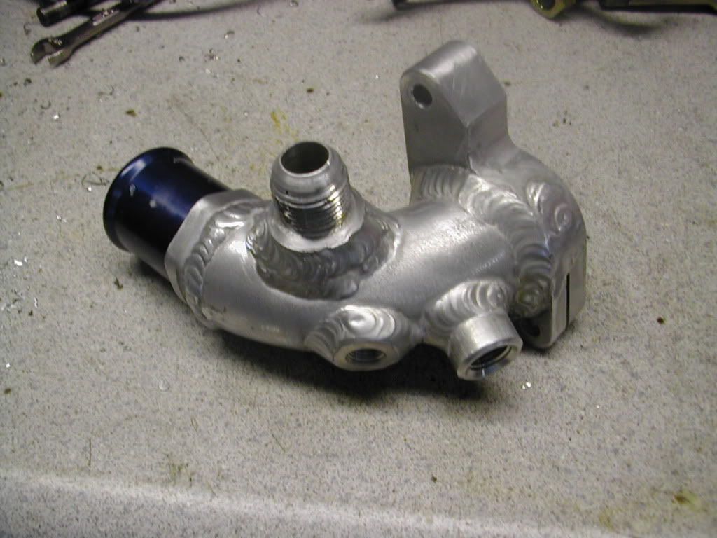

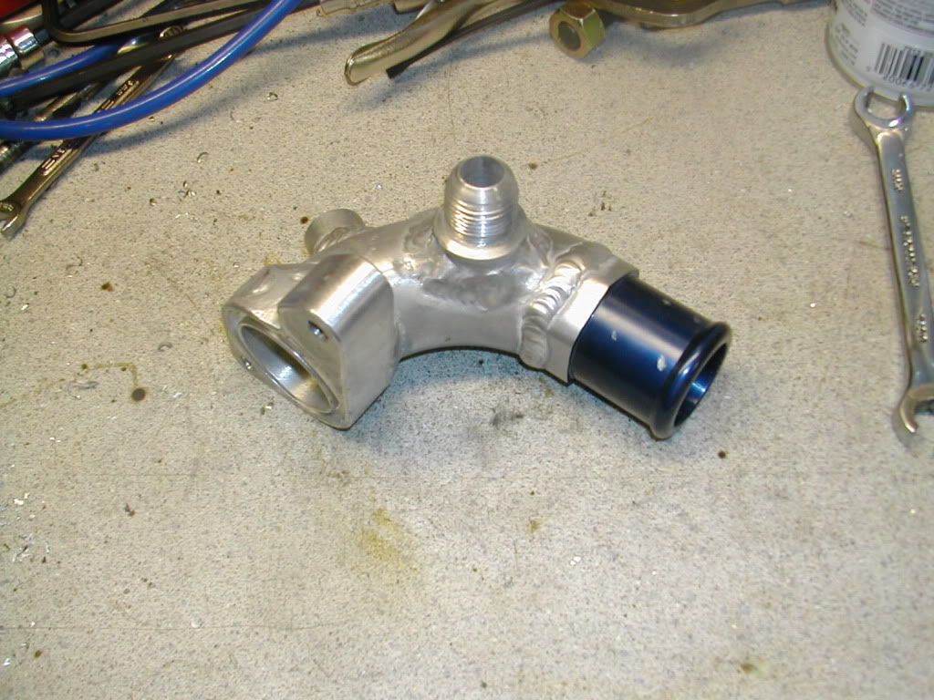

my welder buddy just finished this up for me. the coolant housing off the end of the head is plastic from factory and i do not need all the ports nor do i use factory style sensors. so we made one up using a 42dd flange and some other parts/bungs to suit my needs. this guy can weld, too....

Ha! Nice! I need a similar water neck work myself...

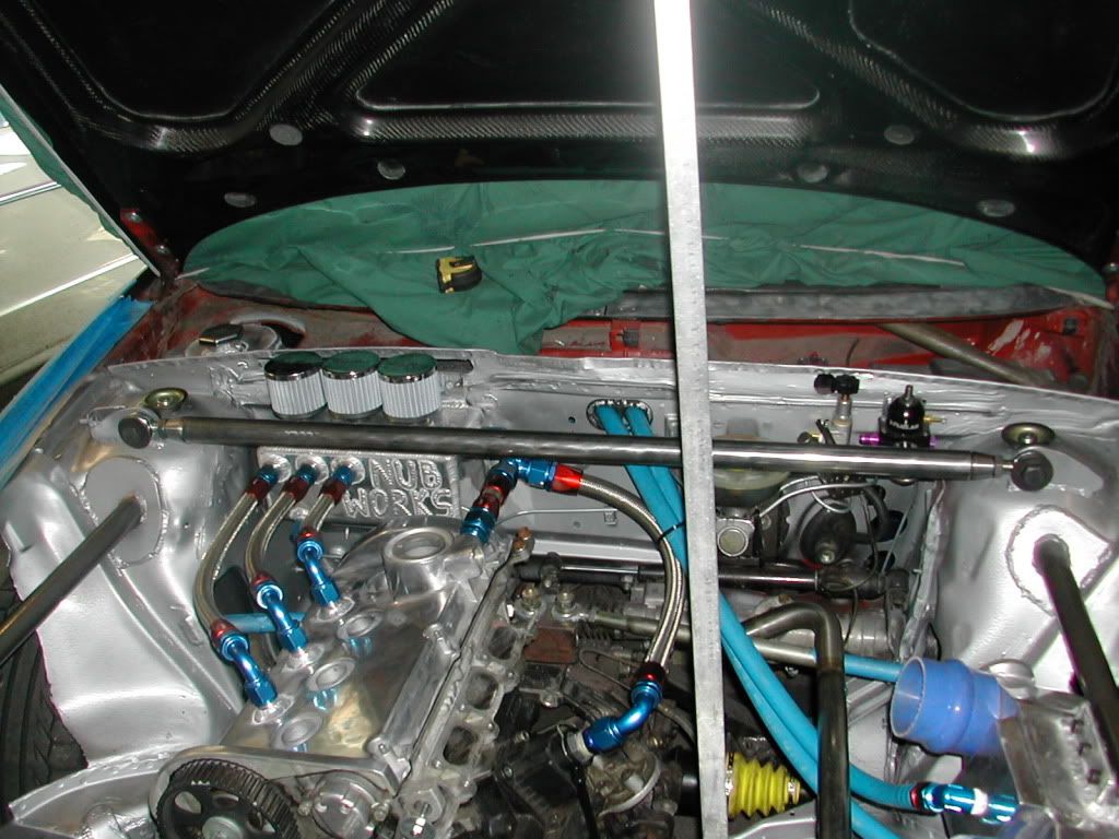

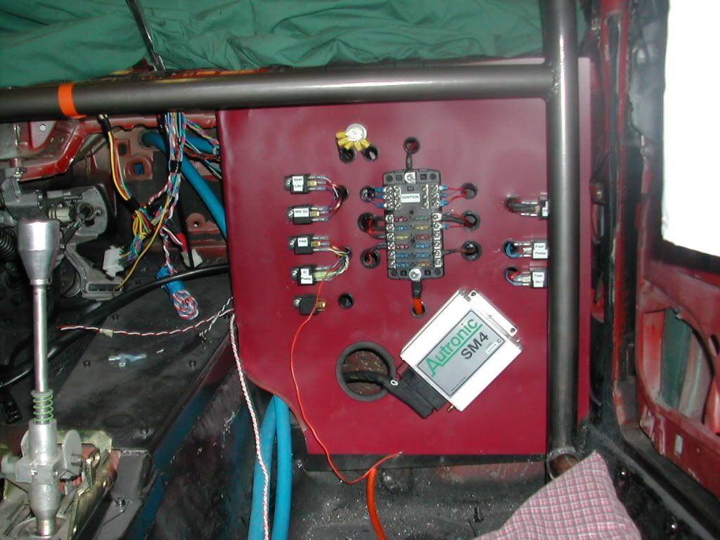

got the SM4 harness almost completely installed.... just gotta figure the VSS and the TPS. the TPS i am just going to mimic the rabbit, its the same thing there. VSS not so much. everything else is plug and play.
and my strut bar is completed. i like to use things i have laying around first, and i happened to have a few 5/8" Heims sets extra. i sold one pair right/left to another Canada MG'r awhile back to help him with ship & duty.... so i had one pair L/R left. well, its not extra anymore.
its burly, its not going anywhere. 1/4" (my favorite
) plate for the tabs, and .120 wall 1.25 DOM tube. OHHHH YEAHHHHH. finished it off with some grade 8 bolts with heavy hex nuts and structural plate washer. even if the Heim end failed it cant pull out of the mount.

oh yes, did some welding on the pass side door sill bar. its completed. will fit the door bar this week. wont put it in til its "time" to, as it sucks to work around.
and also, i think it would be sweet to triangulate the strut bar to the two bars that run off the strut tower and down to the front cross-bar. but then it would be pointless to have the Heims ends on it as it would be permanent in one place. i guess i could "set it and forget it" huh? we'll see if i get bored again LOL.
