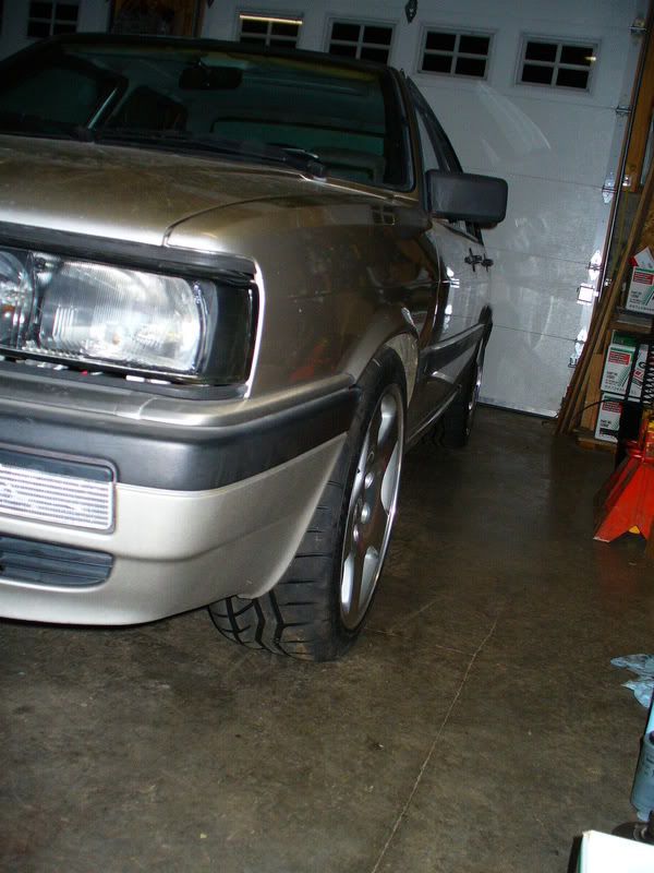

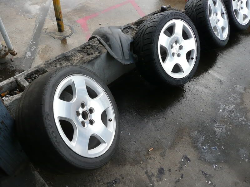

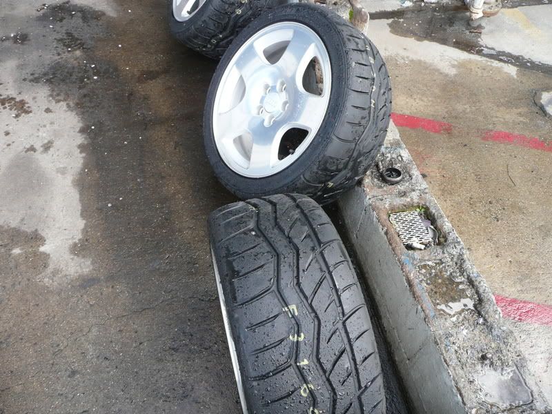

WAAAHOOOOO got me some new Tahrs!! and good ones too 8)
good news is that these 235/40/17 falken azenis' are the same height as the well used toyo RA1, and the same width, so all my clearancing and such should pay off nicely 8) only bummer is that i gotta wait until next weekend when i get home to mount them :(

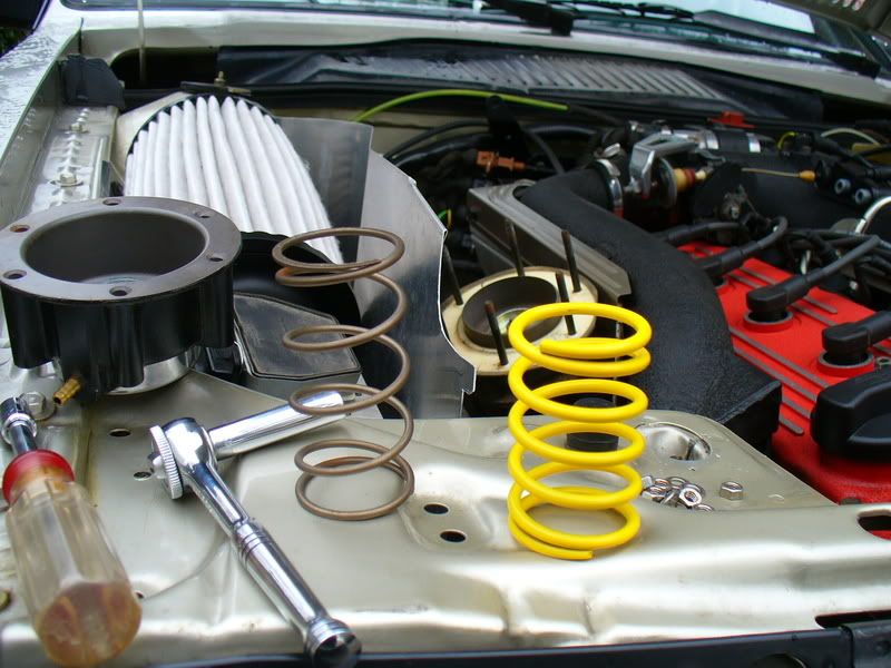

i also got my yellow spring for the wastegate, and it's boostin hard :P 27psi hard... haha. i was watching it closely and backed out right away but i gotta get it down to 24psi max overboost methinks. i guess pretty soon i better get my new turbo on it.. and header, and exhaust.. and IM spacer so much to do ! :P

[quote="derracuda"]
:o Are you sure that's not a coilover helper spring? :P

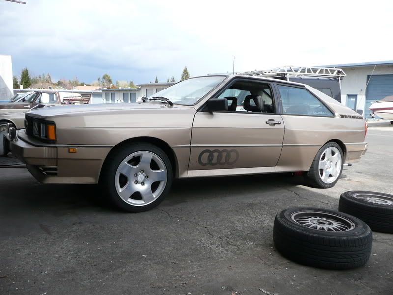

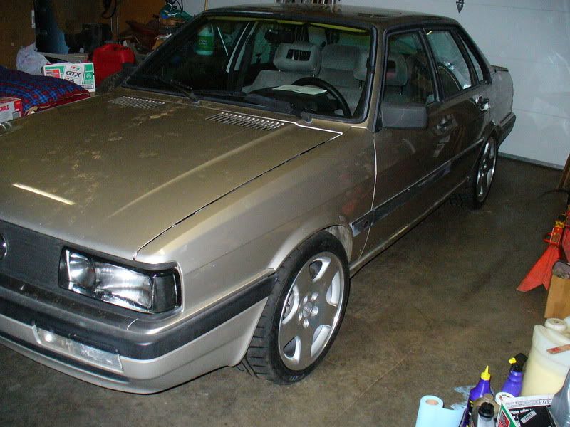

just for kicks we threw the wheels and tires on my friends URQ today. they need to be black, and the car needs to be lowered :P
quattro87
Posts: 1000
Post by quattro87 »
Those 235/40/17's look good on the Urq. They don't look like they would have any problem at all with clearance. Maybe when the car is lowered they would. How wide are the rims?
audibeans
Post by audibeans »
Got any tricks to get the wastegate spring on without taking apart the whole thing?
Tried the C-clamp, ....busted knuckles...:(

RSCoupe wrote:
Nice spring Derek, I've one of them too. I need it for that 2 bar that I am running now.

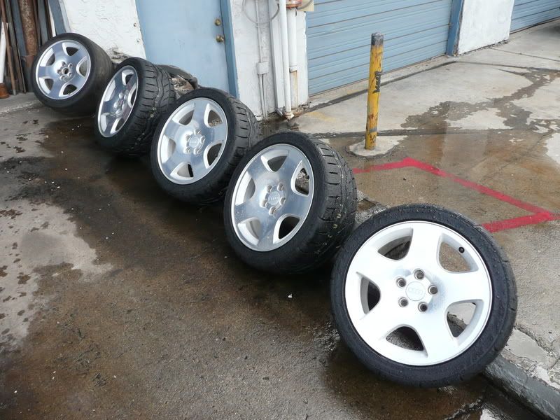

quattro87 wrote:Those 235/40/17's look good on the Urq. They don't look like they would have any problem at all with clearance. Maybe when the car is lowered they would. How wide are the rims?
no clearance problems with it now...
rims are 17x8 ET48 A8 rims.. of which i have 5 for sale ;) the finishes are rough, but otherwise fine.
audibeans... dude, what are you undoing?! haha. there's six little 8mm nuts holding the WG cap on... no C-clamps needed :P
audibeans
Post by audibeans »
derracuda wrote:audibeans... dude, what are you undoing?! haha. there's six little 8mm nuts holding the WG cap on... no C-clamps needed :P
maybe the spring I got is too long....have to push way down on the cap, cant get the 8mm nuts started....

20v90q
Post by 20v90q »
Where did you get that yellow spring? What "Bar" is it?
derracuda
Post by derracuda »
i got it from ben swann, and i can't remember if it's a 1.9 or 2bar spring. i just ordered it :P
oldsklaudidub
Post by oldsklaudidub »
derracuda wrote:i got it from ben swann, and i can't remember if it's a 1.9 or 2bar spring. i just ordered it :P
It is that same spring he sent me and its what i am using with the prototype 2 T chip he made.
"Wastegate spring - 1.8 bar spring fits most I5 Audi wastegates"
20v90q
Post by 20v90q »
What's better, this or the 1.9 Bar 034 spring?

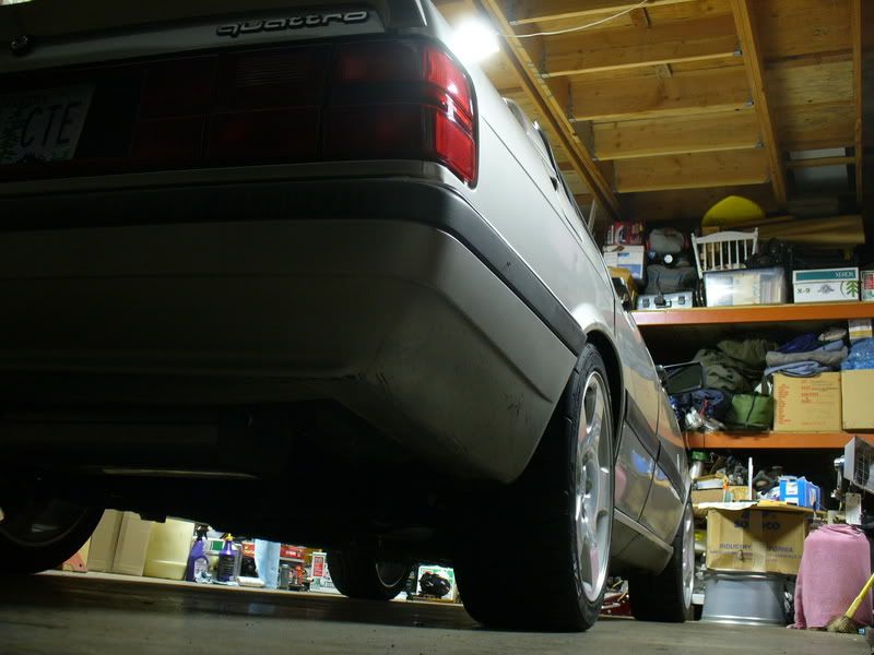

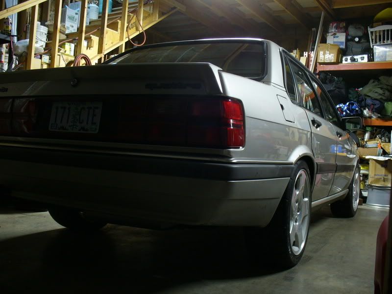

derracuda
Post by derracuda »
yesssssssssssss
(pardon the dirt and cat prints, been meaning to kill those things off)

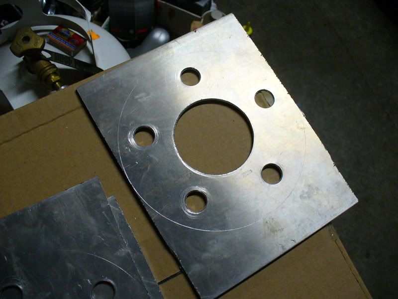

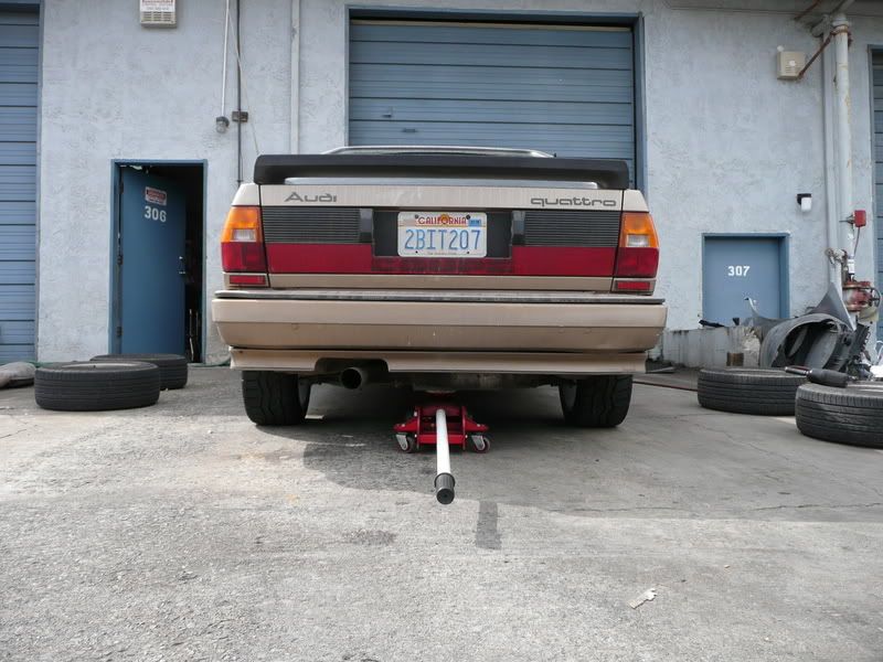

the only thing i need to do is finish cutting out my 3-4mm spacers so that the rear tires have a little more clearance between the parts they are jjuuuuust barely touching :P
i've been waiting a loooong time to fit 235's under a 4kq... and now that i've have 265's in my hands, they 235's look small! :P :( oh well, these suckers are grippy, and 20mm more rubber will make a world of difference for this car 8)
