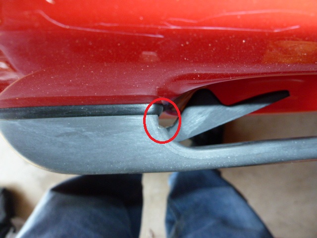

I have a tip for the door handles... the autohause ones suck, and the gaskets from them are unuseable. When I replaced mine I used their handles and tried their gaskets but the gaskets are too soft and already deformed when they get shipped and they don't stay in place because they don't even fit the handle. Luckily at the time factory gaskets were still available so I ordered up four of each. Had to trim the door handles so they fit and it turned out alright.

For some reason the larger gaskets I got fit really well and appear to be OEM-ish, but the smaller ones are awful. I have an order from the dealership en route with the OEM gaskets. I just need to rekey the drivers tumbler and wait for a few more parts and the door handles should be fixed.
