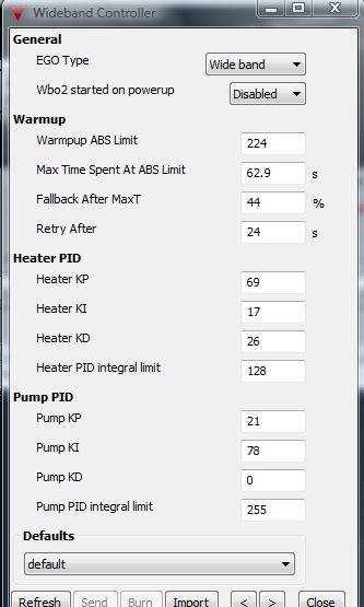

Well, I spoke too soon. For some reason my WBO2 is not working. I thought it just needed recalibration but it is not heating...
Otherwise, my false trigger errors are gone and idle is much better!
Posts: 1586
Re: Firmware Update?
Mcstiff wrote:Well, I spoke too soon. For some reason my WBO2 is not working. I thought it just needed recalibration but it is not heating...
go to your wideband page and select the dropdown to fill with defaults for the heater.
Marc, I was using "default" which matches my old settings. If I choose "WBO2-Heater-PID" it changes integral limit from 128 to 129 and nothing else. :ty:
