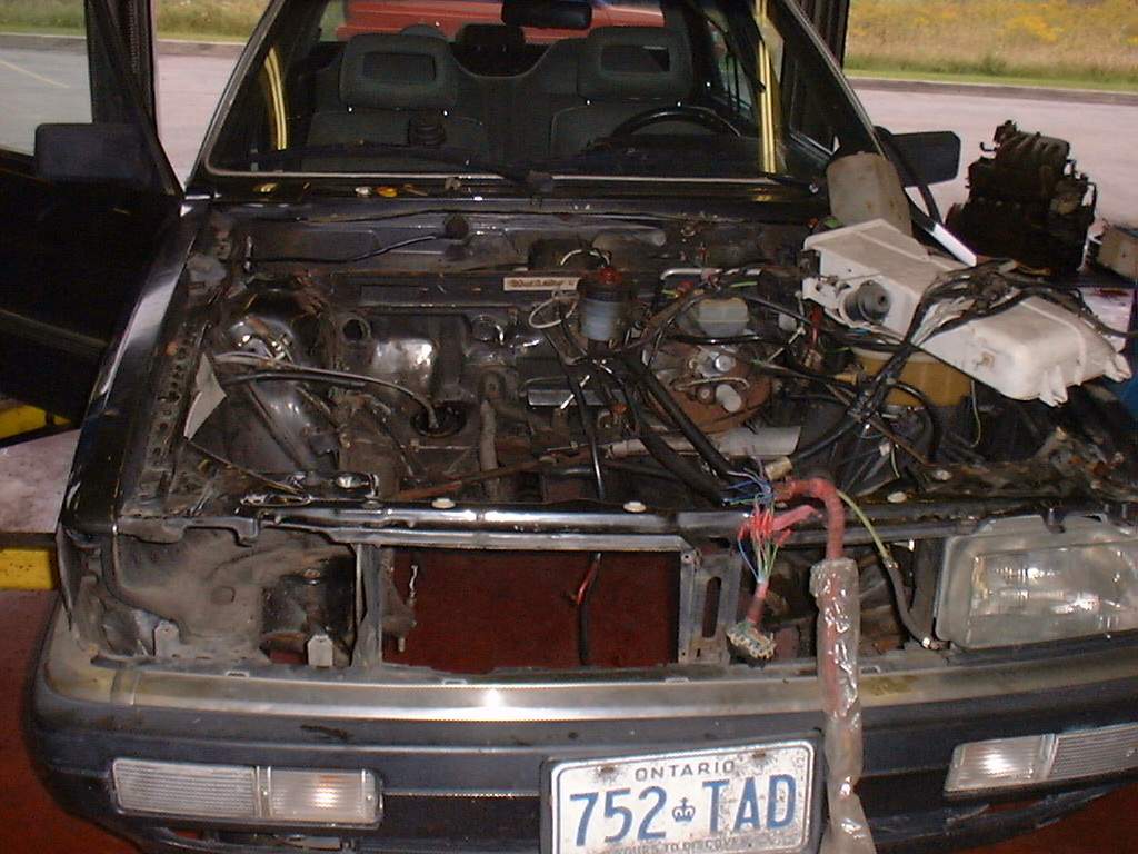

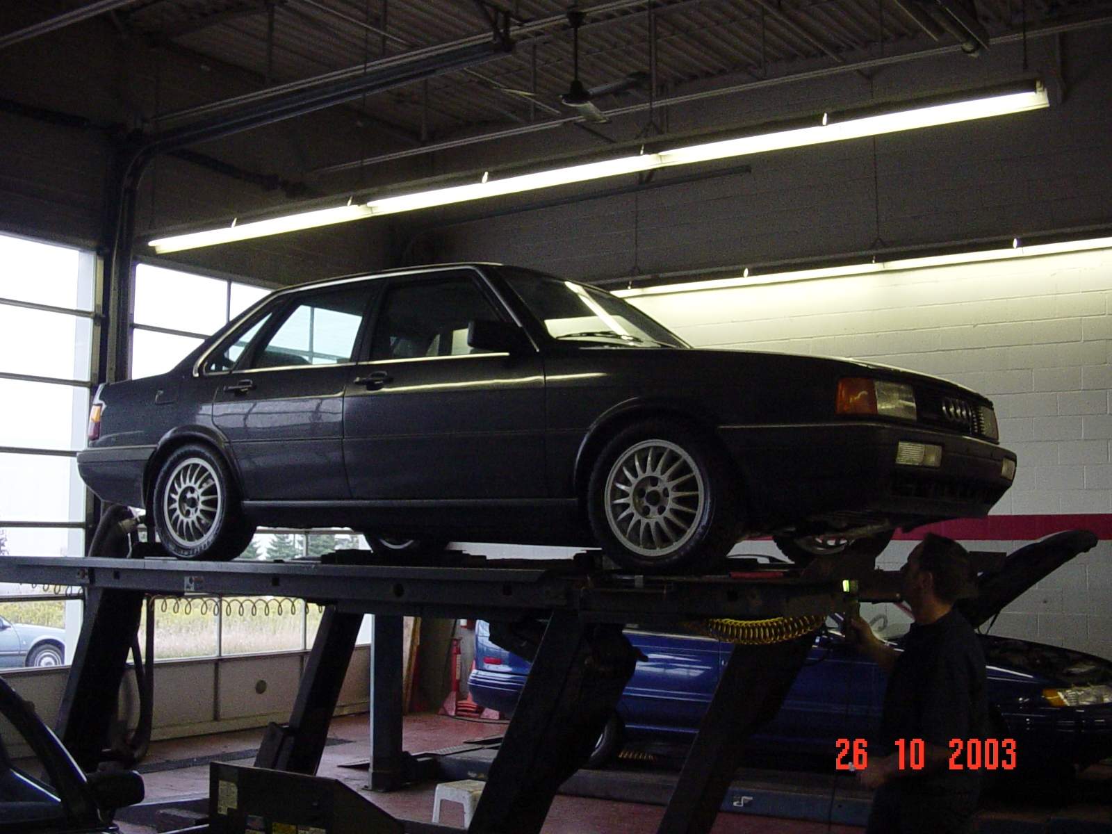

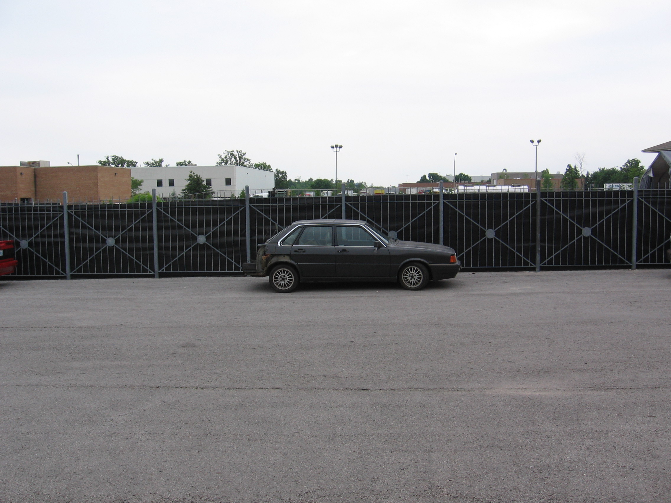

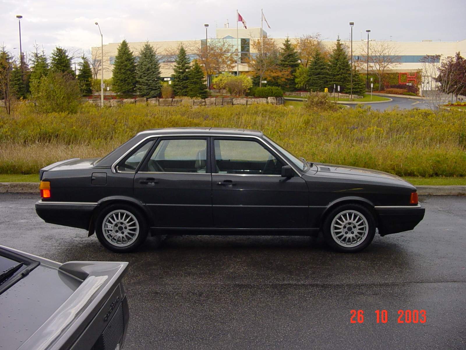

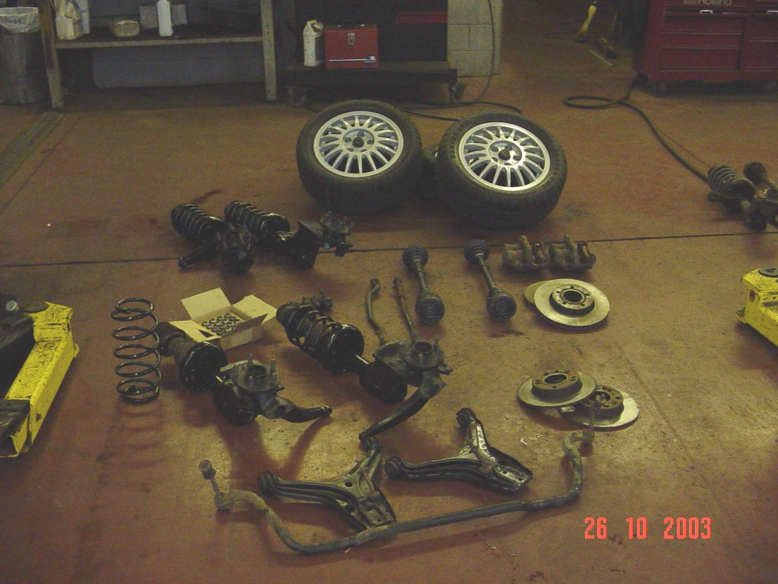

The day I got my first quattro. IMO there's something special about type 85's
highlander69
Posts: 279
Re: Craig's Sport quattro build
Post by highlander69 »
5 bolt converstion being done on the old girl.
highlander69
Posts: 279

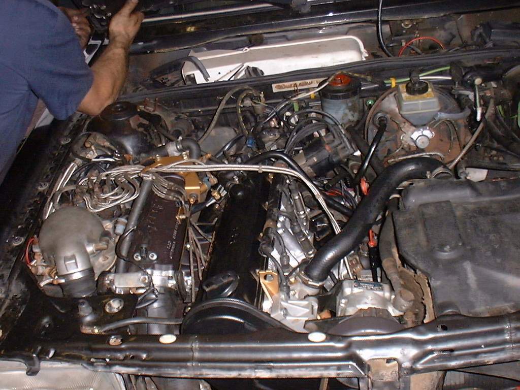

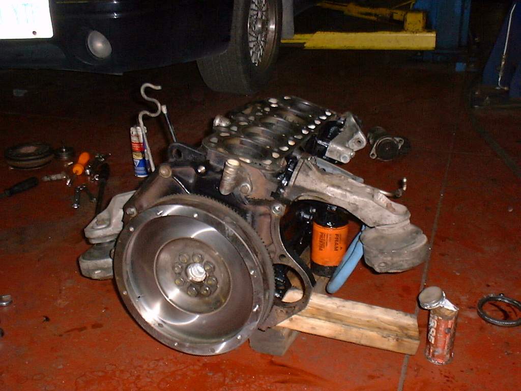

Time for more power. Turbo Transplant.
MC with a chipped computer and 3" exhaust .
It really transformed the car. Other than the gearing being too short, this car was a blast
to drive.

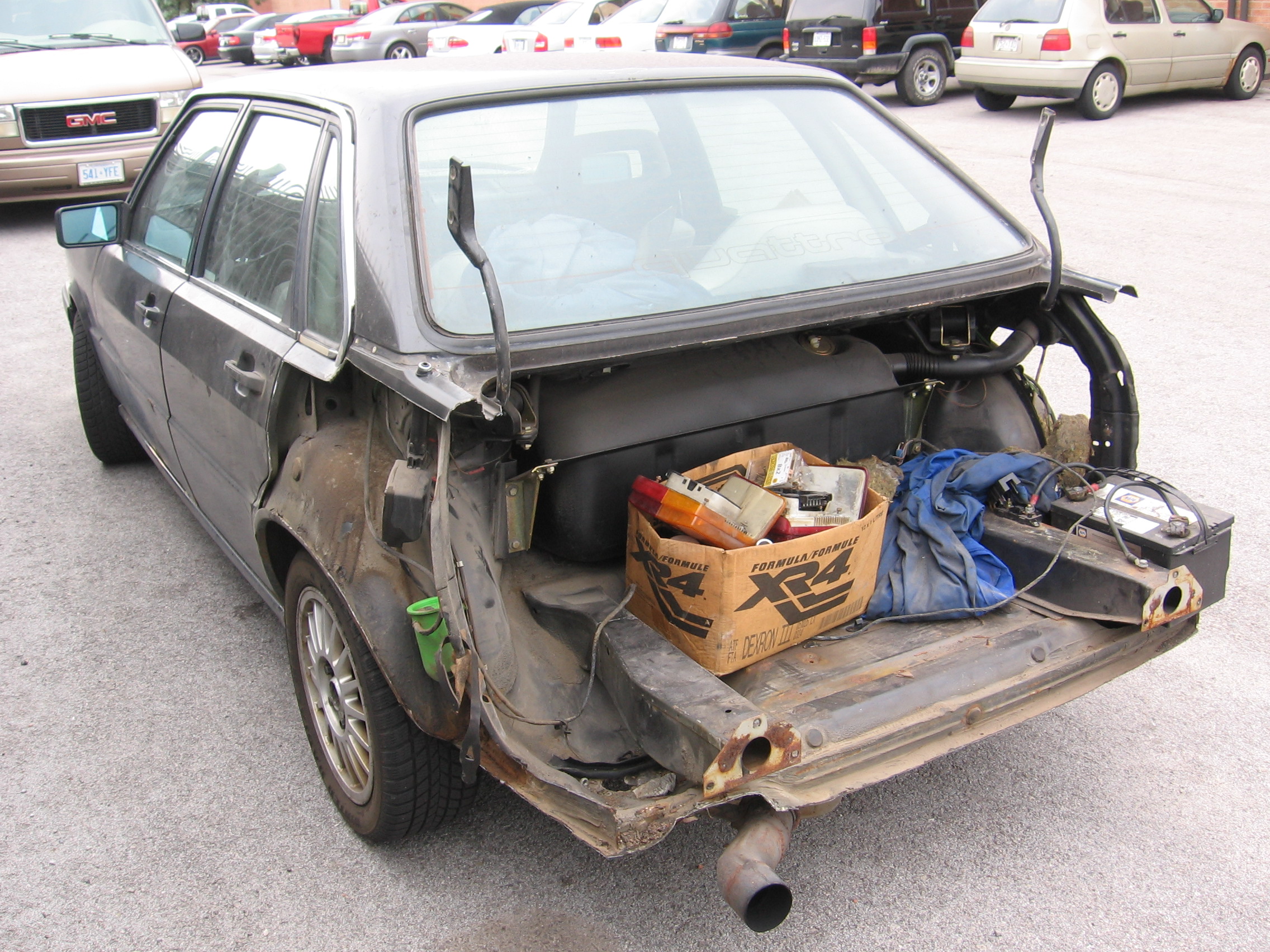

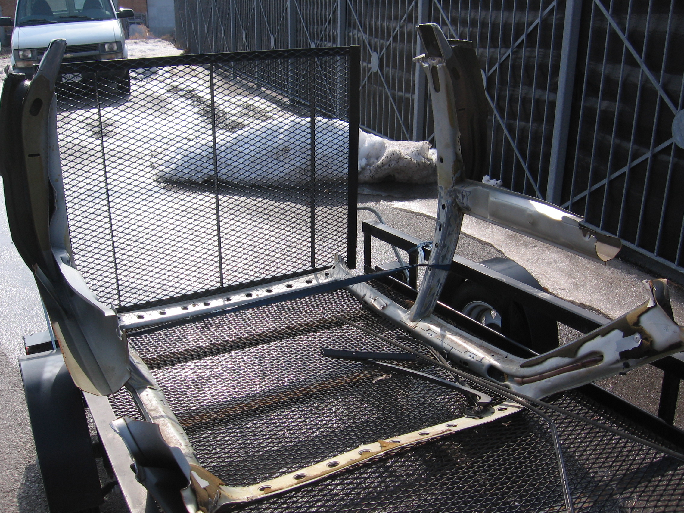

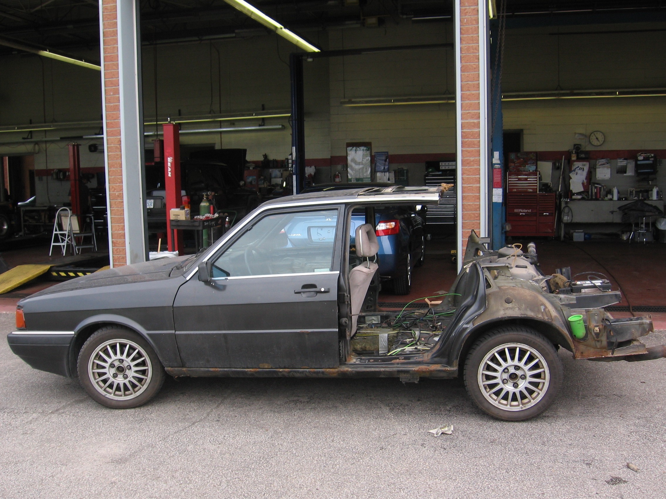

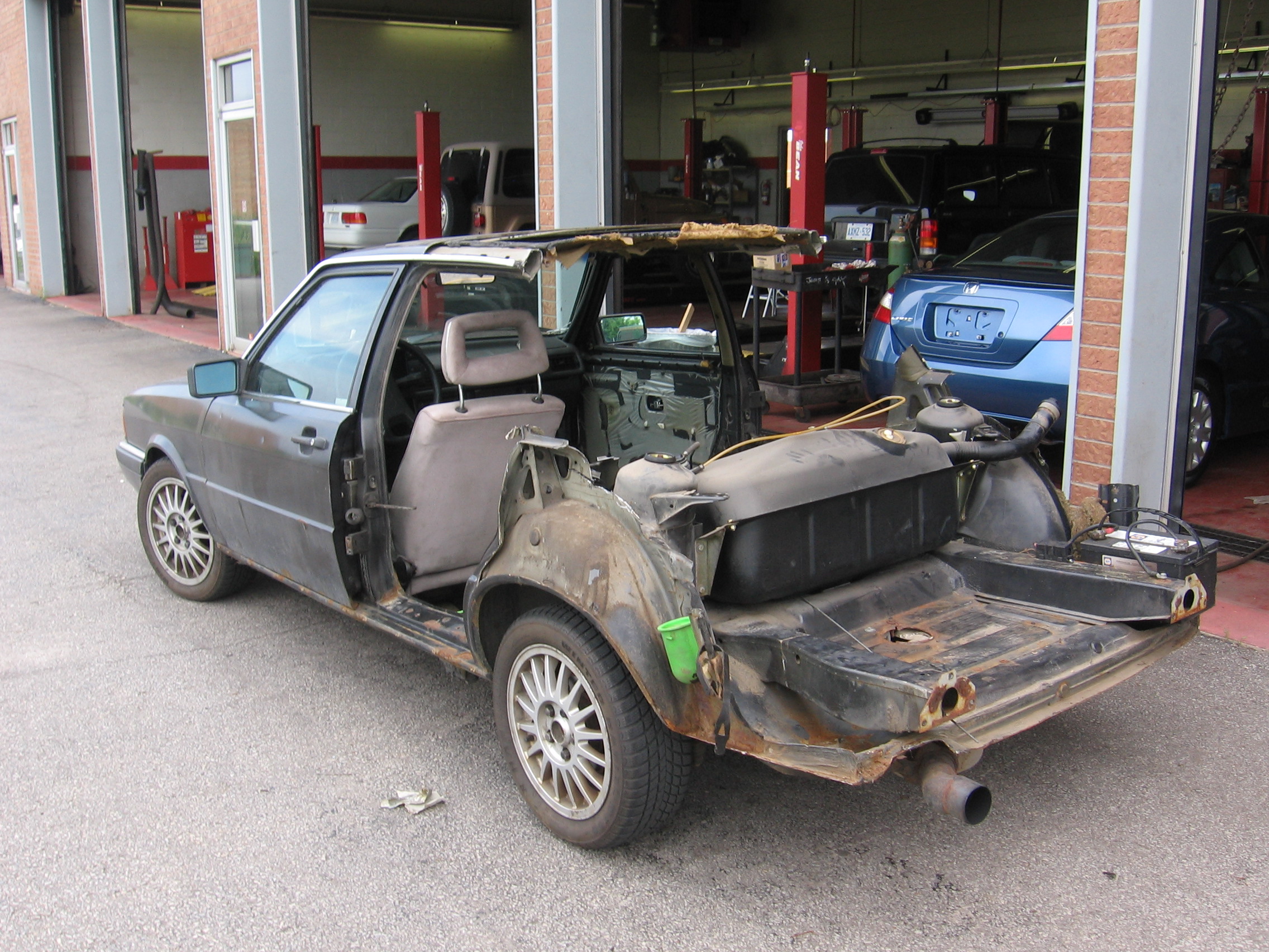

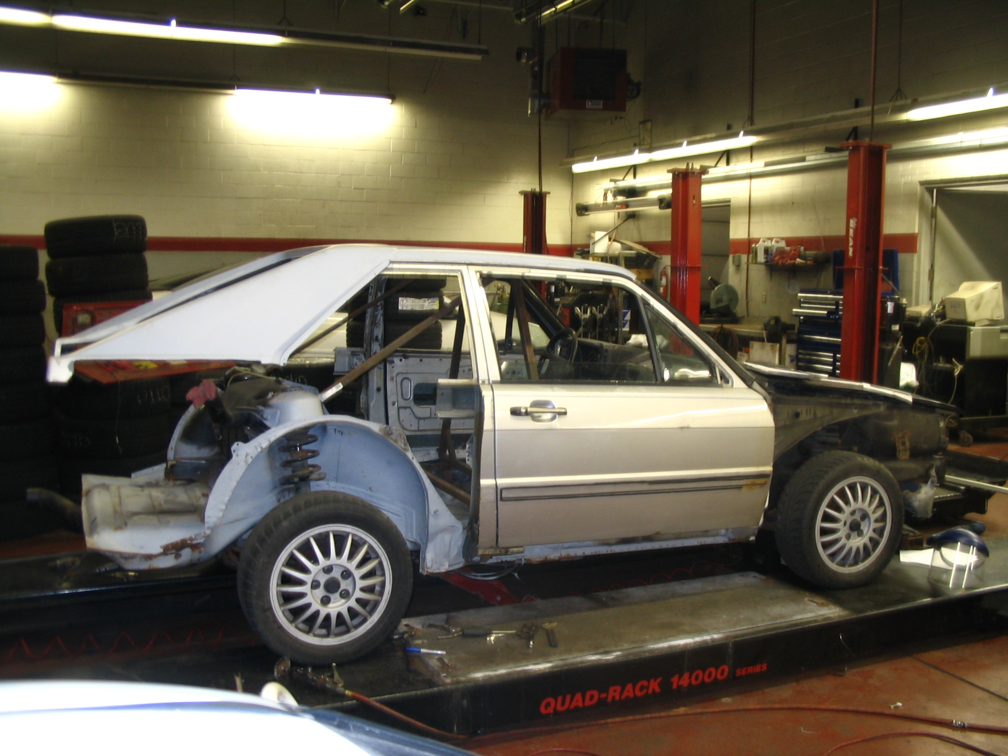

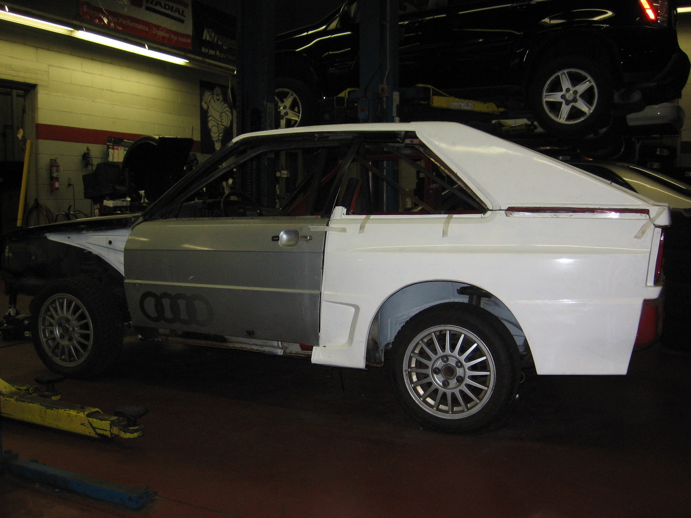

The sport build begins.
Trunk cut off. Here I'm gettng my game plan together.
Why use a 4000 quattro 4 door as a build foundation for a coupe 2 door build ?
A few reasons:
I don't have a urq to cut up, and would feel bad cutting one up in the first place.
North America didn't get type 85 coupe quatto's.
By using the 4000 as a donor I already have the correct windshield angle that the sport quattro uses.
This way I won't have any weld joins at the bottom of the windshield pillar. If I had have been using
a coupe body I would have had to cut the whole roof off.
I decided to use the complete 4000 quattro floor pan minus the 320mm of course.
Going this route presents a few problems. For one it has 4 doors. Also I need to source a coupe rear end.
IMO the best way to build a sport quattro is to use a 4000 quattro front mated to a urq rear end.
Like I said I didn't have a urq to cut up, so a coupe gt rear body sheet metal would have to be sourced.
The next piece of the puzzle would be sourcing a 2 door 4000, Not a easy task in North America.
This would turn out to be alot harder than I first thought.
So basically I needed parts from 3 cars to make 1 sport quattro. :bangshead: :nuts:
She looks so lonely sitting there!!
Craig 001.jpg (892.49 KiB) Viewed 46944 times

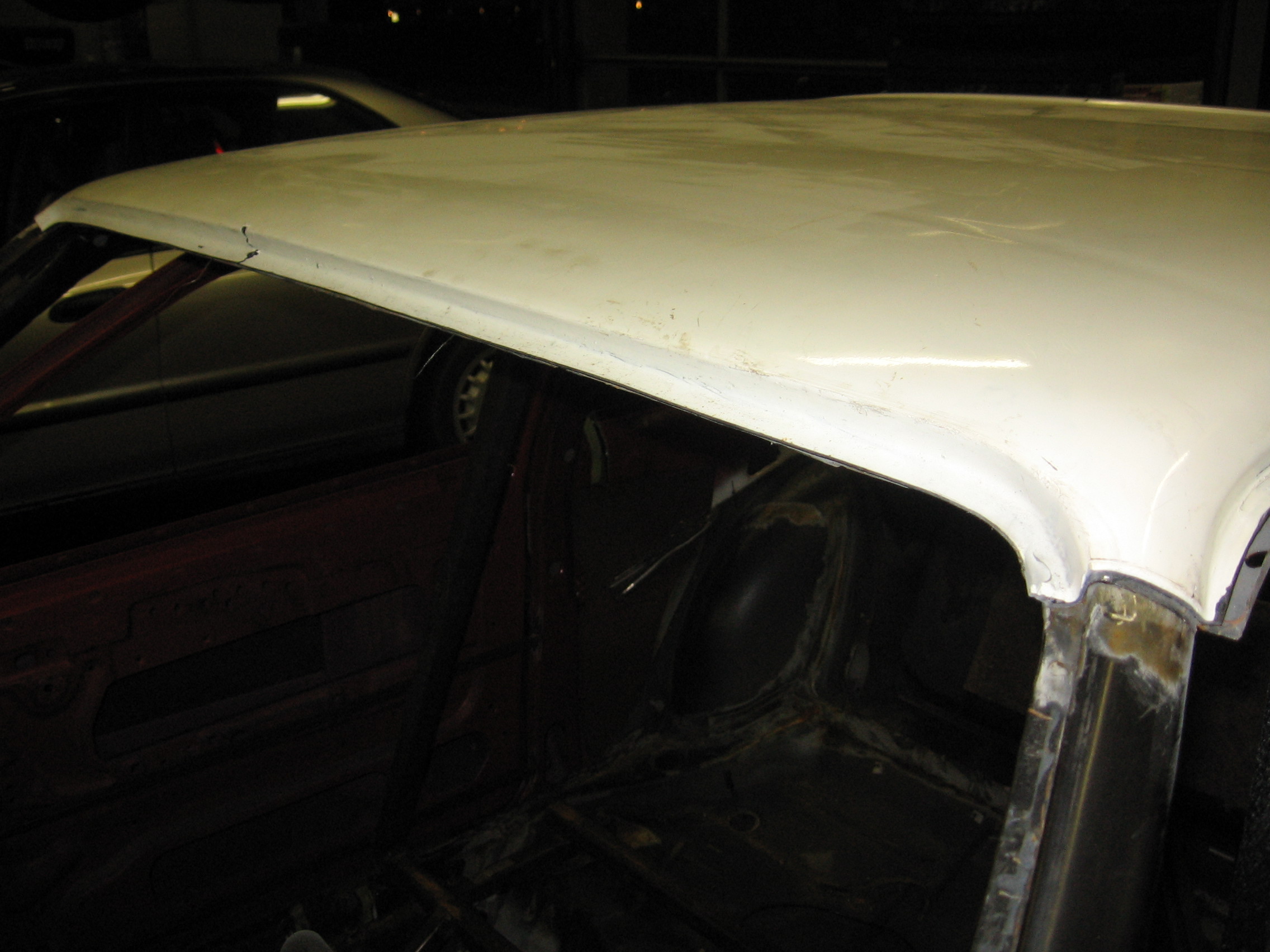

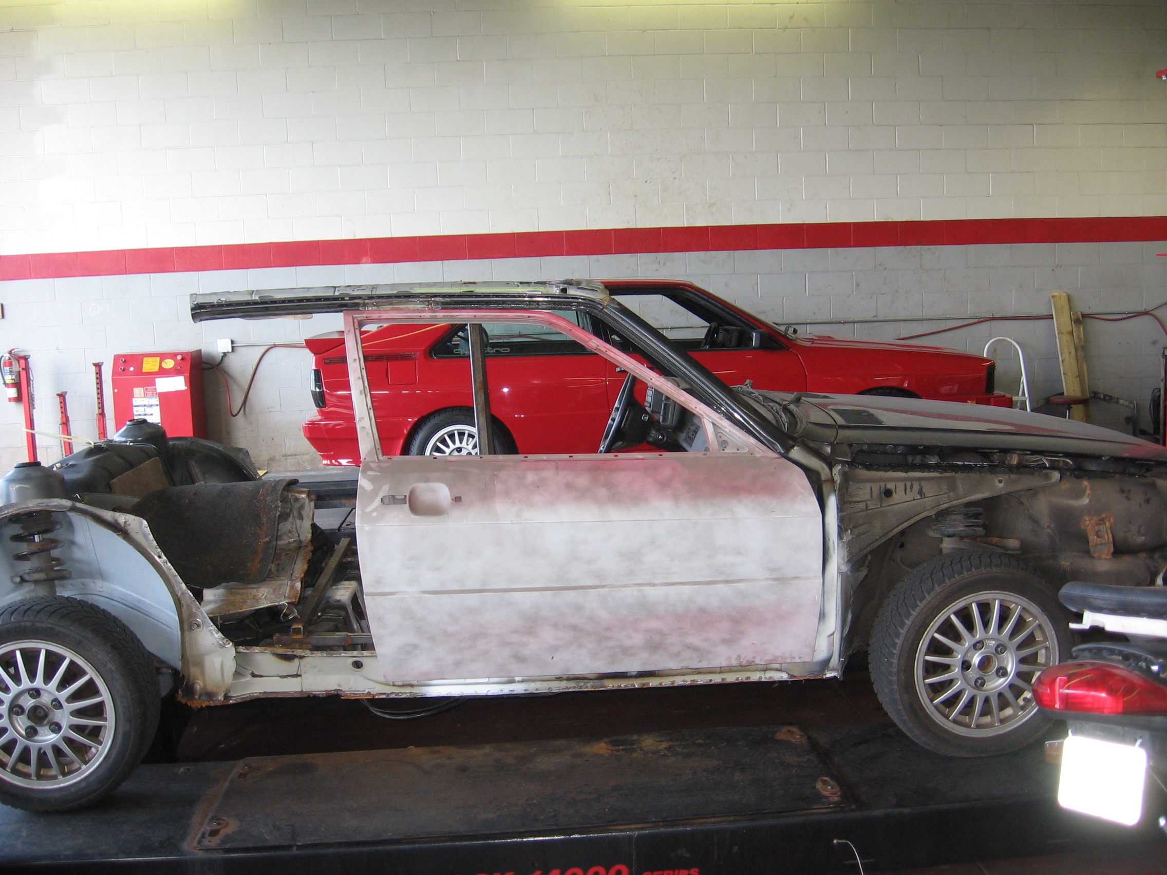

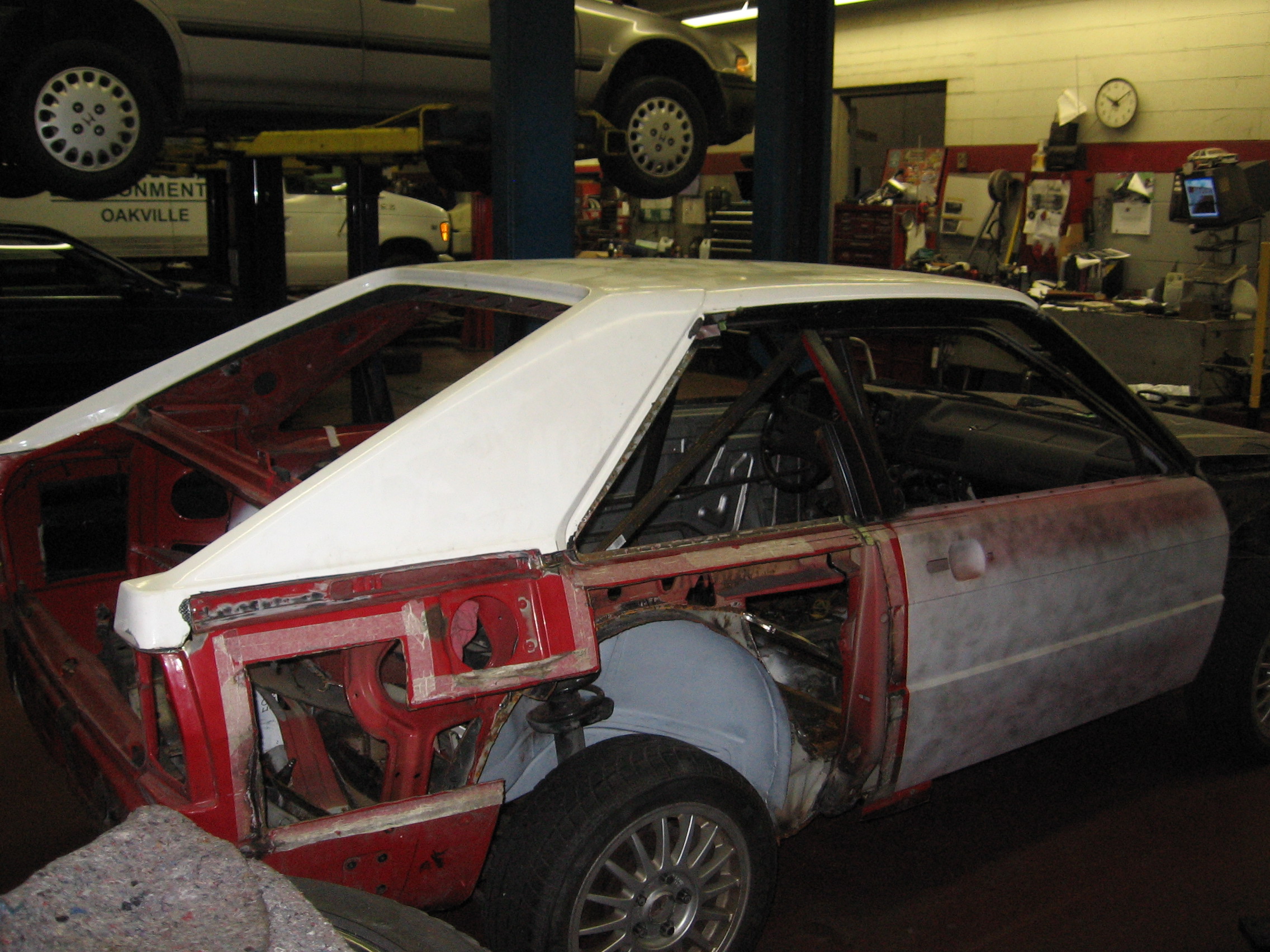

Now we have a 2 door :D
roof cut.jpg (1.14 MiB) Viewed 46939 times
roof cut 2.jpg (1.07 MiB) Viewed 46939 times

highlander69
Posts: 279

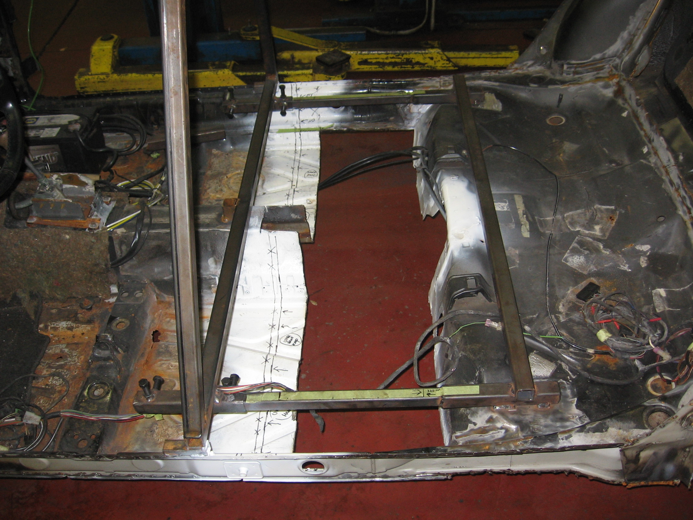

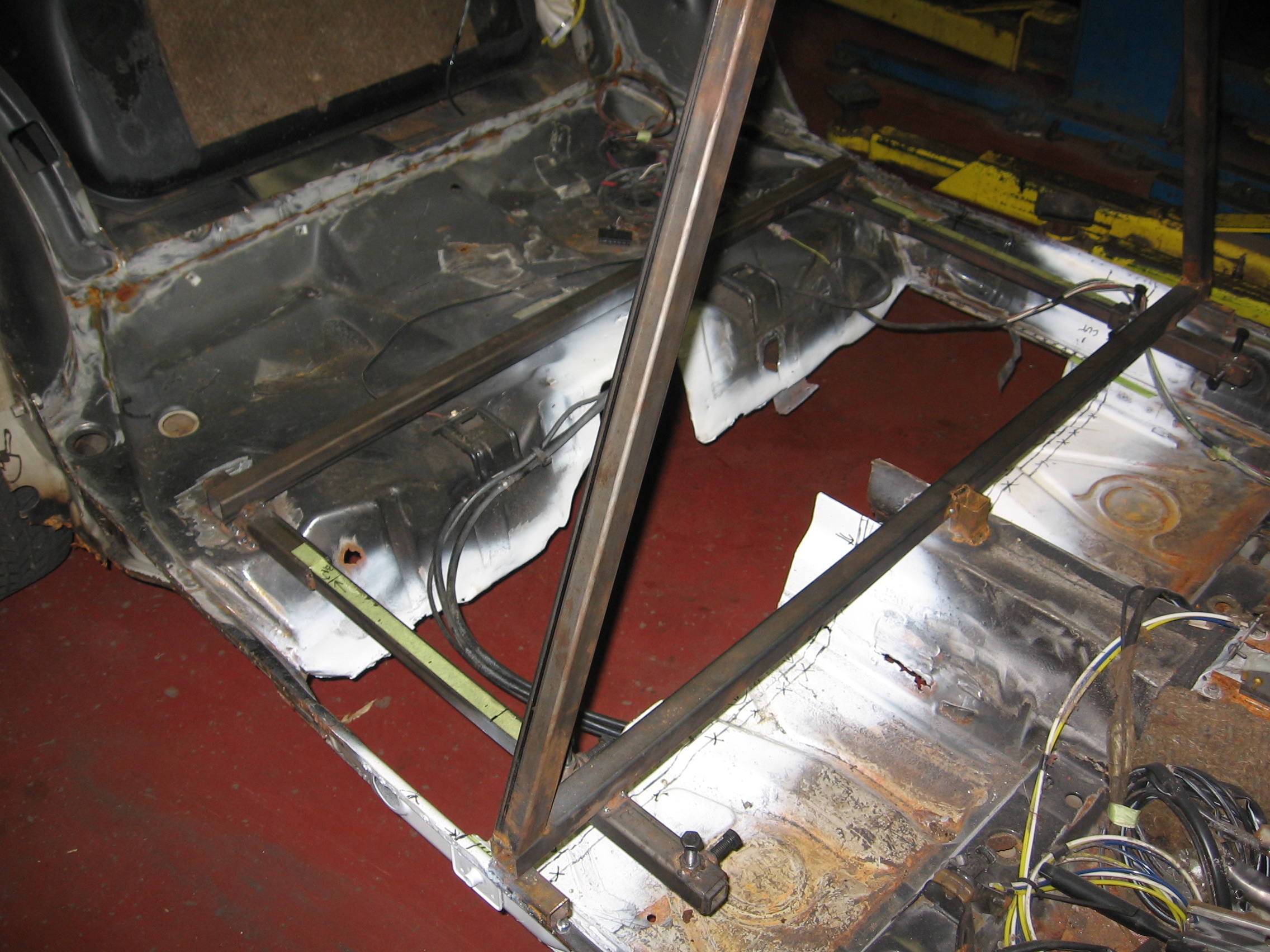

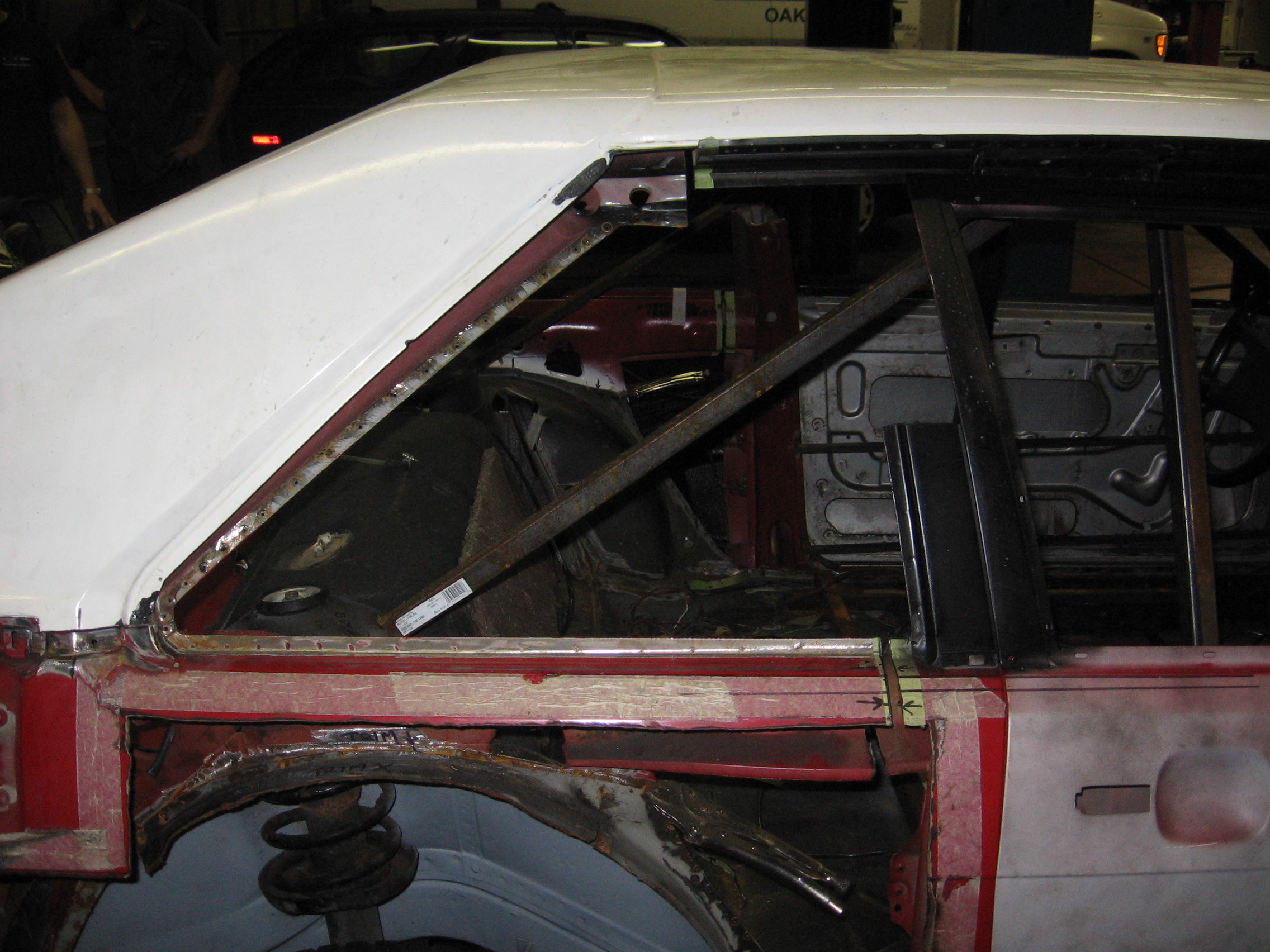

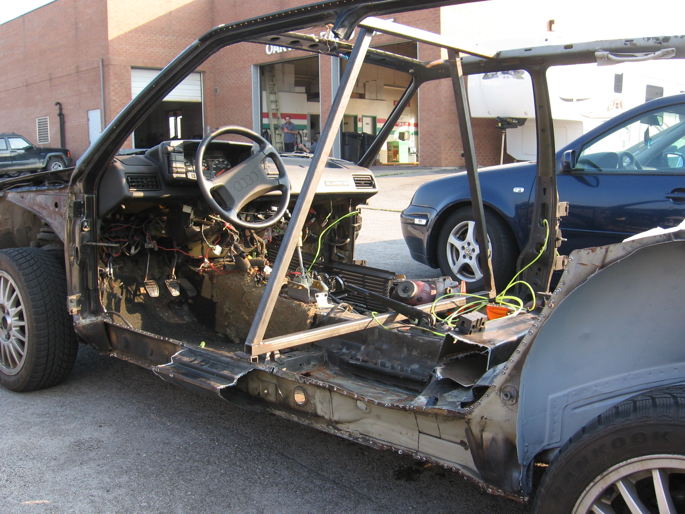

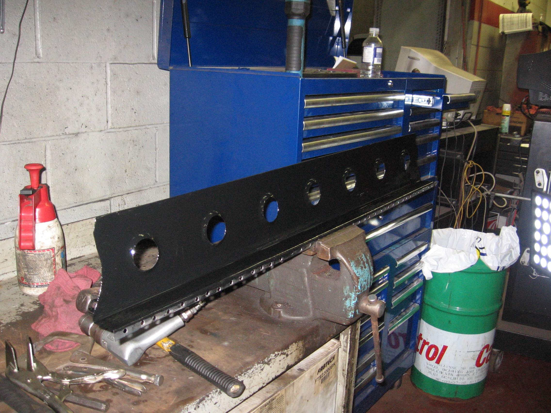

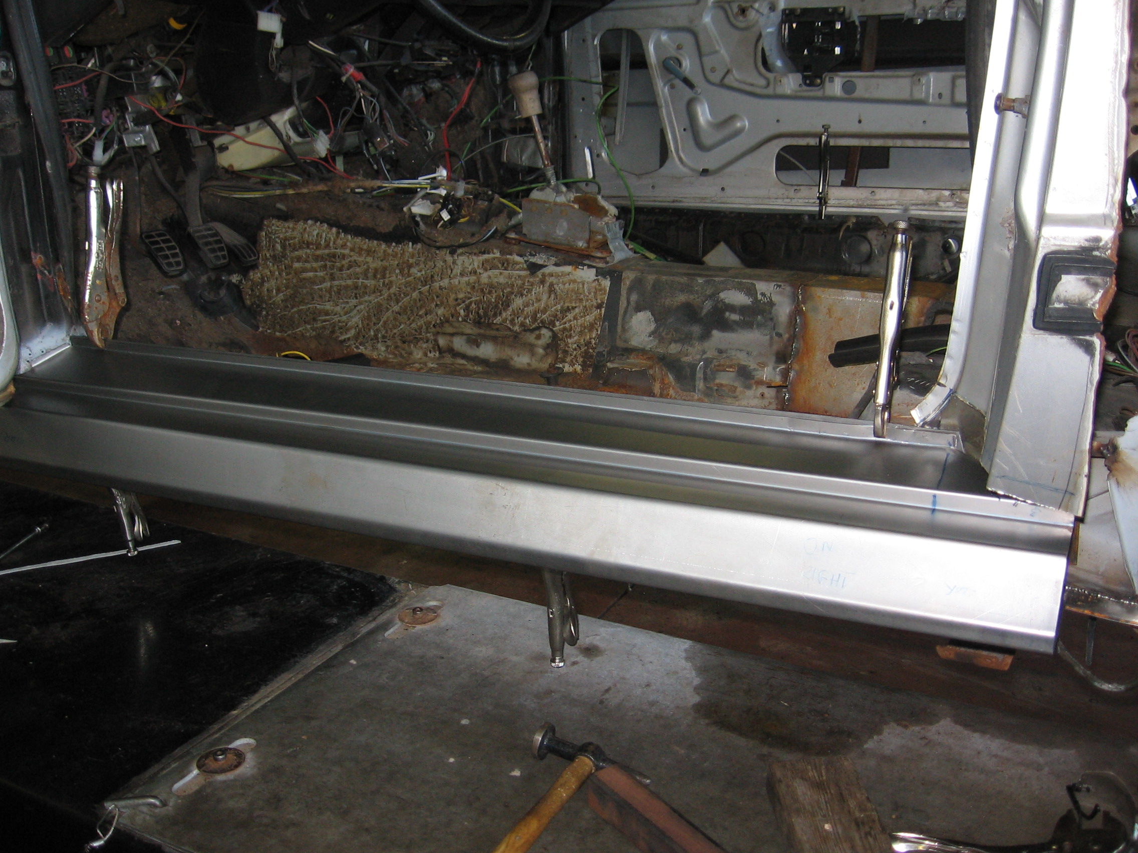

In these pictures I'm still stripping away the sheet metal that's not needed.
The plan here is to get the car ready for adding the rear coupe gt back end.
I built a frame to keep the car braced and square. This is a very important step to
complete. The frame is also what I used to mark all my reference points for shortening and make sure
nothing have moved out of alignment after the shortening process.
I also installed a coupe door as a reference for the location of the b pillar. It's clear to see the difference
in the windshield angles between the 4000 and the coupe with the door installed.
Enjoy the pics.
Craig Cook.
Body work 014.jpg (890.39 KiB) Viewed 46872 times
Body work 004.jpg (1.15 MiB) Viewed 46878 times
Body work 003.jpg (1.12 MiB) Viewed 46878 times
Body work 002.jpg (1.19 MiB) Viewed 46878 times

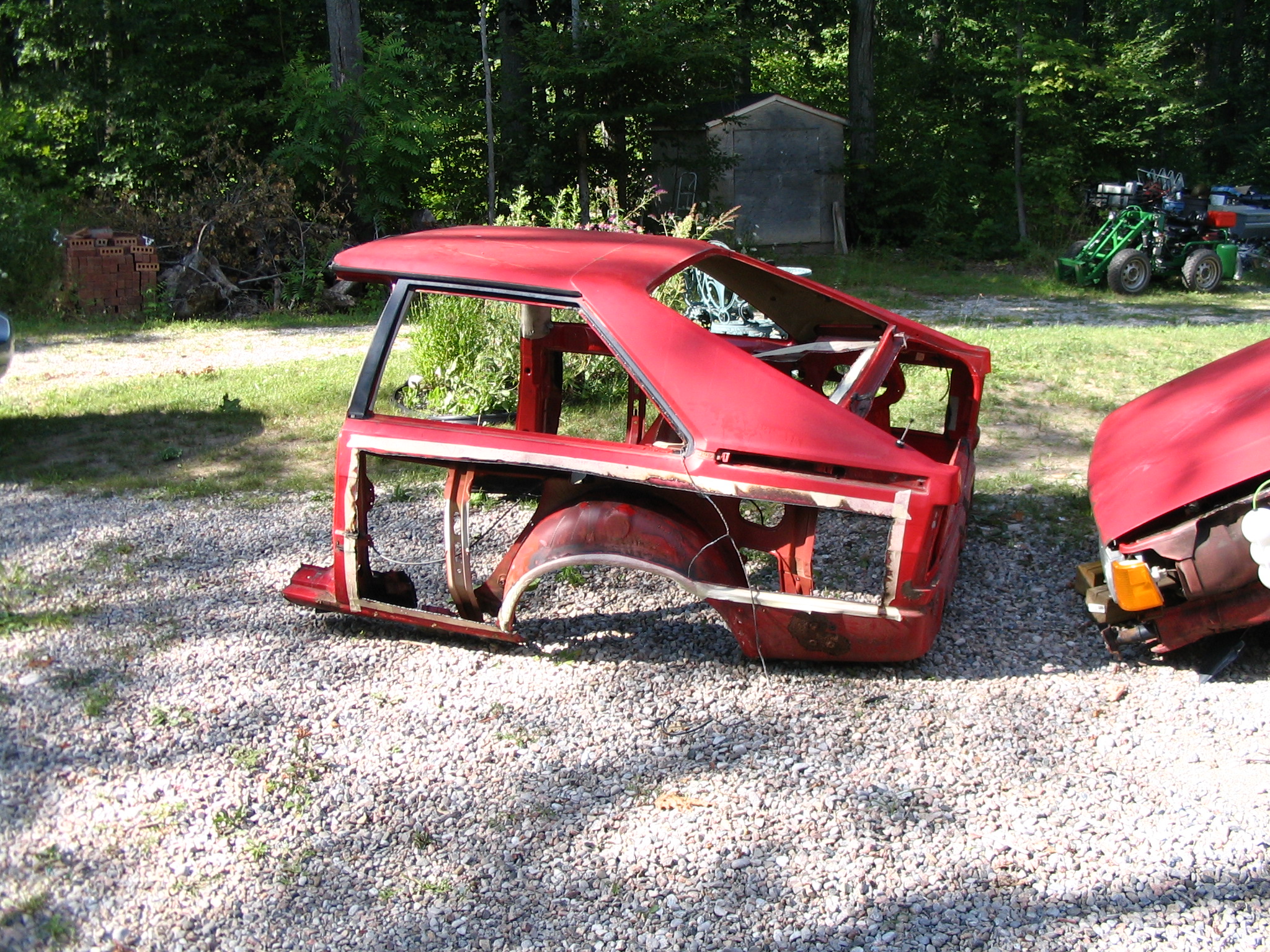

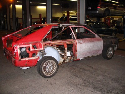

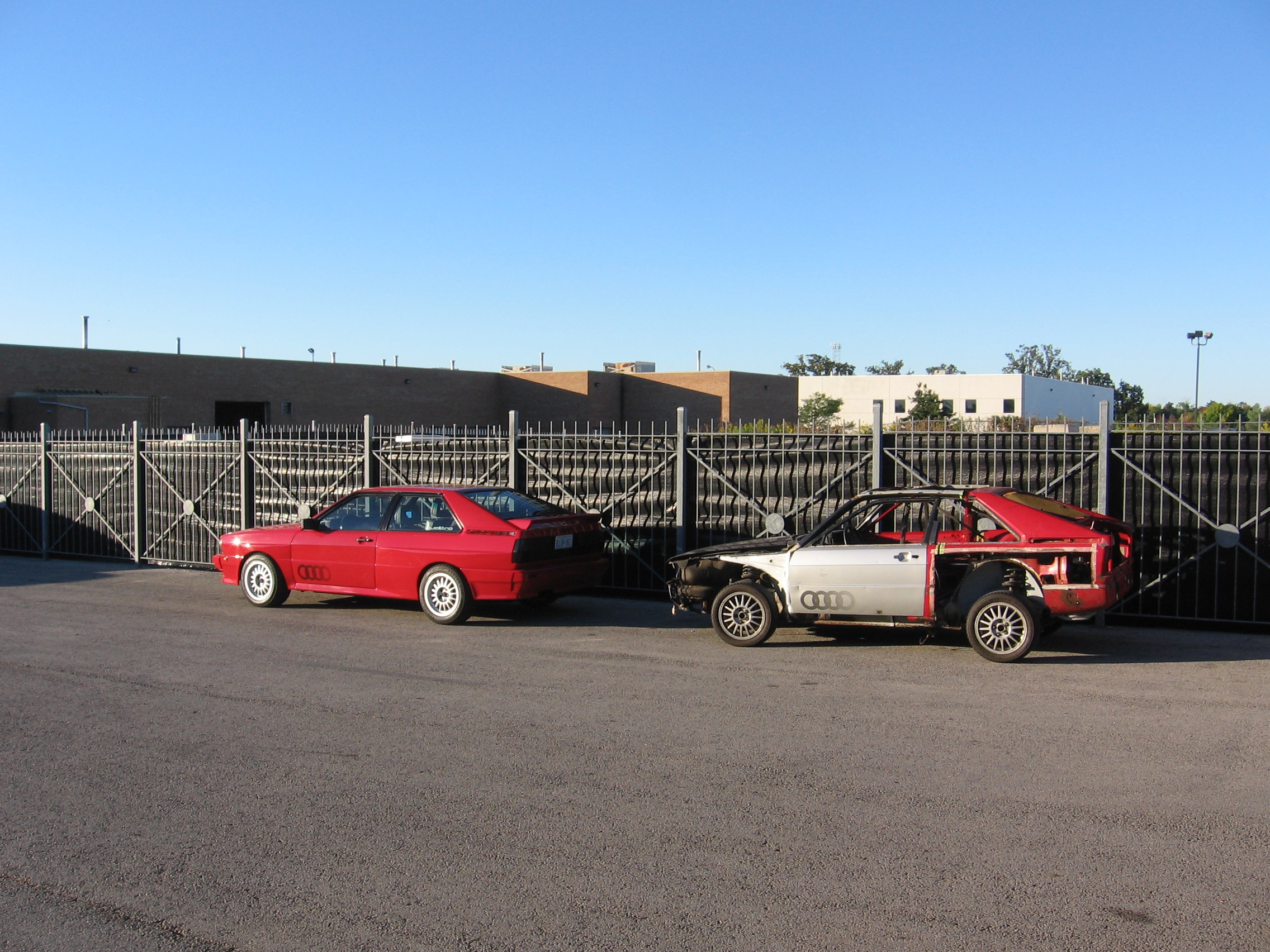

Now that I've done all I can do to the 4000, it was time to hunt down a coupe gt back end.
Time to turn this 4 door into a coupe :D
For once luck was on my side. One of my good friends John (1wheelpeel) who is in the process of restoring
his own urq was breaking a coupe gt.
So one Saturday morning I went up to his house to liberate said parts.
Cheers,
Craig Cook.
John in action with his plasma cutter
Finally I have the second part of the puzzle.<br />I couldn't be happier

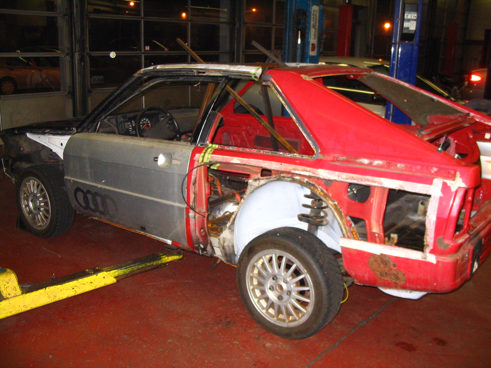

Next step is to get this coupe back end on to the 4000 floor pan so as I can get my game plan together.
First of I had to prep the coupe sheet metal in order the have a trial fit on the car.
Once I had the coupe back end sitting on I could figure out the b pillar location.
Martin took a video of the two pieces being offered up for the first time
http://youtu.be/b29B-yvFUfE
Cheers,
Craig Cook.
If the factory can do it, I can do it!!

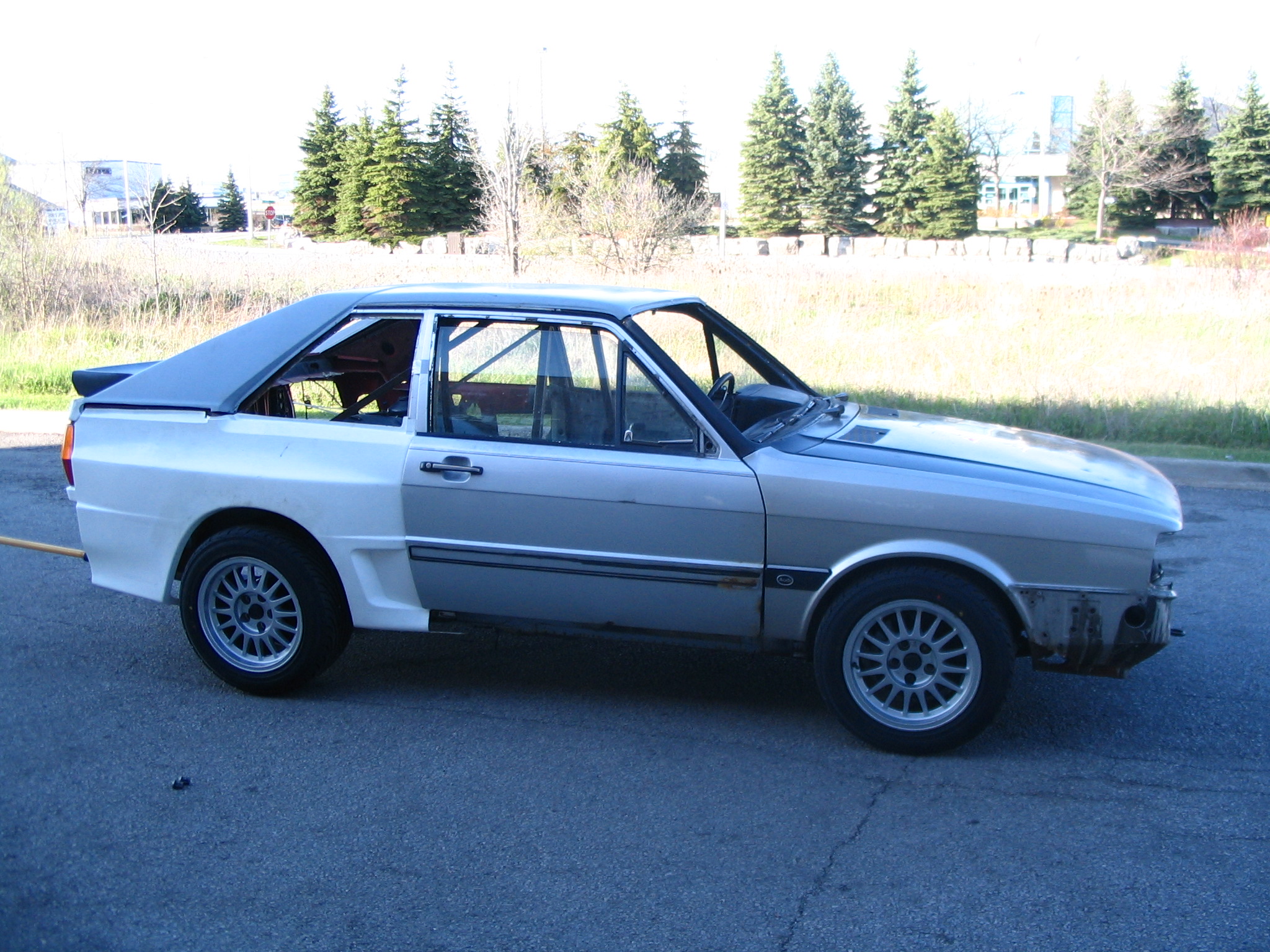

Coupe back end sitting on the 4k floor pan for the first time. Not pretty but sitting on . We now have a coupe!!

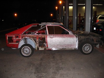

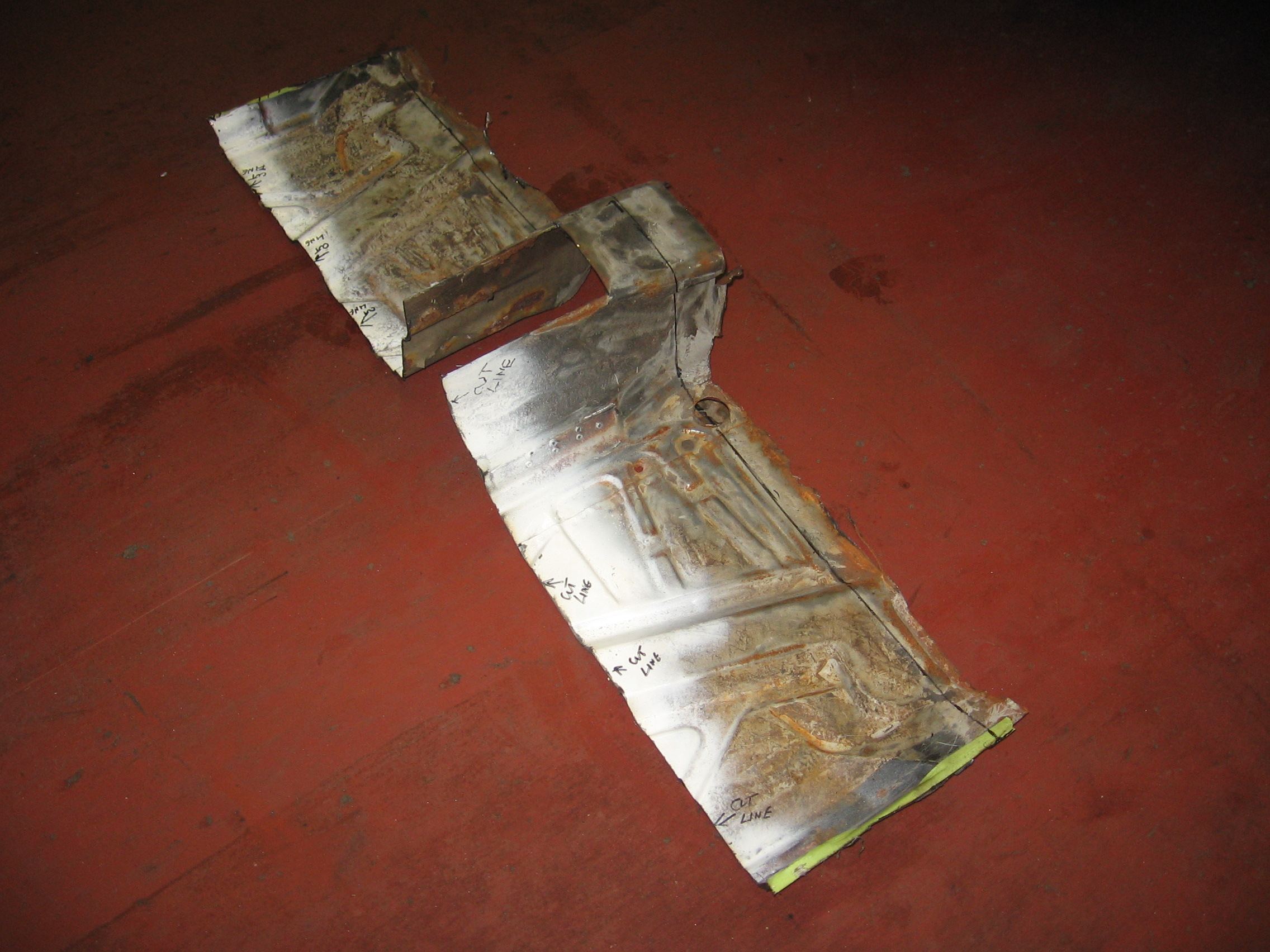

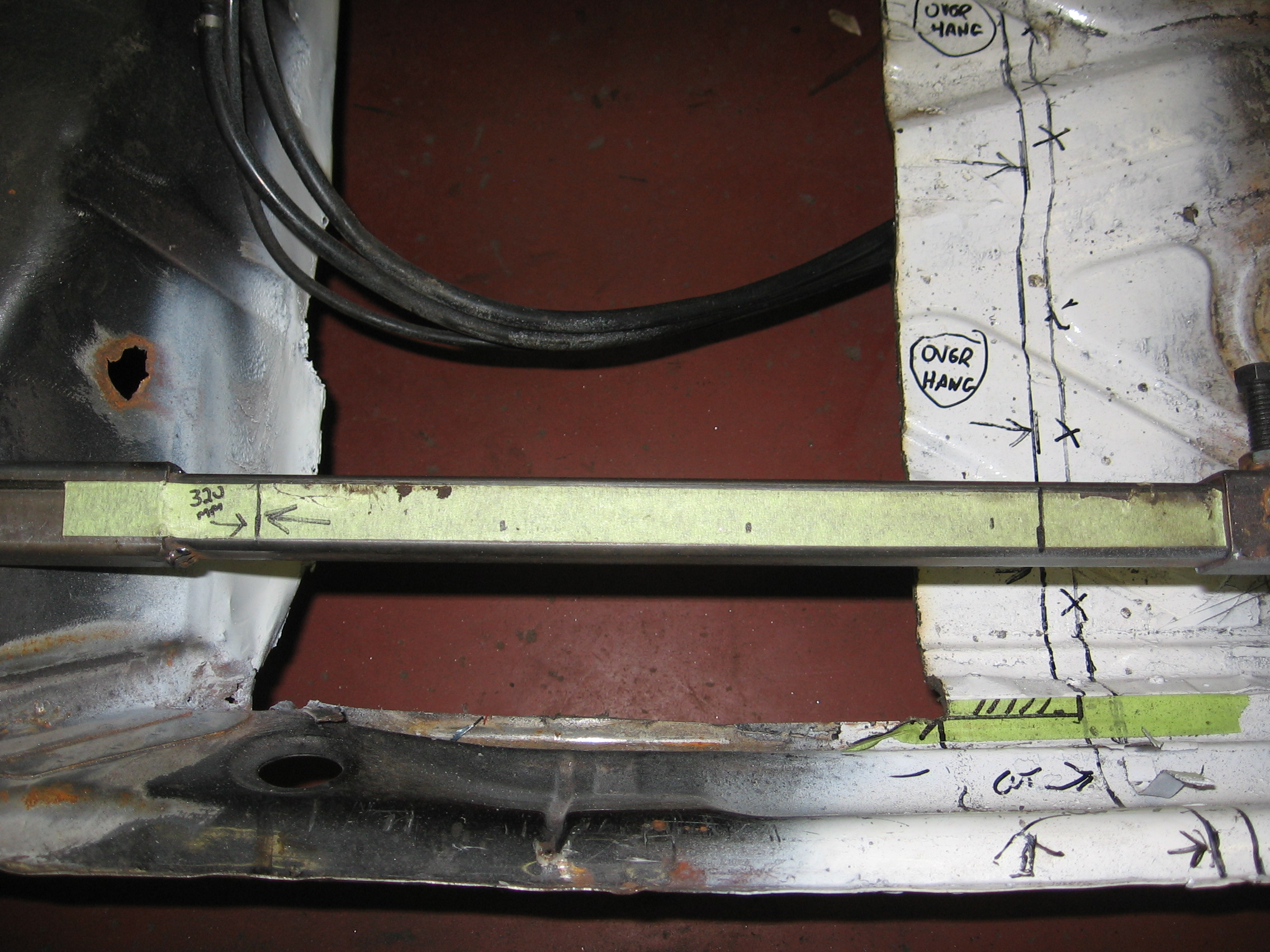

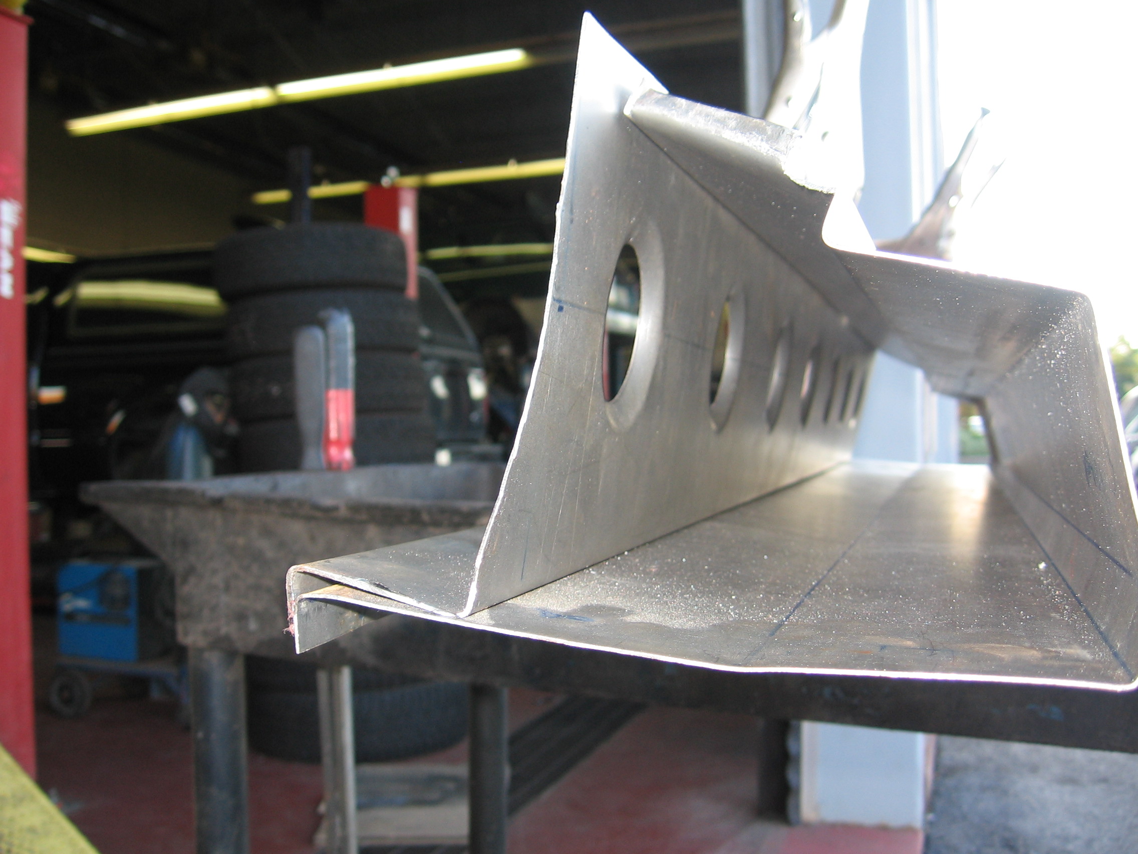

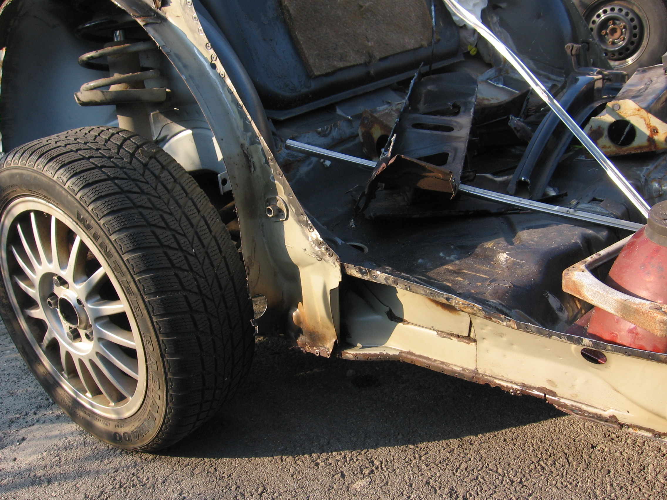

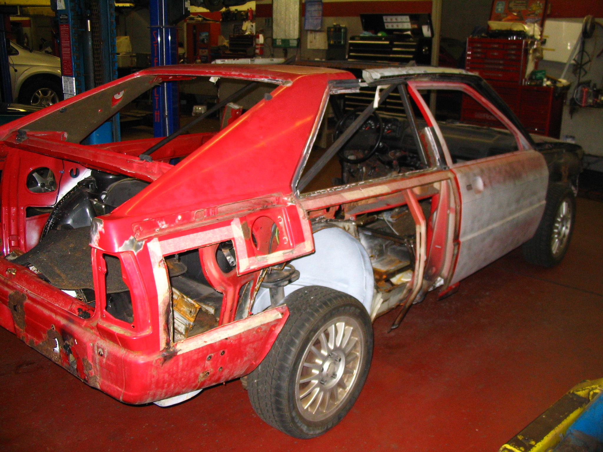

Now that the car had been converted to a coupe it was time to start the shortening process.
I carefully markout out on my jig the dimensions to be cut and then cut out a piece of the floor.
Cheers,
Craig Cook.
Now basically slide the car together and we have a shorty !!
Body work 008.jpg (1.01 MiB) Viewed 46867 times
Body work 009.jpg (1003.81 KiB) Viewed 46867 times
Body work 010.jpg (964.93 KiB) Viewed 46867 times
Floor be gone
Floor be gone
Body work 011.jpg (879.3 KiB) Viewed 46867 times

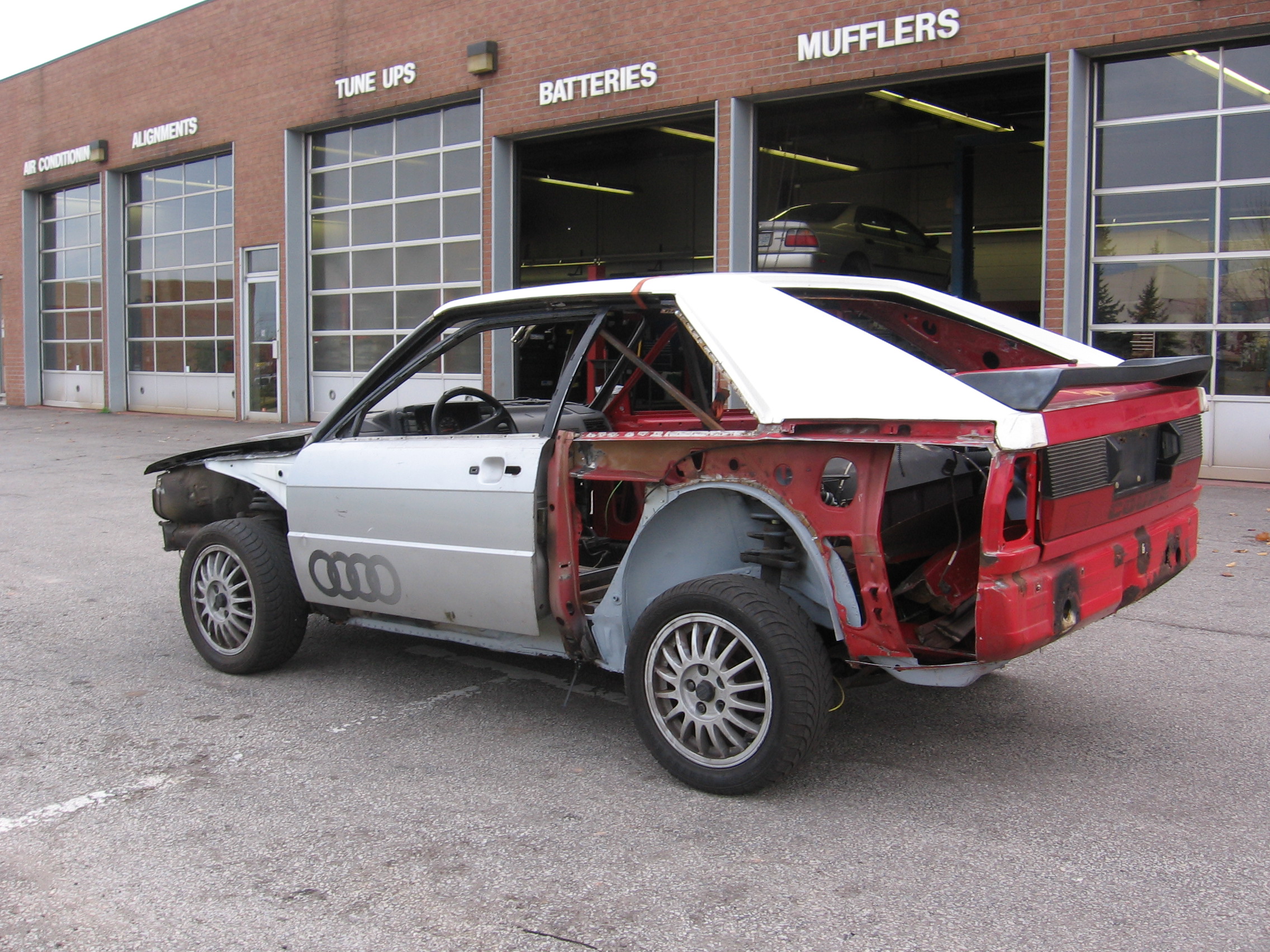

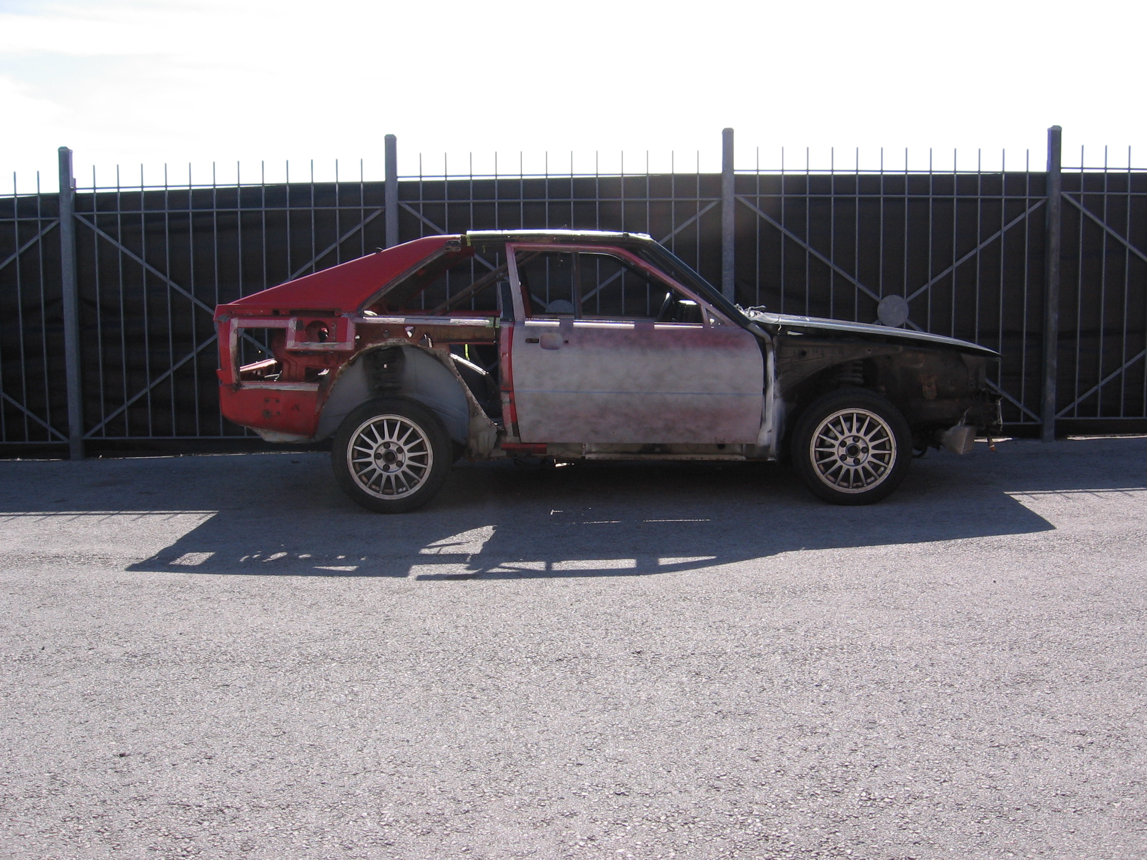

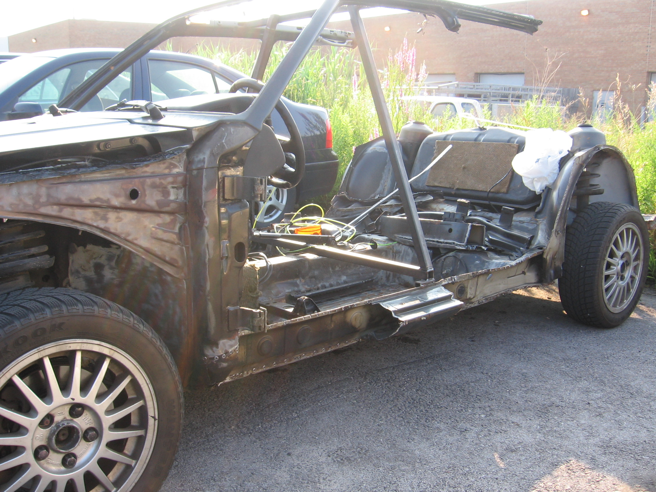

Now the fun car really begin. The day has arrived to shorten the car.
In these pictures the car has been shortened,but still has about 20mm to go.
Martin came over to help out with the fun part.
Again we took a few videos of the process. A little elbow grease and the car came together !!
http://youtu.be/w7XwL7B1HbM
http://youtu.be/dsm2iS200KM
We have a shorty............. :D
Cheers,
Craig Cook.
urq sport comparison 001.jpg (1.18 MiB) Viewed 46862 times
Getting there
Getting there
Shortening the car 009.jpg (1.17 MiB) Viewed 46862 times
Shortening the car 001.jpg (941.03 KiB) Viewed 46862 times

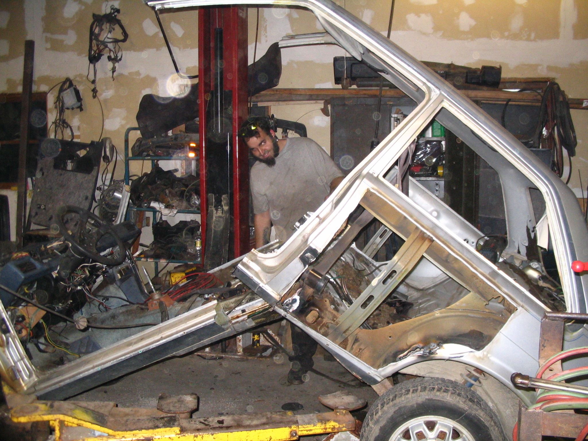

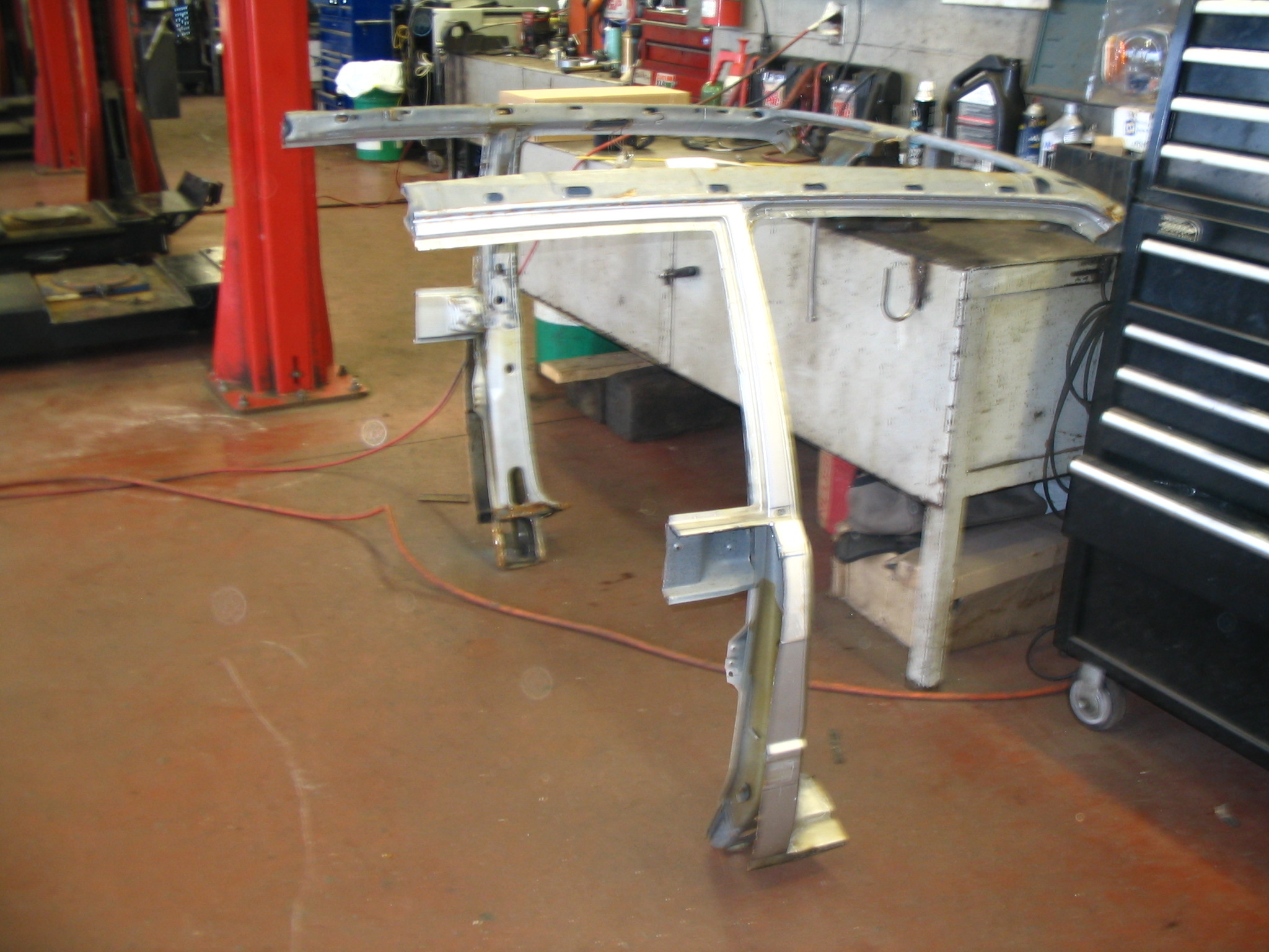

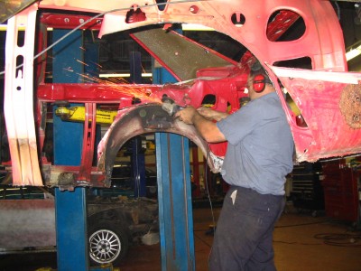

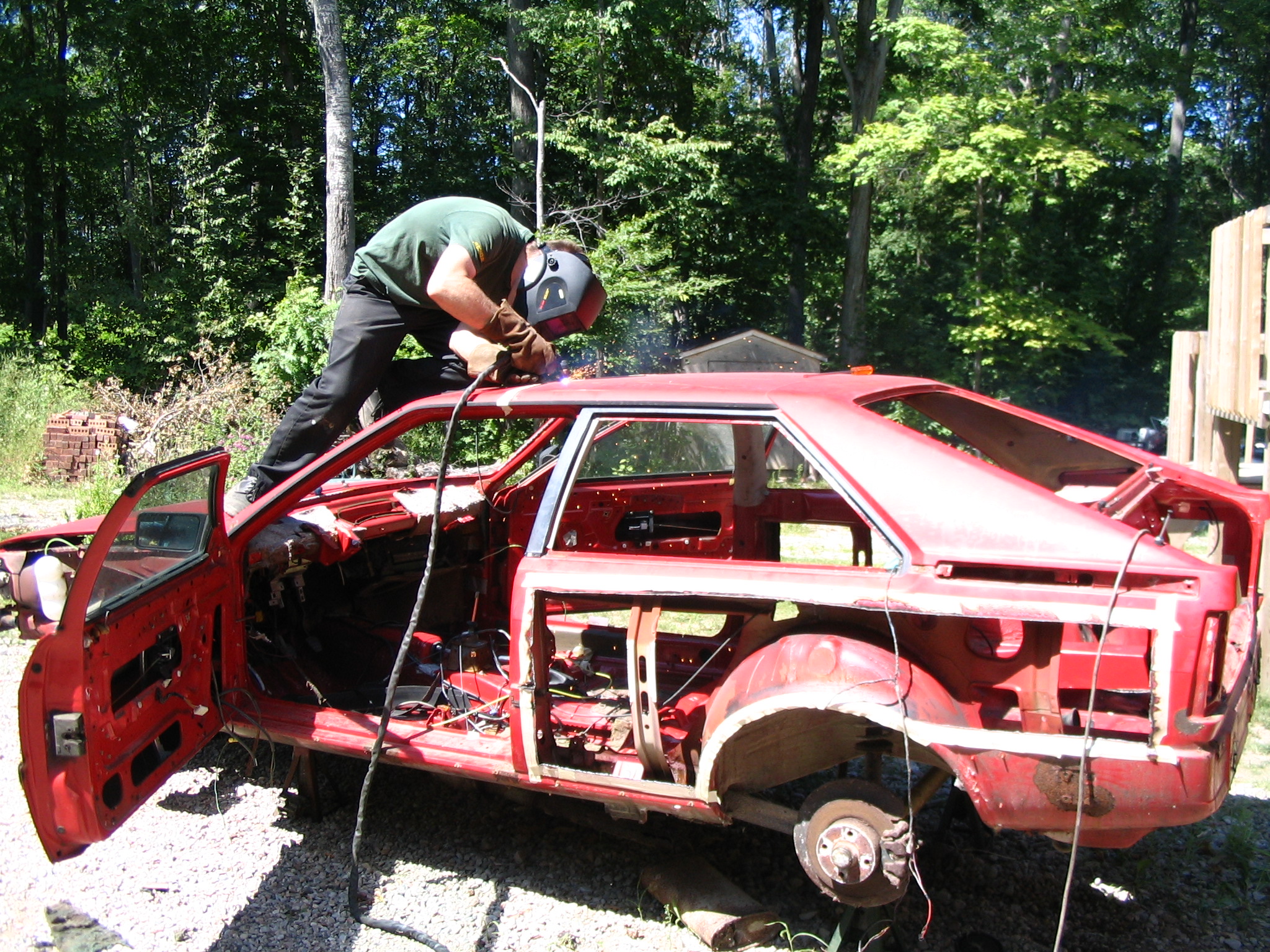

I guess the Audi god's must have been approving my build. One of the audi group members
had a 2 door he was willing to break for me :ty: :hail: :hail:
I NOW HAVE ALL THE PARTS FROM 3 CARS TO BUILD MY OWN SPORT QUATTRO :drive:
Jim (glibobbo21) had just what I needed. Although it was over a 20 hour round trip, I couldn't get there fast enough.

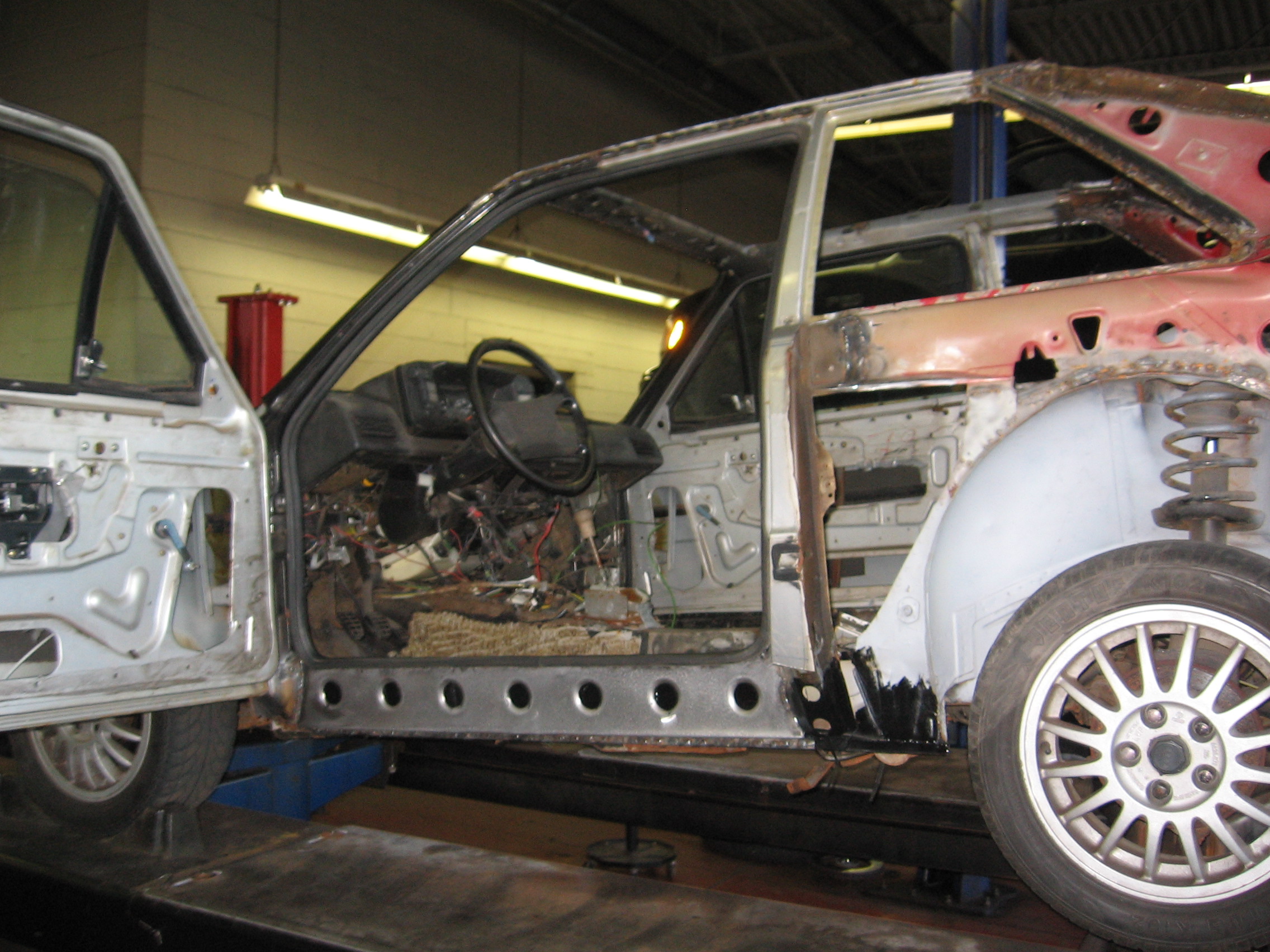

So after driving for over 10 hours we arrived at Jim's place.
Here's Jim looking quite scary cutting the car up!!
Jim the madman cutting the car up!!
Car fell off the hoist!!.JPG (1.03 MiB) Viewed 46857 times
23 hours later. I have a b pillar!!
2 door roof prepped 002.jpg (1.57 MiB) Viewed 46857 times

Now that the car has been shortened, it's time to get some strengh back in to this unibody.
First, I sat the roof on to verify fit.
As hoped, it looks great 8-)
Cheers,
Craig Cook.

Now it was time to get that b pillar welded in.
I installed the b pillar in 1 complete piece. Most people cut the b pilllar in half.
This way is a stronger way to do it.
So for the first time I have the correct b pillar and door on the car. It's starting to look like
a car again.
Cheers,
Craig Cook

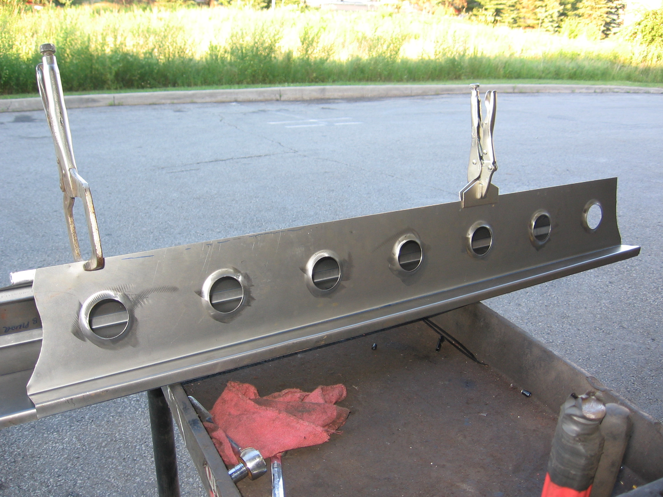

More unibody work on the car.
My goal is to make the car stronger than even the factory sport quattro road car was. Even
before I install the roll cage. A strong platform to build from is a must.

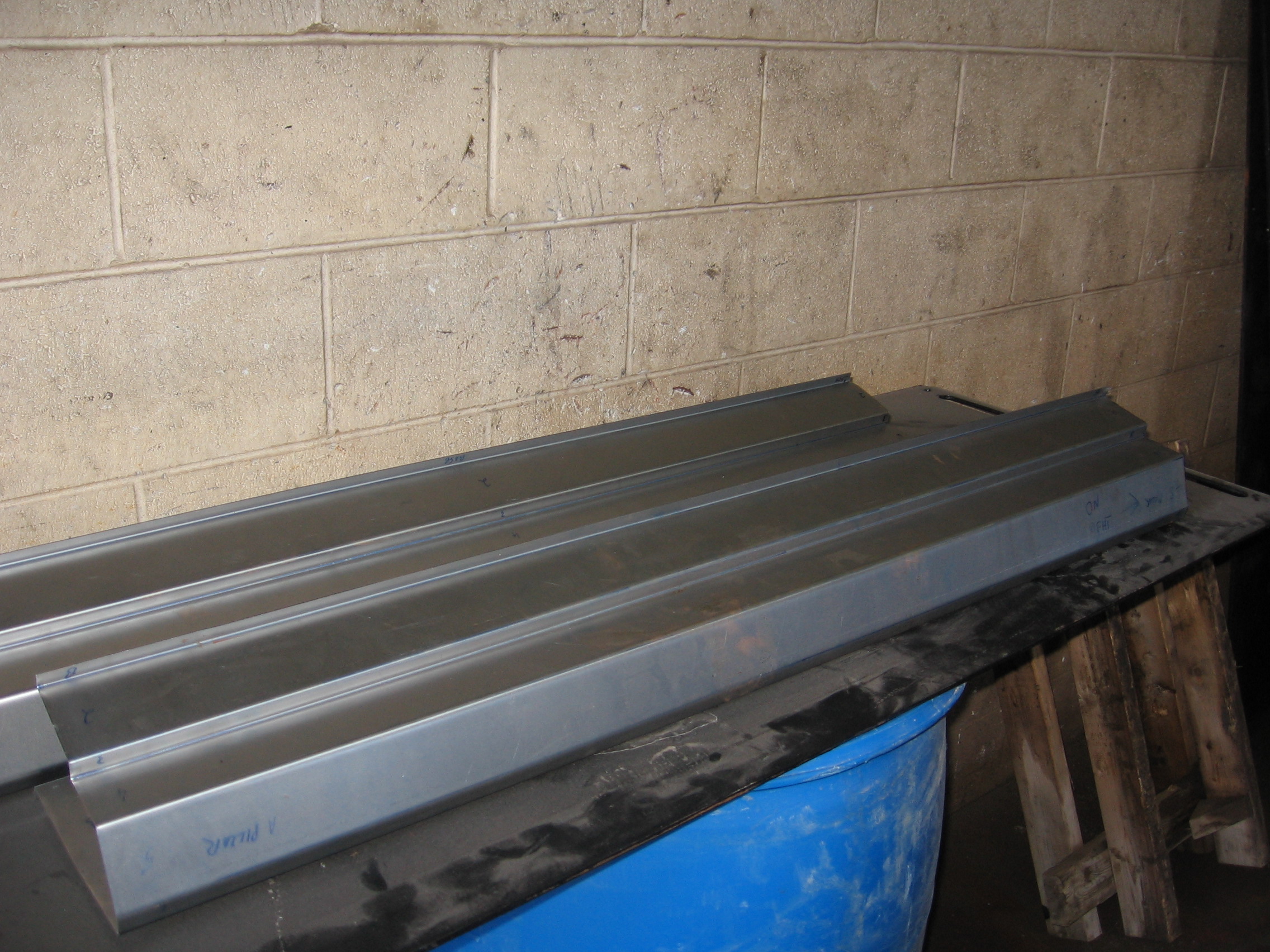

I bent up my outer rockers in a heavier gauge metal than the factory used.
I also installed a complete mid inner rocker in a heavier gauge metal. This part alone has increased the unibody
strength significantly. :D
Cheers,
Craig Cook.

A few more on the rocker detail.
By installing the mid inner rocker piece, I was able to seam weld the a and b pillars together.
This increased the strength significantly. Something the factory never did.

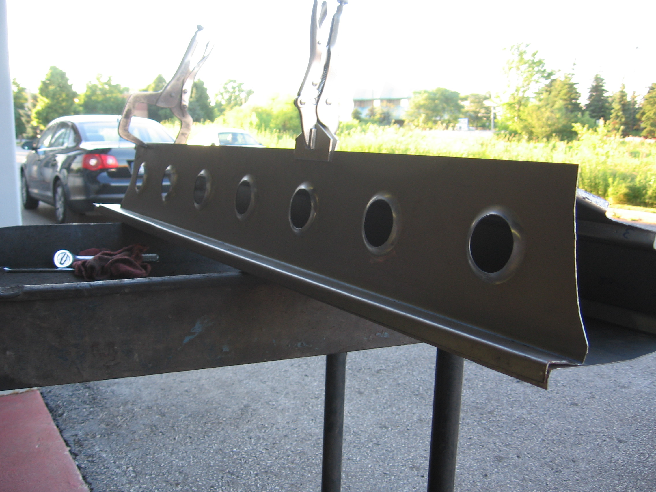

These dimple dies look familiar, I hope we don't wear them out before Martin needs them ;)
Thanks for the loan :beer:
