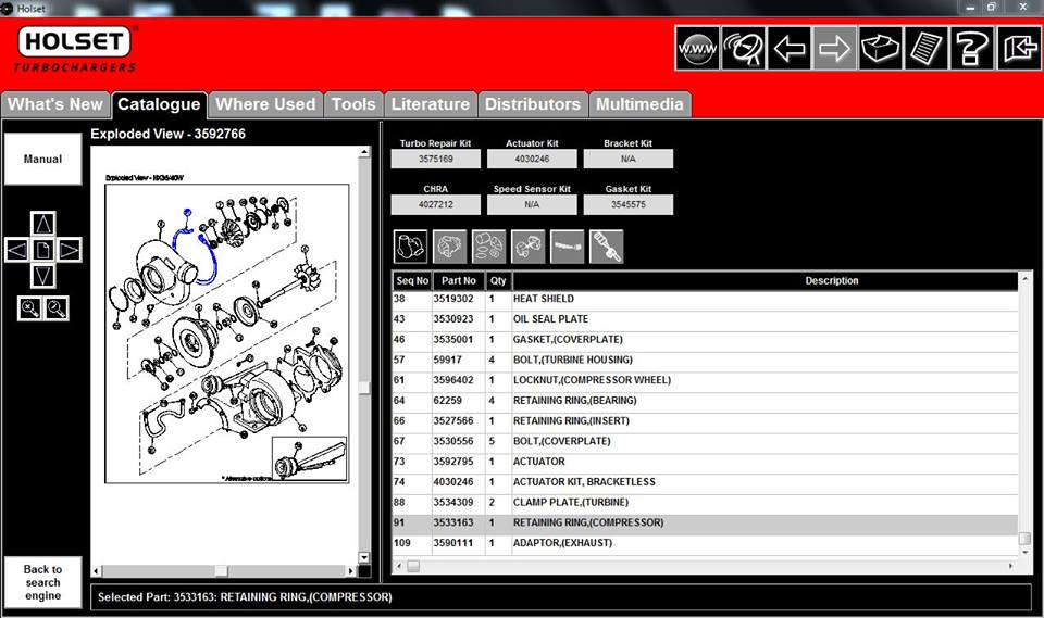

i managed to get a copy of the factory holset parts catalog software! this is really freaking useful!
- 12006374_10153059096836771_4449606938117245152_n.jpg (82.23 KiB) Viewed 60986 times
