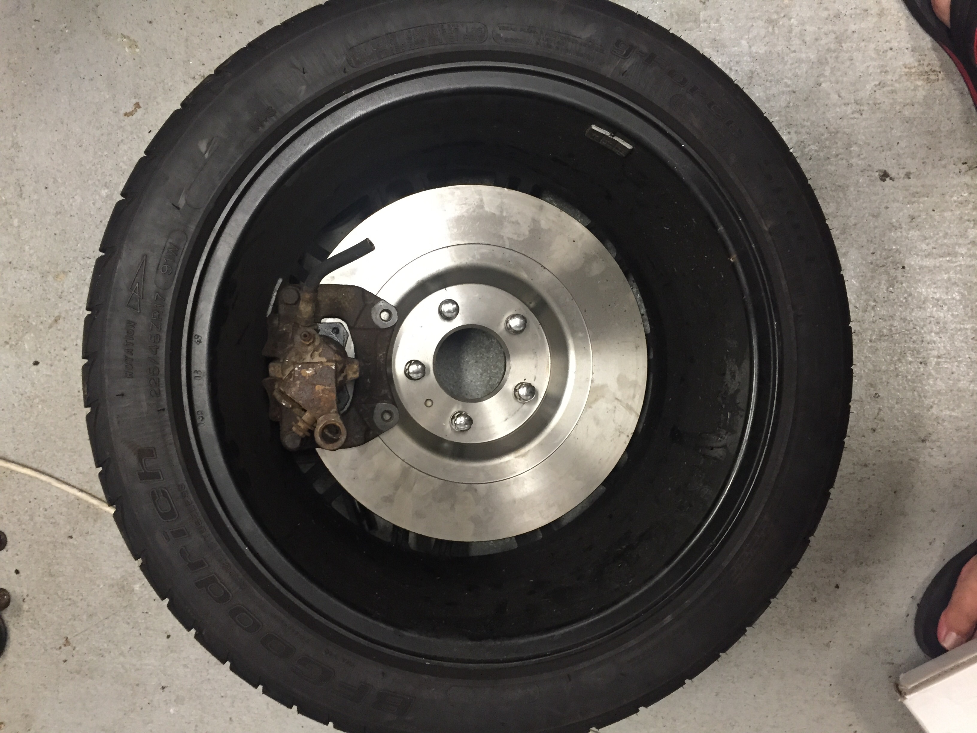

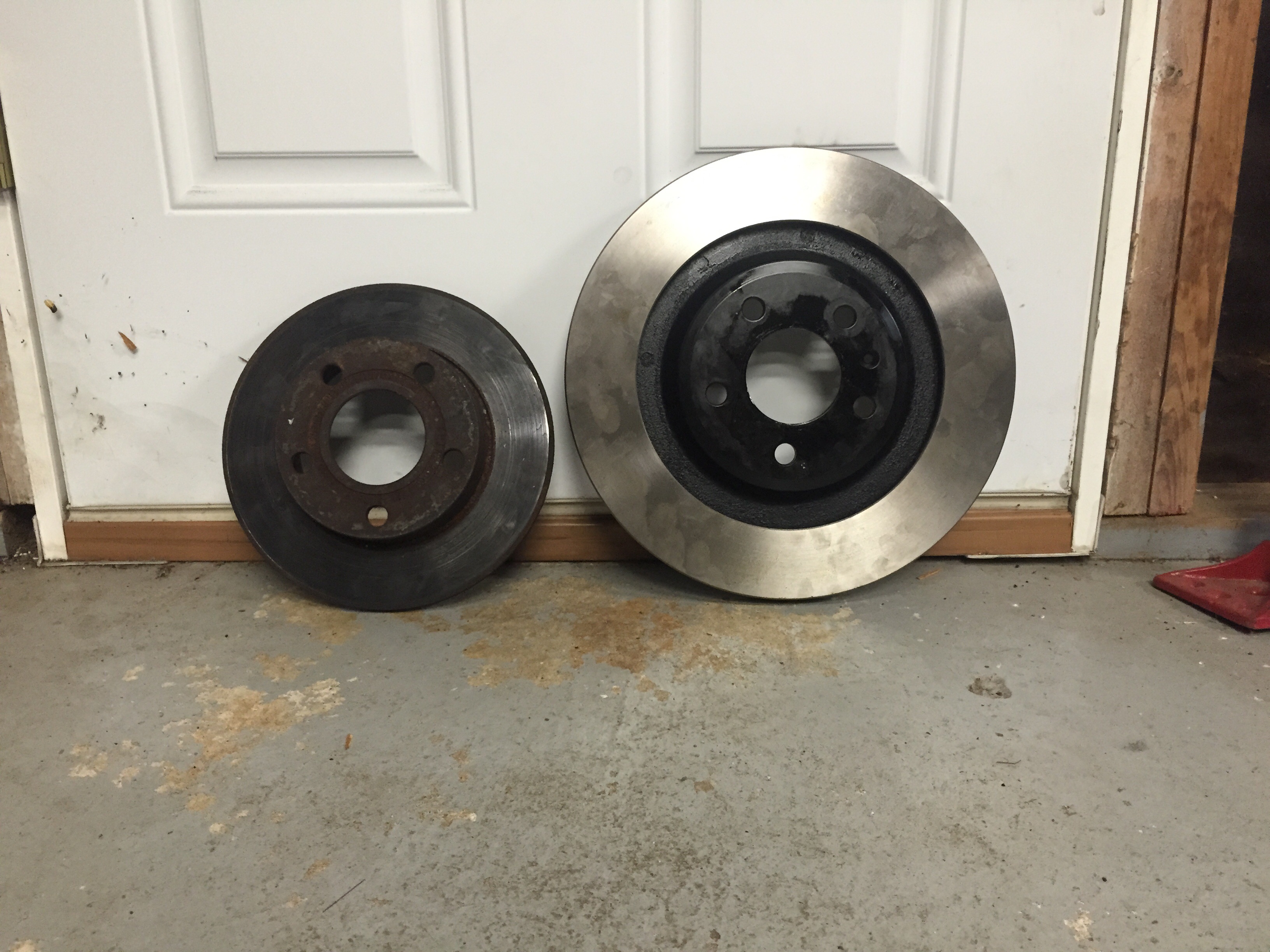

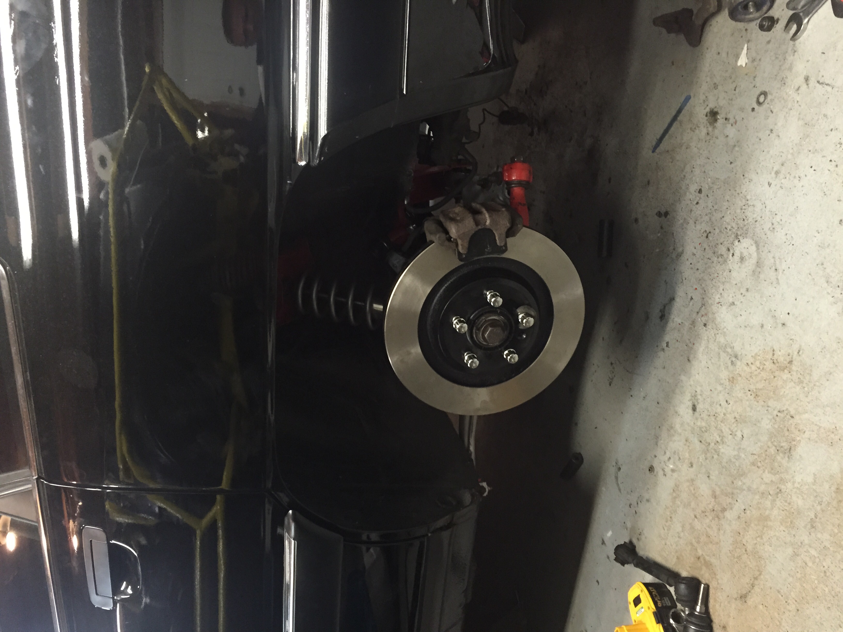

Here is what I did... 330x22mm rotors. Factory 200 20V/ V8 rear calipers and making the adapter plates.
Rotors are $42.00
Rotors are $42.00
- image.jpg (1.11 MiB) Viewed 67660 times
- image.jpg (1.22 MiB) Viewed 67660 times

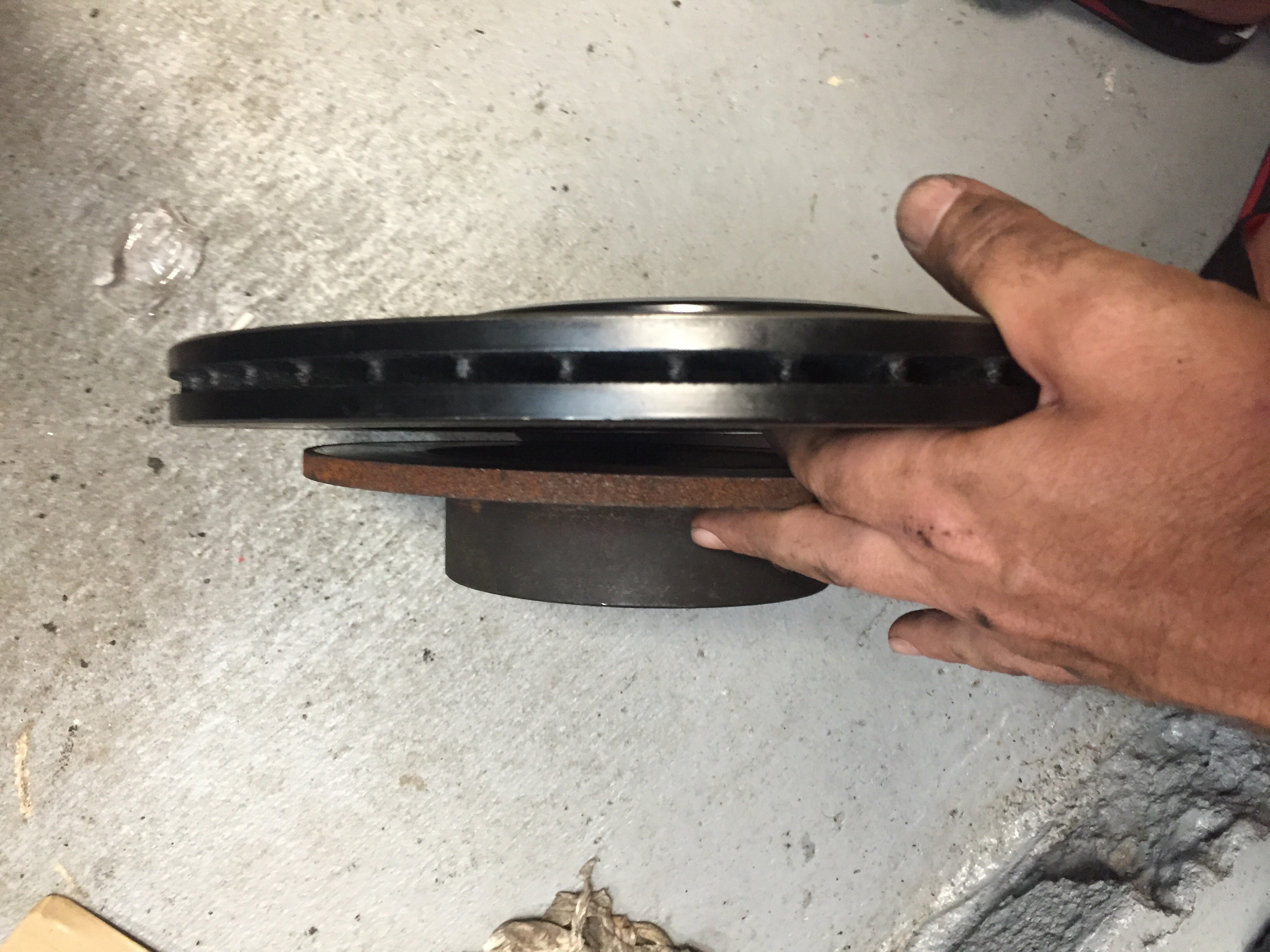

Are those rotors vented?

I now realize that was a stupid question, but I wasn't sure if the stock caliper for the non vented rotor would work with a vented rotor, and from those angles they didn't look vented.
Re: Type 44 big brake ideas? (Rear)
Wow that's a lot of rotor, well done! At that point I doubt it would matter vented or not, that's a lot of surface area to dissipate relatively not that much heat. I mean I'm sure there would be a difference technically but with a good set of pads I bet you would never notice. I've been following along, well done on all fronts

He said he is using V8Q rear calipers...pilihp2 wrote:I now realize that was a stupid question, but I wasn't sure if the stock caliper for the non vented rotor would work with a vented rotor, and from those angles they didn't look vented.

They are vented...
- image.jpg (1.52 MiB) Viewed 67624 times
