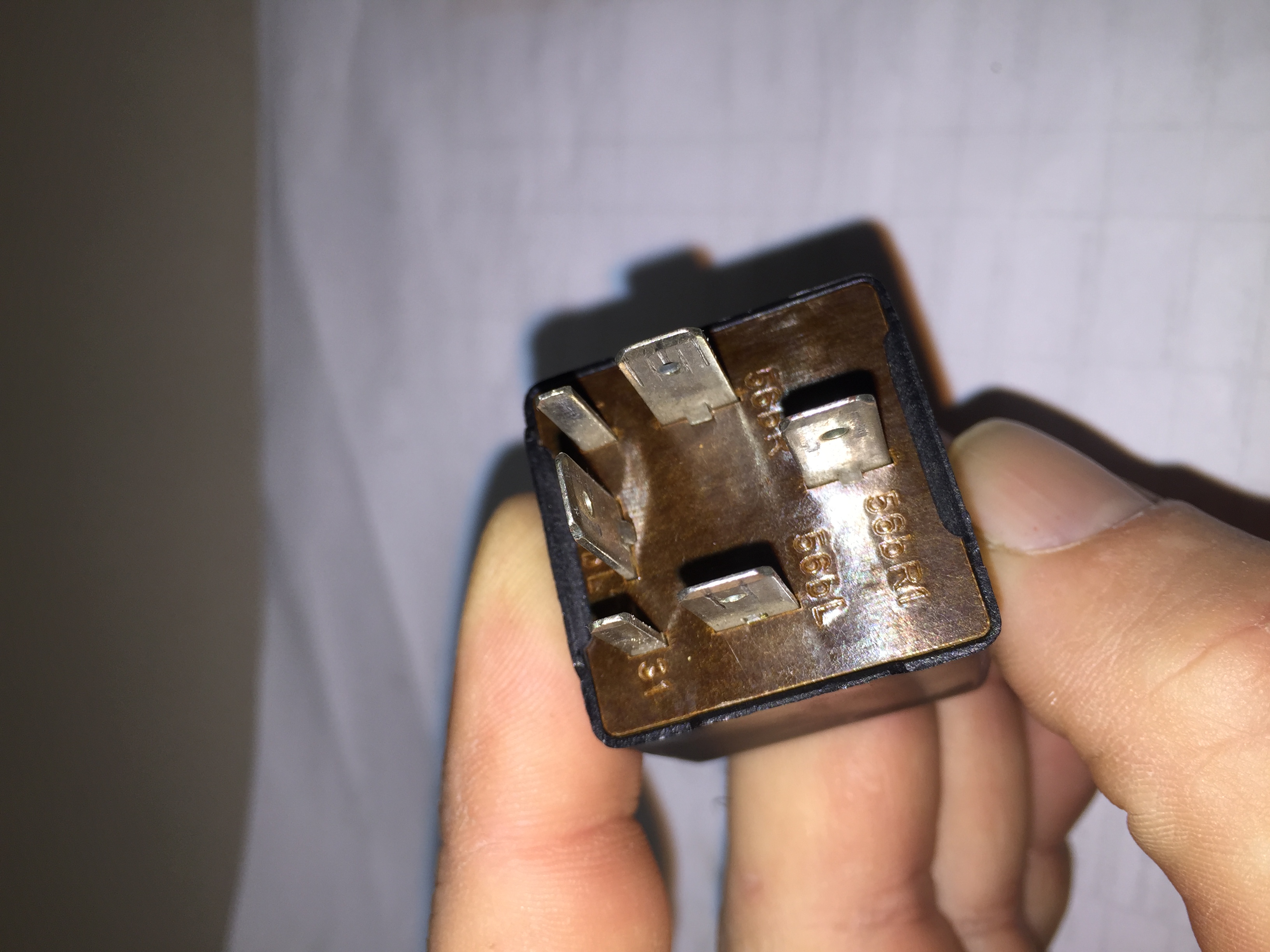

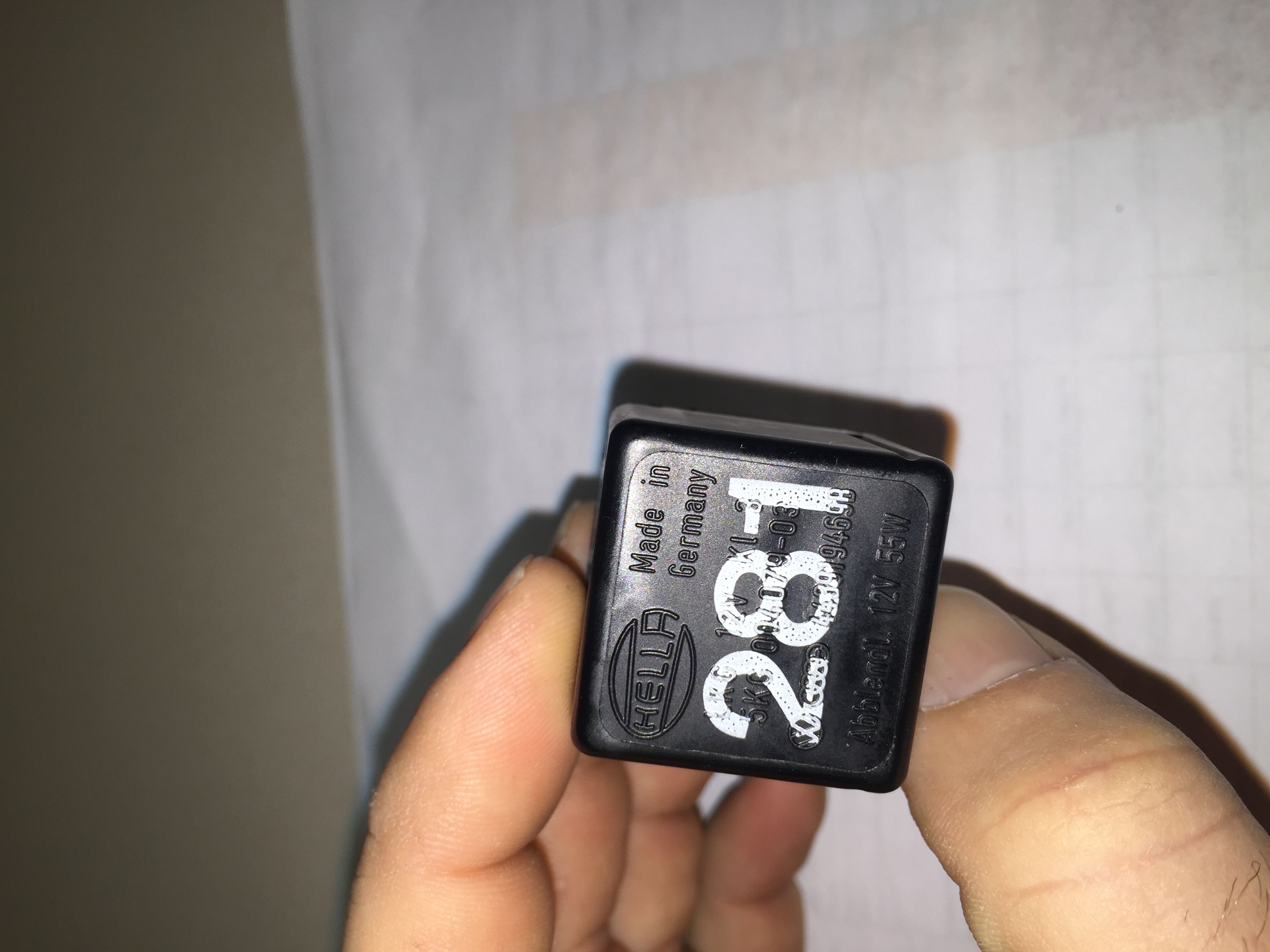

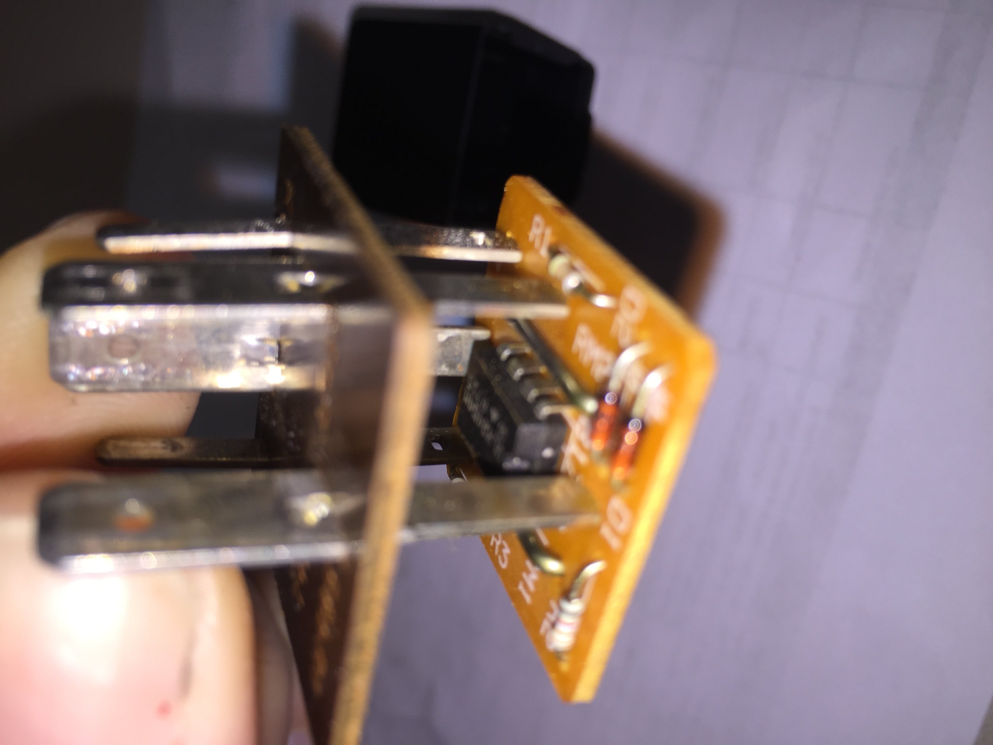

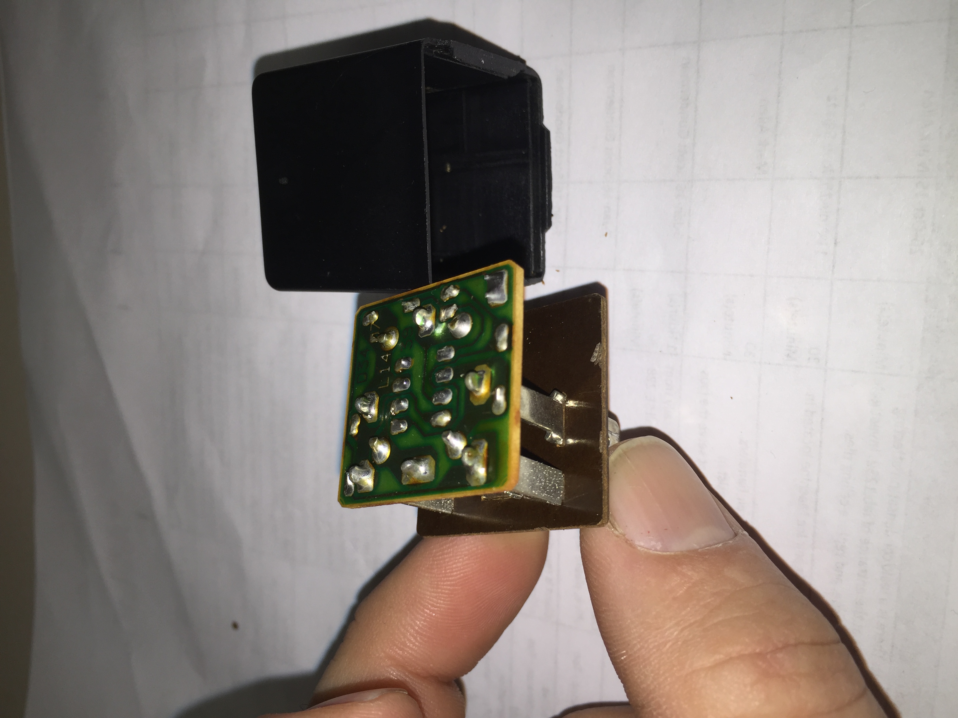

Here is my lamp control module... It looks like a standard relay, but this one is electronic and has more pins. I would have no idea on how to test this or how it should act. It looks like I am going to have to do a lot of point-to-point with my meter and more than likely split the heavy duty jacket that protects the wiring harness that goes goes to the front of the car. I was Really hoping to not have to do that.
