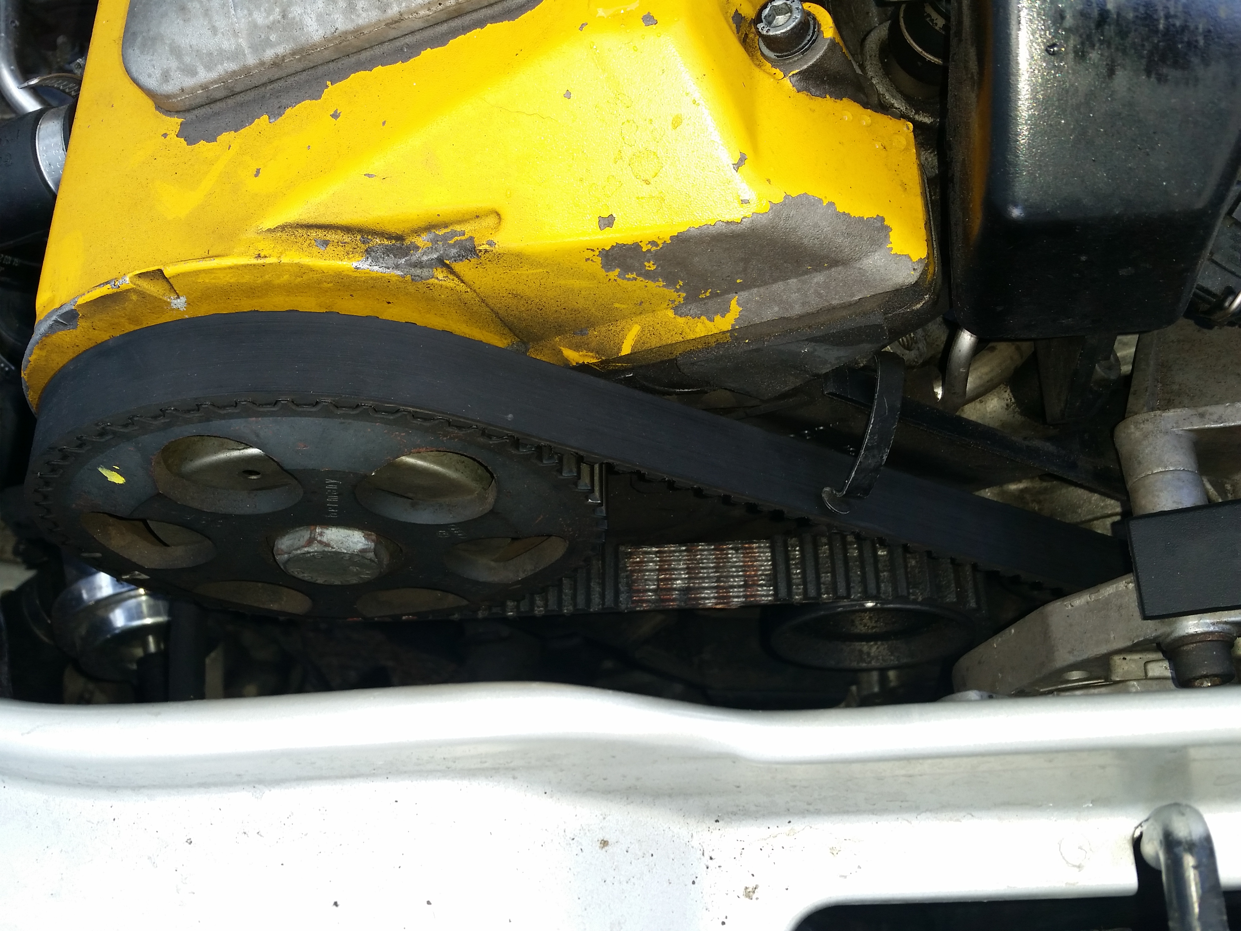

Well Crap! I'm having a bad car week. Alternator on the A4 went out so of course I decided to fix a few other things while I have the front of the car in Service Position. Then yesterday my newest acquisition (1995 Audi S6) died on me on the way home. Had to get it towed. Started off with the usual suspects, (Fuel pump, G4 & G40 Sensors) but quickly ruled them out.
I didn't like how the engine sounded while cranking, it didn't sound like there was good compression in all cylinders, more like when you're doing a compression test. Pulled the timing cover, put a quick index mark on the cam sprocket and....... bad news, Cam is not turning and on further investigation I can see some stripped teeth off the timing belt. That sucks, I was planning on doing it this winter because I have no idea when it was last done, (Purchased the car this summer).
Anyone want to hypothesize on how bad it is? I didn't hear any nastiness when it went, and it cranks over fine. Am I just looking at a few bent valves? I guess I better get the S8 done so I can get the S6 in the Garage. No room for both cars. :-(

No doubt you have bent valves, and probably some cleaning up to do of the pistons at a minimum.
Re: Bad Car week
Define "Cleaning Up". I'm hoping it was minor enough contact to not damage the pistons. I always take a wire wheel to the pistons when I'm in there so I'll definitely "Clean Them" and inspect them for damage. If there is a nick in the pistons, whats the recommended action? De-Bur and smooth it so there are no sharp edges to hold heat?
Re: Bad Car week
Yes, that's what I meant by cleaning up. It wouldn't be ideal to run them that way if they are nicked, but I'm sure you could get away with it depending on how much damage there is.

They would have to be really chewed up to have to pull them. But if you were in a high speed and didn't take the car out of gear when it happened that may be your case. I would stop trying to start the car anymore and pull of he head. Take a picture post it here and you'll get a ton of responses on if you need to go further.

Man that sucks, looks like you'll be replacing intake valves.
