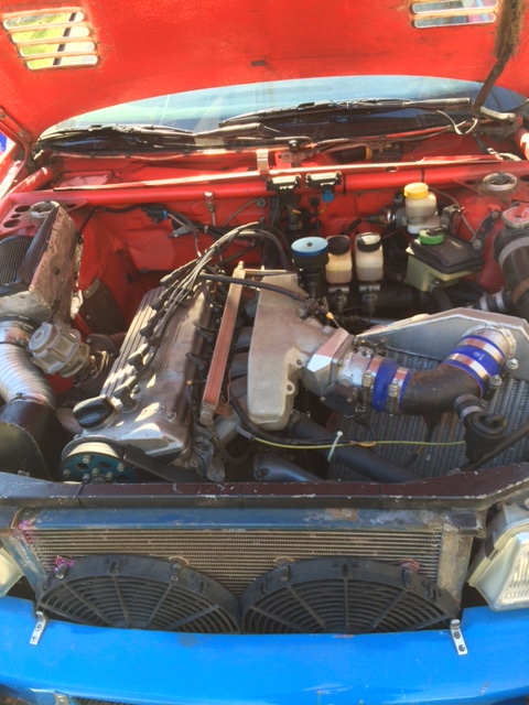

You have any engine bay shots with the EFR in there?

Afterthought wrote:Awesome pics.
Yep! See below. Random photo dump. Old school laptop tuning the Motec M48 for pump gas, new seats, blow shocks, rebuilt shocks, inlet restrictor 3D printed, sugary TIG welds,
